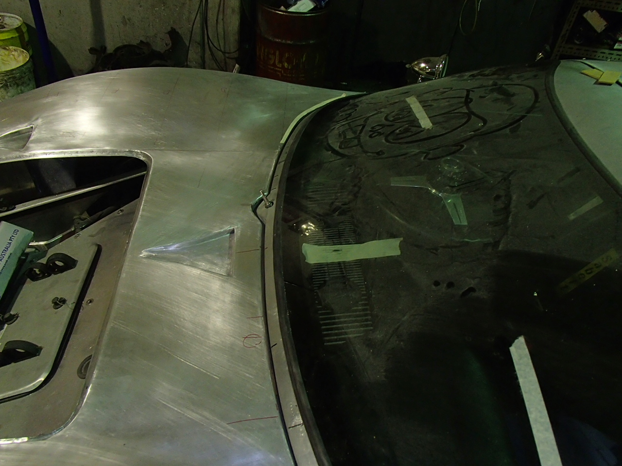

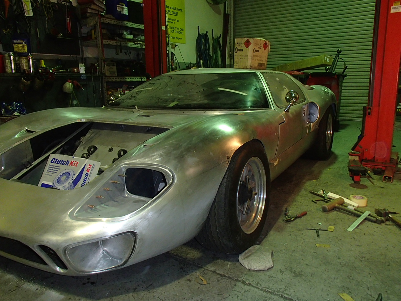

Yes they all function ,all the ducting that was on the glass swaps straight over.
They will just be bonded on with urethane or something similar.

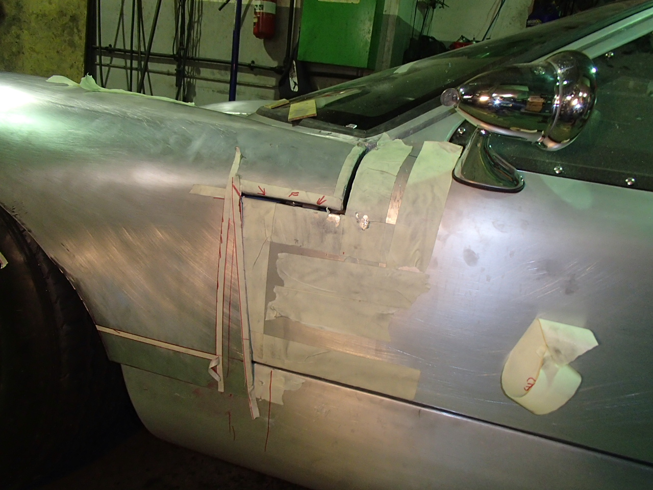

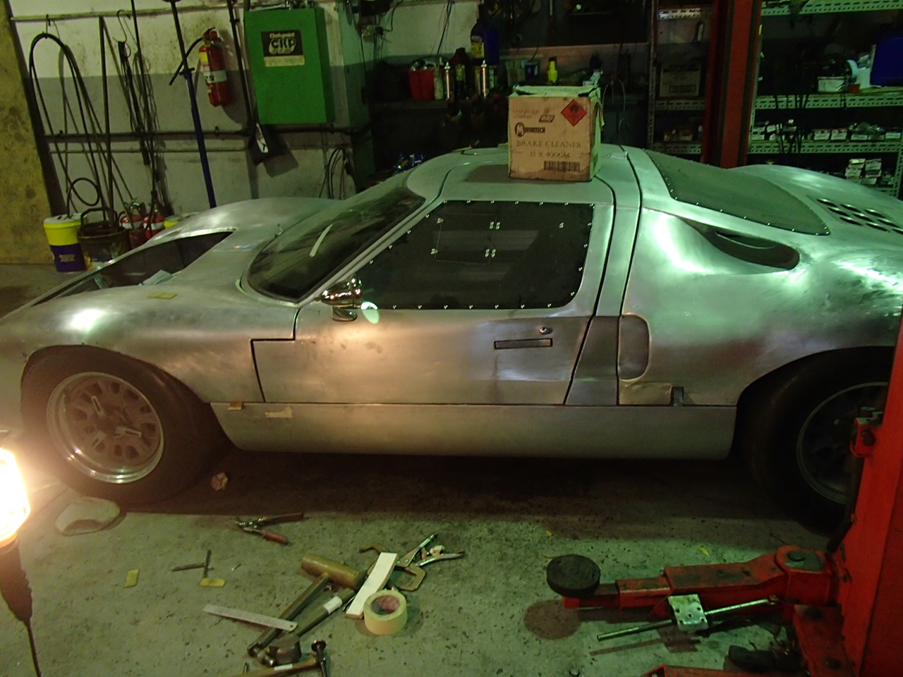

Today was a mile stone for me, I have been waiting for weeks to get this bloody thing on and gap it up.
The panel on the clip have excess material and overlap the doors and sill.
Hard to explain this on paper but you need to determine the gaps so you first need to find the edge of the door, the edge is under the overlap so you cant see it or get to it to mark.
I run 50mm tape on the edge of the doors and sill, with the clip in position I run another strip of tape on top of the lower strip and it will be half on the clip and half on the panel under it.
you then mark a line on the front edge of the tape and that is the edge of the door.
You then lay a strip of tape the width of your gap next to that and that is your fold line.
You run another strip the width of the cut line.
You use tape because you are often going around corners or over curves.
That's all I have .

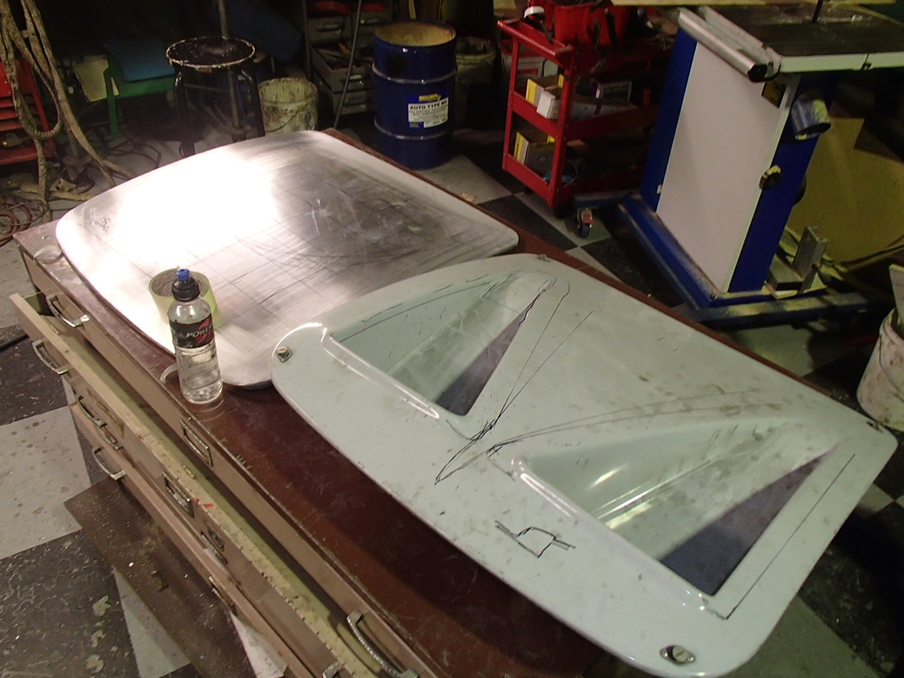

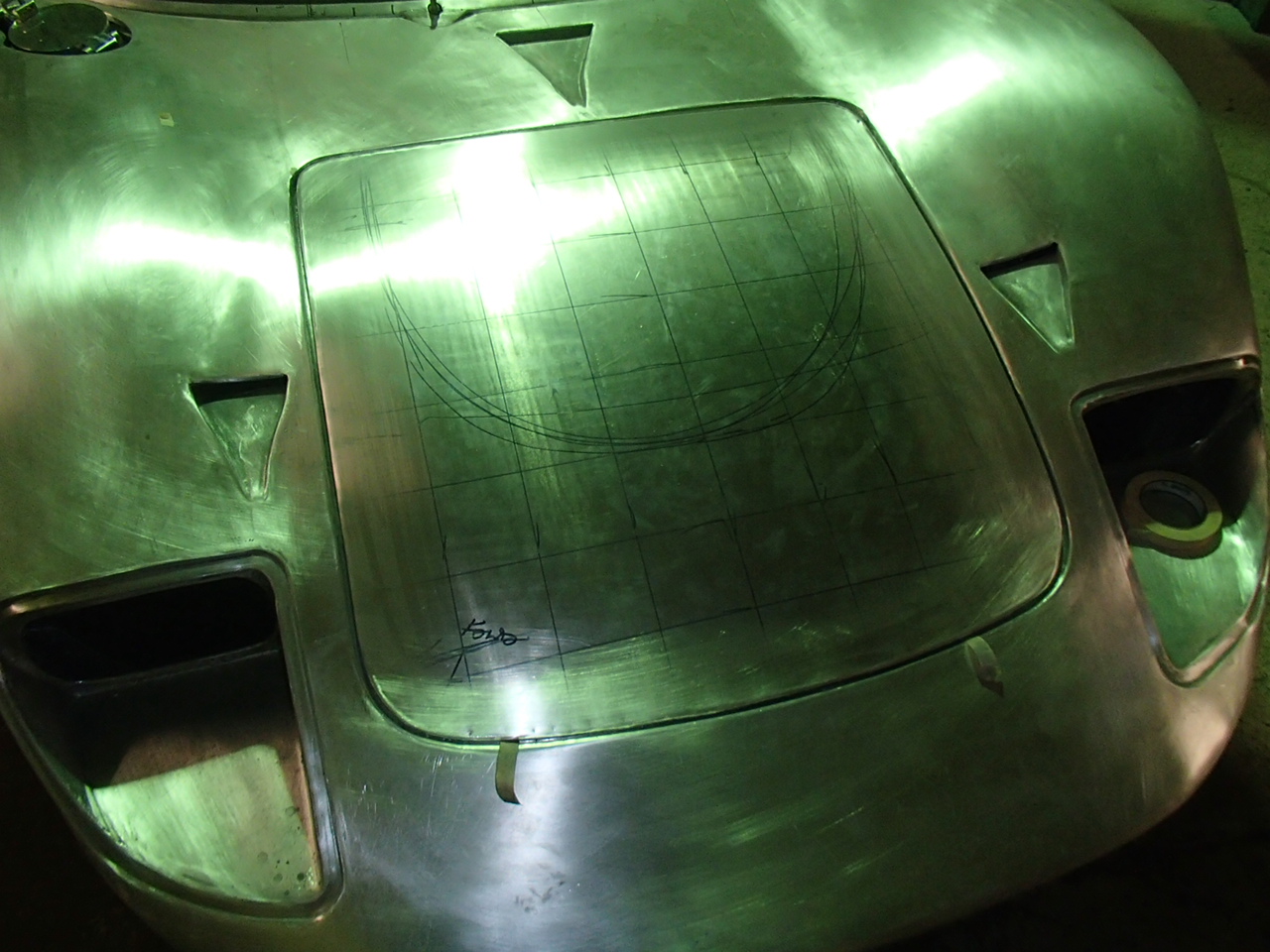

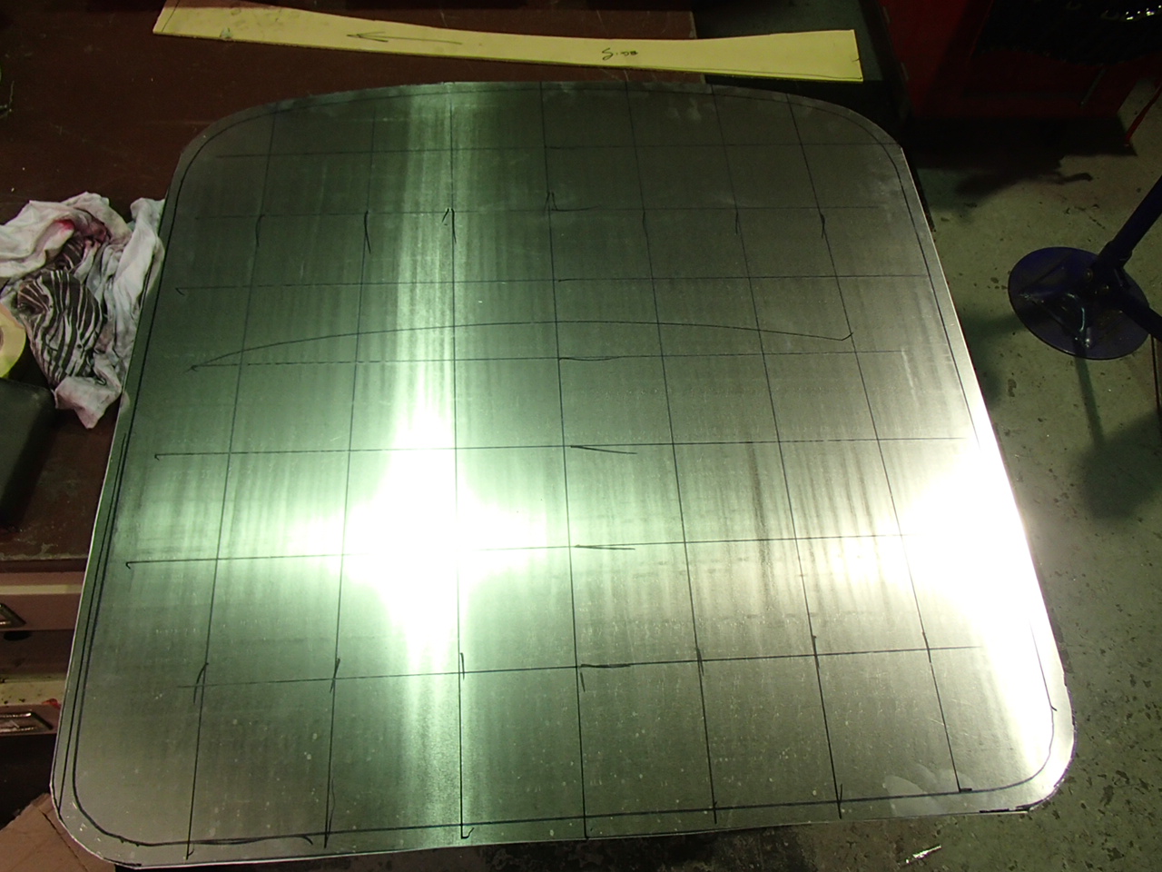

The next part was the center bonnet /hood if you are from the USA.
It was not a difficult parts, I wheeled some shape into it, the lines drawn are a guide.
Once I had the correct shape I marked out the outer fold and folded it over to give strength to the panel.

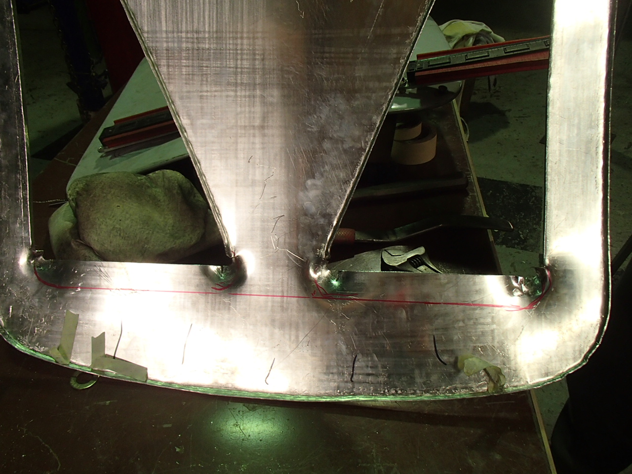

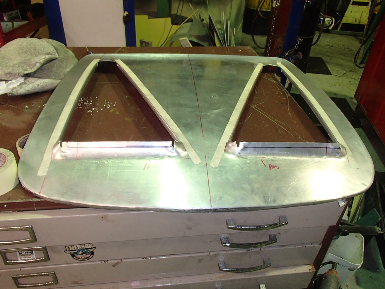

Next was cut the center out to match the original.
All the edges falling into the ducts where folded over and the front turn up was tapped over a T dollie while the corners of the turn up I used a hammer and smacked it into a sand bag to get the radius and blend.
I relieved these areas with a cut and after I wish I had not because It would have worked with out it, it happens you just have to fix your errors.

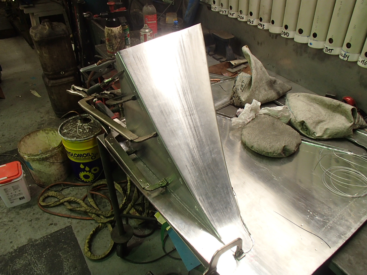

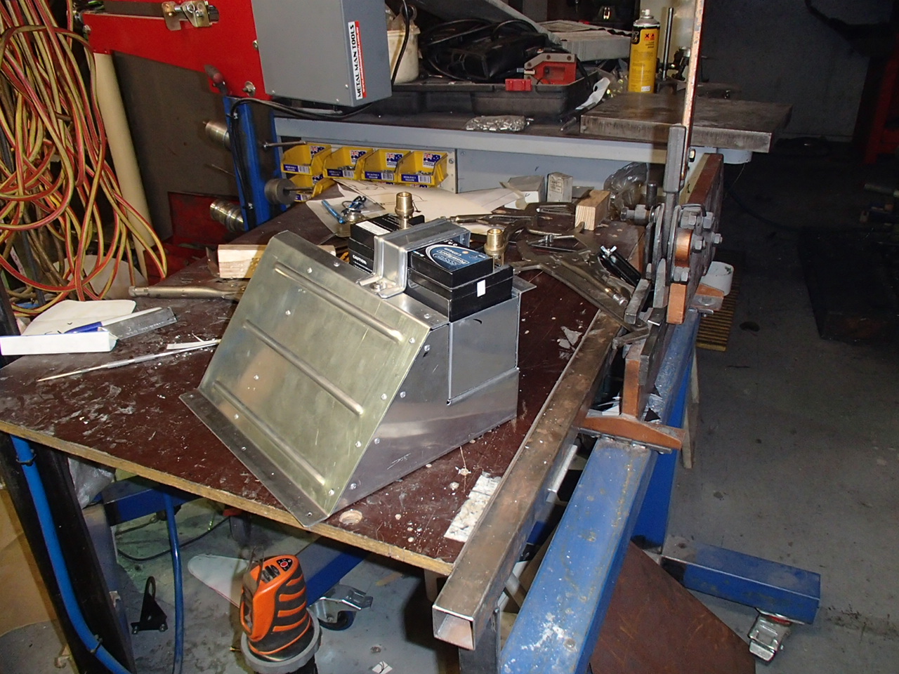

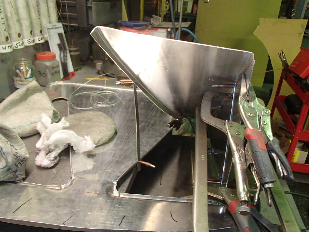

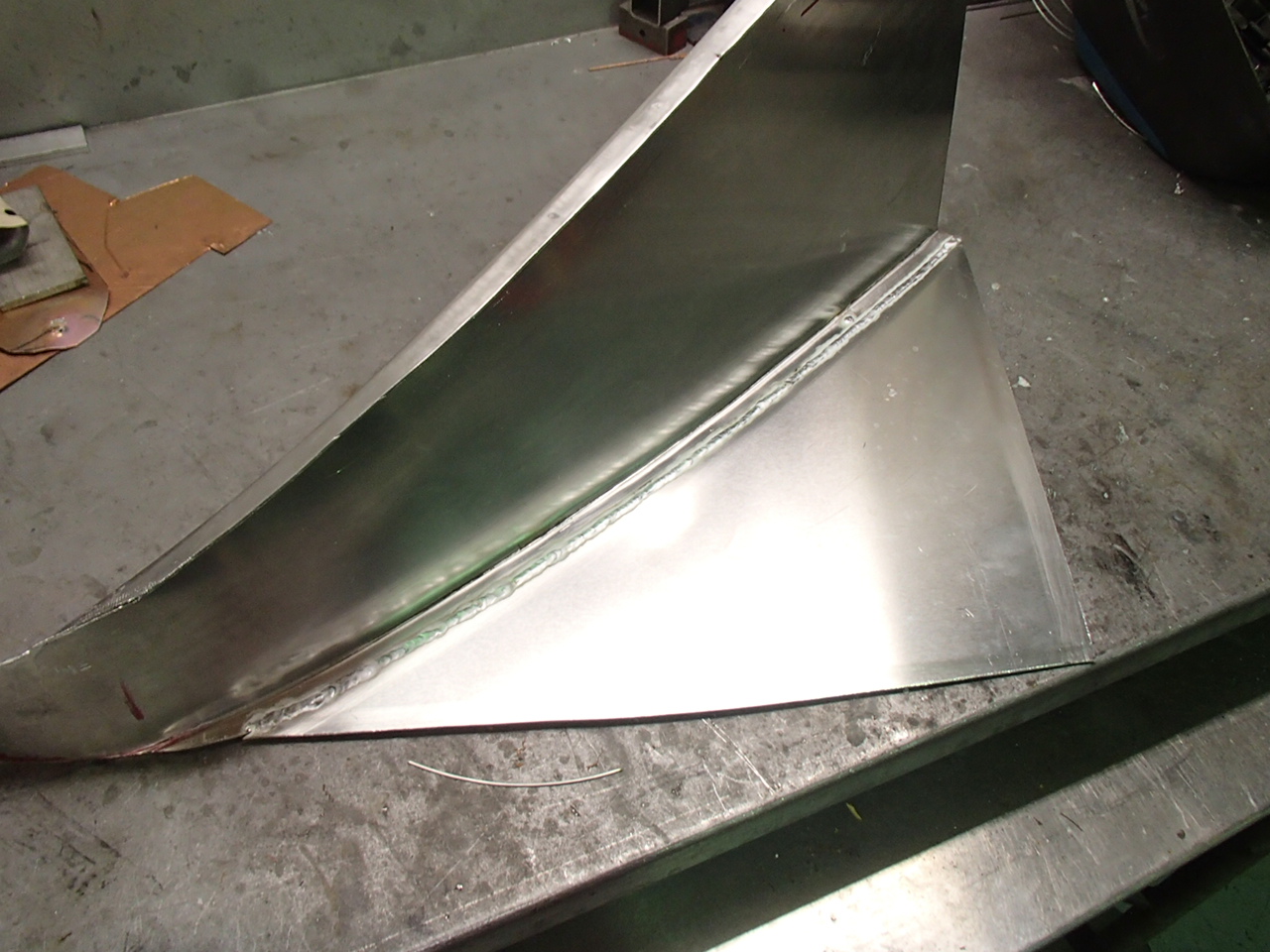

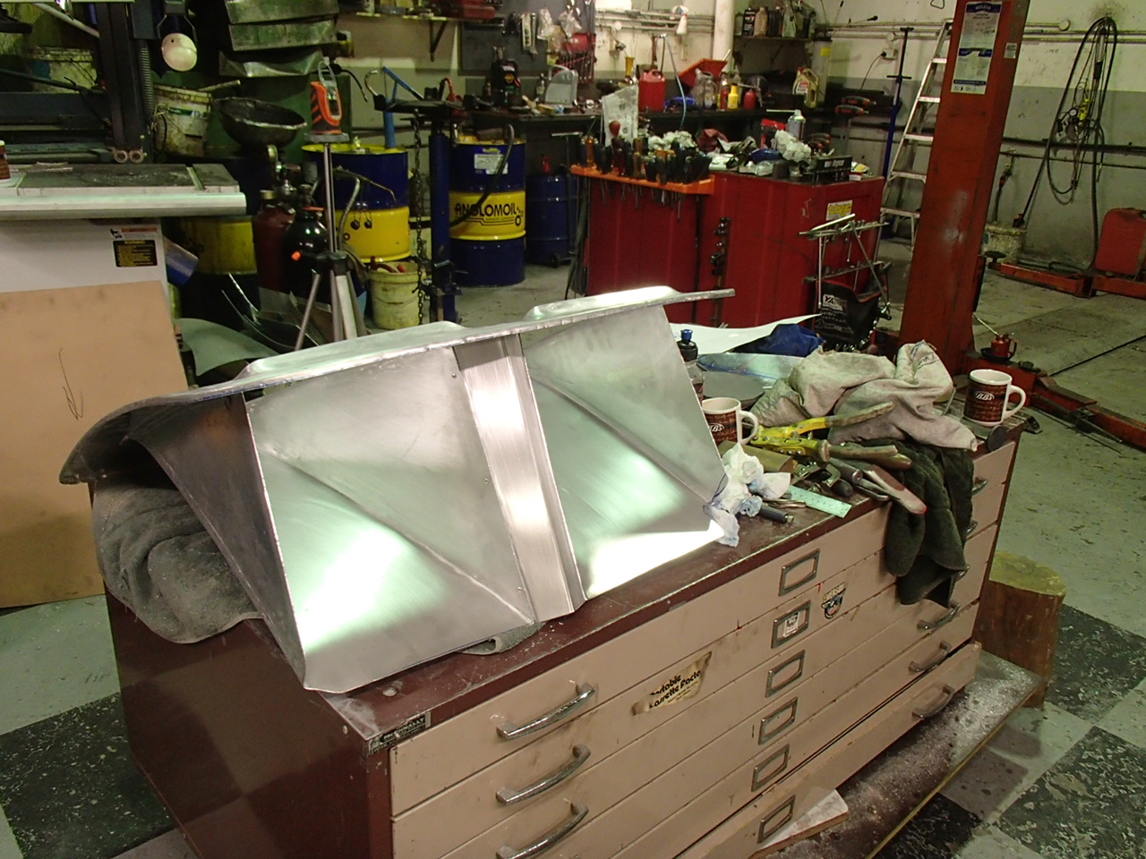

Next was to make the ducts, starting with the floor, set it up with some simple brackets then pattern the side panels.
Weld the sides on then repeat on the other side.
This is to the 85% stage, you clean edges and just generally tune it up, you would spend a few more hours to get to the finish stage.

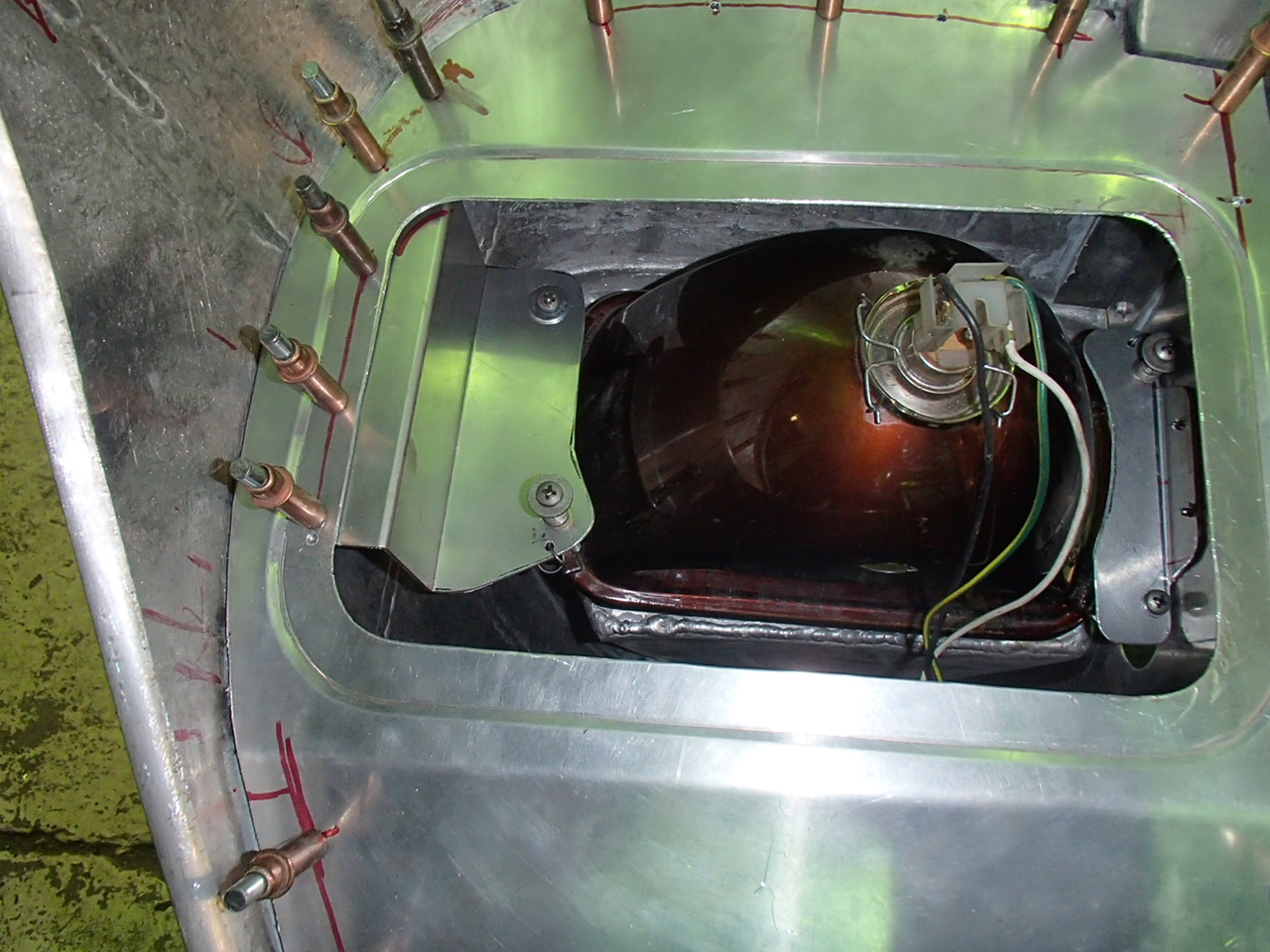

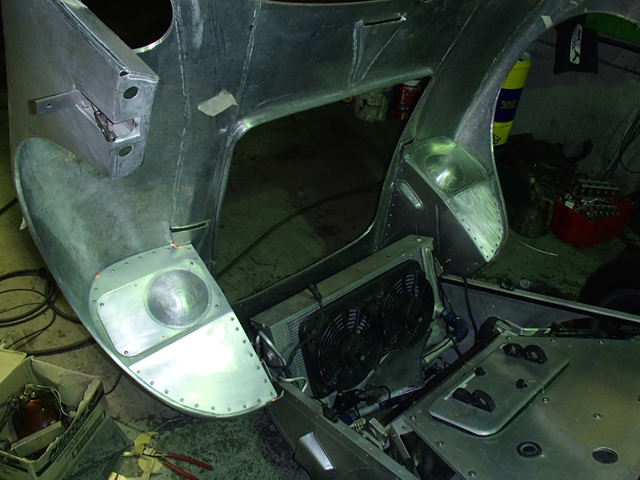

Made all the light brackets with adjusters.
Beat out some cups to fit the rear of the lamps to give an old school look to it.

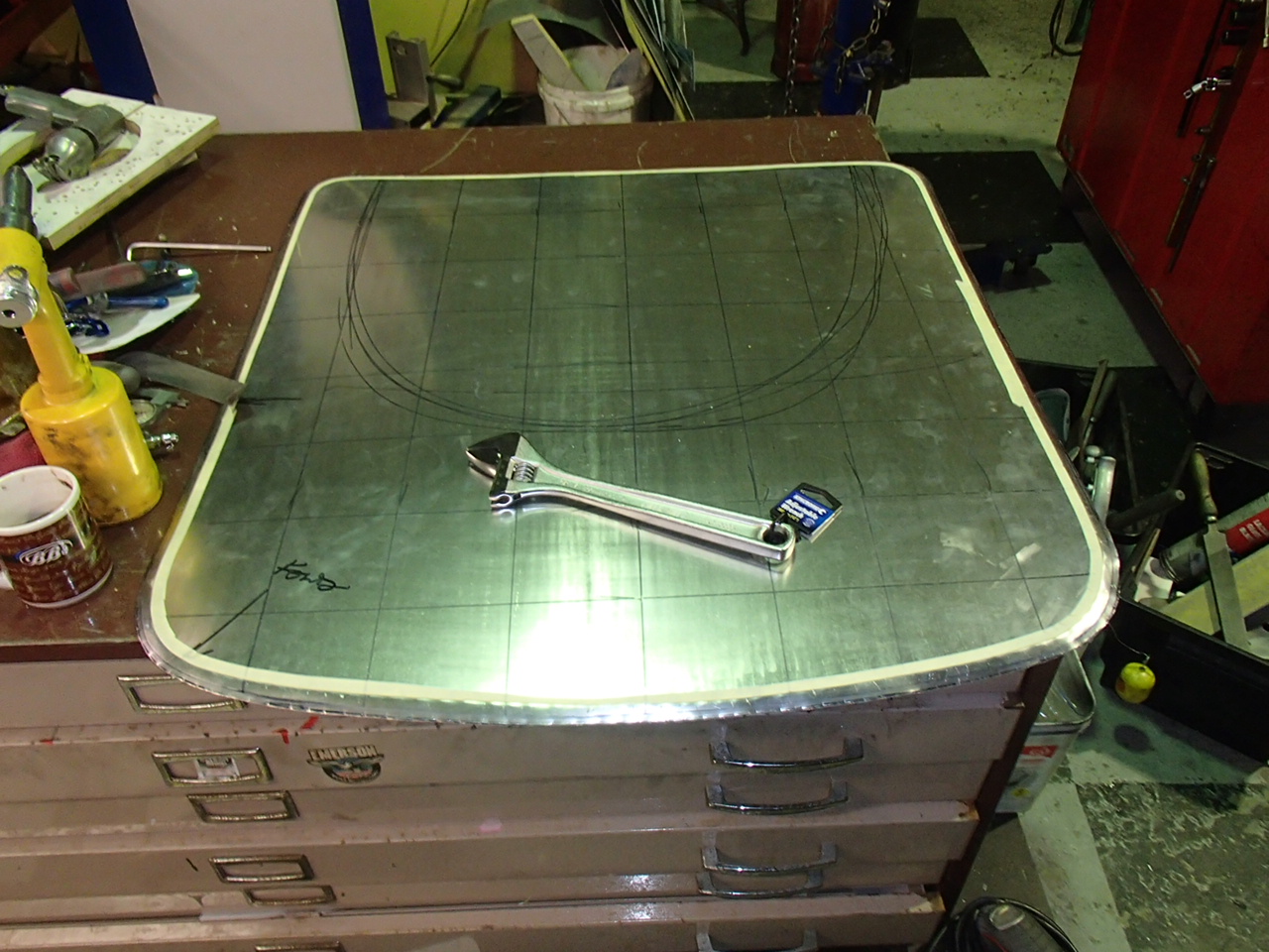

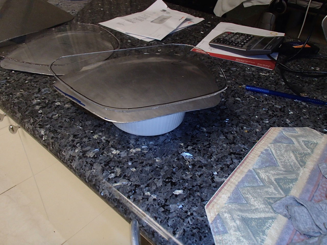

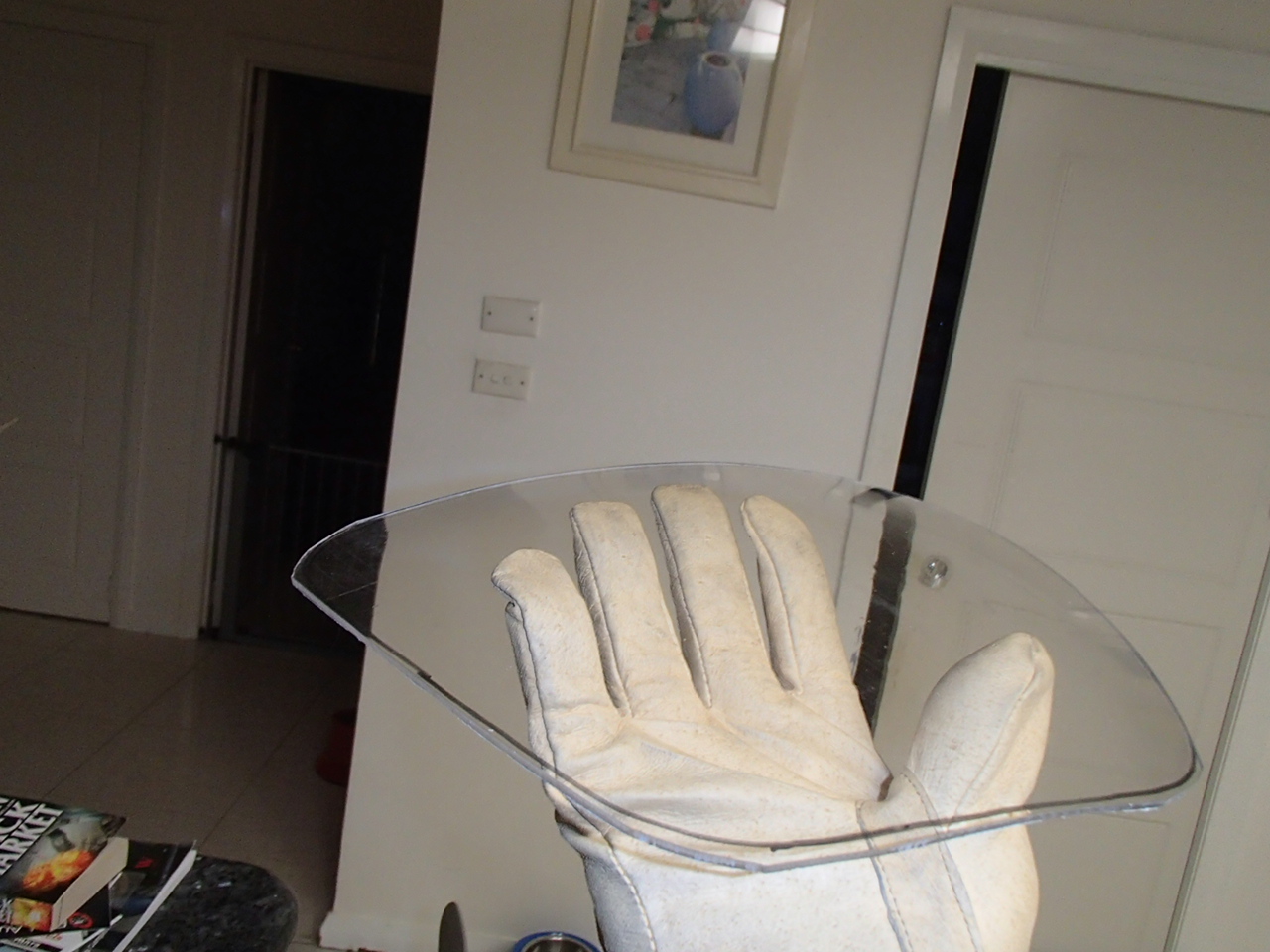

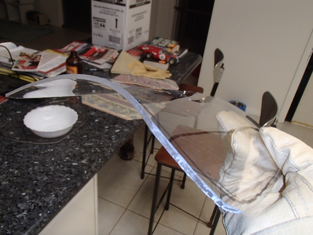

Headlamp covers I formed the covers in alloy then used the oven to heat the plastic sheets.
Then with clean gloves I applied a small amount of pressure .
I trim the outer to size by using the belt linisher.

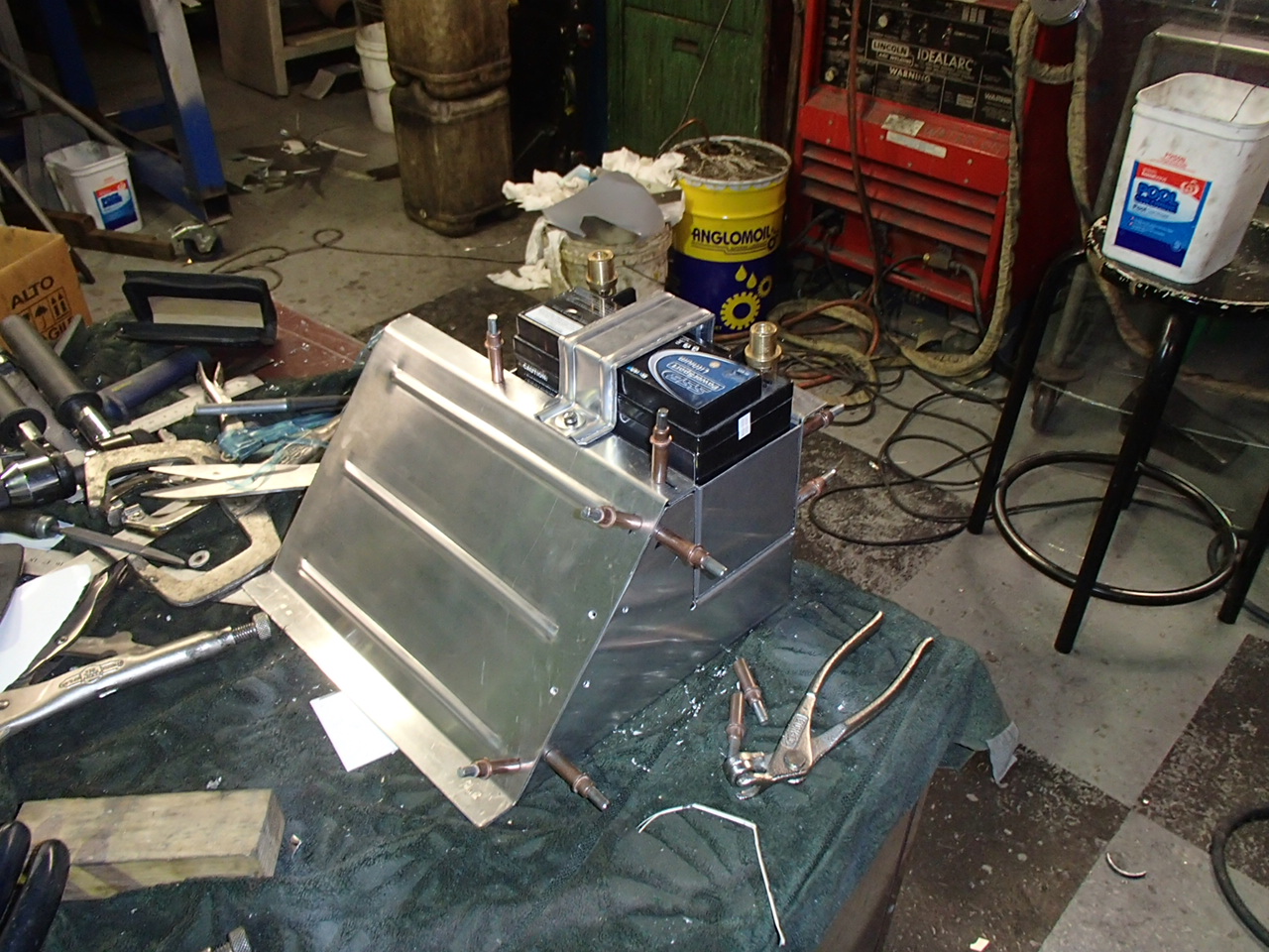

I always needed more leg room on the passengers side so the battery had to go.
I was given a lithium iron battery by on of the reps that buy of.
It is 400cca so its plenty, the weight of this thing is amazing it feels like an empty box.
I made a new foot rest but incorporated the battery into it.
