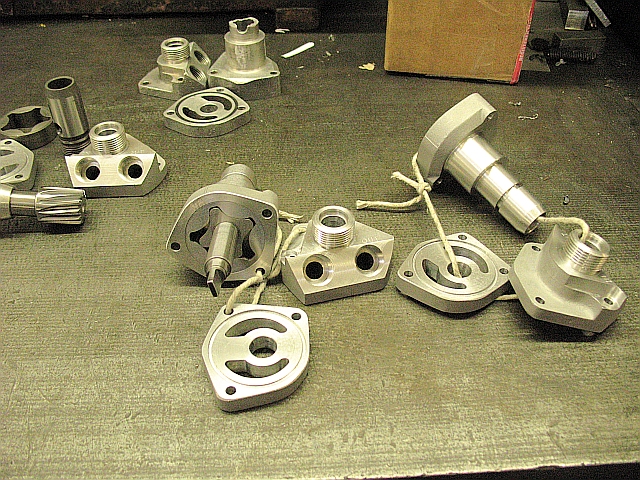

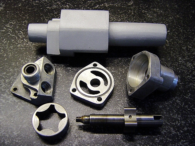

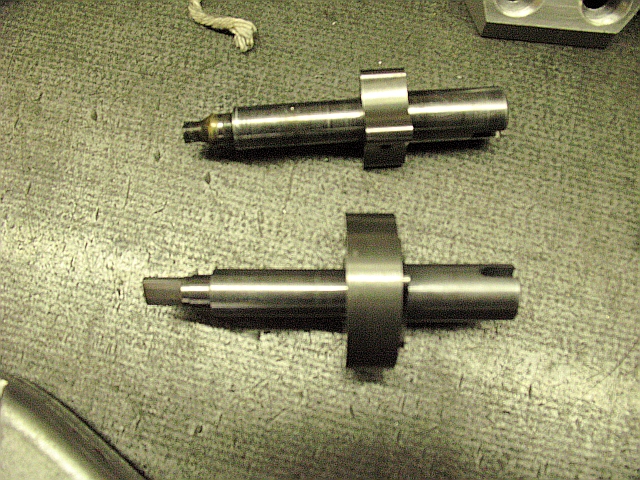

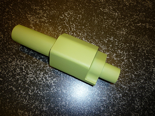

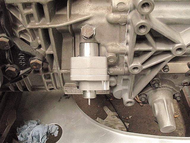

The ZF Oil Pumps are ready.
My mate Doug Fitzpatrick loaned me his broken pump to copy and we made three new ones.
Doug's has a slightly different drive connection on his Lotus so we made two spade types for us and an exact copy replacement for him.
We also added an oil seal to the spigot.

re: Jimmymac & Alistair's Cars
It's just brilliantly smart!
One pattern, sliced and machined.... I wouldn't had the idea!

The gerotors were eventually electro-eroded out of steel and polished.
The sinter ones had the exact same profile as the ZF and came from a BMC pump but were too long.

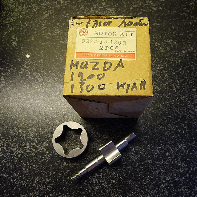

You have your pump rotors made know, but size wise it looks like Mazda 1300.
I did a lot on those engines and it looks close ,Maybe worth looking at for future.

Thanks Jim,
You might not believe it but I tried the Mazda 1300 rotor and unfortunately it was too big.
The Mazda is 50mm diameter and the ZF is only 40mm.

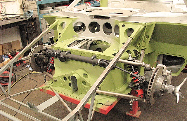

Steering rack and brakes installed at last.

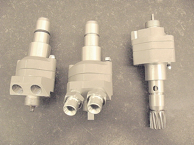

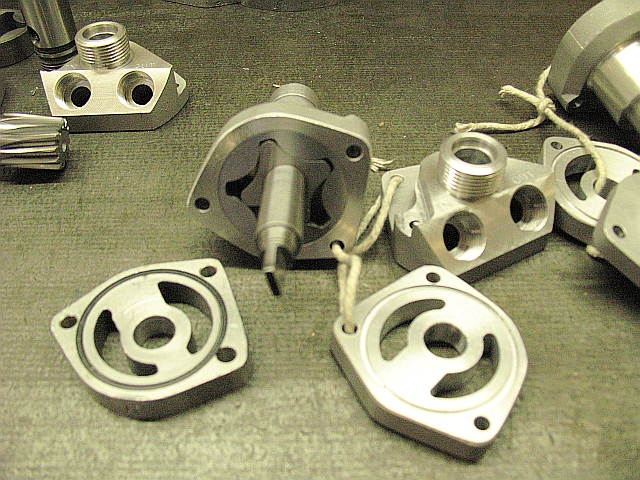

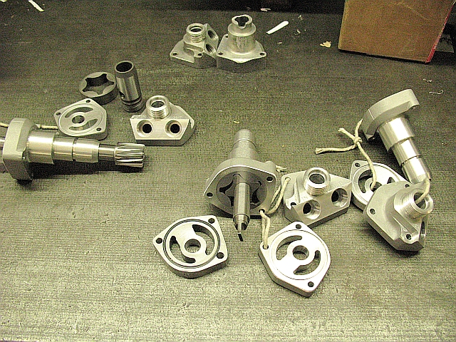

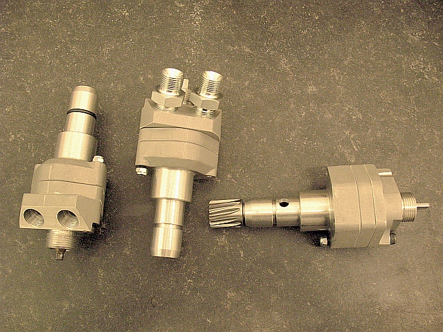

Finished ZF pumps.
Doug's new pump for his Lotus is on the left in the first shot.

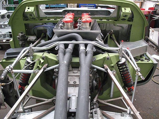

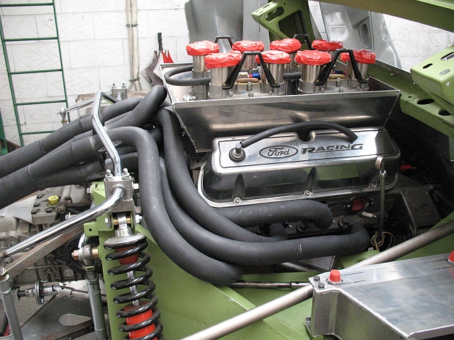

Dropped in the exhaust headers today before they go out for coating - just to get an idea of how they will look.
These are old style sand bent ones with no butt welds.

Exhaust bolted to the headers today and really pleased with the result.
We have decided to add some loops and springs to the collectors.
Now making the original designed rear support bracket to the transaxle.

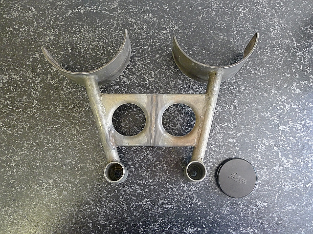

Here's a rear exhaust bracket from an orignal car in case you were wondering.
