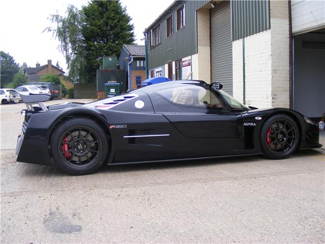

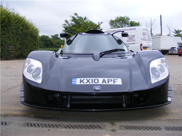

my car stands at 1256kg but thats fully comfy road going, with new front EPS rack in which is much heavier than the SLC one

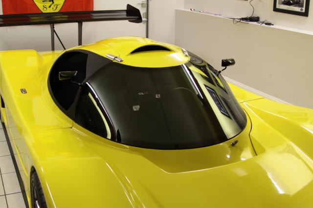

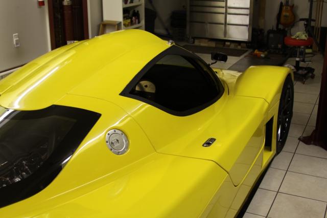

Mirror problem solved. These work nicely. SPA F1 mirrors. Ready to roll now.
I've had those mirrors on another car and found them to be very light and not very susceptible to road vibration - but they were a bastard to align and keep aligned with a locking screw buried deep within the mount..
On another note - The windows sure appear to be very dark. Does the local law not have anything to say about them? I know that here, they'd ticket you and not allow the car to be driven further - necessitating a tow home on a flat bed..
