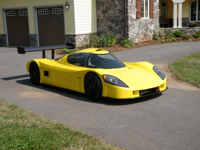

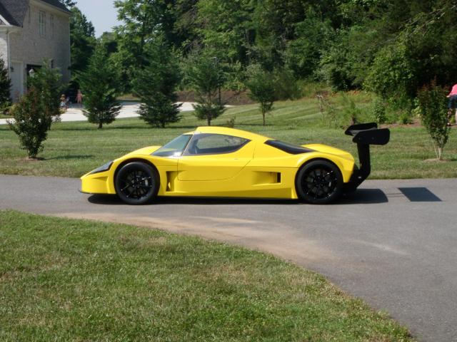

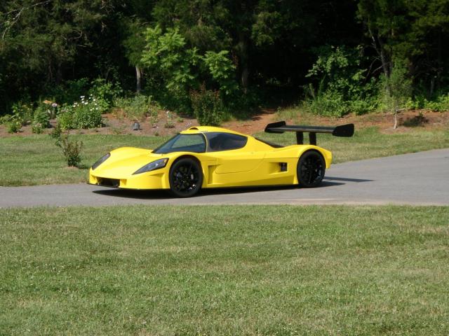

Since this isn't really a build log and it's not a replica, I am going to put this thread here. My father just brought home his SLC and we have started the tweaking that will be required to get it ready for it's maiden track time mid July. This is pretty much a turn-key car, though a few things will still need to be done.
First off, pictures!
The car is intended to be a track car. What possess him to get what is essentially a poor man's Daytona Prototype (in better looking skin) is beyond me, but I am going to ride (and hopefully drive) along with a grin.

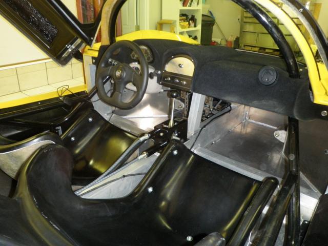

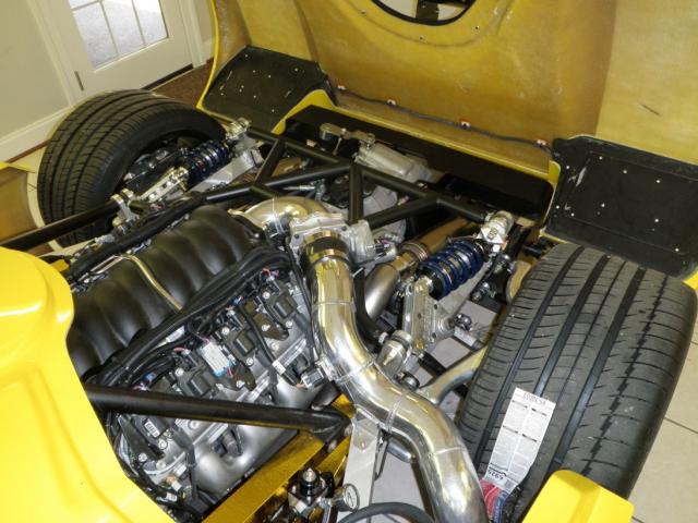

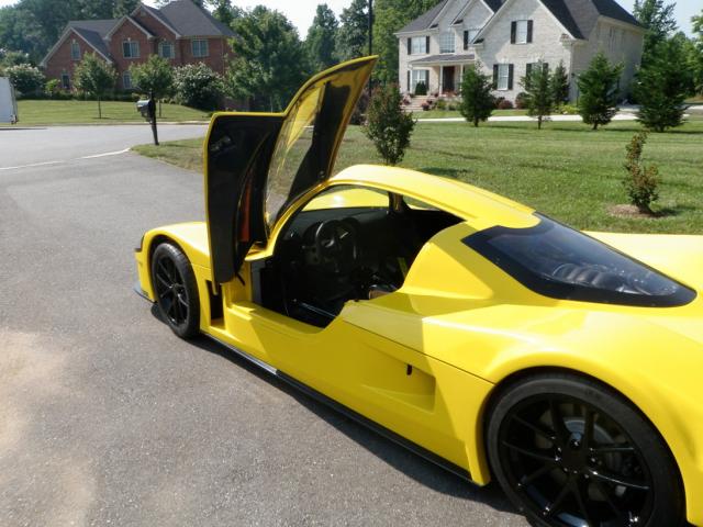

The car has a LS376 crate motor, so it is wet-sump. It has the usual Ricardo with the new style shifter. It has many things that were not developed when the car was ordered: tilt and telescopic steering column, the new high-mount carbon wing with quick-release tilt-away that allows quick access to motor, ram operated doors, and the new standard Brembo brake kit which is an upgrade from the old brakes.
Inside, the dash has been flocked and looks very purposeful. The only interior panel is the top center piece. The interior door latches are cables and work very well. In fact, the doors are really sweet, easy to use, and functional.

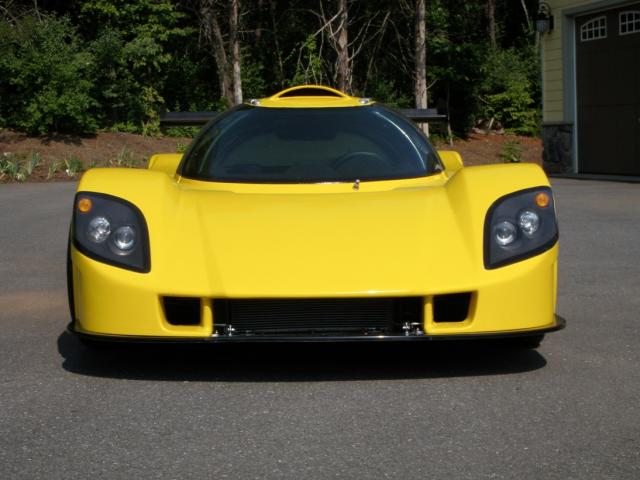

The fit and finish on the fiberglass is fantastic, especially considering that this is gelcoat. It looks like paint. It's very race car though - all the panels clip down like body work over the skeleton of a racing chassis, since that is essentially what they are. There is no weather stripping, sound deadening, or insulation.
The windscreen has always been one of my favorite parts of this car. Look at the line of the edge of the body through the severe curve and you see zero distortion. It is like a giant Oakley lens wrapping around you.
I still can't wrap my head around driving this car on the road. I have had the privaledge to ride in a few outlandish cars (a Murcielago always stands out) but I can't think of ANYTHING that is going to stand out like this. Pull up in a Carrera GT, and those in the know will realize that you are driving something special. This thing... most people won't have a clue what it is, only that it looks like you have stolen it from the pits at LeMans. The doors are just icing on the cake.

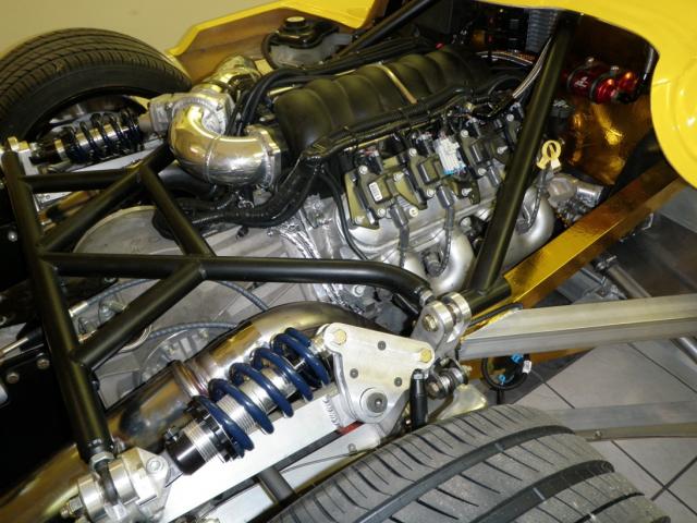

Fran and the boys did some nice work putting this together, though really everything is pretty much "stock". Reasonable motor, the usual gearbox, digidash, standard brakes and wheels, front lift (a necessity). I think pretty much everyone is going to be running these things, and many guys have a lot of upgrades beyond this. As is, I think it is going to be a track weapon far over our heads, but I really look forward to growing into the car (assuming I get to spend some time behind the wheel).

Since we just blew the motor in our Cobra (which was wet sump) I think it will need an accusump, and I also think it will need a transaxle cooler. The tranny cooler is a piece of cake. I would not have thought about the accusump until the big bang... once bitten twice shy.
Check out the sweet gold foil Fran lined the firewall with. You can see it through the window from the car behind. You also get to watch the shifter in action from behind.

Looks fabulous. I'm using the same foil on my firewall and some gold mylar foil over the round diagonals. I just stabbed the Ricardo onto my engine so I'll take the requisite photos maybe tomorrow or so. I like the intake tubing. I may hang the oil coolers at the rear and do the same as yours for the intake after seeing that. I definitely like the rear wing pivot.....just one more item for the must-have list.

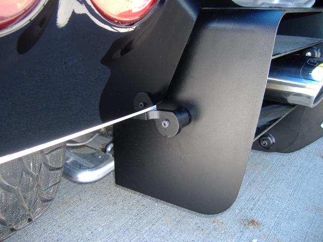

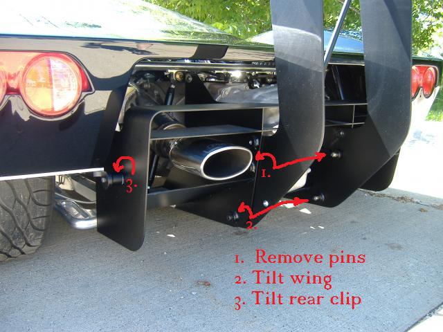

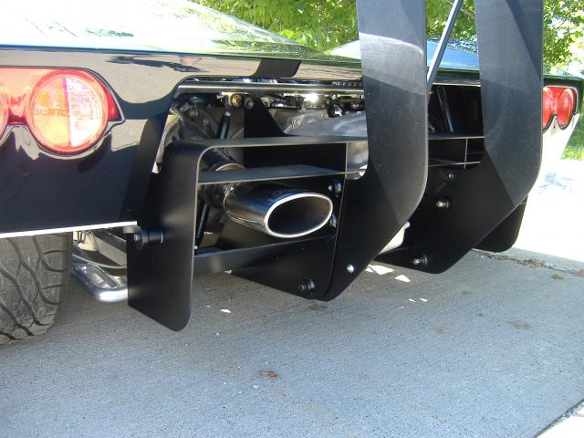

can you post pics of how the rear clip's "hinges" are installed? I can't figure out how the heck they mount for the life of me.
You mean these simple little things that allow the tail to open a full 90 degrees......wink

Interesting - it doesn't seem like the tail can open a full 90* w/o whacking into the spoiler though. Hummmm, well, only one way to find out :D
Alex,
you pull two cotter pins and the wing tilts out of the way about 30 degrees or so, then the rear clip has clearance to go all the way back. It's really slick!
I'll try to take some pictures tonight.

Alex,
-J.
Interesting, I see I see.
Frannnnnnnnnn, with the ?older? style diffuser/wing mount, can the wing be hinged back and not hit the ground? I see I have 3 bolts (1 on the bottom of the plates, 2 at the top, and then a black cross-brace that runs from the top edge of the driver-side plate to the bottom edge of the passenger side plate).
I'd imagine somehow you'd replace the 2 top bolts with quick release pins or cotter pins or something?

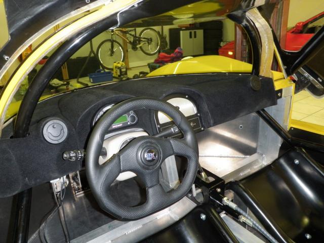

I'd like to know more about the Flocking (process) on the dash!!!
Randy, I'm planning a CF overlay of the binnacles and flocking on the rest of the dash. I believe this has been done before with good results. Very inexpensive DIY project. Good info about doing it yourself at www.donjer.com
I have tried it with thier cheapest sample kit and it worked so well I was very impressed. PM me if you would like some hints learned doing this simple process.
