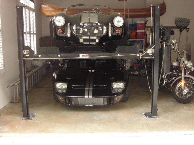

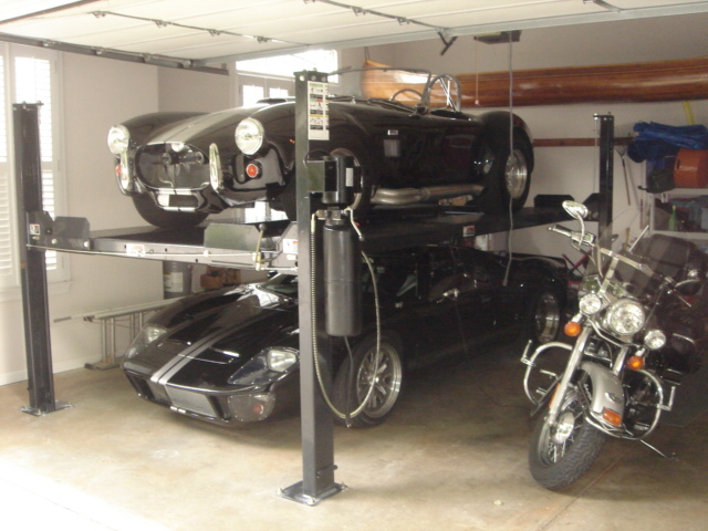

It has been some time since I last posted. As I need some floor space in my shop for a new project I decided to install a four post lift so I could "stack" cars in the garage.

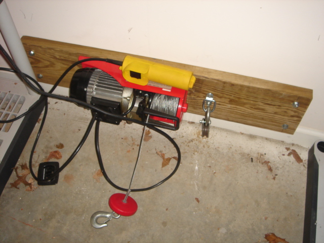

I wanted to back the cars in and did not want to get help each time I did so I installed a hoist on the wall behind the lift so I could just hook up a cable and pull the cars either on the lift or in under the lift.
I know it looks a little odd but it really works well............

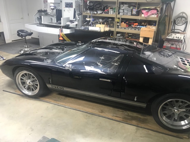

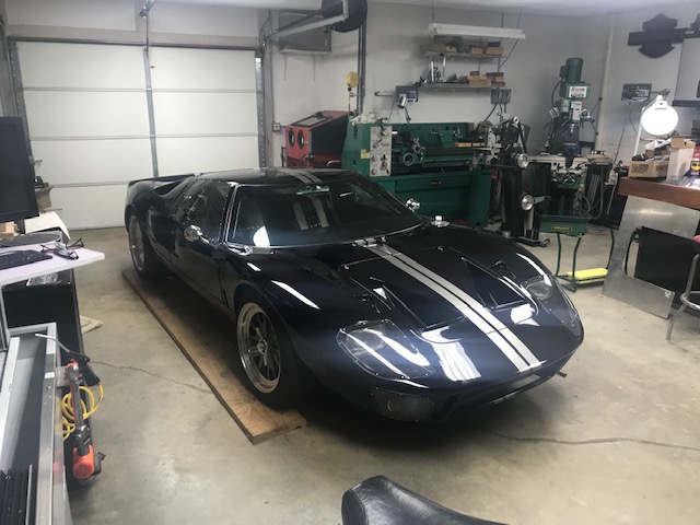

Drove it down to my shop and took a couple of photos, the old gal looks pretty good.IMG_2588.jpgIMG_2587.jpg

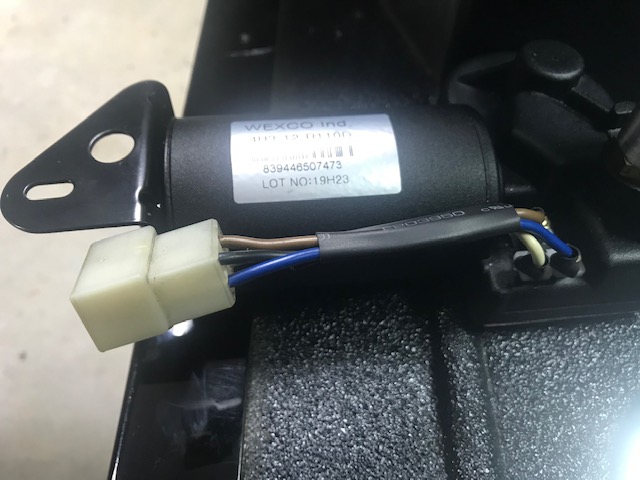

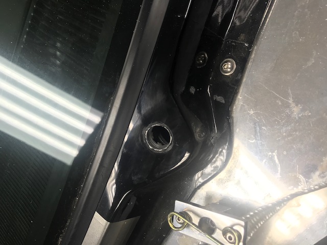

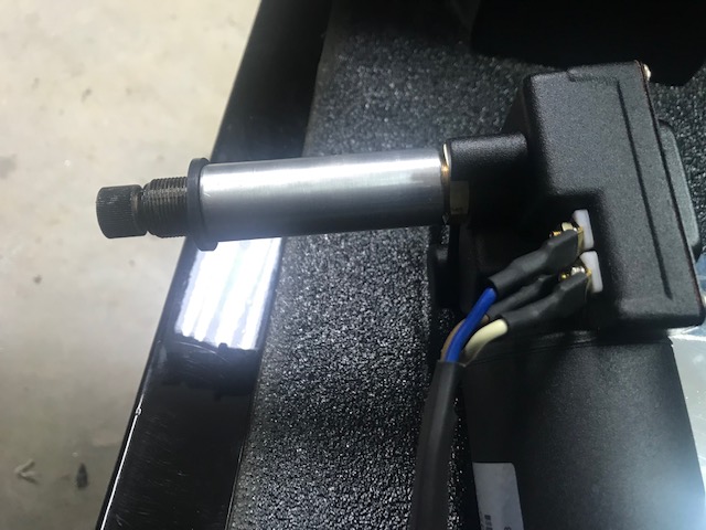

In my previous post I mentioned that the original wiper system had worn out the plastic gear drive (wheel box). To effect a permanent fix I removed the old system and installed a Wexco marine wiper motor that eliminated the need for the cable, tubes and wheel box. The hole in the spider had to be enlarged from 1/2" to 5/8" and an aluminum spacer was machined (1" OD and 5/8 ID) approximately 2.150" to space the 3" motor shaft to my spider. I cut the wire pigtail from the old system and wired it into the new motor so it was just a "plug an play" with my existing wiring. The bracket on the rear of the motor has to be bent/ twisted to make it parallel with the upper bulkhead you can visualize the bend necessary by putting the wiper shaft in the hole in the spider from the top then look to see how much bend you will need on the bracket. Once I got the bend on the tab correct I drilled a 1/4 hole in the upper bulkhead and used a 1/4-20 bolt 2.5" long along with a 3/4 OD and 1/4 ID spacer to fill the gap between the bulkhead and the bracket and a nylock nut.
I had to order a new wiper arm as the marine wiper motor has a special size drive but there are several vendors out there selling the Wexco wiper arms.

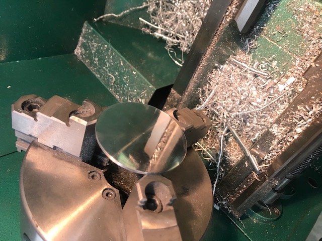

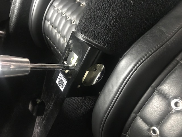

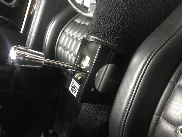

One of the things that has always bothered me when looking at the interior of my car has been the 2.5" open holes in the sides of the cable shifter box. I had a thought yesterday that those holes may look a lot better with some polished aluminum covers. I had enough 3" diameter aluminum bar to make them IMG_2618.jpgIMG_2613.jpgIMG_2612.jpg
so I turned two on the lathe and polished them. A few little dabs clear RTV holds them in place.

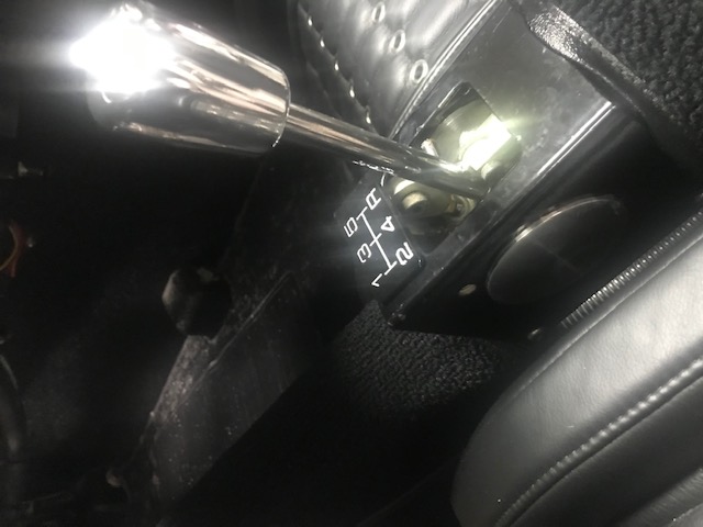

One of the other items that I had thought about but never completed was a shift pattern indicator. I have looked at a lot of different shift knobs with the shift pattern on them but they all looked like they did not belong in the GT40, and, I was sort of partial to the shift knob I made.

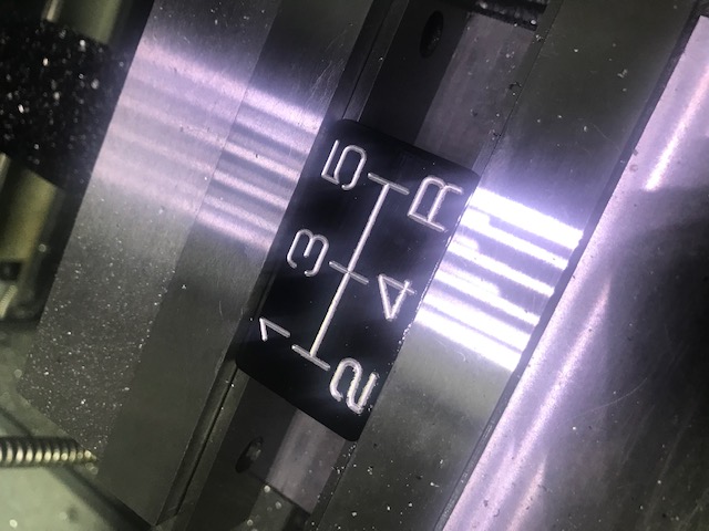

I had a little time yesterday so I wrote a NC program to engrave a plate with a shift pattern. My original intent was to polish an aluminum plate and engrave it then fill in the engraving with black paint. My proof part was a piece of aluminum with gloss paint. After testing several fonts, this one appeared to be the most readable.IMG_2621.jpgIMG_2622.jpg
Seeing how good this one looked on the car I went with it and did not make the polished aluminum one.
