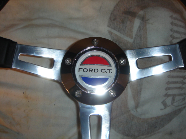

Apparently Santa believed I was a good boy this year and he provided me with a new Grant 1130 steering wheel. I drilled the wheel and the trim ring to accept quarter inch bolts from the quick release; then I turned down the heads of the five five button head stainless cap screws to fit in the trim ring.
The leather wheel, chrome trim ring, and the Ford GT logo really adds some "bling" to the interior.

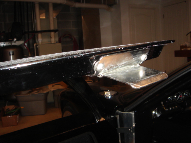

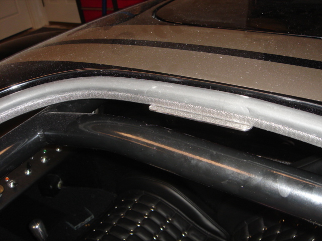

Door top keepers.
As I really did not like the look of the "eyebrows" I purchased a set of the "door top keepers" from EGLITOM here on the Forum. They are stainless steel and have a very high quality look. I used 1/4 inch button head fasteners and rivnuts to mount them. The tab on the piece that is attached to the door top has to be manipulated (bent) to get the correct fit, but when they are adjusted correctly the door tops match the top of the spider perfectly.

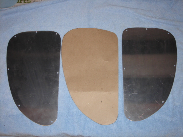

Light box covers:
I made a card stock template of the openings for the lights in the front clip. They are very nearly the identical shape so there is no need to make a template for each side. I cut the covers out of .025 aluminum sheet on the band saw and fastened them in with #8 stainless steel sheet metal screws.
I had thought about painting them flat black but I like the way they look so I am leaving them natural.

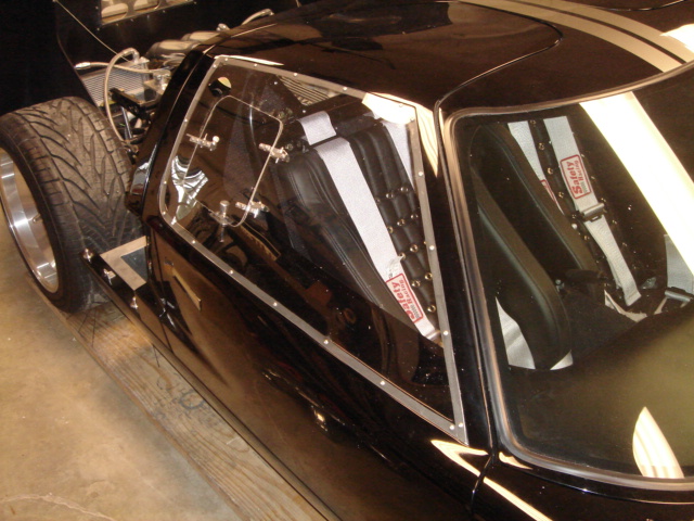

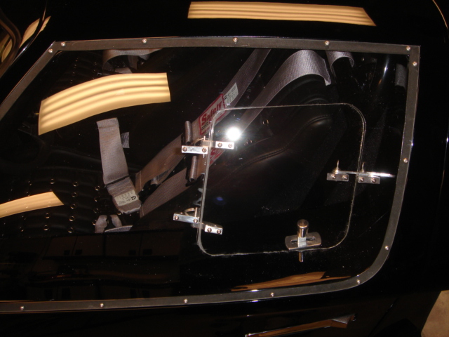

Side windows:
The side windows are pretty time consuming to install. One must take their time when sanding the window edges for a final fit. I used the hole pattern that Chuck and Ryan used for the fasteners. I applied the same "foam tape" that I used for the light covers on the windows as it makes for a very nice finished look. The door shell was drilled and taped to accept 8-32 stainless button head screws (the same as I used on the light covers). The fasteners take a bit of adjusting so that the window edges don't get a "wavey" look as you sight down the window.

Keith, awesome job trimming and mounting the side windows. You are right on the money about snugging the screws down to just hold them in place. If overtightened, the plastic will become wavy due to the pressure of the screws. Again, a super sharp fitment.

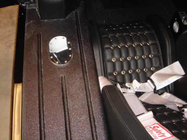

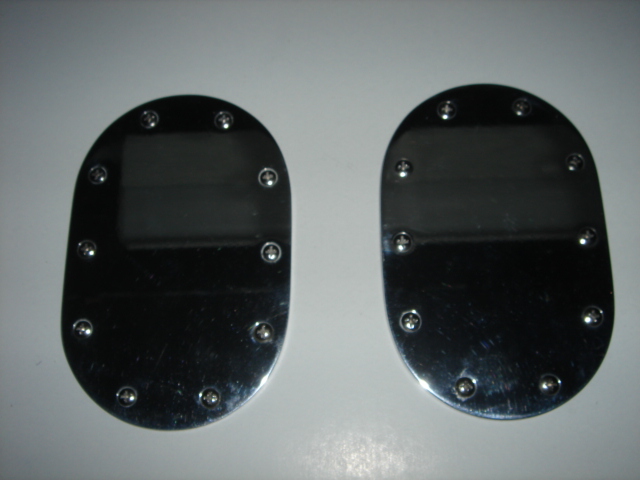

Faux Fuel Tank Inspection Covers:
I machined two oval covers to simulate the covers on the original cars. They were made from .250 thick 6061 aluminum plate. I drilled and countersunk holes for stainless steel fasteners and stuck the fasteners in place with epoxy. After half an hour on the buffing wheel they had the appropriate "bling" that I was looking for. I used black RTV to hold them in place. Now if I can just keep my feet off of them..............

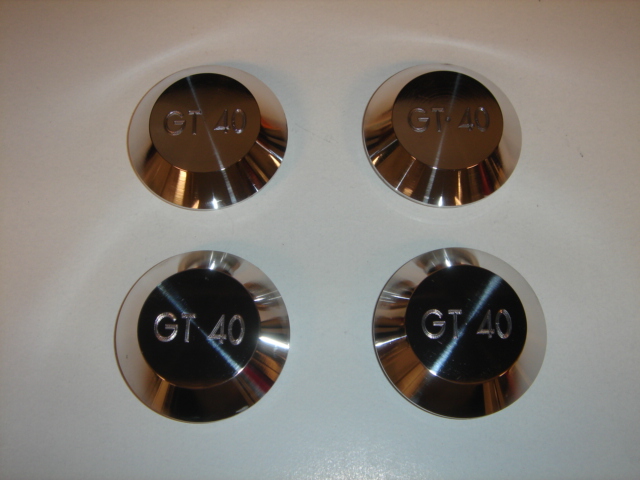

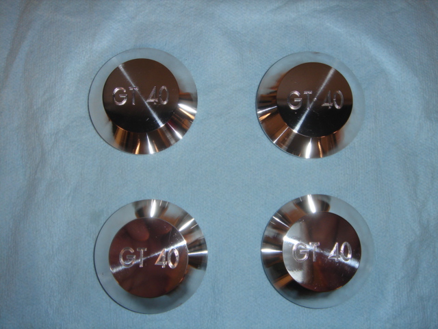

Wheel Centers:
I have been keeping myself busy while the weather warms up enough for my first test drive by finishing all those last details that seemed so trivial during the build.
The wheel centers were chucked in the lathe and polished. Then I took had a "GT40" engraved on them and brought them home for another polishing.
