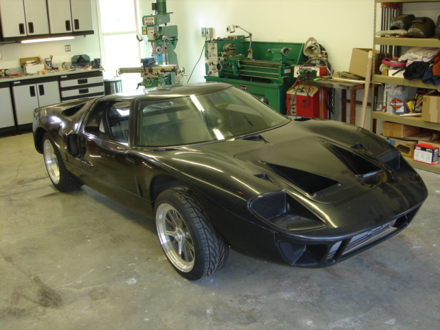

I had it home and in my shop by 9:00 that night (see photo) and spent Saturday sorting thru parts and marking boxes. Out of all the parts in the deluxe kit I only had two back ordered parts the door handles and the axle shafts. The only thing missing out of all those parts were the engine mounts and I believe this was probably my fault as Fran and I were discussing the mounts and I think they got put back on the shelf instead of in the box. Fran had the mounts and the door handles at my front door in less than 48 hours.

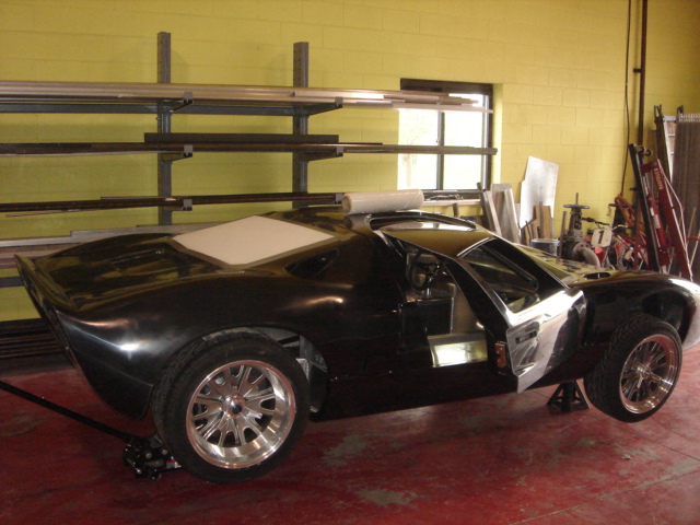

I have worked on the car untill nearly 10:00 every night and I am starting to see some progress (see photo).

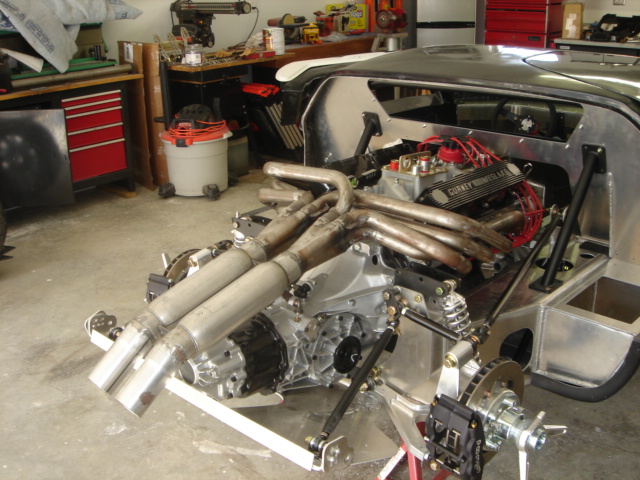

Pantera, yes I bullt the exhaust system myself using photos I copied off the forum and U bends that I got from Headers by Ed in Minnesota. The collectors/mufflers were made using a tracing of an RF muffler system that a forum member made for me on a piece of Christmas wrapping paper. It took about 3 to 4 hours to fabricate each pipe. The most remarkable part of this is that they fit the RCR chassis/body with no additional modifications so I will send them off to Jet-Hot next week.

May be you haven´t moved your rocker panels as far back as possible ( the right hand one is almost touching the chassis on the lower front inner arch). This way you also get the wheel centering correct. Also adjust your suspension roughly first ( check out my build log for how to)

Congratulations and nice job on the headers! I think Dean Lampe polished his chassis, so it is not out of the realm of the possible. Just takes a lot of work! Keep posting pictures as they tell a great story.
Ricky, my 15" wheels touched with the panels set on the car as delivered. Once I moved the rockers and doors as far back as possible and moved all of the lower front control arm chassis spacers to the rear, it was fine.

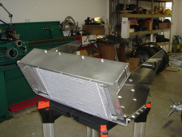

It has been a while since I posted an update. I have been spending my time makeing sub assemblies so I thought I would post a few photos..........

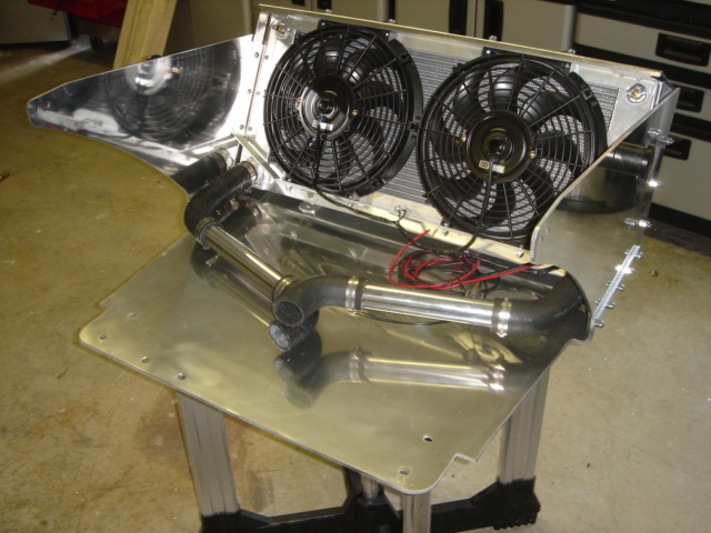

I took Chuck and Ryan's lead and made brackets for the fans and a cover for the radiator and AC condenser.

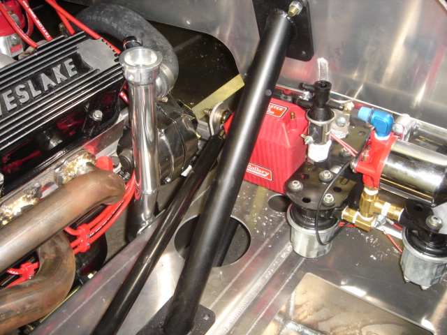

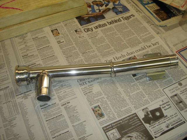

I have also been working on the other end of the cooling system. Unless I can't make it work I do not plan on using an expansion tank in the system. I plan on using only a coolant recovery tank that will collect the coolant as it expands and flows past the pressure cap and siphon it back into the system as the coolant cools back down.
I have attached photos of the coolant tube I fabricated.

#18
Keith:
Radiator / fans looks really good. That is a great shine.
Do you plan to add rubber washers / spacers between the radiator and the suport bracket?
Chuck
#19
Tom,
Thank you, it actually looked better before the fingerprints......... I did learn a valuable lesson about buffing outside in the summer in Alabama. The rouge does not stay in it's original bar shape if it sits in the sun.
Chuck,
I did buy rubber washers but elected not to use them after running the fan with my old Harley battery. Running the fans at full speed produced little or no vibration, I did not run them thru the full range of speeds to see if I could find a resonant frequency so I may still have to go back and do some vibration isolation if I see a vibration during actual use. Adding the top cover (as I copied from your build) really added rigidity to the fan structure and made it very robust.
