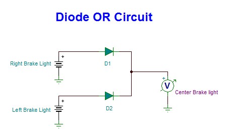

Hurley,
A "Diode OR" circuit is a simple digital logic circuit. It has 2 (or more) inputs and one output; When one or the other of its inputs get a voltage, its output puts out a voltage. If none of its inputs gets a voltage, its output is zero.
Here is how it works: L & R brake light OFF = C brake light OFF
L brake light ON & R brake light OFF = C brake light ON
L brake light OFF & R brake light ON = C brake light ON
L brake light ON & R brake light ON = C brake light ON
I didn't have a symbol for a light bulb but I hope this diagram helps. The individual diode types are not too important, just make sure they can handle the current required for your center brake light. The voltage rating is insignificant since this is only a 12 volt application. Diodes power diodes are rated from 50V up to 600V so get whatever is cheap & available.

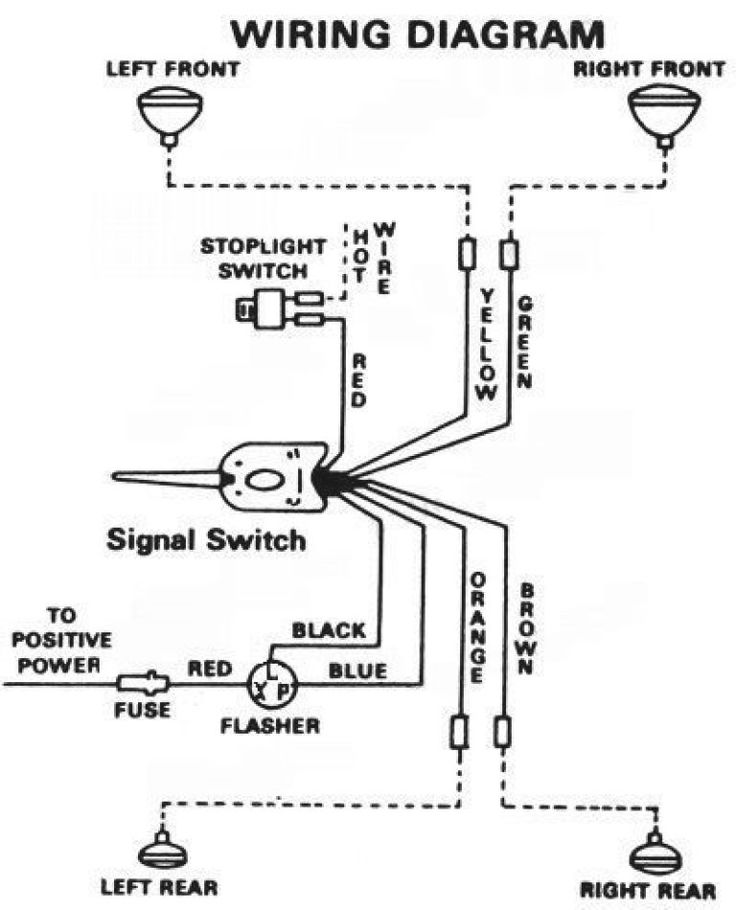

In this example, just connect the 3rd brake to the red wire.

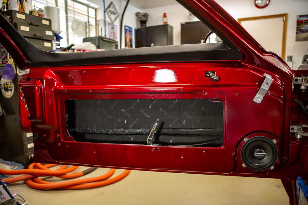

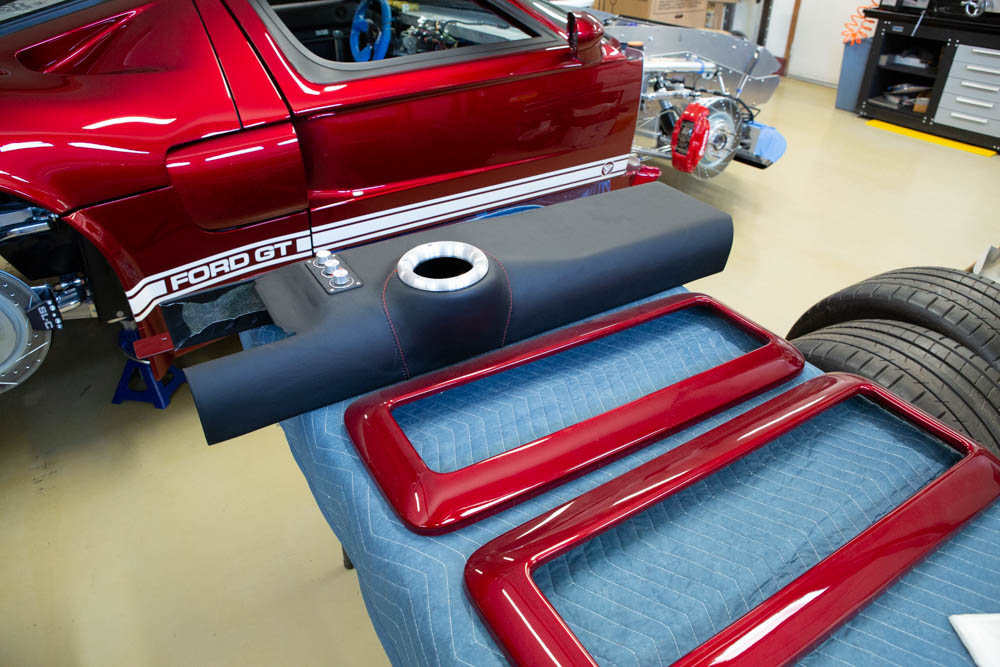

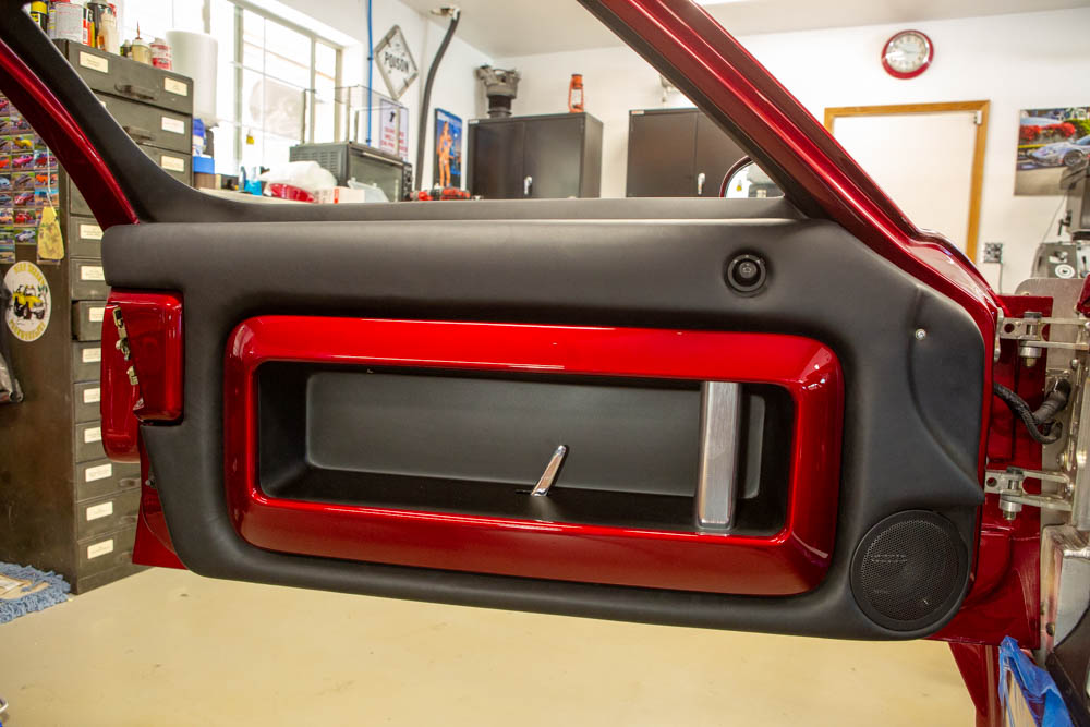

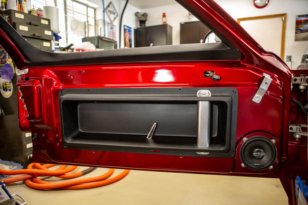

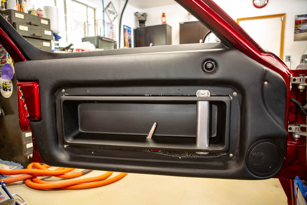

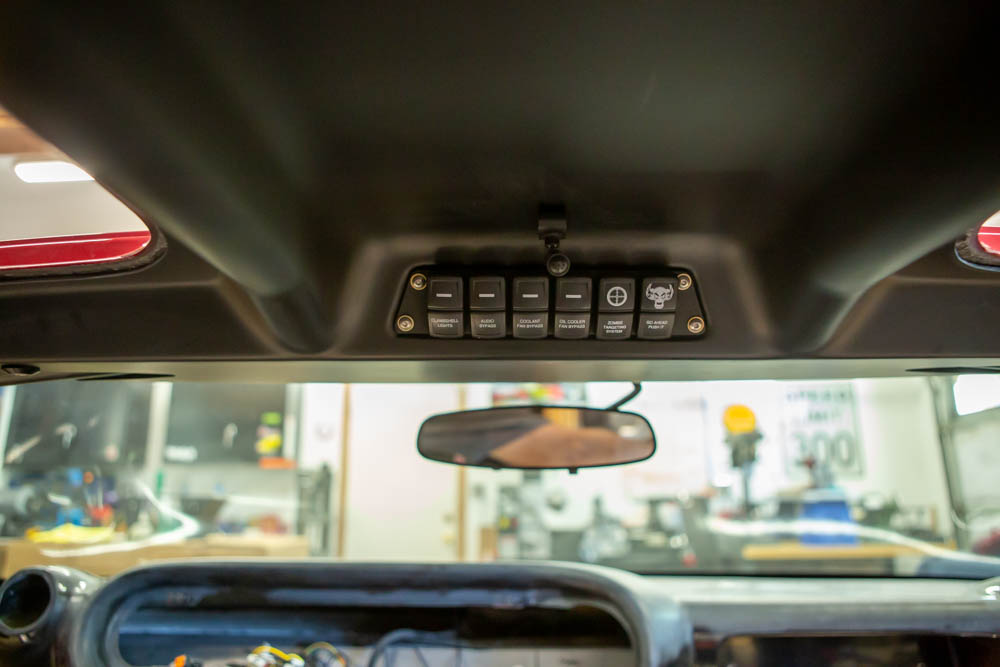

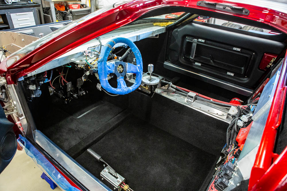

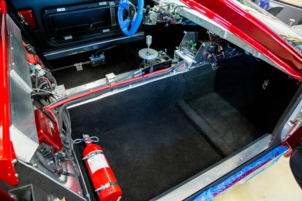

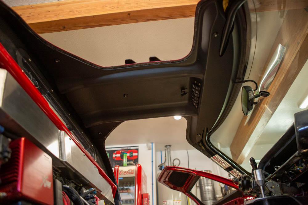

Finished assembling the doors except for the red trim (install after the seats are in) and the windows. The overhead piece and switch panel are in including the wiring to the rear-view mirror lighting. Second Skin soundproofing has been applied to the floor and sides and the carpet has been cut and glued into place. The center console is ready for install but waiting for the dash to be upholstered (hopefully by the end of next week).

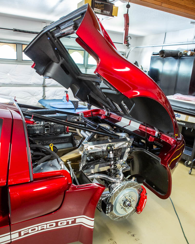

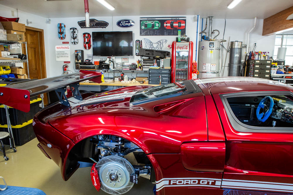

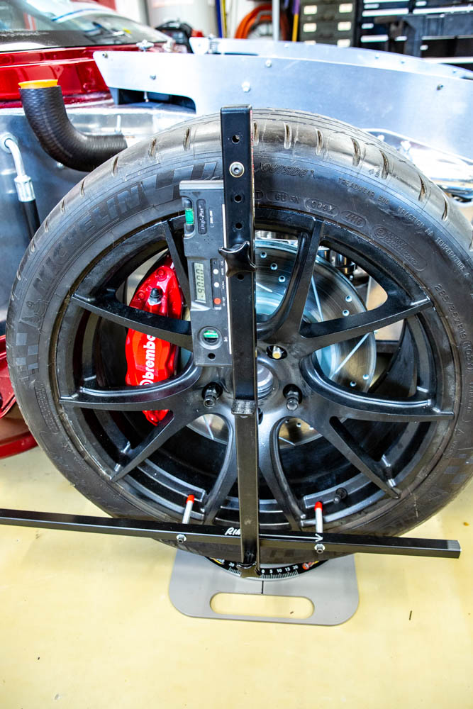

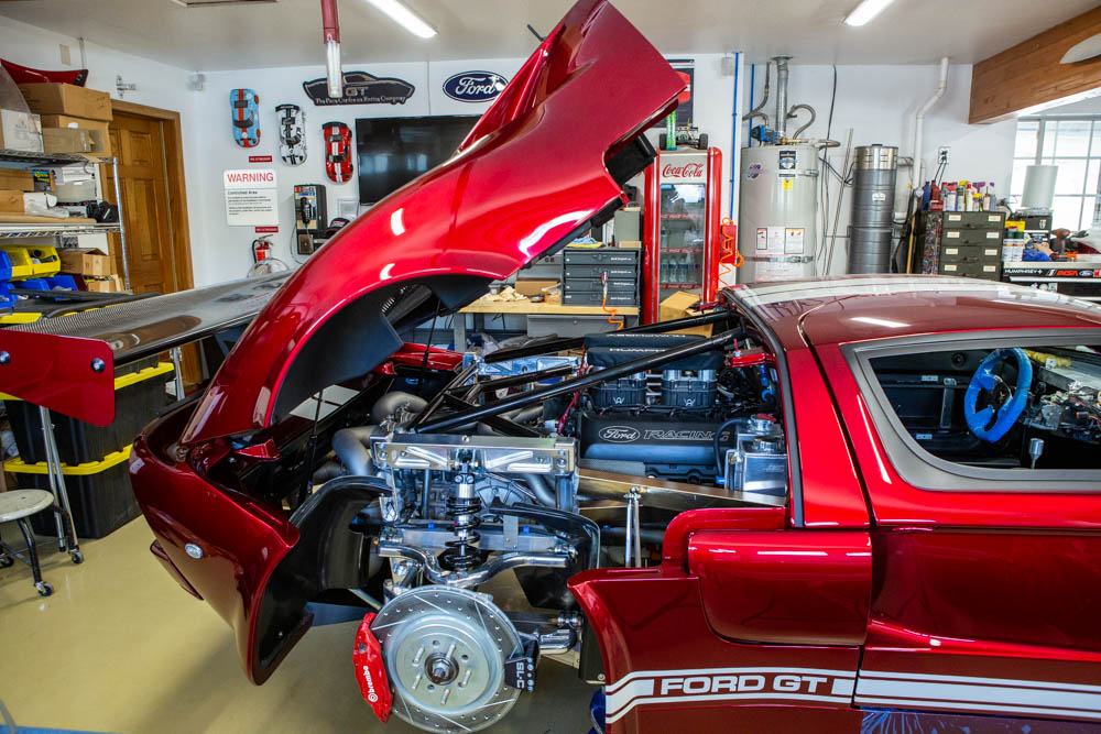

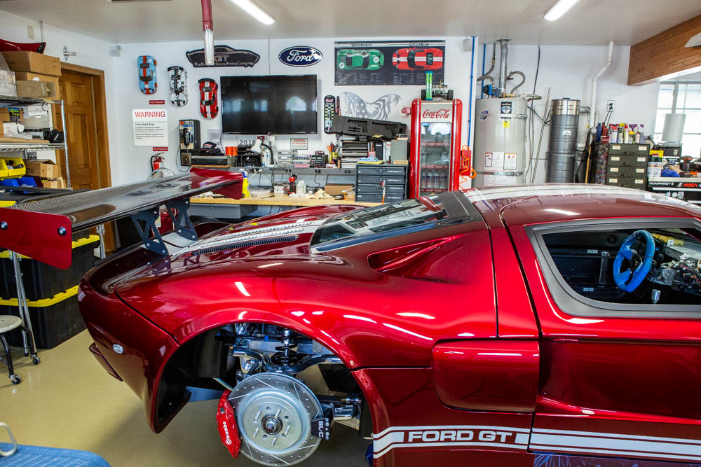

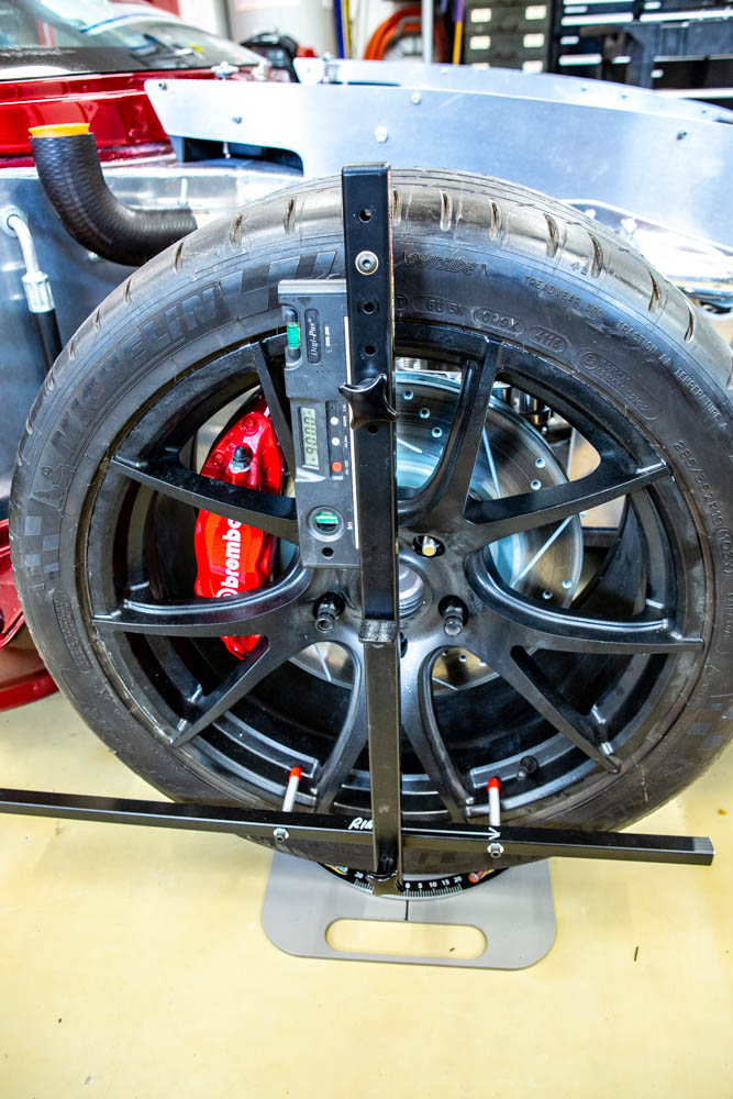

There are a few things I must do before final assembly like front wheel alignment. In post #256 I modified the front suspension to remove the 1-1/2” wheel spacer but neglected to check the alignment. I used a Quick Trick alignment tool, followed their directions, and took my time. I used the SLC recommended settings for CASTER, CAMBER, and TOE-IN.
- For caster, the SLC recommended settings are Min: 4°, Max: 8°, Preferred: 5°. Changing caster is difficult due to the modifications but I found the left/right side to be +7.80°/+7.95° so I called it GOOD.

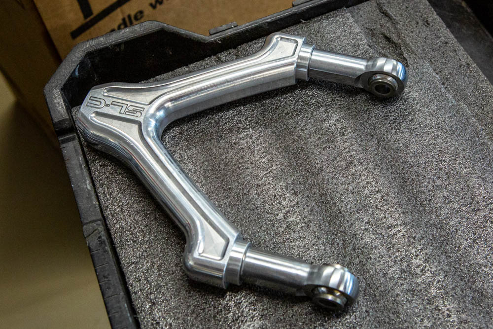

- For camber, the SLC recommended front wheel settings are Min: -0.3°, Max: -1.3°, Preferred: -0.8°. My initial was 2.78° and 1.80° left and right respectively, not quite Bosuzoku style but was noticeably off. I added spacers to the upper A-arm to chassis connections (see photo). I added 0.40” spacers to the left side and 0.20” spacers to the right and had a final camber of -0.8°/-1.0°.
- For toe-in, the SLC recommended front wheel settings are Min: 1/32”, Max: 1/8”, Preferred: 1/16”. My total toe-in is 1/8”.
