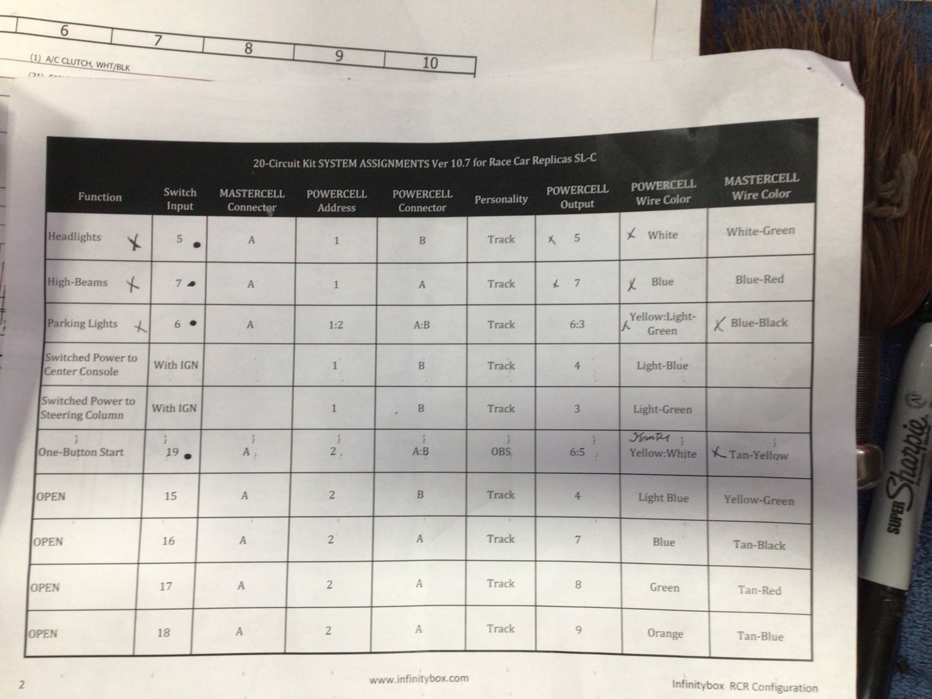

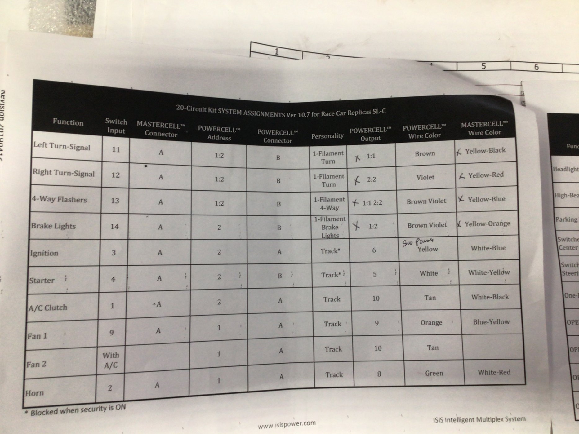

Kurtiss here are my system assignments that came with my kit I thought maybe you can compare them to yours and see if they are the same

Hi Larry. Those are the typical wire assignments for an SLC so I made a few changes for my GT-R. My wiring schematics are based on changes to the wire assignments shown in post #136.

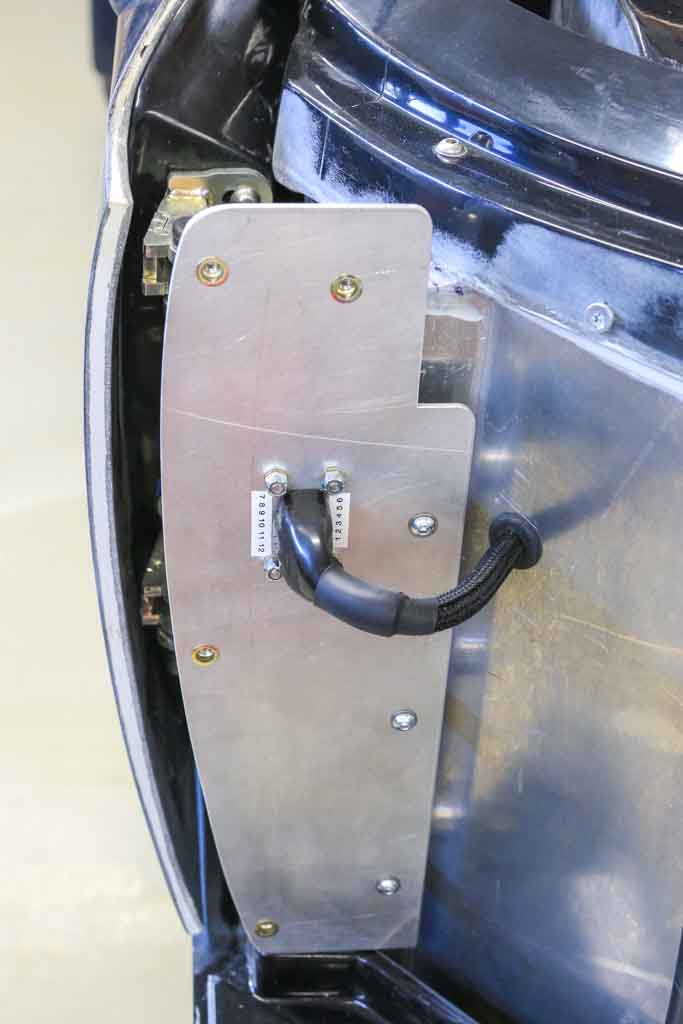

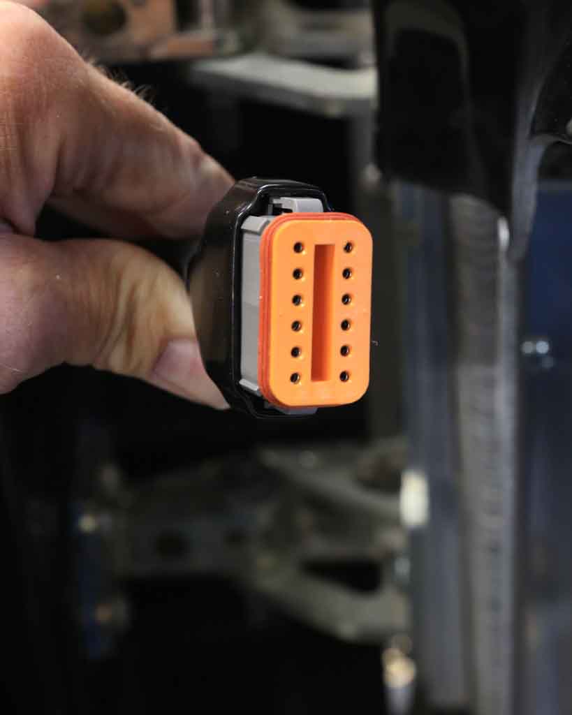

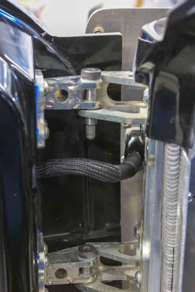

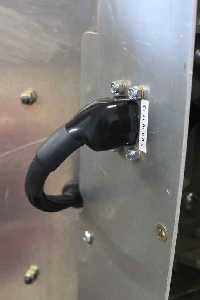

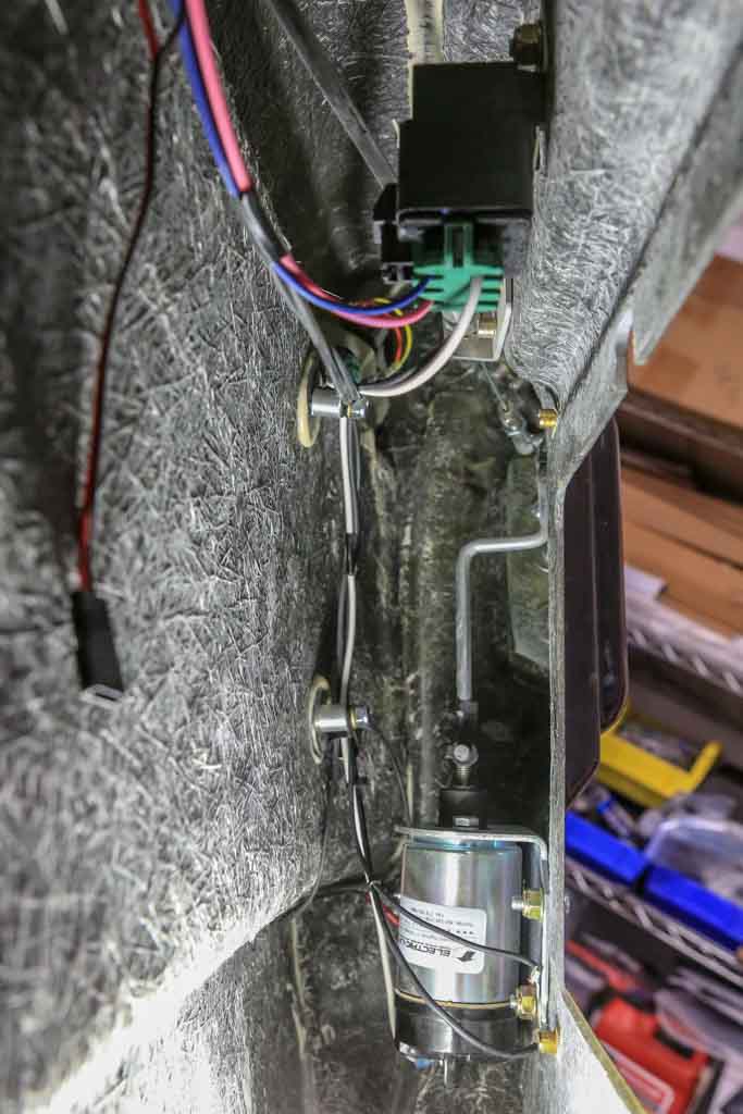

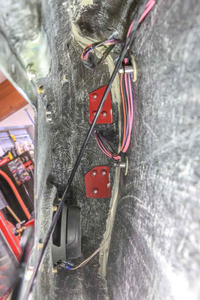

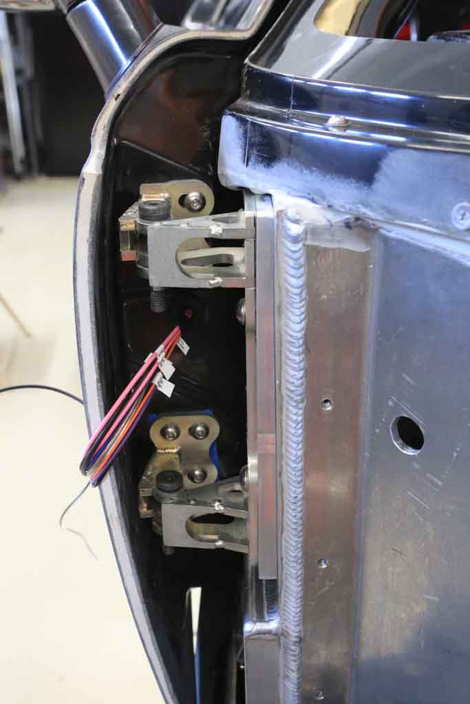

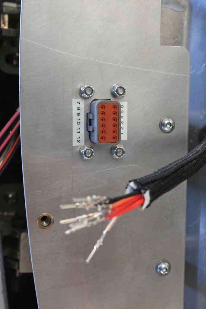

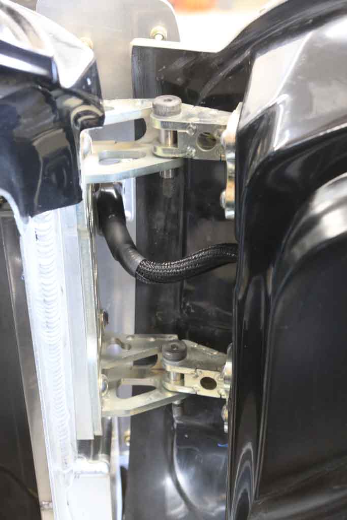

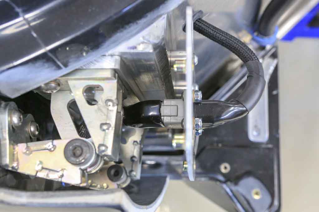

Finished the passenger door mechanical and stumbled into the electrical stuff. Since I decided to use a switch and solenoid to open the latch mechanism, I also installed a relay within the door and a door-jam switch for interior lights (see Electrical Schematics, post #280, schematic page 15, 16 & 17). For the driver’s door there are 12 wires (5 for rear view mirrors, 3 for door lock, 2 for speaker, 2 for interior light). To help secure the wiring I installed 5 click bond type standoffs. I used a 12 pin Deutsch flange connector at the door to chassis interface and ran the wires directly under the upper door hinge pivot. The passenger door requires 10 wires.

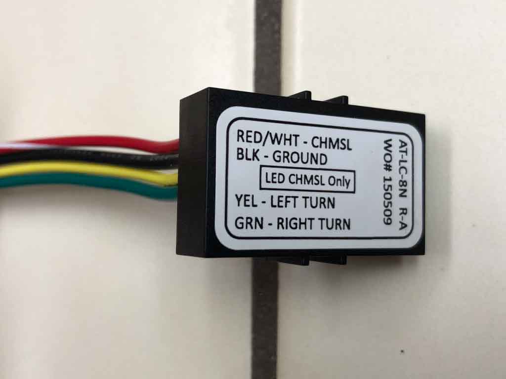

I made a modification to the wiring schematics in post #280 for the Center High Mounted Stop Light (CHMSL). I found a neat little gizmo (technical term) for a diode circuit that connects to the left and right stop light/turn signals and correctly powers the CHMSL. Found it on Amazon. Very simple to install and given the low stance of the GT-R, the CHMSL is an added safety item.

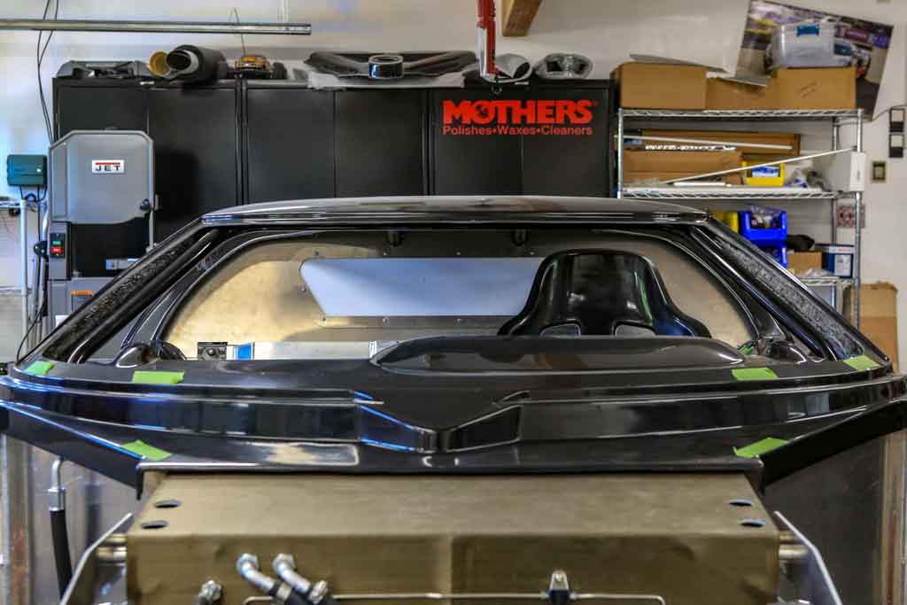

I'm installing a 3rd Brake Lamp P/N GM559-B0000 (fits a Chevy Blazer and H2 Hummer).
Now the question is; where am I going to install it? The original location is at the upper edge of the rear clamshell window. My friends say it will take away from the mold line of the car. They want me to install it under the clamshell at the upper edge of the window. You'll be able to see the light through the window but it will be "hidden". I tend to agree but the light may highlight dirt when illuminated. Trial and error...
Steven Lobel
I had mine below the Gurney flap. H said move it up top. A low car is hard enough to see. See pics in my thread. Barely noticeable. Bought off Amazon for a Suburban. Under $20

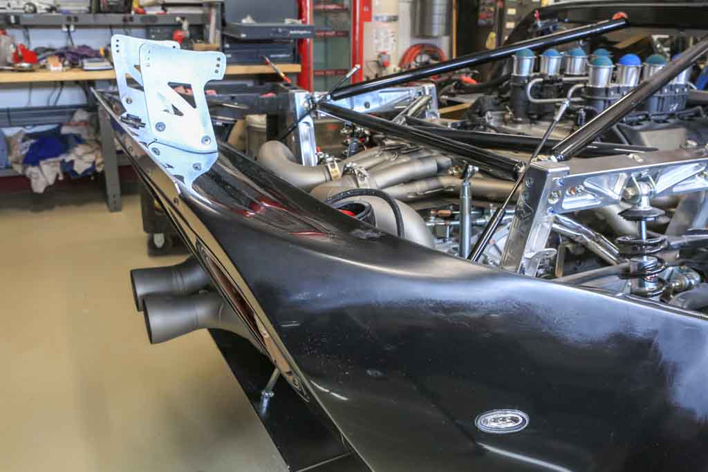

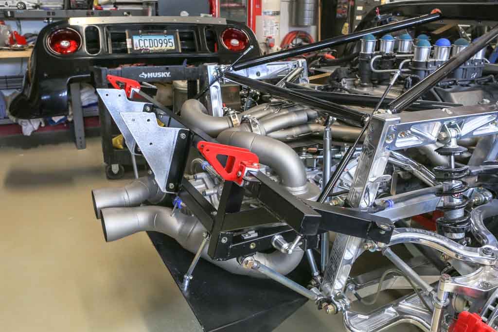

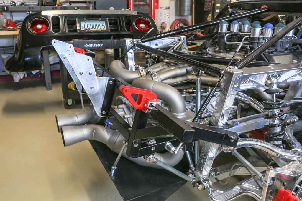

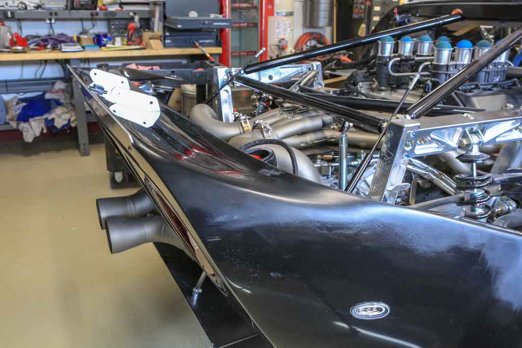

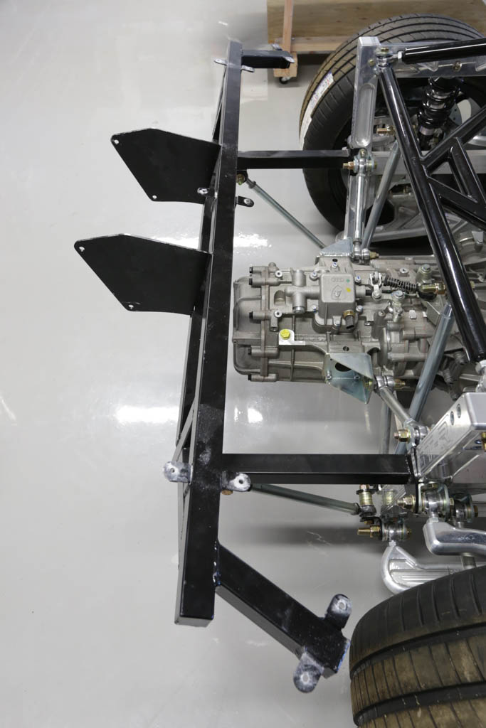

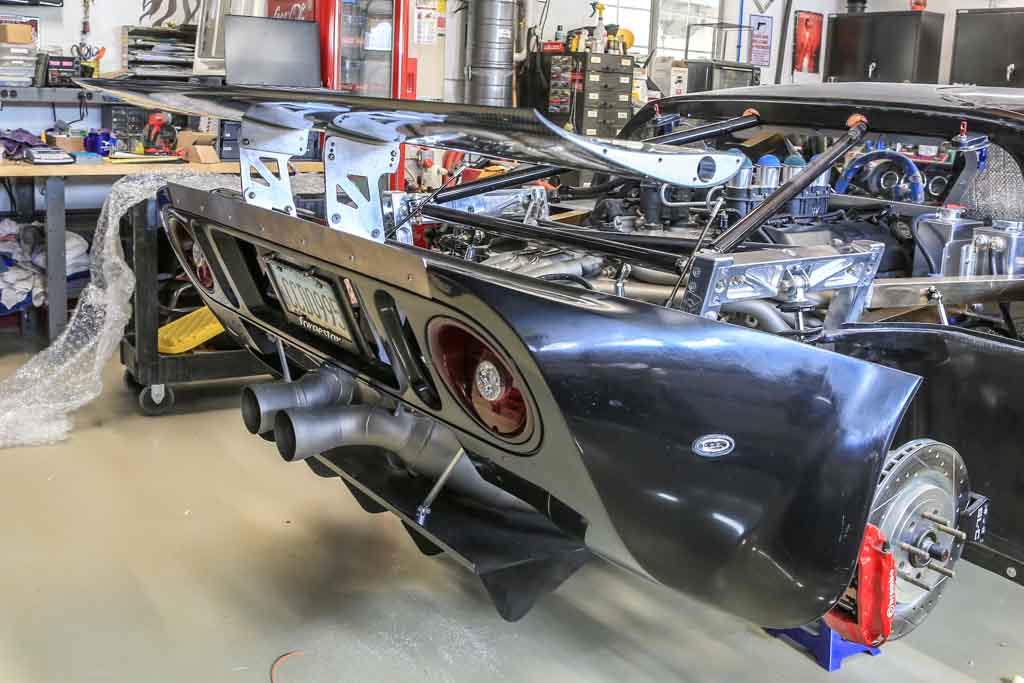

Rear Wing Attachment - Why did I opt for the rear wing since I don't plan to race the car? Because it's fun, it's a built-in table top to eat your lunch on, and it looks cool!

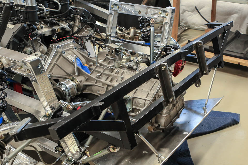

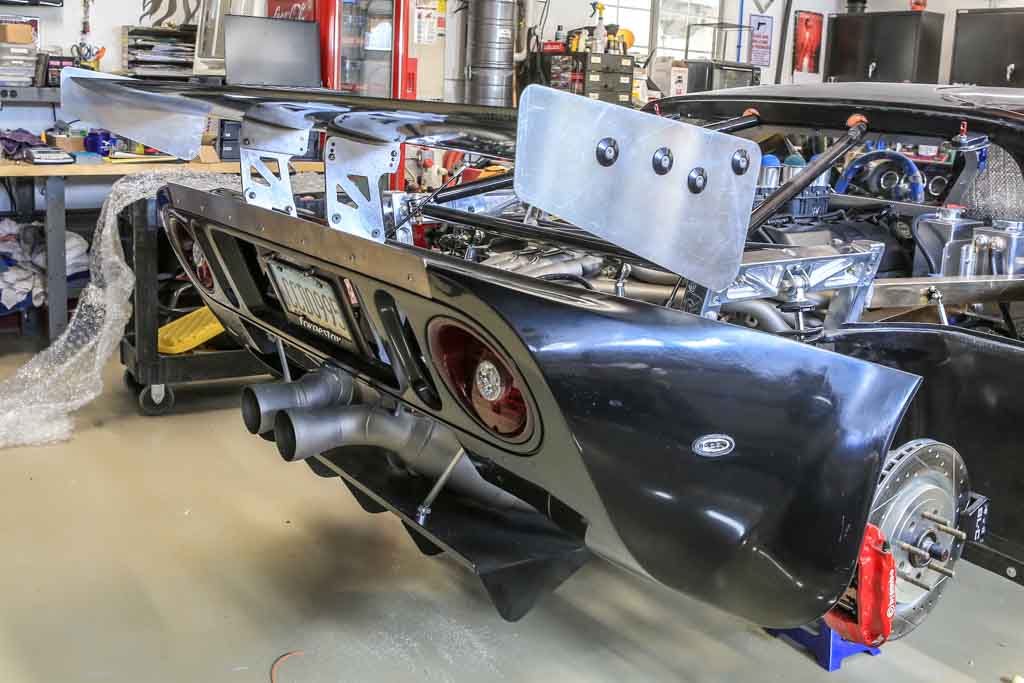

So the rear frame member came with wing strut mounting plates as shown. I didn’t like this design and removed the plates and welded angle steel to the frame. The wing struts are made from ¼” thick, 6061 aluminum. Each strut has three sections; one section attached to the frame member, another penetrates the rear clip and the last attaches to the wing (I may combine the latter two in the future). I added multiple layers of fiberglass to the underside of the rear clip for strength before cutting slots for the struts. My rear clamshell is hinged using H’s hinges and “yes”, the clamshell can fully open without interfering with the wing. The wing can be removed in a few minutes and the open slots can be covered if desired.
I positioned the wing so the chord is -8° (the bottom of the wing tab is at -5°). At this chord angle, the forward top section of the wing is almost flat (a good place to hold my beer). I don’t plan to race the car so the end plate design is off-the-cuff but I did account for the greatest low pressure area that is located just aft of the wing leading edge.

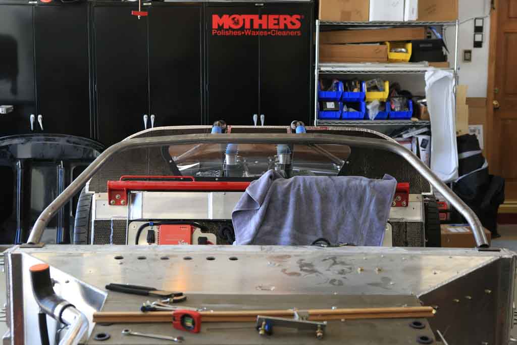

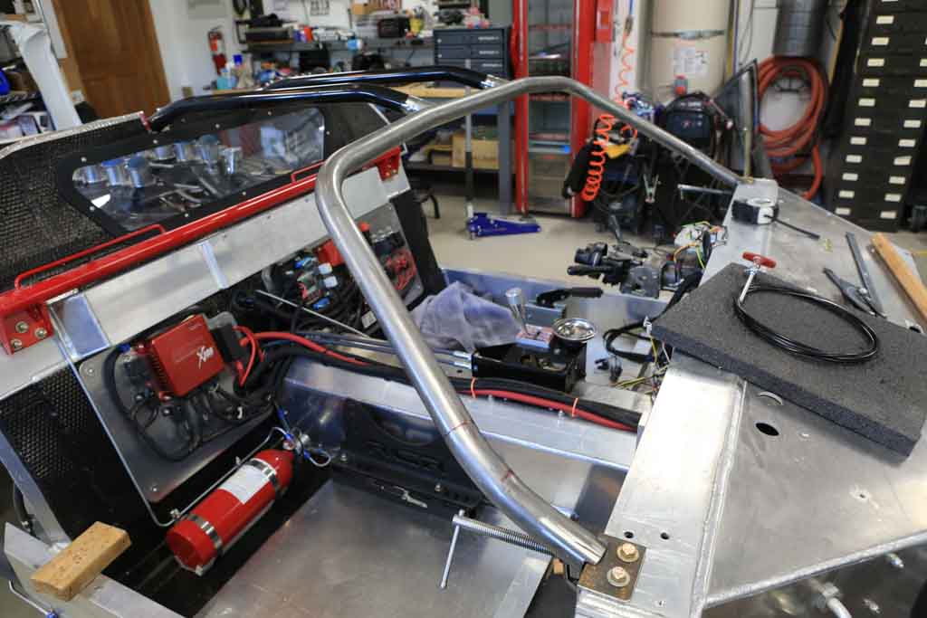

Windshield Rollbar – I did this last August before going to H’s.

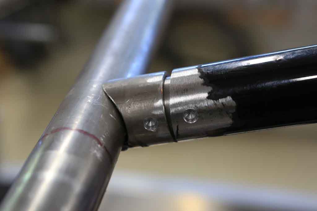

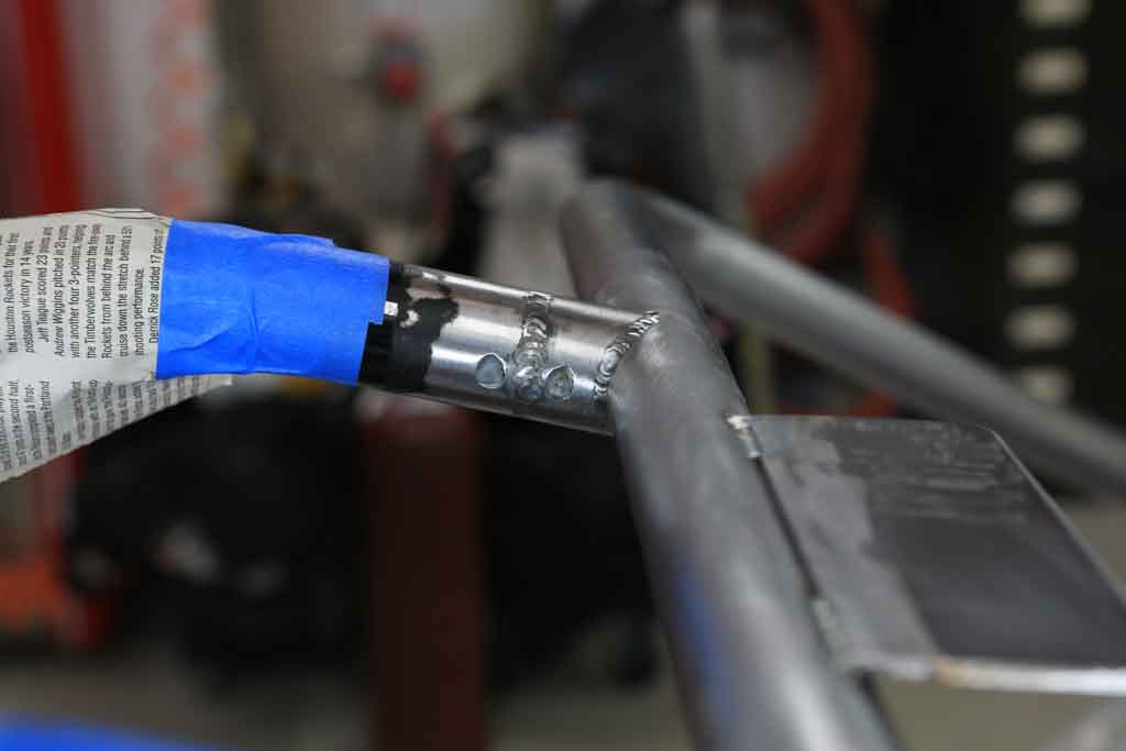

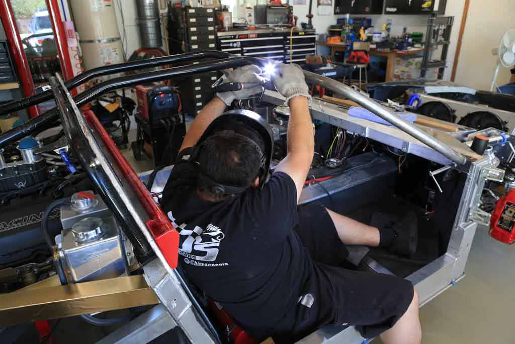

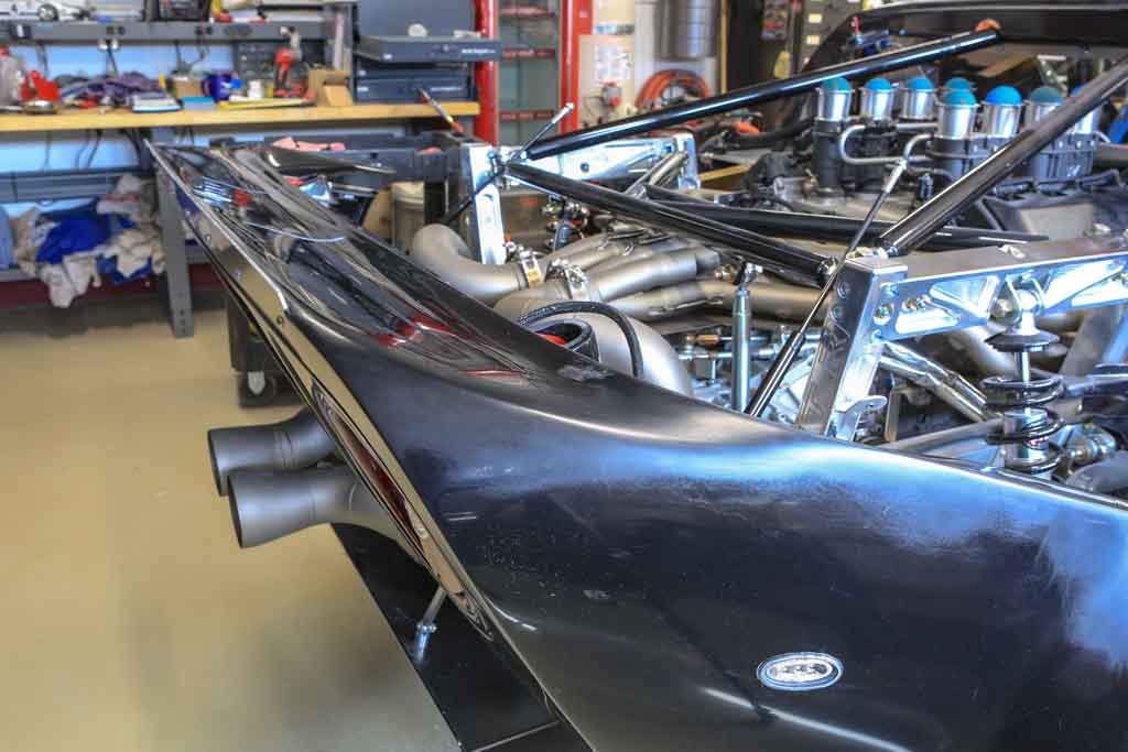

There’s a lot of space between the windshield rollbar and the A-piller. So, like others, I decided to take the plunge and replace the bar with a wider one. I purchased 10’ of 1-1/2” diameter, .120” wall DOM tubing. After a few bends here and there, my friend of BJ’s Racecars did the welding. It fits so much better.
During the fabrication, I added more space behind the rollbar to allow room for the overhead switch panel. I’m using rocker type switches that are deep and need room for the wiring. The flat plate in front of the rollbar is to mount the GPS antenna's.

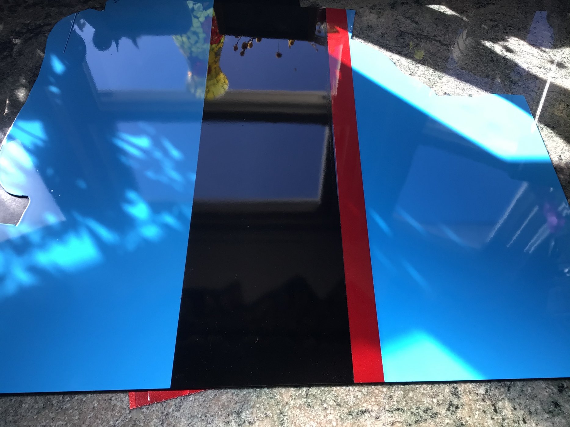

Ah yes I am in the same boat but once I get the honey do list done I get to work on the wife’s 1970 Chevy Chevelle I am going to put all new Air Ride Suspension Tubular Control Arms 4 wheel disc brakes take out the 396 Big Block and put in a nice LS3 and overdrive Transmission so she can go anywhere she wants with no headache. Here is my paint scheme Alan will be doing he picked up the car today. It will be dual Black stripes with the soul crystal red in the middle
