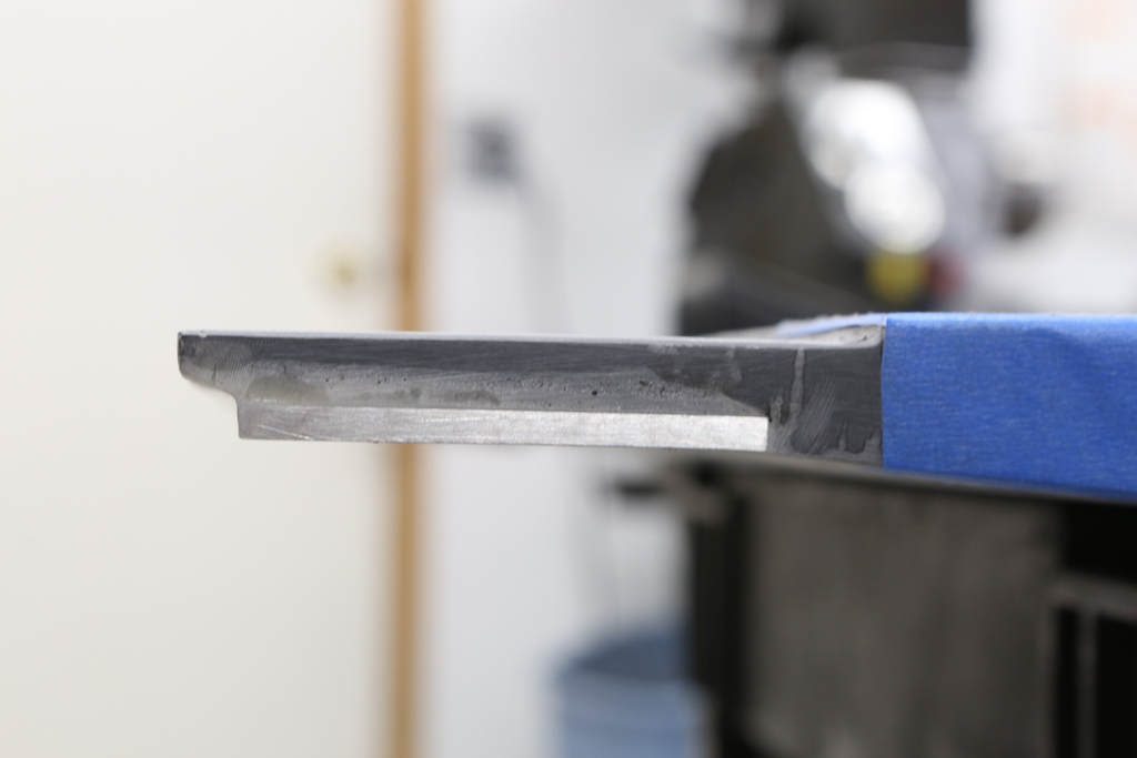

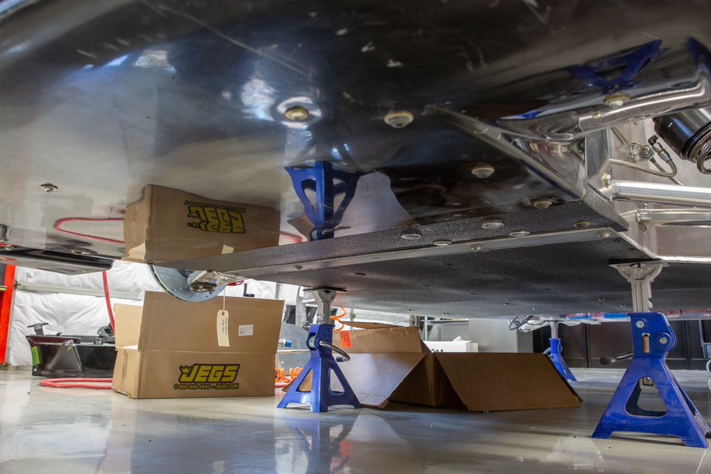

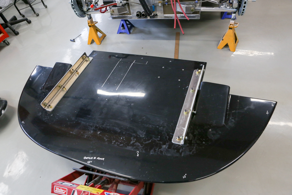

I decided to raise the front splitter to improve the stance and/or gain an extra 1” of ground clearance. H supplied some great information on suspension mods for after the splitter is modified.

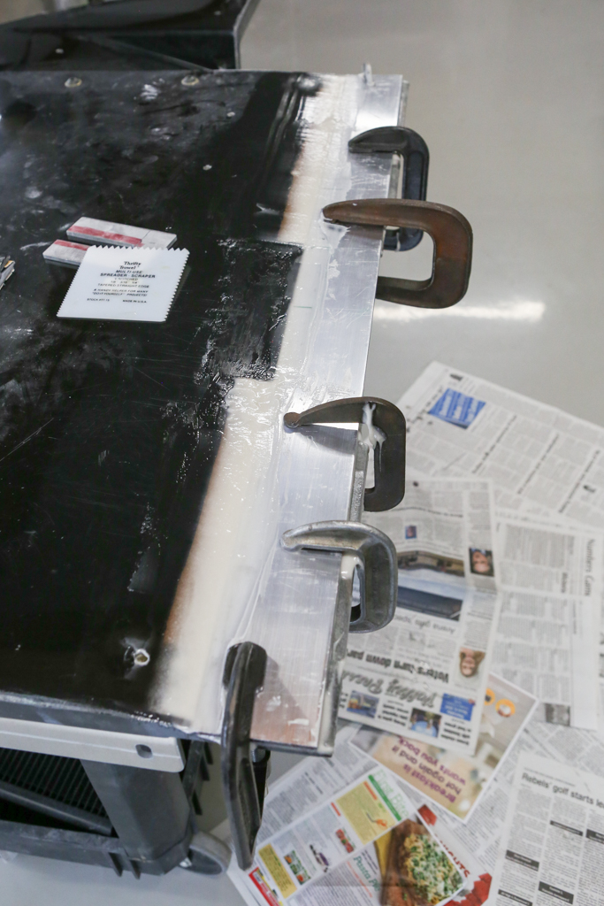

I haven’t worked with fiberglass so this was a new experience and so far, it’s been fun. First, I measured and marked the location of the front clip, radiator, heater and brake lines then disassembled the front end.
The splitter was modified to provide a flat surface when bolting it to the chassis lip. The bottom surface was ground flat then multiple layers of fiberglass where applied for strength. I then bonded a 3” wide, .2” thick aluminum strip to raise the splitter. Overall, the splitter will be raised 0.85”.
Next the vertical members will be cut and re-drilled, then the radiator and front clip install.

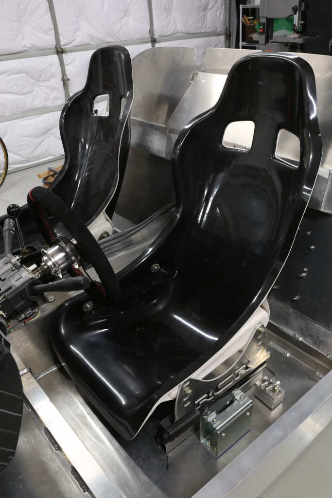

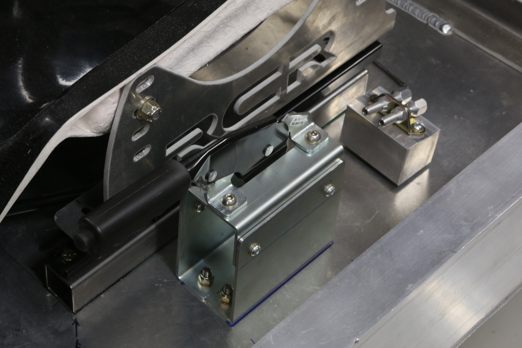

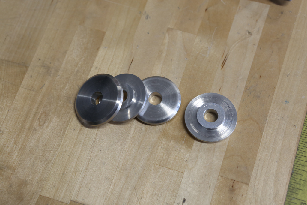

When waiting for the fiberglass resin to cure, I worked on the seats, fuel system and emergency brake handle.
The seats were raised 2 inches for proper eye height. On both seats, I used 1.5” square tubing under a Sparco seat adjuster. I machined spacers and epoxied them at the seat attachment points for added strength.

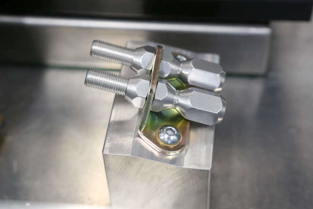

For comfort, I shortened the emergency brake handle brackets then bolted the assembly to the floor. I machined a bracket for the cable support and will finish the install soon.

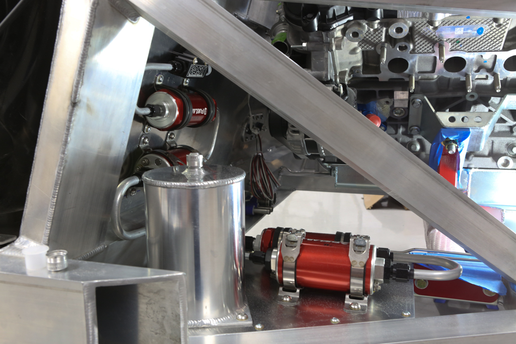

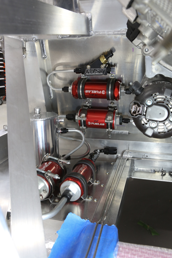

Kurtiss H.
Member

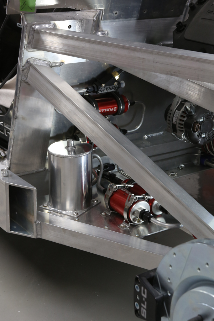

Attached is the diagram for the fuel system. I used hard lines between most items and will build flex lines for the rest once I determine the final routing.

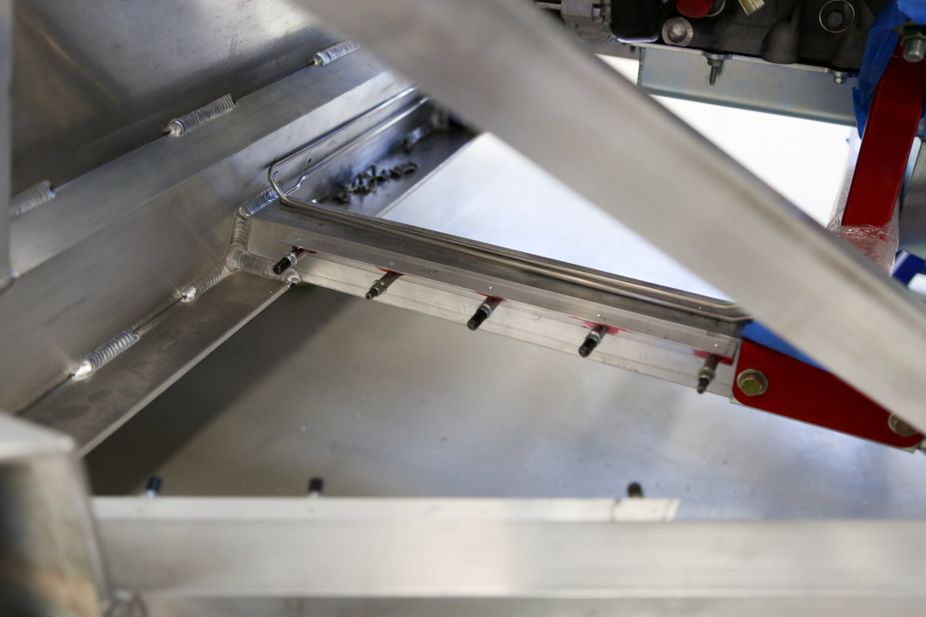

Kurtiss H.
Member

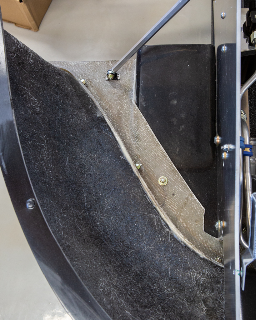

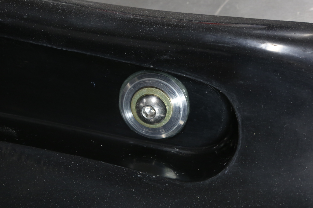

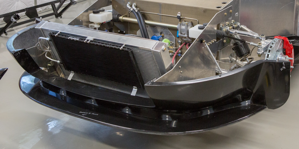

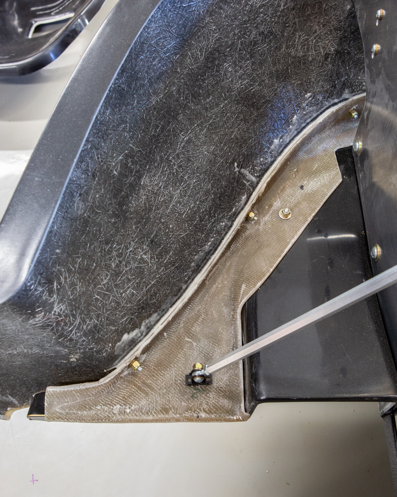

I completed the splitter modification. I had some left-over Raptor bed liner material and sprayed the splitter where it was modified. I also machined inserts and bonded them to the splitter for the battery tray fasteners to eliminate bolts/nuts from protruding too far below the splitter.
I then adjusted the lower section of the front clip to mate squarely with the front bonnet then bolted and bonded the lower section to the FRP retainer as shown. Now it looks nice and flat across the bottom of the chassis.
Then raised/installed the radiator after carefully checking the overhead clearance and reinstalled the AC condenser and lines. I discovered that the driver’s side forward most brake fluid reservoir will interfere with the front bonnet so I relocated it to the other side as shown.

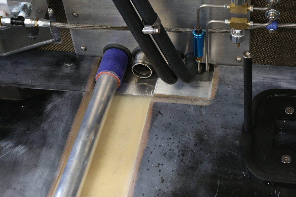

Kurtiss H.
Member

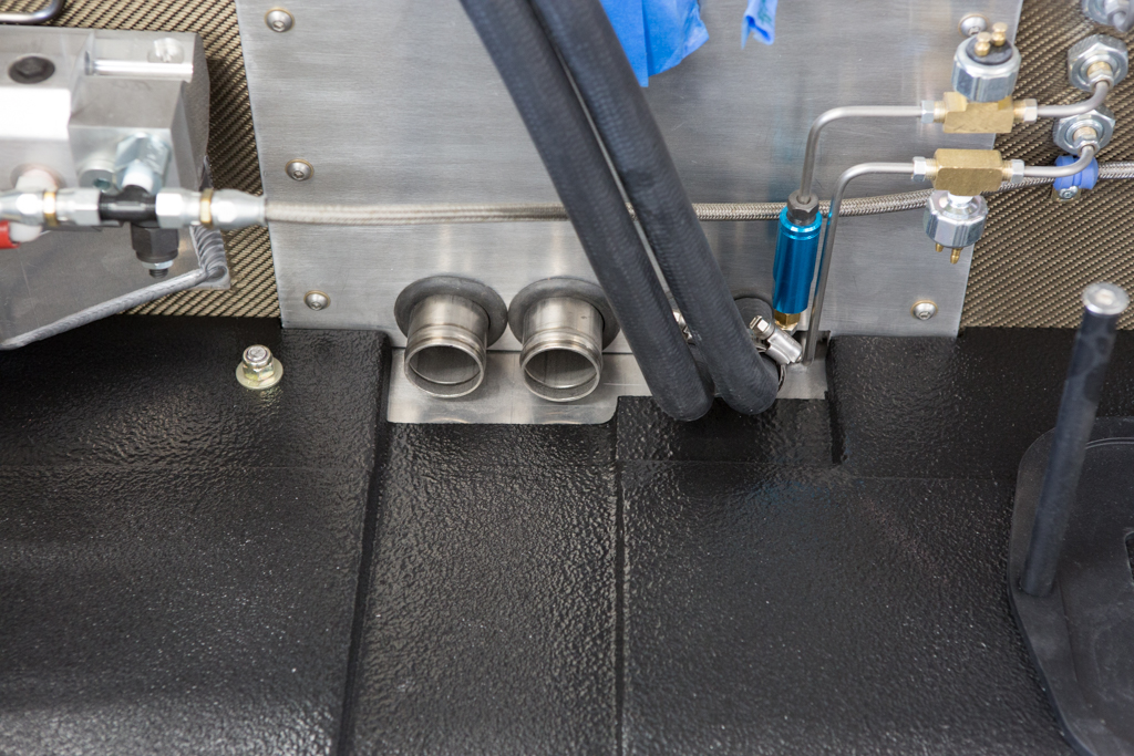

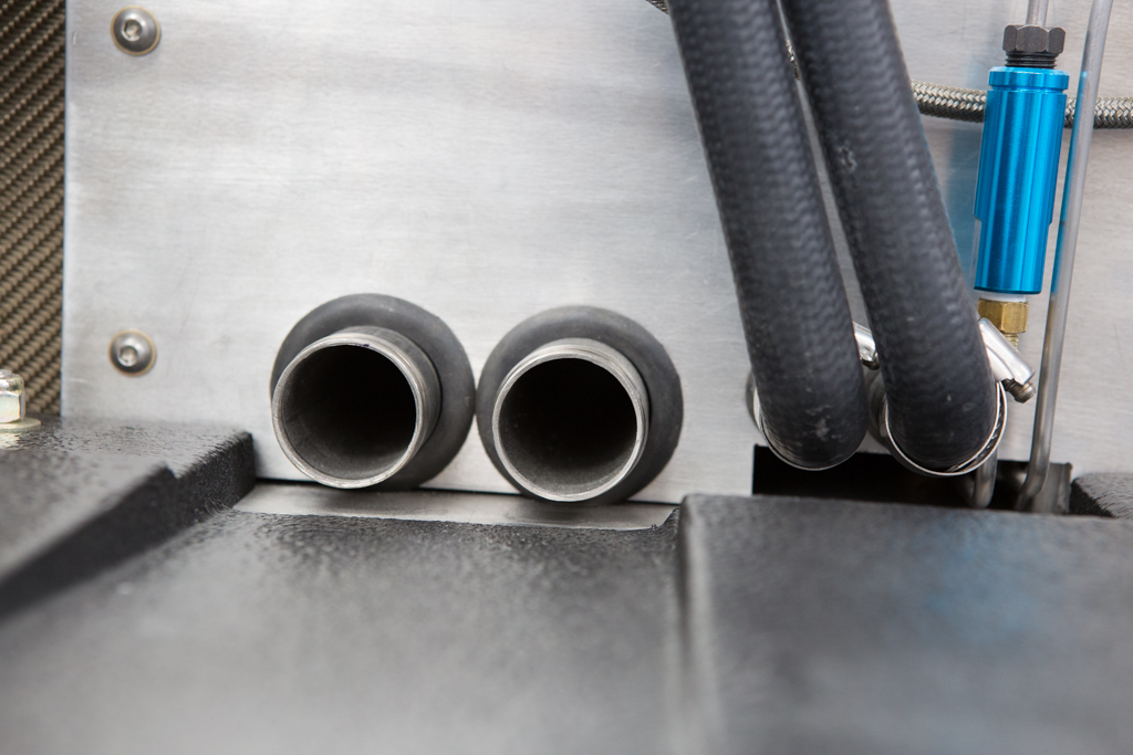

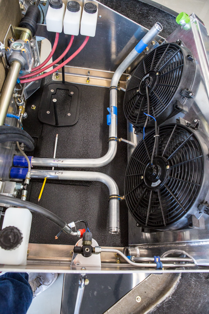

The splitter was modified to provide clearance for the coolant tubes. The 1.5” diameter aluminum tubing has been positioned and marked and ready for welding.

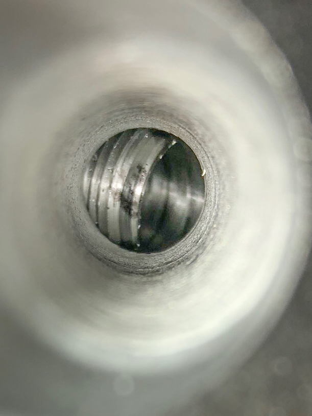

Kurtiss H.
Member

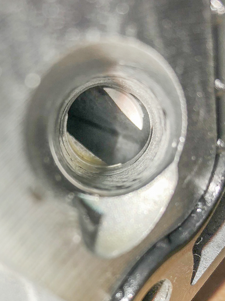

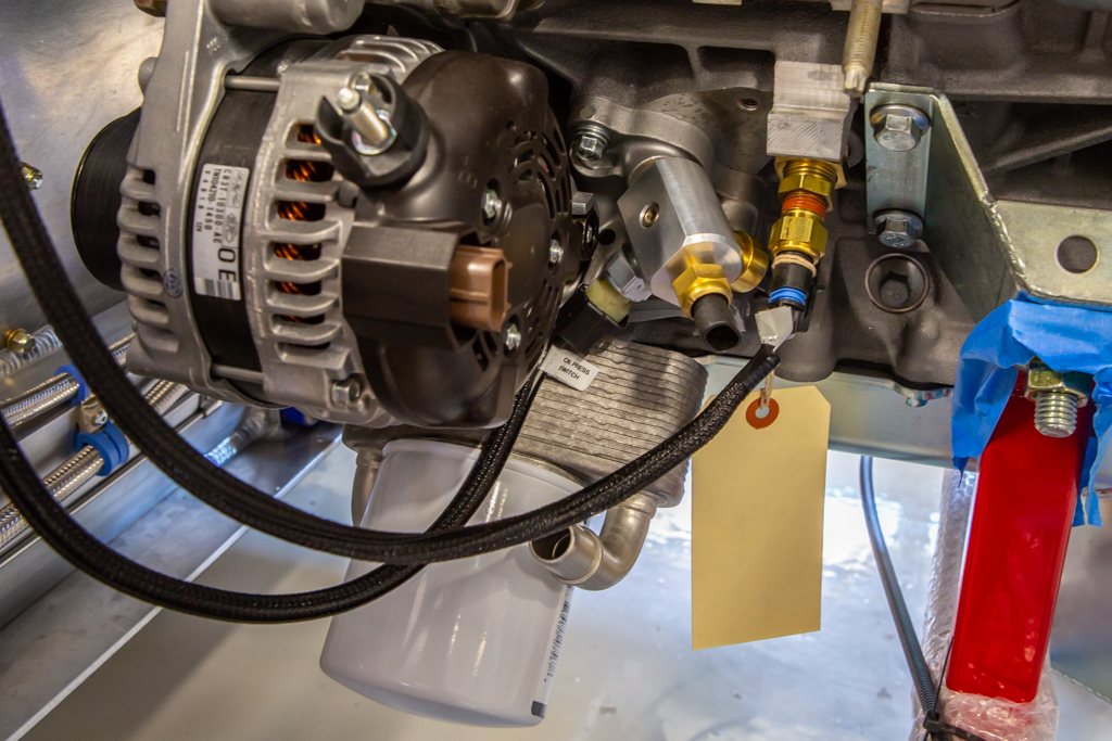

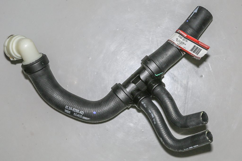

Oil Cooler - Two ways to go; 1. Install a separate oil cooler, remote oil filter and the Ford engine oil adapter all using -12 AN lines and fittings (as recommended by Ford), or 2. Utilize the existing oil/coolant heat exchanger and filter that came with the Aluminator crate engine.
I was beating my head against the chassis until I ordered/received a remote oil filter mount and looked for a good out-of-the-way location. Well, there is none! Then, mounting an oil cooler in a location with good air flow with -12 AN lines/fittings would take up more valuable real estate so I decided to keep the original oil/coolant HX. I purchased a lower radiator hose from an F150 that has the oil cooler coolant line diffuser that I will use to plumb lines to the oil cooler. Should be clean and out of the way. I’ll post photos when I get to that point.
Warning: The stock oil filter/cooler adapter may restrict the oil flow. The last two photos show the adapter passages from the engine side. You’ll notice the threaded pipe (that holds the oil filter and HX) extends well into the oil passage. I machined down the pipe to provide better flow. Also, the other passage had restrictions due to the way it was machined. I used a Dremel to open up and smooth out the area.

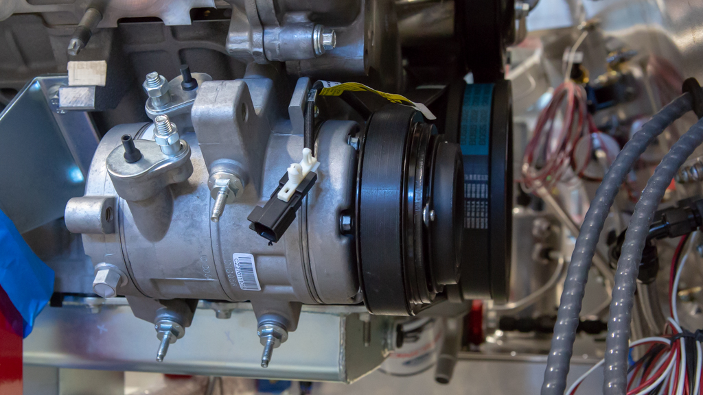

The Vintage Air system that comes with the kit includes a Chevy LS type AC compressor. Many builders have adapted this compressor to the Ford modular 5.0 and 5.2 engines but I opted to install a stock compressor for a simple and clean installation. This is a tricky install since there is no belt tensioner or compressor adjustment. The belt will stretch and keep the proper tension once installed. Need to follow the factory Mustang workshop manual for installation instructions.
Note: Vintage Air has all the pieces/part numbers for a bracket to install the LS type compressor but they will not sell the individual pieces, only a whole kit including the PS pump and compressor. Very poor customer service.

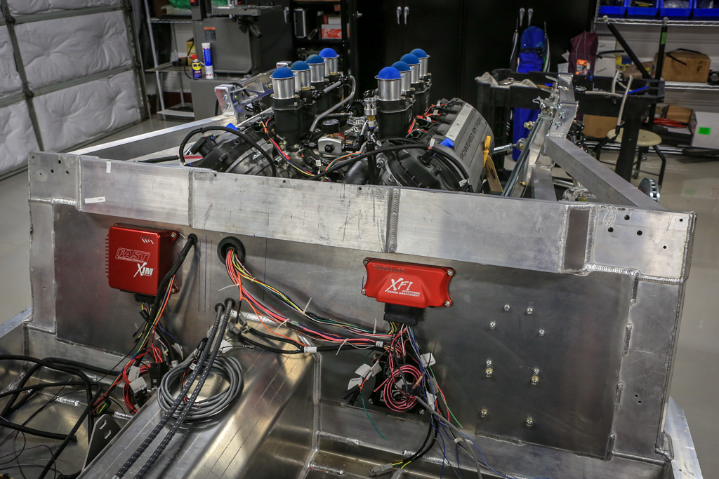

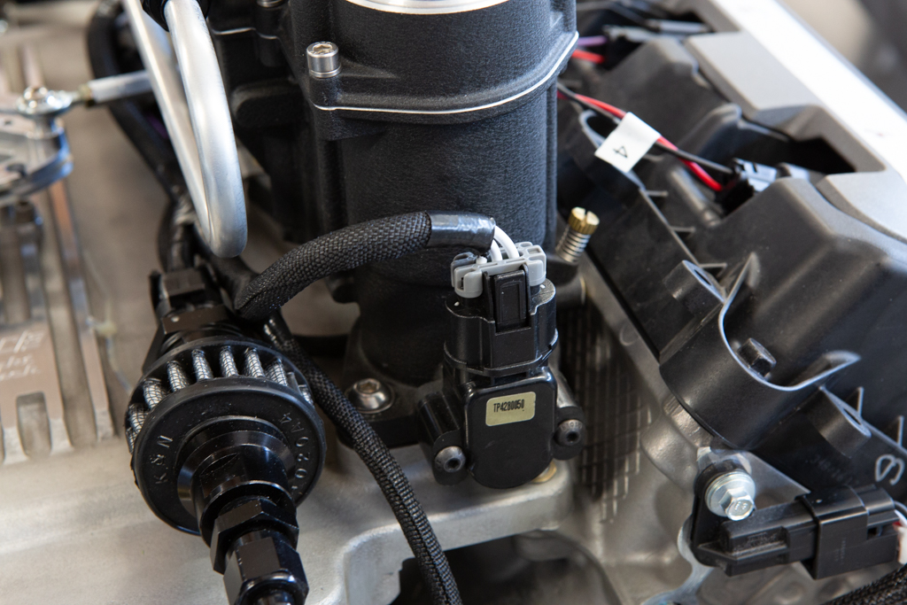

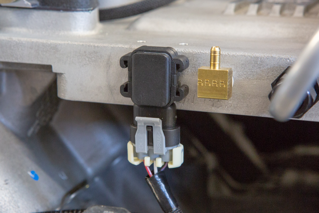

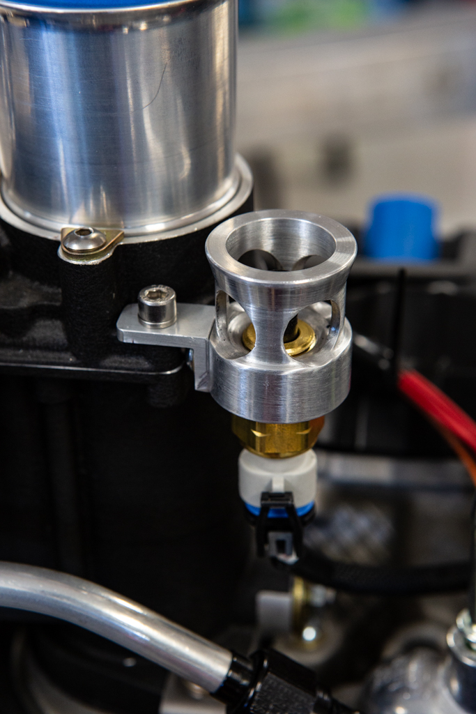

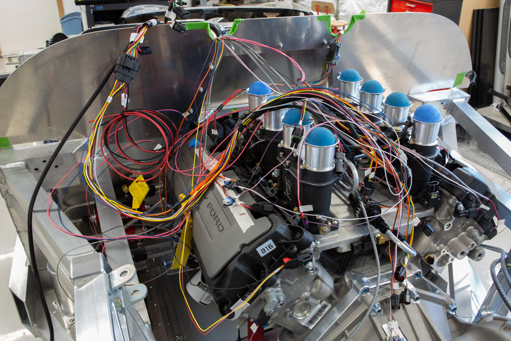

My Borla induction includes the FAST XIM (ignition module), XFI (fuel injection) and VTC (valve timing controller) control units and 5 wire harnesses (a total of 32 connectors). I installed the controllers on the forward side of the firewall behind the seats. Due to possible RF interference, the XIM module was mounted 18” away from the XFI and VTC modules.
Since this system was designed for a front engine car with multiple options, the wire lengths were too long and some connectors were not needed. The photos include the Air Temp sensor, Manifold Air Pressure sensor, Throttle Position sensor, and Idle Air Control. I’m currently working on re-routing, shortening and re-wrapping the wire harnesses and installing fuel pump relays.
