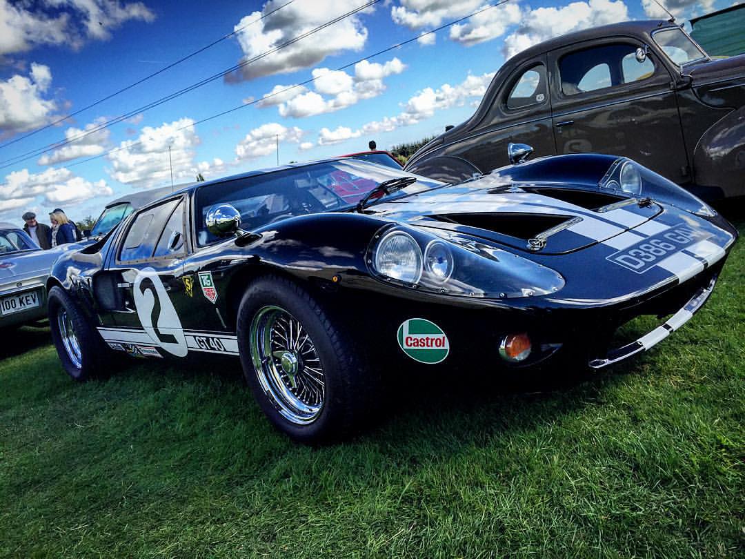

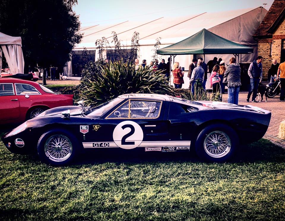

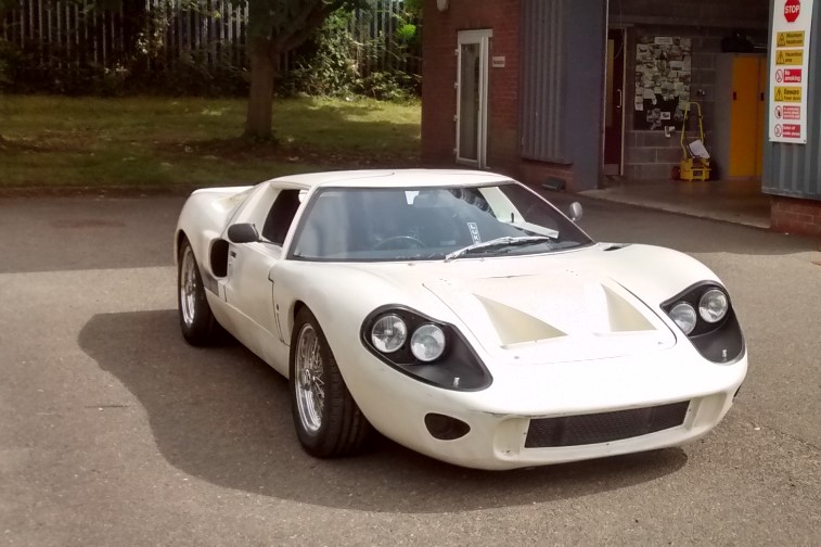

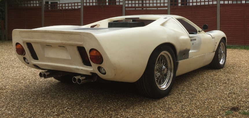

great to see another MK3 coming along, we are a rare breed, the car looks fantastic, what colour scheme are you going for..... looks like your not far off an IVA??
I've attached a pic of mine... where in the Uk are you based??
keep up the good work

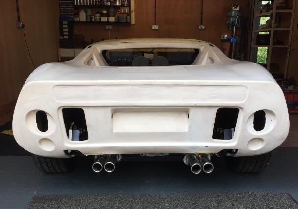

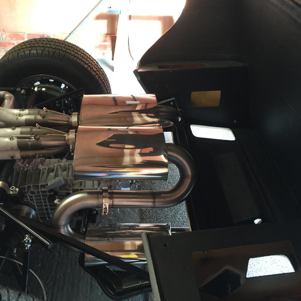

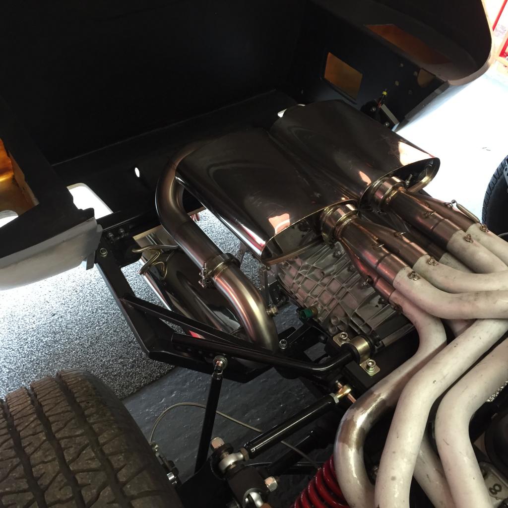

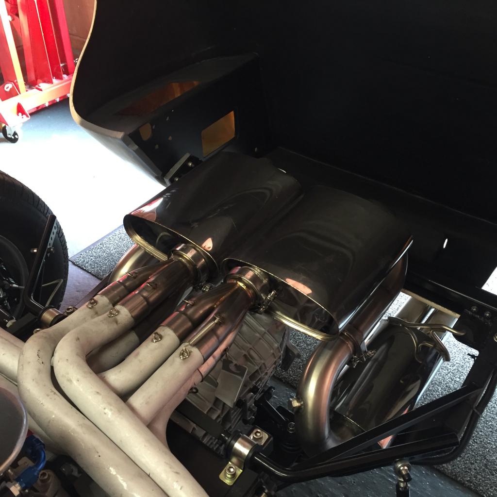

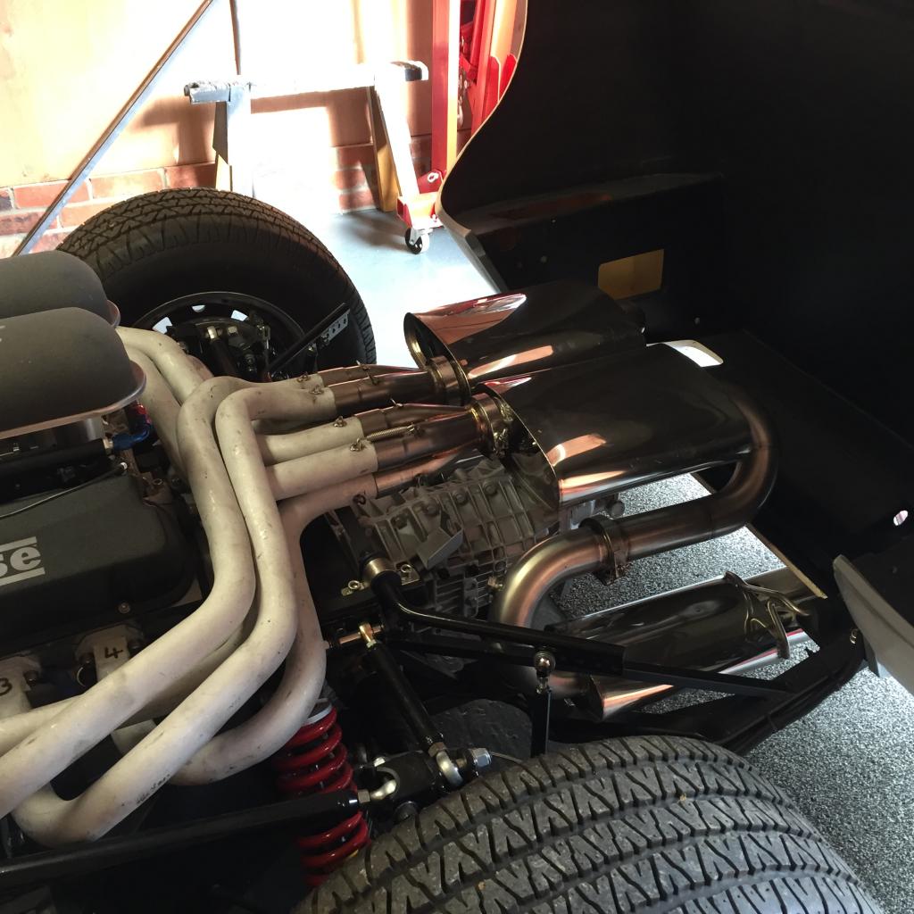

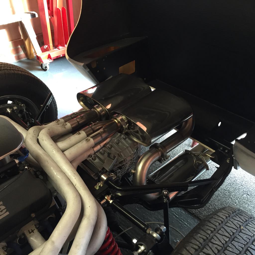

One of the latest purchases was to have some Stainless exhausts and silencers made. Made with IVA in mind so each bank has two silencers and nearly 5 feet of pipe work, but all sectioned and joined with V bands, so the top silencers could be bypassed later on if desired.
As mentioned previously the rear body work has been hinged so that the valance does not go downwards towards the ground as the clip is opened so that the exhaust could exit under the valance and have gone with two twin exits.
Both sides have built in ports, one side will house the wide band sensor the other will be for gas analyser probe when on rolling road.

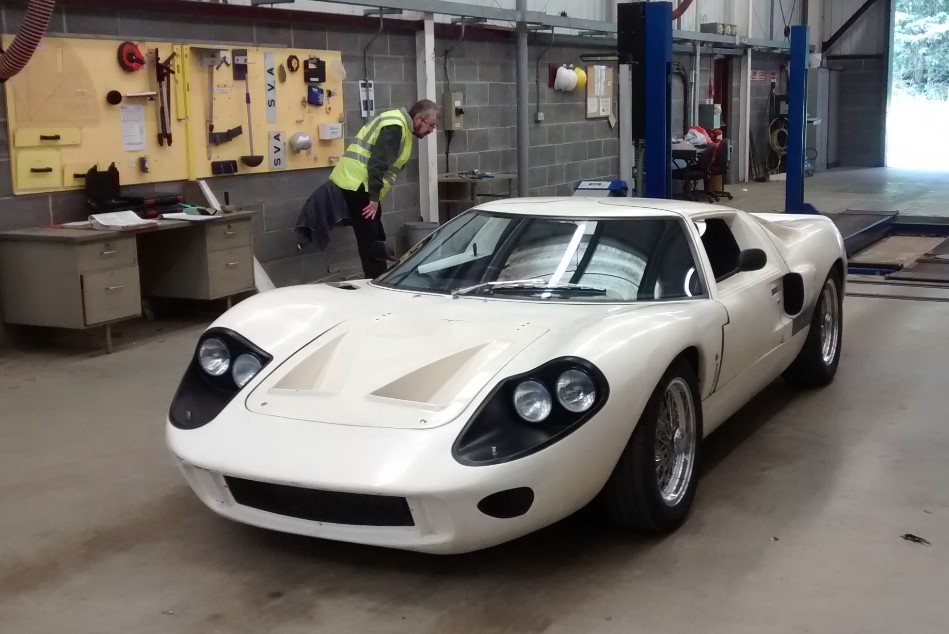

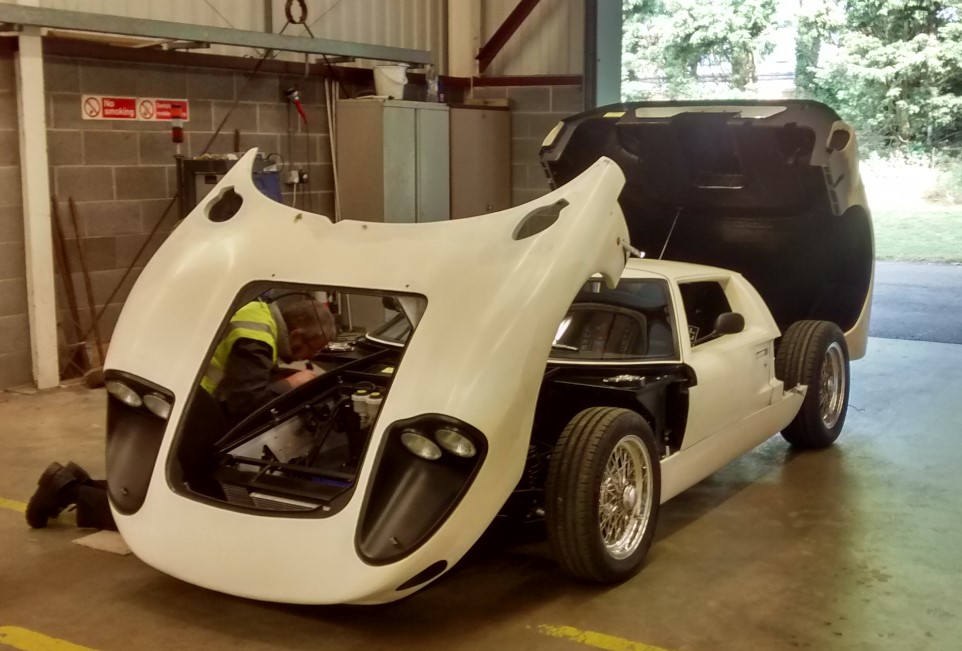

IVA test passed
Failed the 1<sup>st</sup> test on one point - handbrake efficiency,retested and passed = Words cannot express the happiness and joy.
A big thank you to Andy Green for his invaluable help and advise throughout the build.
Now I can start the strip down for painting – Opalescent Maroon.

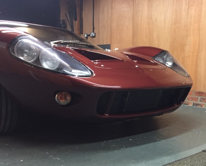

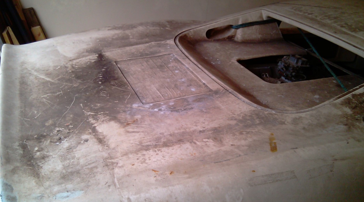

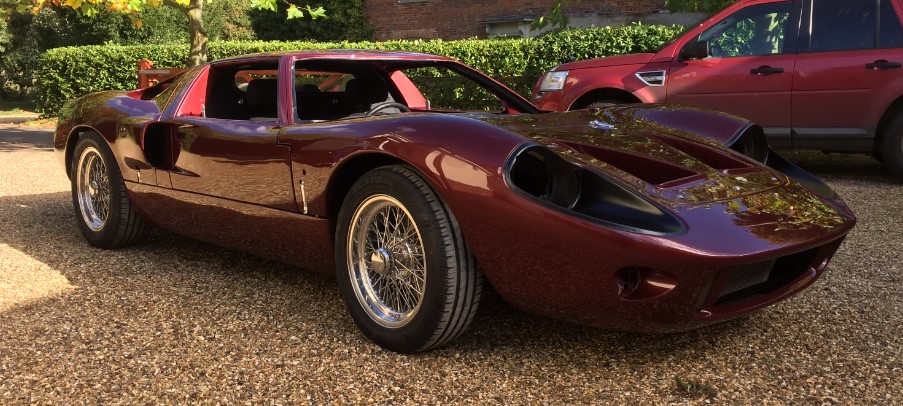

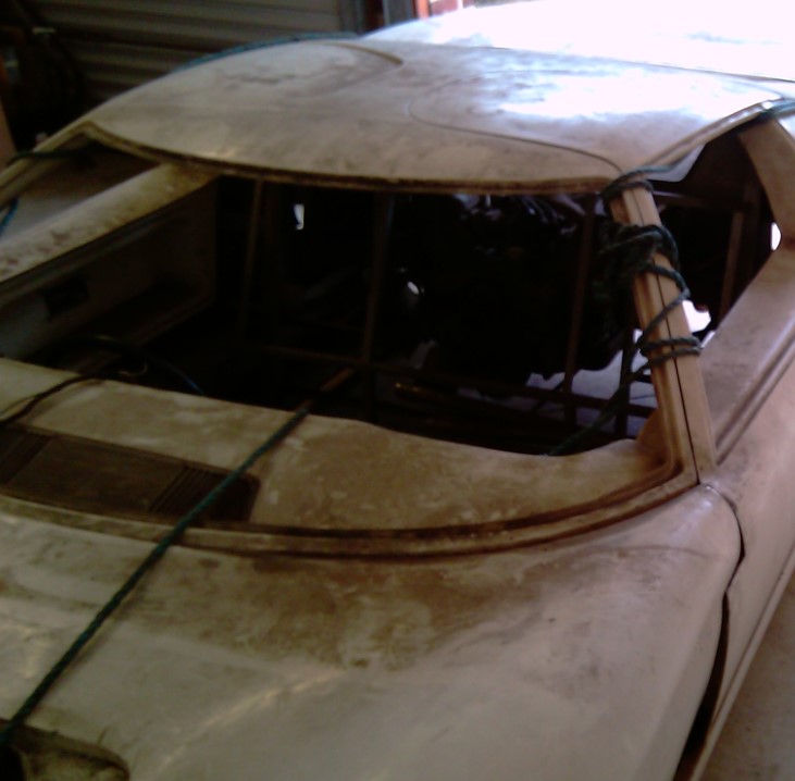

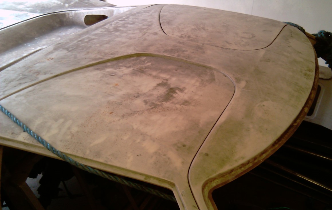

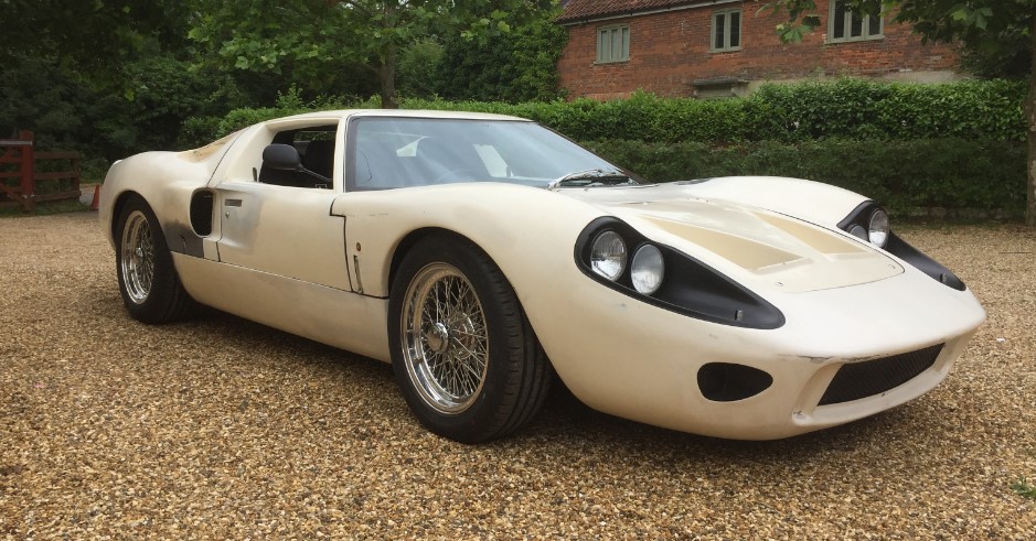

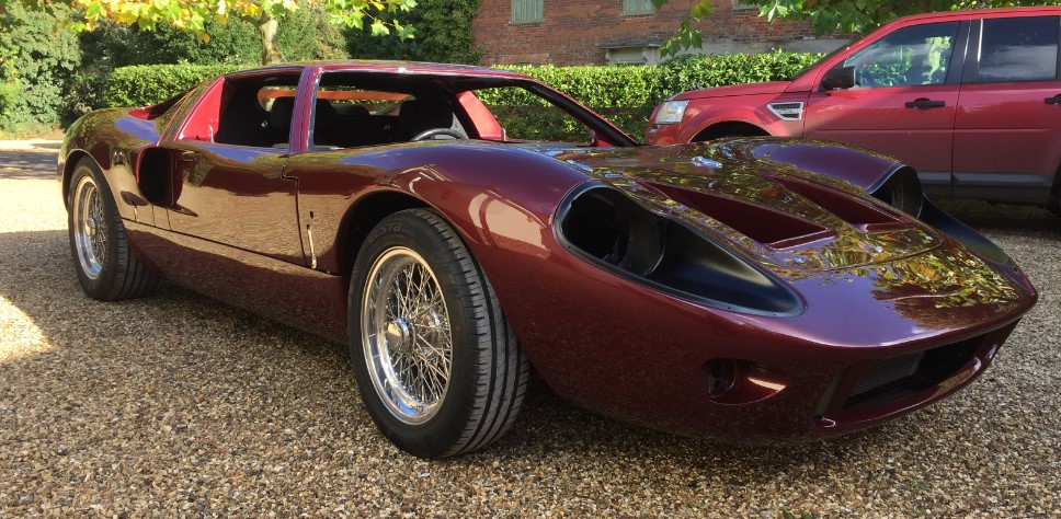

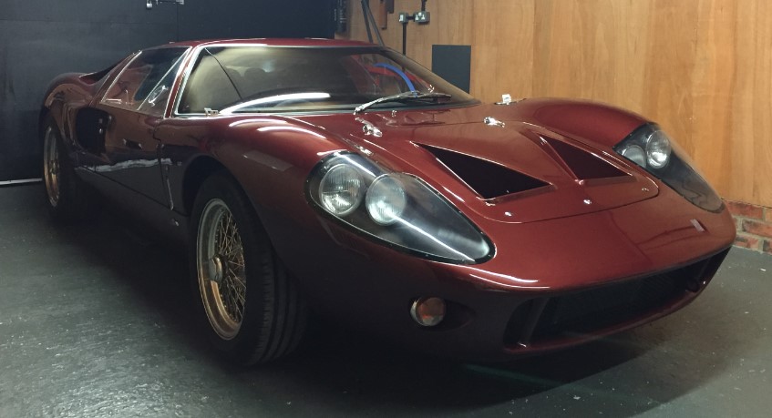

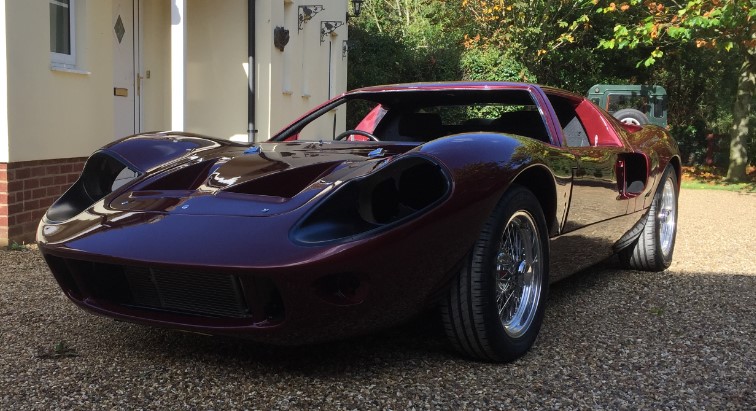

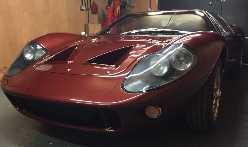

It definably pays to know your limits and when its best to leave a job the professionals, after 3 weeks of waiting for the body work to be done and the car painted, it came back just after lunch today - to say I am pleased with the results is a total understatement, I have a permanent grin on my face like a Cheshire cat.
Chris at Absolute Bodywork in Norfolk is a master of his craft and worked miracles with a 1984 body that was poor fitting, crazed and warped from bad storage over many years.
Below are pictures of how it looked 3 ½ years ago when purchased and the finished result in Opalescent maroon.

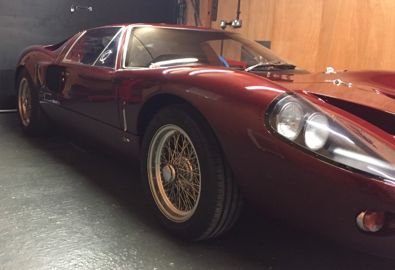

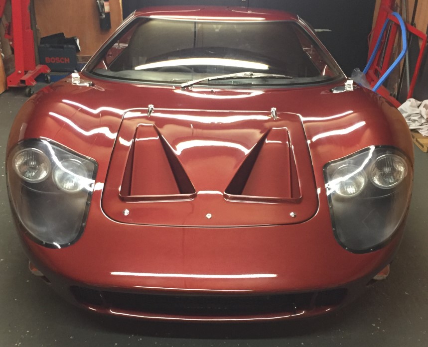

Making good progress with the re-fit, Before being sprayedhad removed the front and rear wiring looms, they have now been re-fitted andall the lights are in and working.
I have made the side and rear windows from a sheet of LexanPolycarbonate and fitted Helicopter Vents to the side windows, got front screenseal and fitting kit from Rejel.
Made the mesh grills for front and side intakes from ahoneycomb mesh as it gives a 70% open area, so as to not restrict cooling airin and painted it black which goes well with the Maroon and chrome colourscheme.
Still a few external jobs to go, like fitting the vitalonisebring chrome wing mirrors.

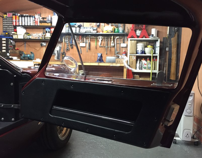

Started work on the interior with making door pockets anddoor cards and fitted a Nardi steering wheel, after Christmas will get theseats trimmed.
Plan to get the car on the road for 1st March to shake down in readiness for planned trip to Classic Le Mann.
