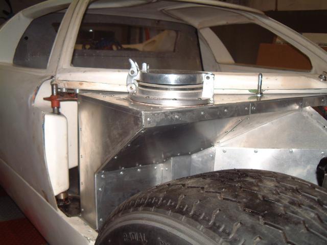

Hi Robin,
This picture should explain what I mean, to give clearance for the tyre on bump.
Brian

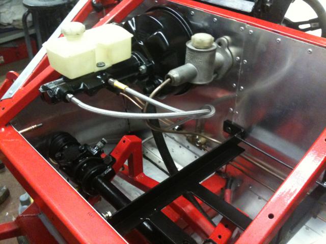

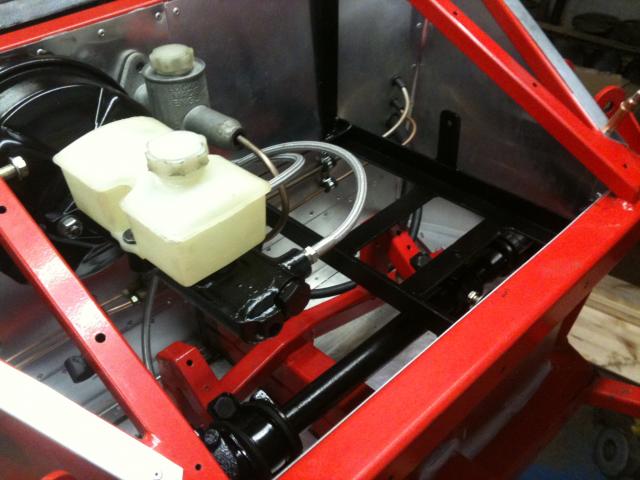

Front coming along ok. trying to sort out brake pipes and clutch pipe.
Does anybody have a 3/4 clutch master cylinder for sale , as just placed the old one in the car to get the pipes to the correct place.

I have some new Girling (with integral reservoir) 0.75" master cylinders with various outlet sizes and ends. What size outlet fitting is on your car? 3/16" or 1/4" ? What fitting do you have at the pedal end? Some master cylinders have a fixed fork and some have the screw on type.
If you post what your setup is I may have one which is suitable. Failing that I can let you have the suppliers that I tried for my car.
I have these as I have just changed my clutch setup and it took a few tries to get it right!

The Master cylinder I am looking for is a 3/4 bore with a 1/4 single outlet with an integrated reservoir. Clevis at the end but could modify for both types
