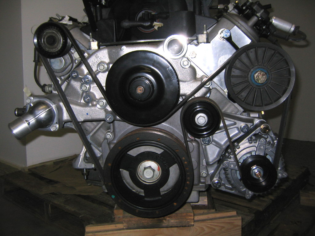

Here's a pic of my engine with accessories installed using the RCR front dress kit
Pete
Which alternator and part number is that. Do you recall the bolt sizes you used...simple enough to figure it out, but while I'm asking......
Looks clean and simple enough. Picture is worth a thousand words.

Hey Dan, Just looking at Pete's picture I have a feeling you can't mix and match solutions. The location of the PS idler looks too low to me to allow you to use the CTS-V setup, you will most likely have clearance issues with the belt between water pump and idler.

Allan, are you using the idler pulley on the CTS-V bracket or skipping it? I'm having a hard time imagening this routing. I included a shot of my setup and it's awefully close even though my belt is angled higher.
FYI when using the CTS-V bracket you must use one of the CTS-V alternators, they're very specific and have a cast in 3rd bolt braket for the side of the block. There are two CTS-V alternators, part# 25766345 as mentioned by Allan has a simple turn on lead (Terminal L) that's just a straight voltage, used with older ECUs. The newer CTS-V alternator(~2007+) uses pulse width modulation to properly turn it on. You must match the alternator to your ECU otherwise it will not regulate properly(fixed at 13.6V).

I used the standard RCR alternator setup.
I think the alternator came out of a Denali or Suburban or something like that. I remember I got it right on the first try. Autozone/napa/whatever had one on the shelf.
Secondly. I didn't have any belt slip, i know people are worried about that. Mine didn't.
Third, power output was fine at the 105A version of the truck alternator for what I was doing. Constantly saw 14.5 or higher on the gauge.
Finally... About it slipping or getting ripped off at high RPM's... I revved mine up (more than once, race track ....) to about 6,500rpm-ish (multiple times, for sustained periods, gotta love GM crate motors!) and no issues.
~Eric
The RCR set up works without any issues. You can use the CTS-V mount with the RCR set up but not the idler pulley.
Or you can use the CTS-V set up with the tensioner in the stock position along with the mount, idler pulley, belt and the pulley made to replace the power steering pump.
