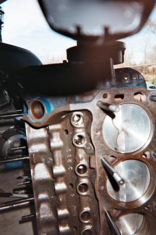

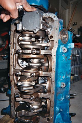

Ok, finally pictures. Once I pick up some Alum. Heads and the rest of components, I will have the components torn down, crack tested, and re assembled. Next is the trans, I have a line on a Porsche 930 transaxle I plan to pick up in Dec. I figured I had better buy it now, since they seem to be getting rarer, especially at a reasonable price.
