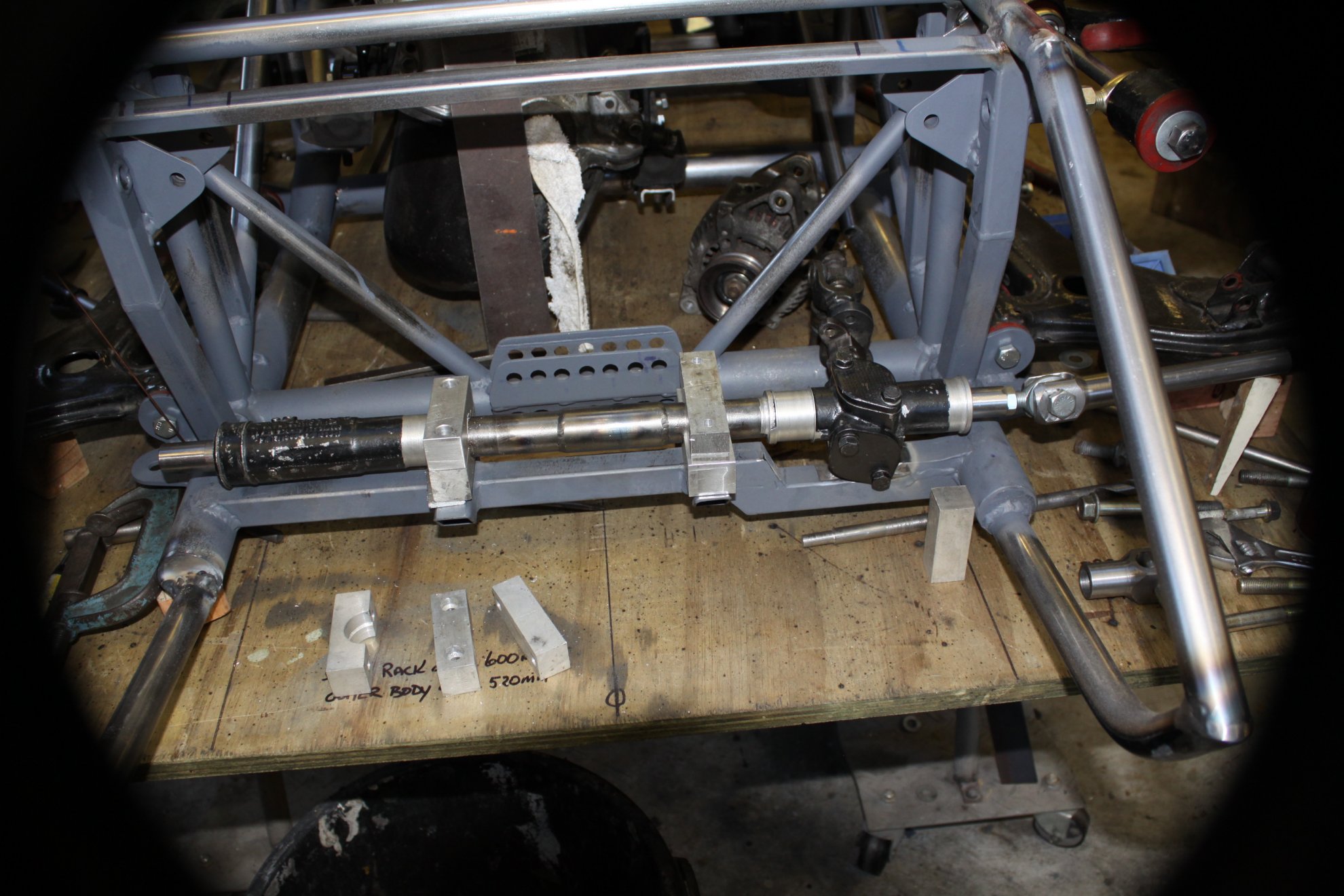

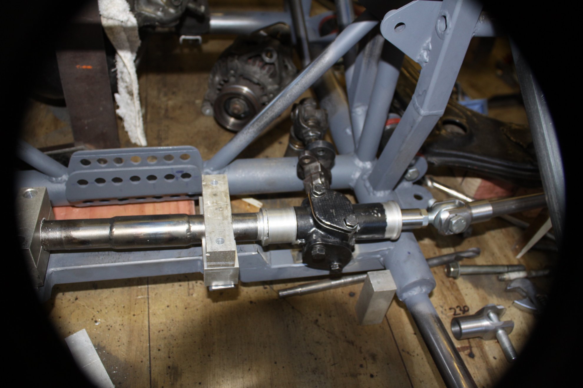

Do you recognize the rack that you gave me....been shortened a tad

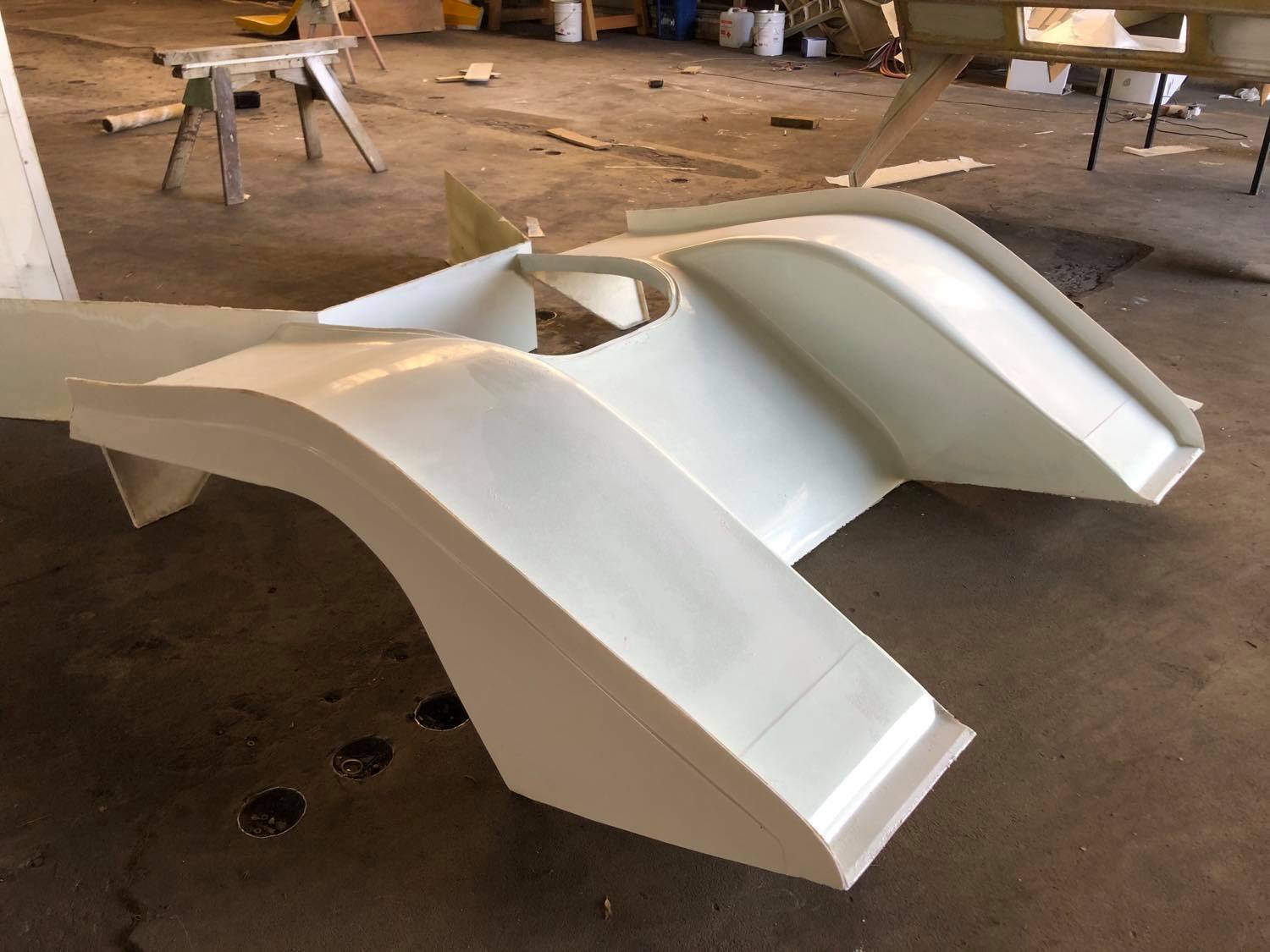

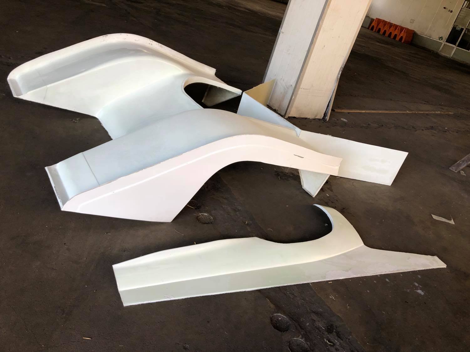

Hello guys a bit of an up date, I got stuck in Australia for 3-1/2 months because of COVID Before that I as working on getting this Car done this year. I pulled a second Body from my molds, this one I laid up myself and it released from the molds easily. Sine I have been home I Have hade the engine to the Dyno and Ran it up, 700hp @ 7000 rpm. I'm quite happy with that and the engine guy says it's a safe Tune, we could lean it a bit and put some more timing in it but 700hp should spin the wheels is what we decided. I'm now getting it in the car and getting it ready to sit on it's wheels off the table for the last time. I tried to put up a video of the engine running but been so long I have forgotten how or its just not playing the game. Will try again another day. Cheers Leon
Managed to get these to work. First parts out of the mold, these are the first ones I have laid up myself, I had Andy's body Laid up by an expert. To be honest I think my effort was as good just took me longer.
