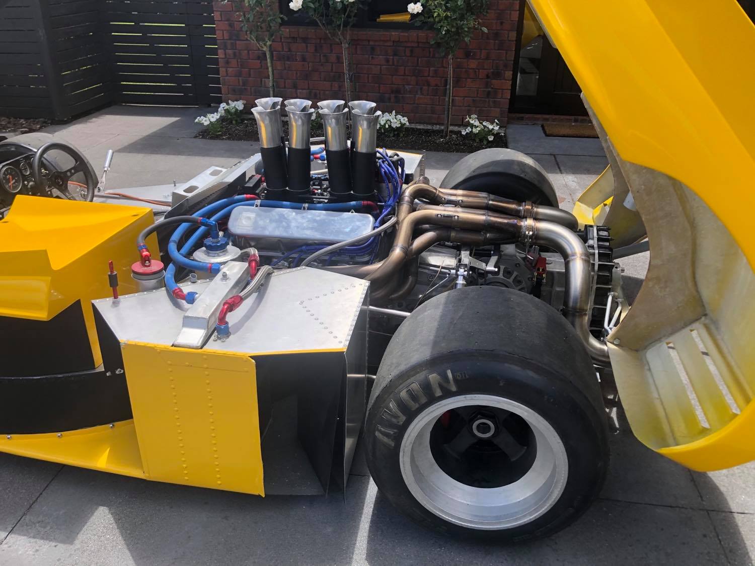

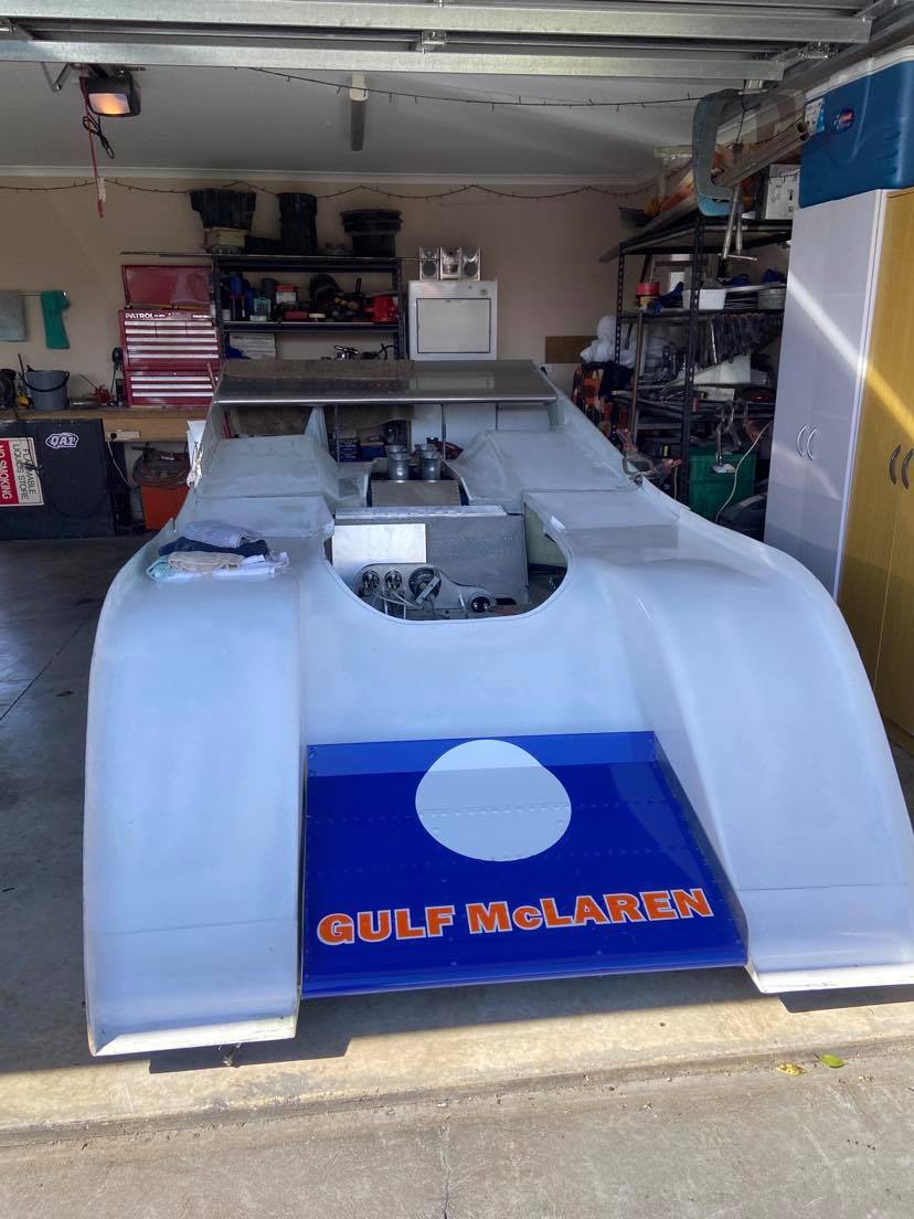

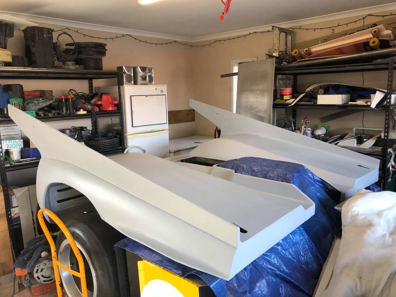

Fitting of the body has started, I have some fettling to do on the rear clip to Clear my exhaust system which I knew was going to be an issue but I'll sort that. Making the mounts at the front and on the rear is the bigger job but I know what I want there so no big deal, a couple of Photos to start and will do some of the mounts soon. Cheers Leon

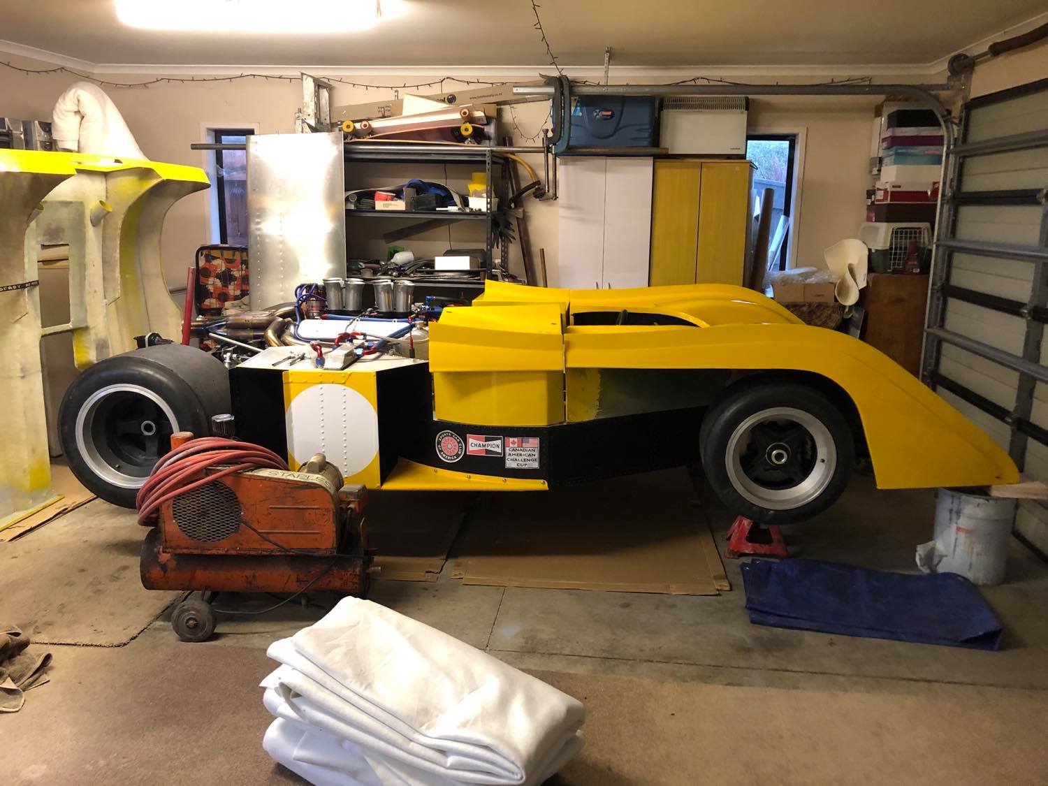

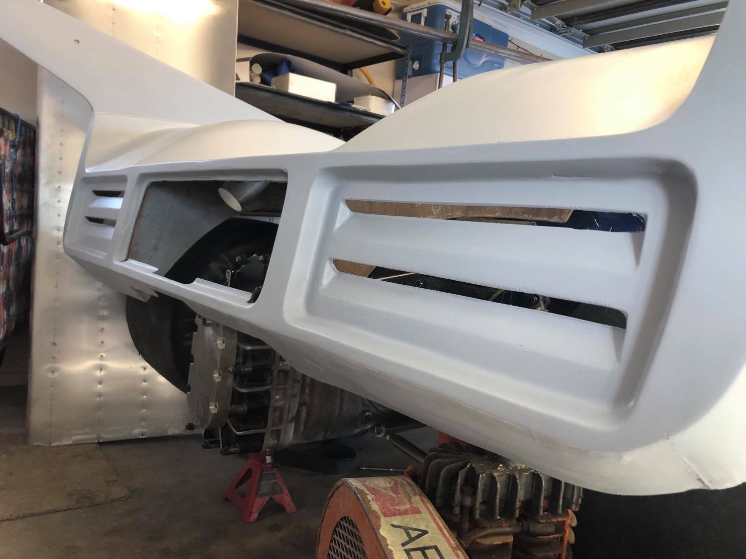

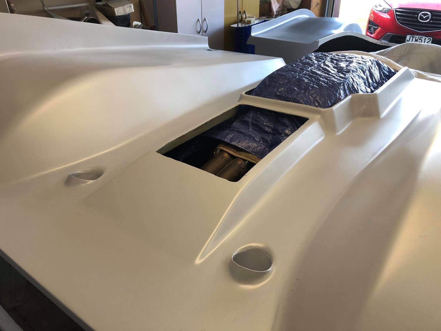

I'm in full body prep mode now as I will be painting it at the end of the month. I have had to make some mods to the rear deck to clear the exhaust system. You will see in the attached photos the opening will be covered with an expanded mesh and I have molded in some brake duct intakes. Also I have opened up the rear panel vents. I am also making a mold to make the windscreen to be like the original. also working through the last Fab and Mechanical jobs, I can clearly see the light at the end of what will be almost 12yrs work. Cheers Leon

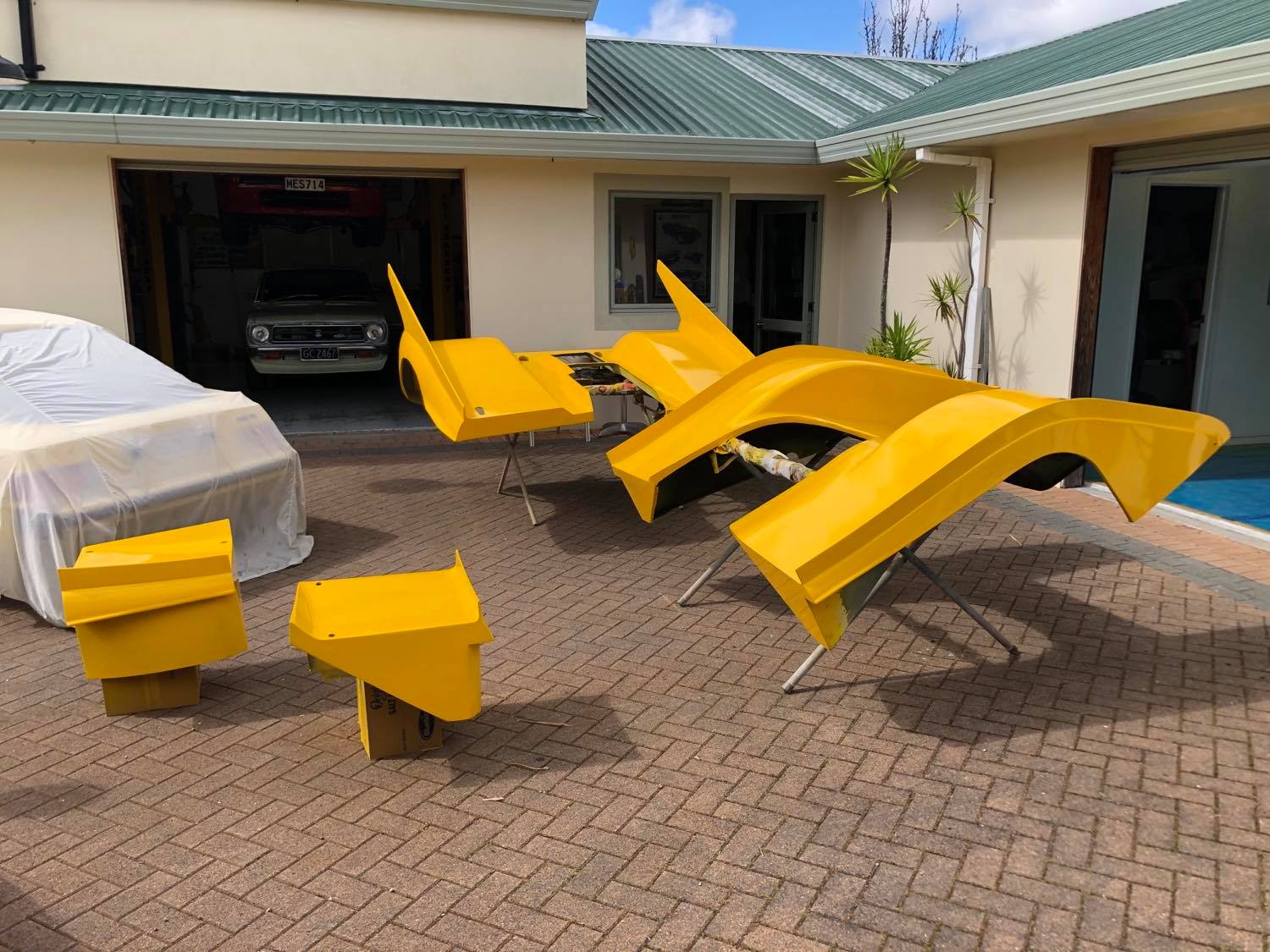

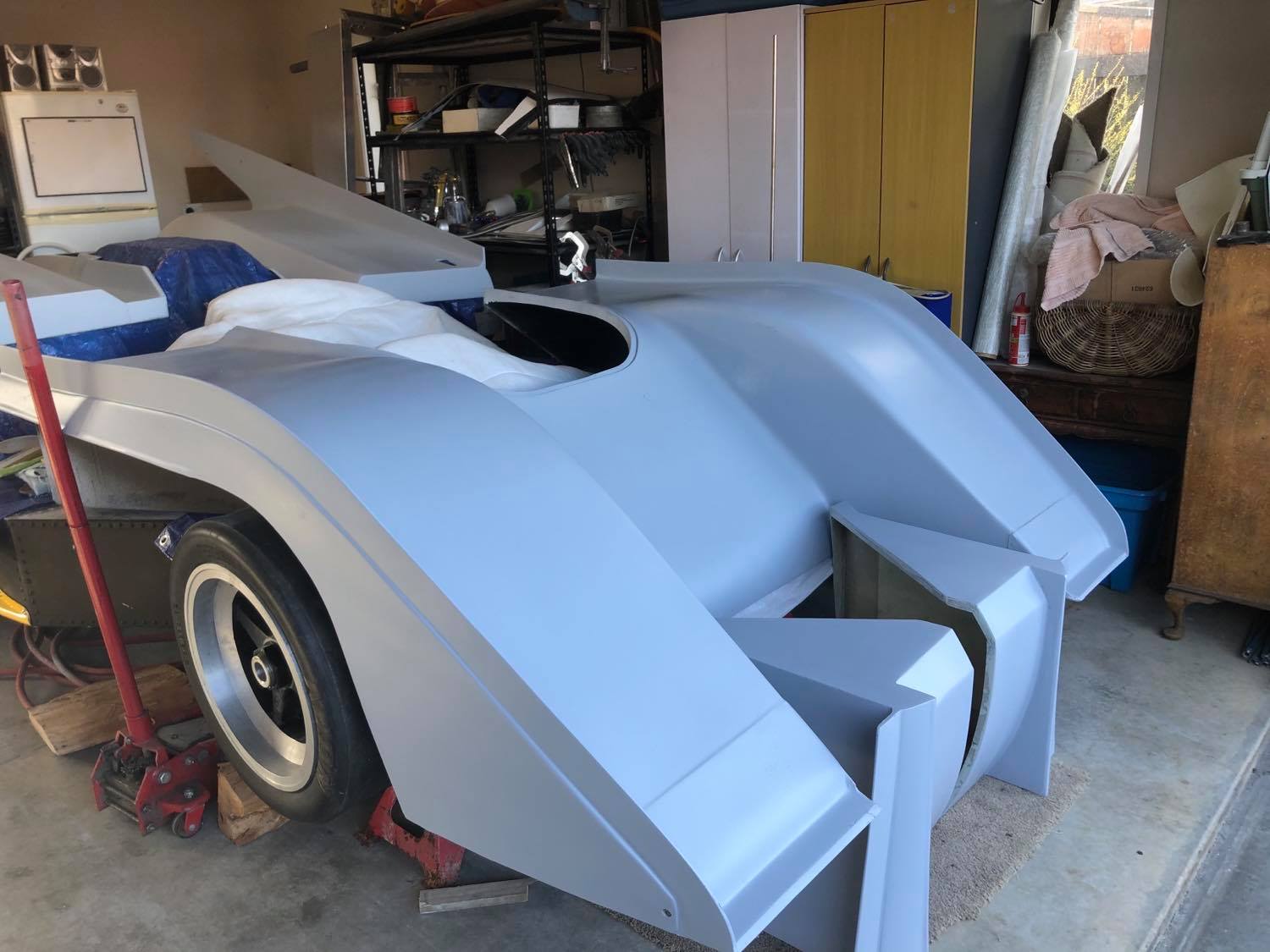

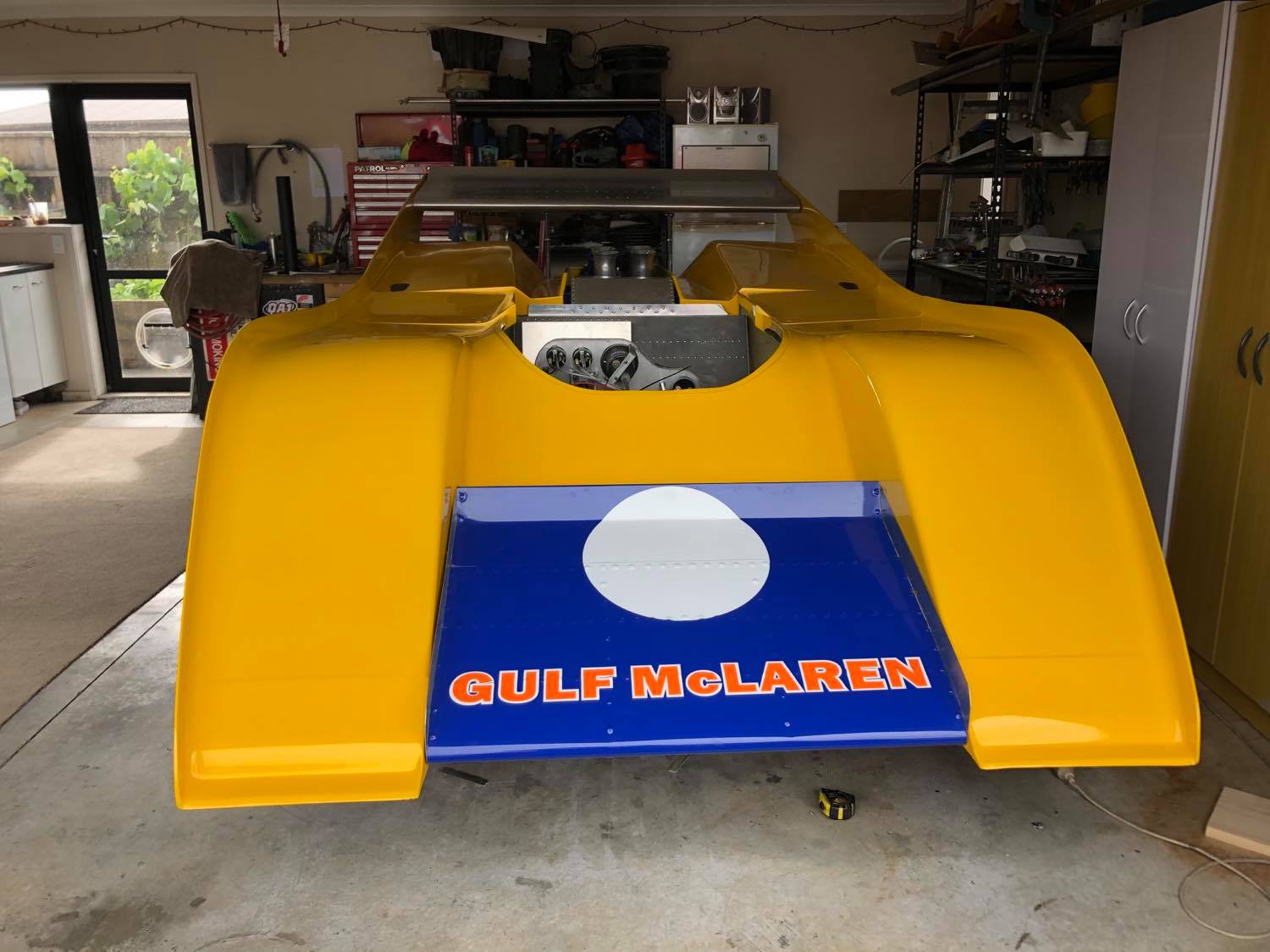

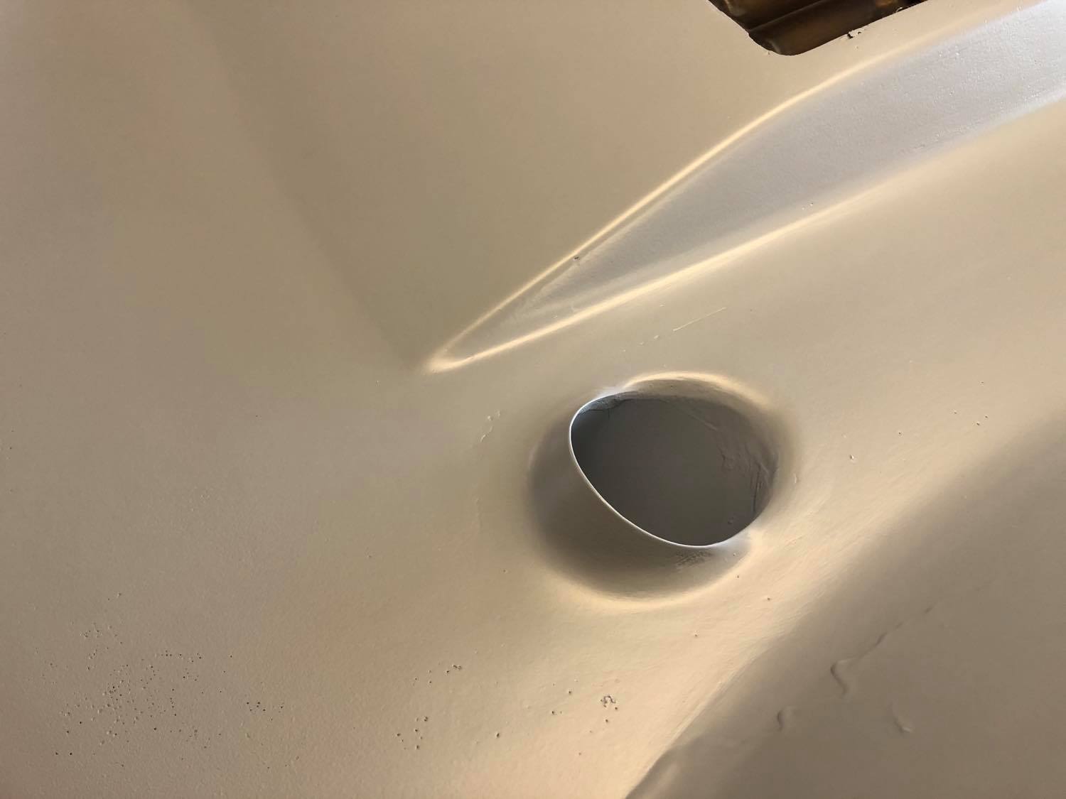

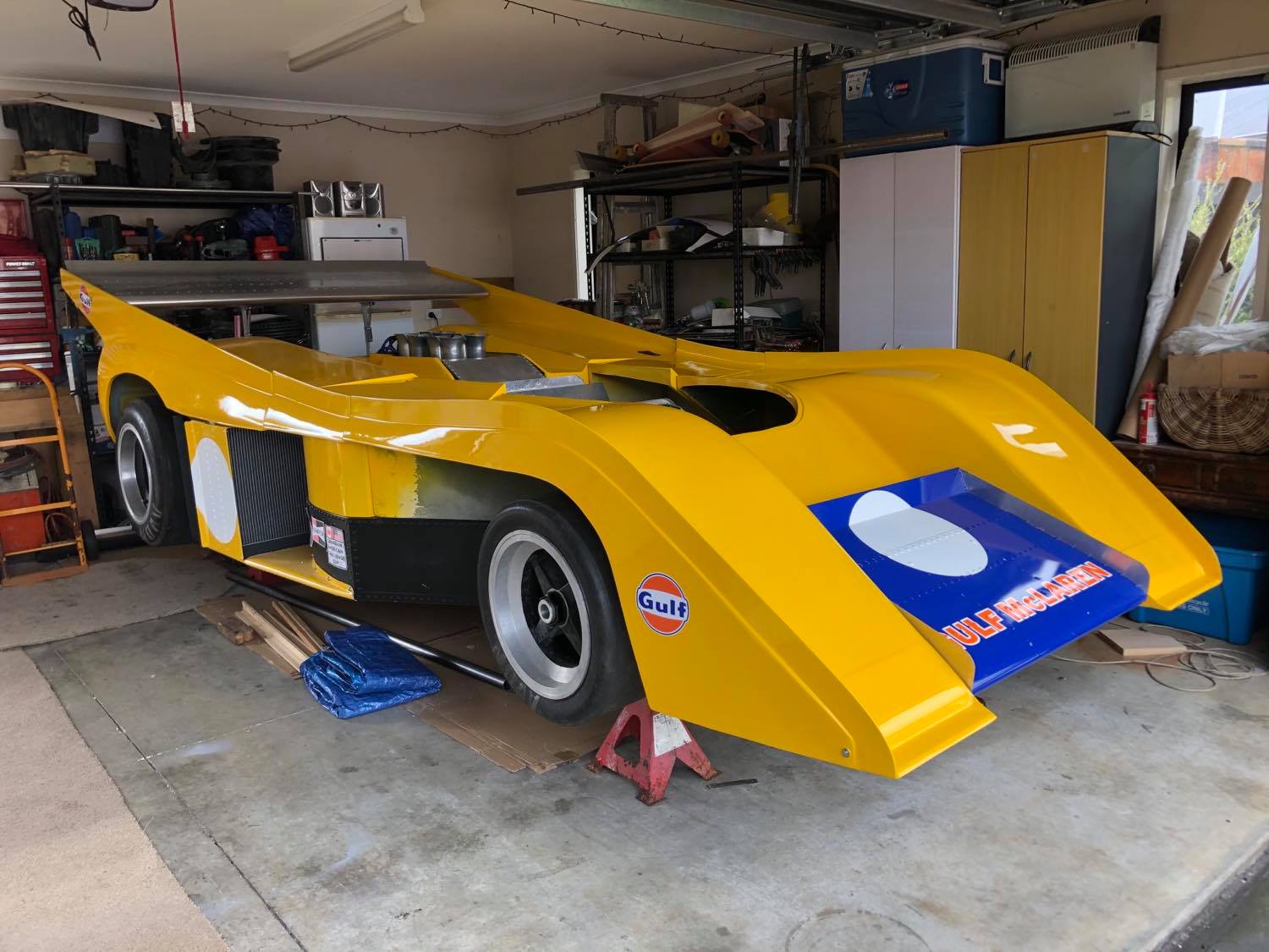

The weekend was busy but I got the body painted we had a hell of a time with pin holes in the gelcoat but managed to get there after 4 weekends of filling and sanding. Attached are some photos, I'm really pleased with the colour match, the stuff on the tub is a wrap not painted and I got the paint shop to match from a sample I gave them. Just the black to do now and some decals.
Cheers Leron

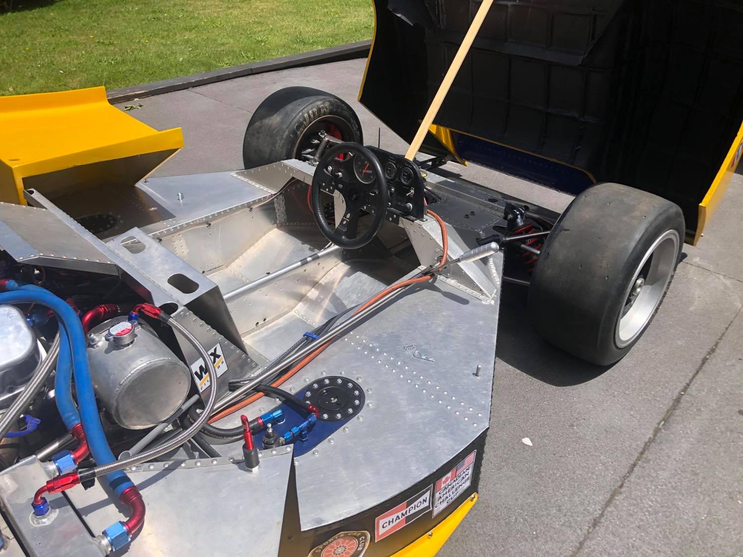

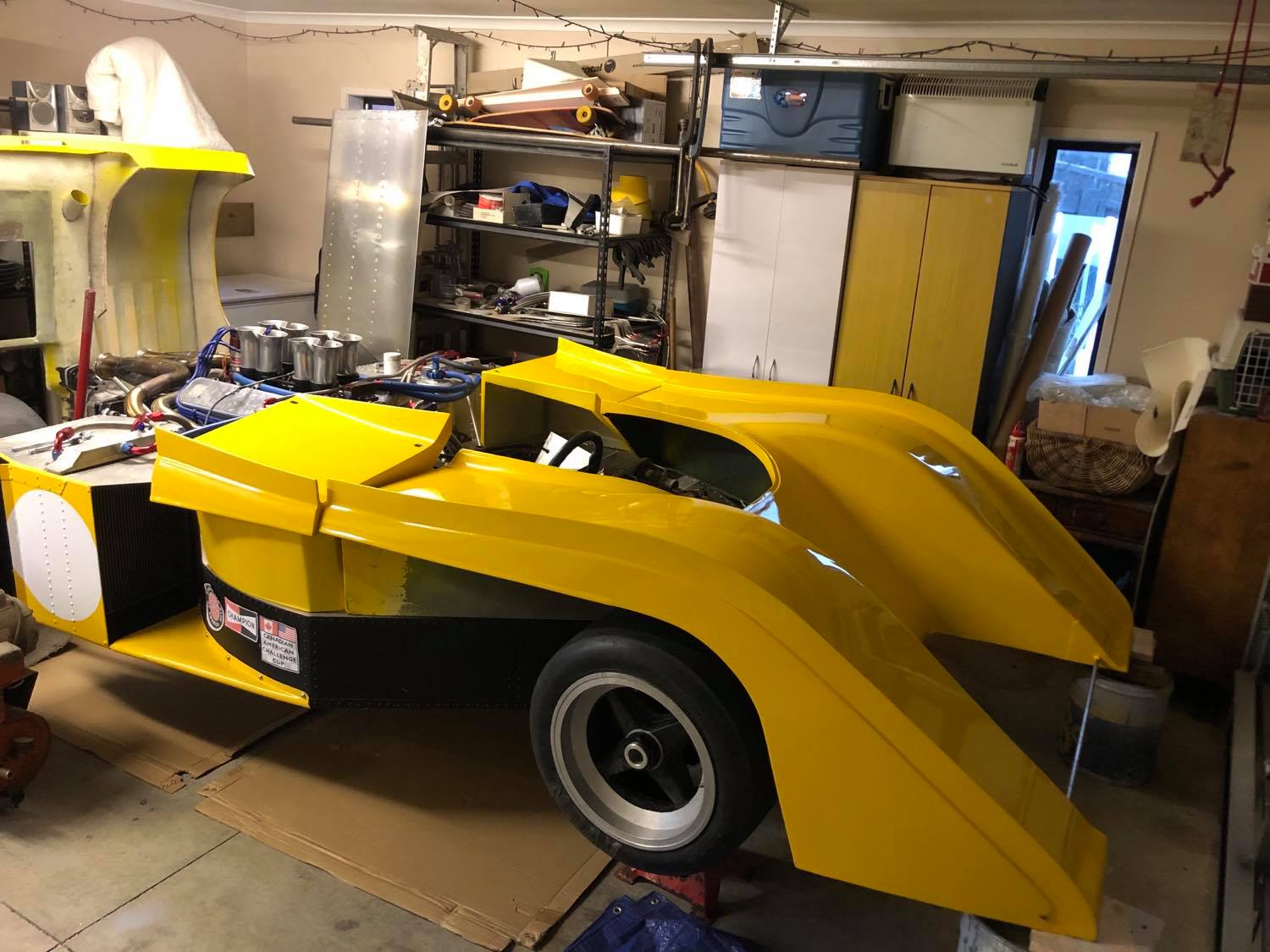

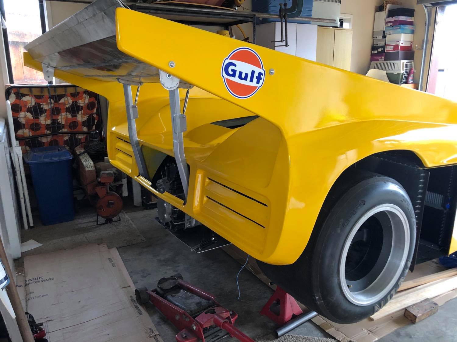

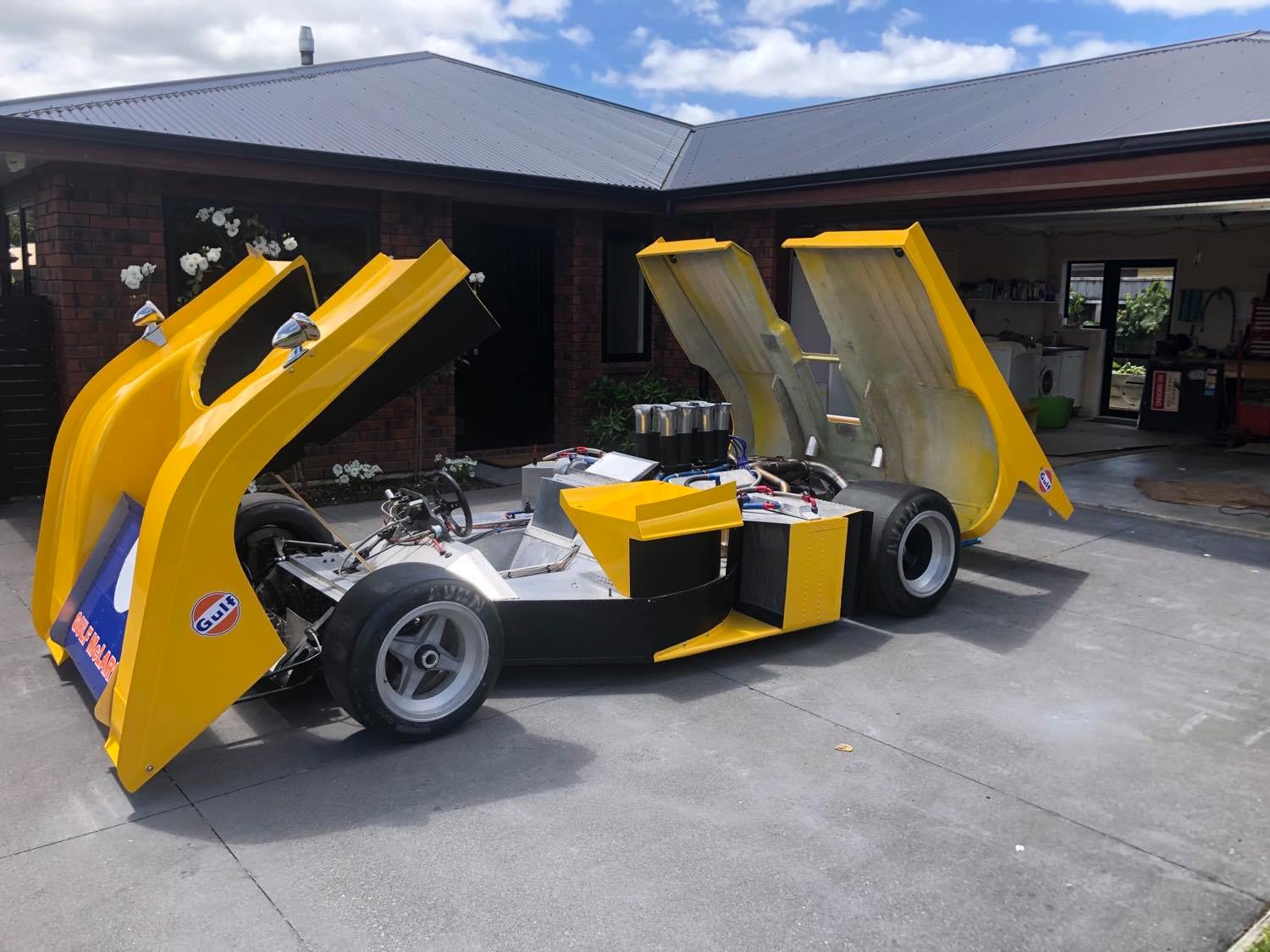

Progress is steady now the front clip is mounted and the door latches are work in progress, the rear hinge mount is almost done. The body gap's are …..well like an old racing car and that's how they will stay, I have looked at 2 M8Fs that are here in NZ and my body gaps are just fine!! LOL. Still need to do the black below the body line but the weather isn't cooperating but will be done soon. Hope to have the roll bar done this week, some more photos attached. Cheers Leon

The paint shop called it "Sun burst" they just matched it to the wrap that I got from a local sign shop. I pretty much took a photo I had to the sign guy and we found the closest thing they had. Its a 2 pack enamel by "Autothane"
Cheers Leon
The rear clip is 30kg the front is 28kg and the doors are 5kg, Total 68kg with out wings. I would estimate the wings are maybe another 20kg.

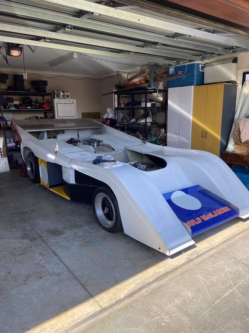

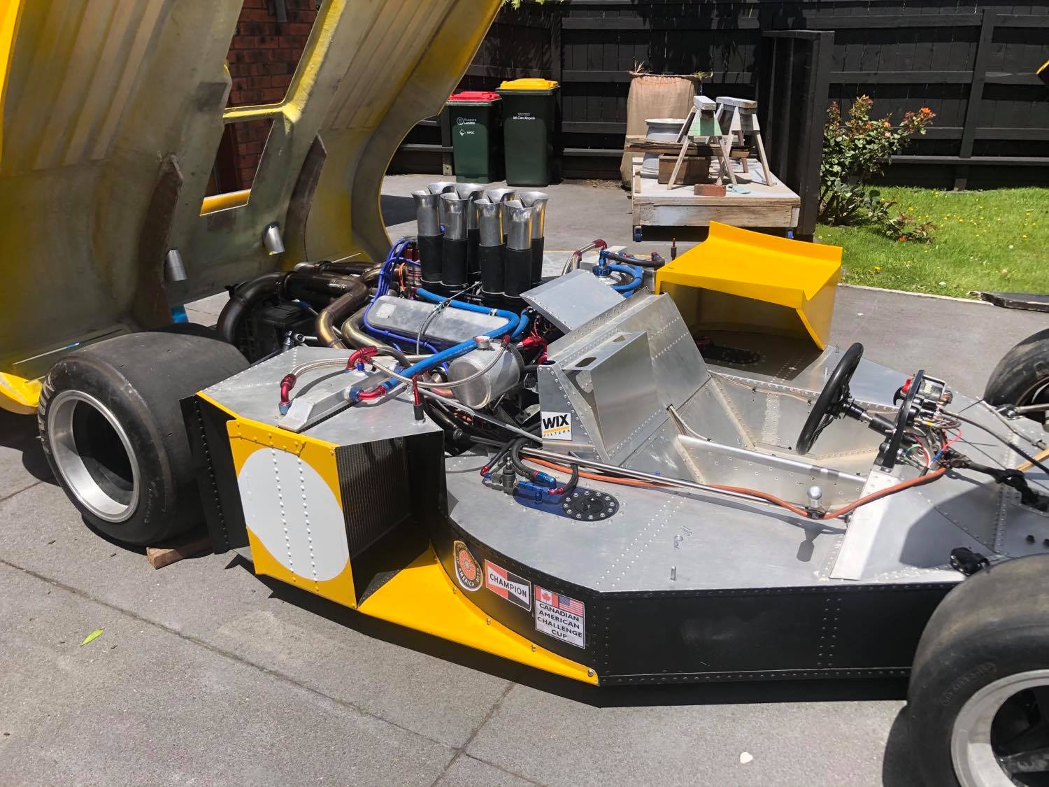

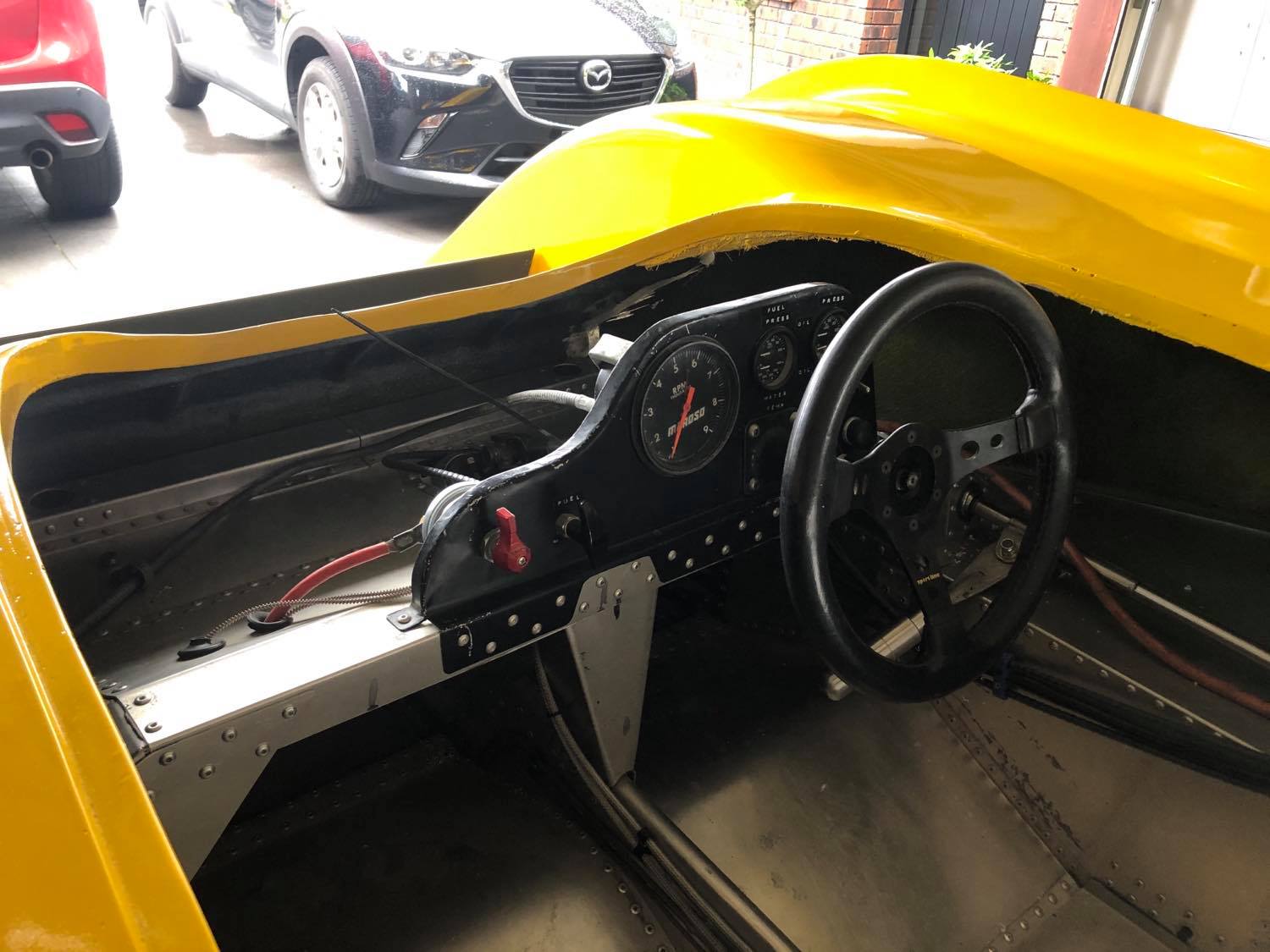

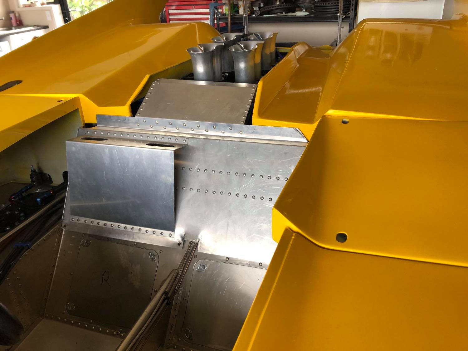

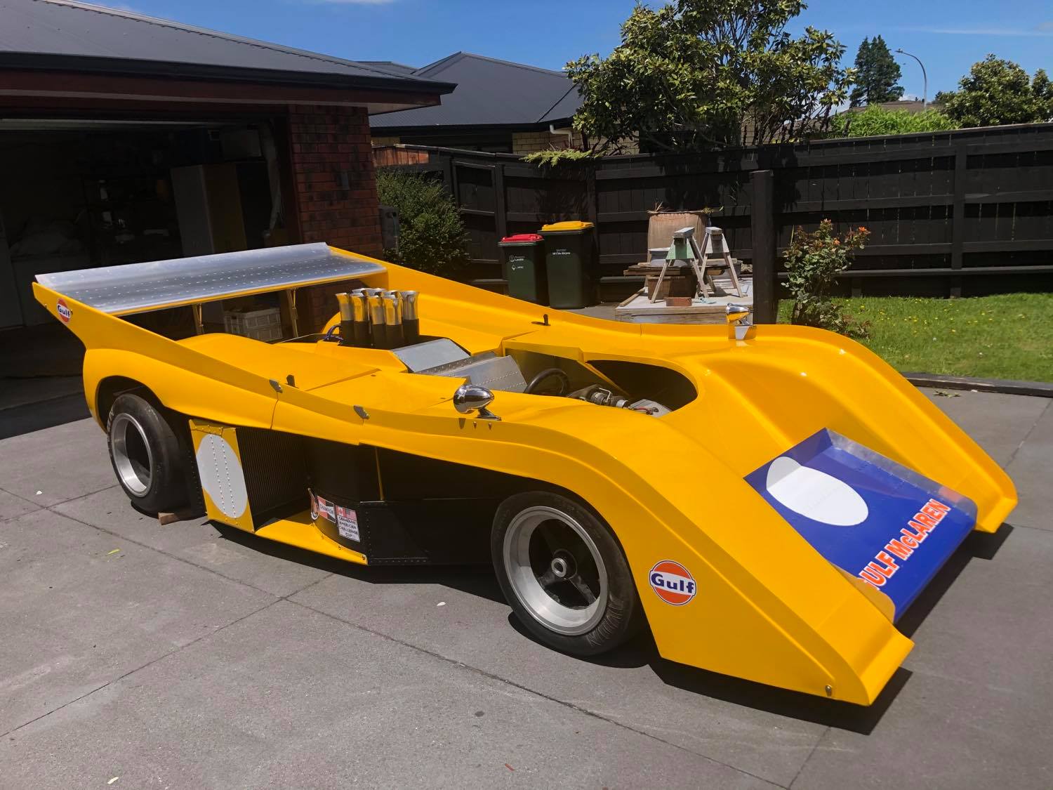

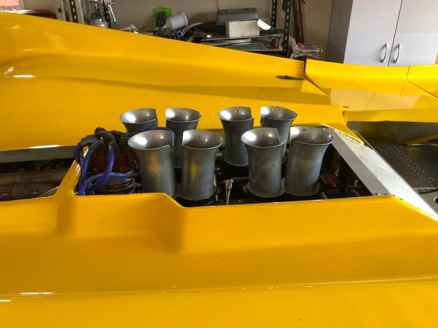

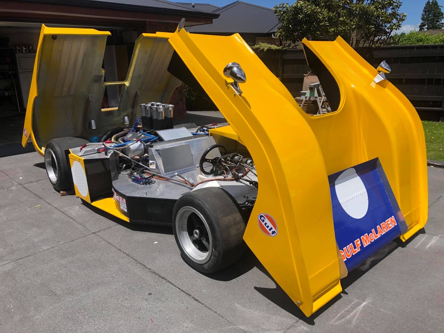

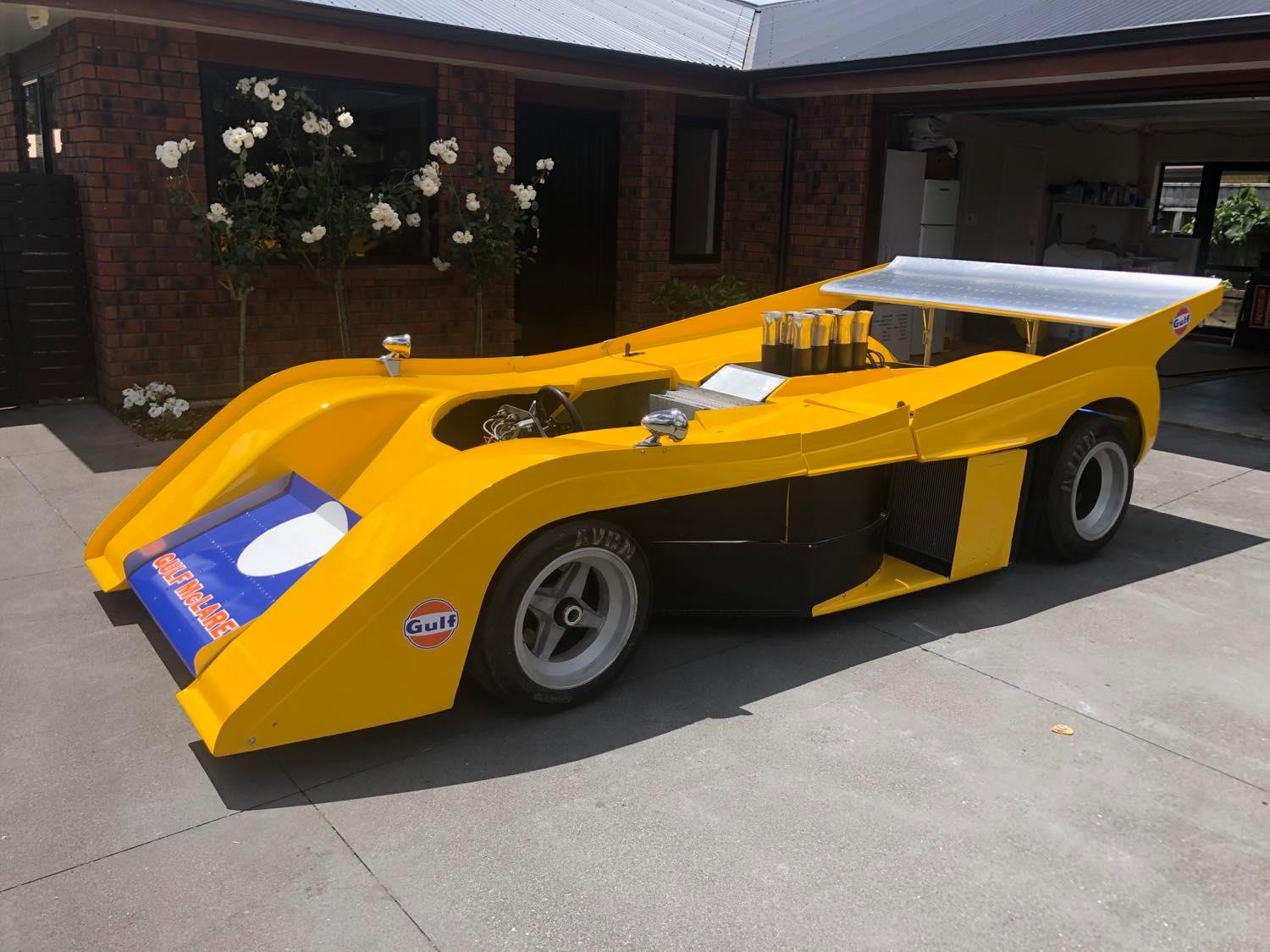

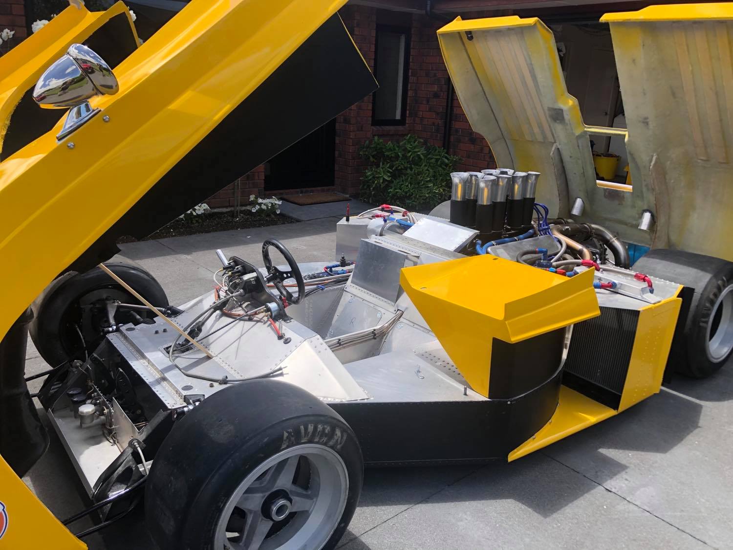

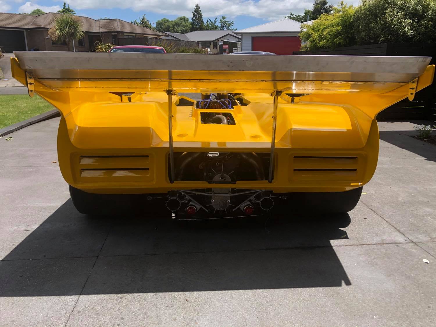

Been working on the car a fare amount of time the last few weeks hoping to run the engine up in the car very soon. Finished the body mounts got some mirrors and tail lights fitted. Really just the roll bar and wind screen to do. the bar is bent up just needs to be mounted, Brakes are bleed need to make the mount for the throttle cable on the valve cover and some other odds and ends and this story will be done. Some photos to show for the last few weeks of work. Cheers Leon.
