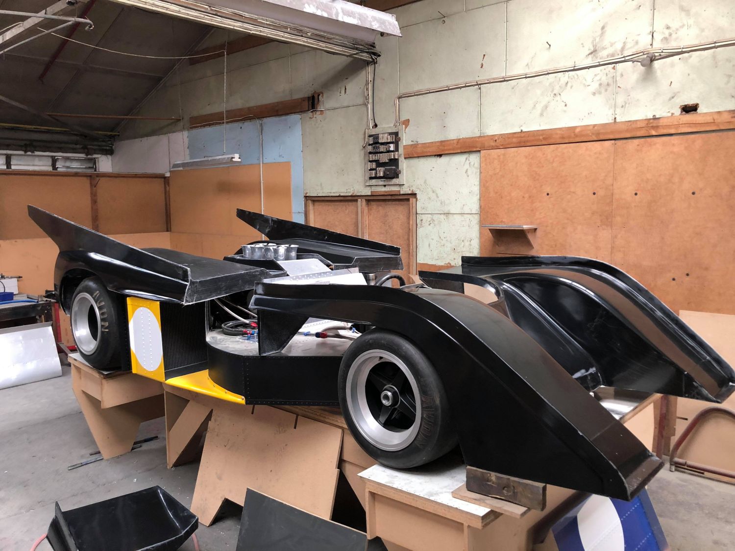

Well we have photos of the first body from the mold, Andrew picked it up today so should see it on his build soon but here it is sitting on my car. cheers leon

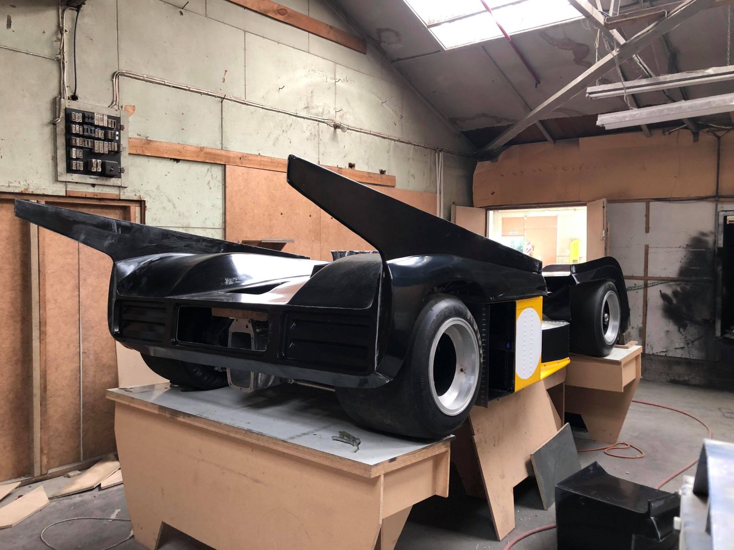

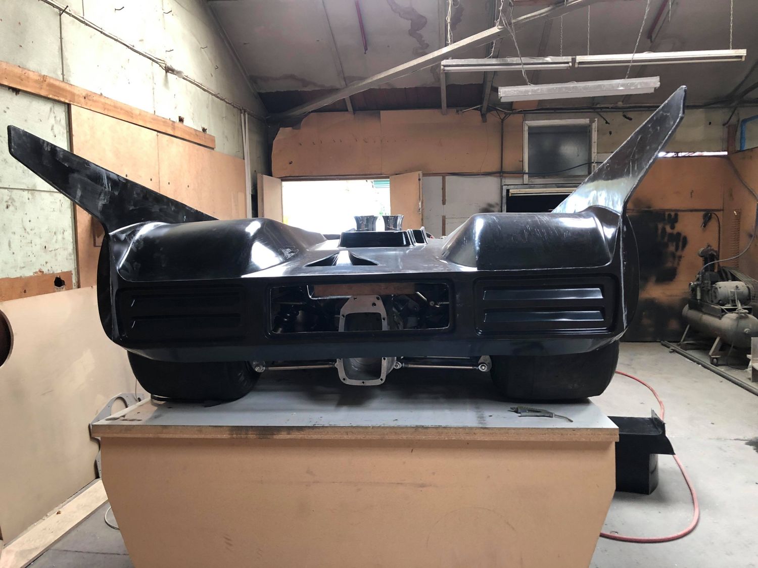

A long time coming but worth it in the end. I'm happy with the shape and believe it is real close to the real thing and with a block rub and paint very straight which is hard to get on big flat surfaces such as this car has. The man who laid up the body said he was impressed with the finish on the molds. I will have my body in the new year and hopefully will be able to get this thing done, it will be 10yrs in March!!
Cheers Leon
Leon, considering the dramas previous when I last called, that result must be very pleasing. Well done and a credit.

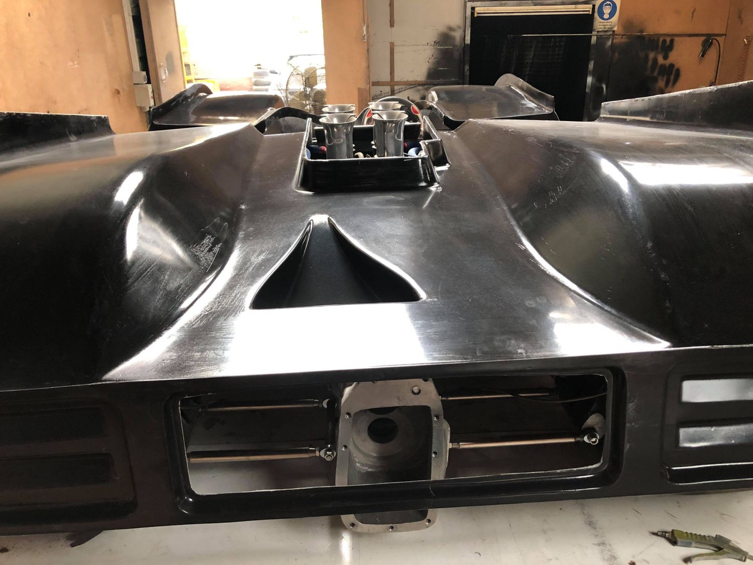

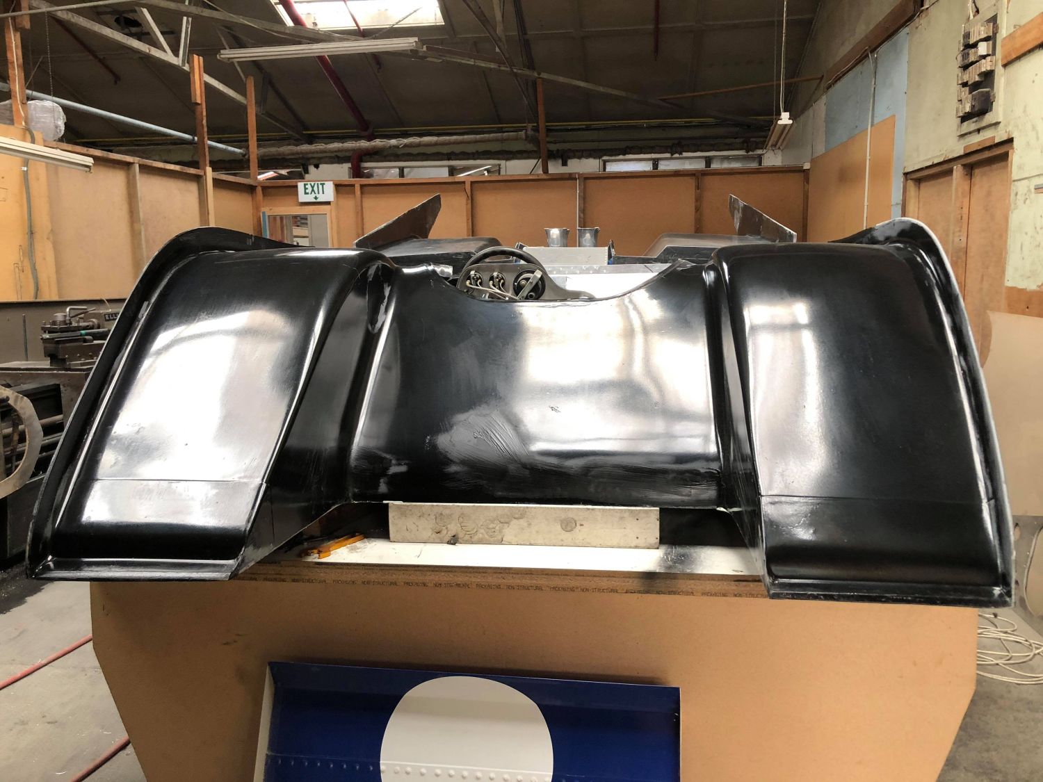

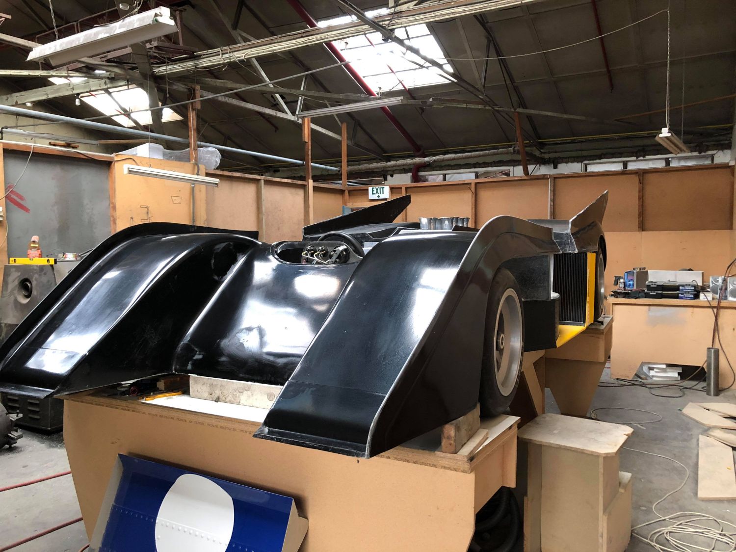

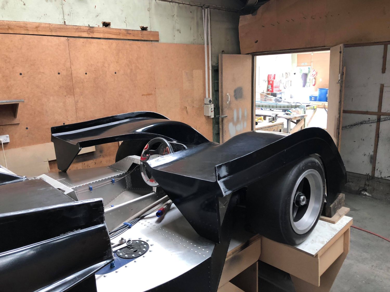

I now have the body back in my workshop, nothing serious I'm going to prepare it for paint, A little miscommunication, I said it would be finished in 2 pac primer and Andrew asked me to do it in black gel-coat so I took that as meaning just that. He is too busy to prep it so I'm going to finish it in 2 pac as I said I wood originally, it will be good as i can block it back and see just how nice a finish it will have. I'm also going to make and fit the door latches now instead of supplying them to be fitted later. And I might get a chance to do the windscreen on this body if not it will be done on My body in a couple of months Andrew is going to check with MotorsportNZ on the specs for the screen.
Cheers Leon
Andrew came and picked up the body again a week ago and I'm sure he is happy with the end product now. on closer inspection the gelcoat was not a great finish and I have talked with my Glass man as to what we can do to improve it for my body so hoping not to have as much work to prep it for paint. I was also able to get the windscreen done on Andrews body as well so I'm pleased with that.

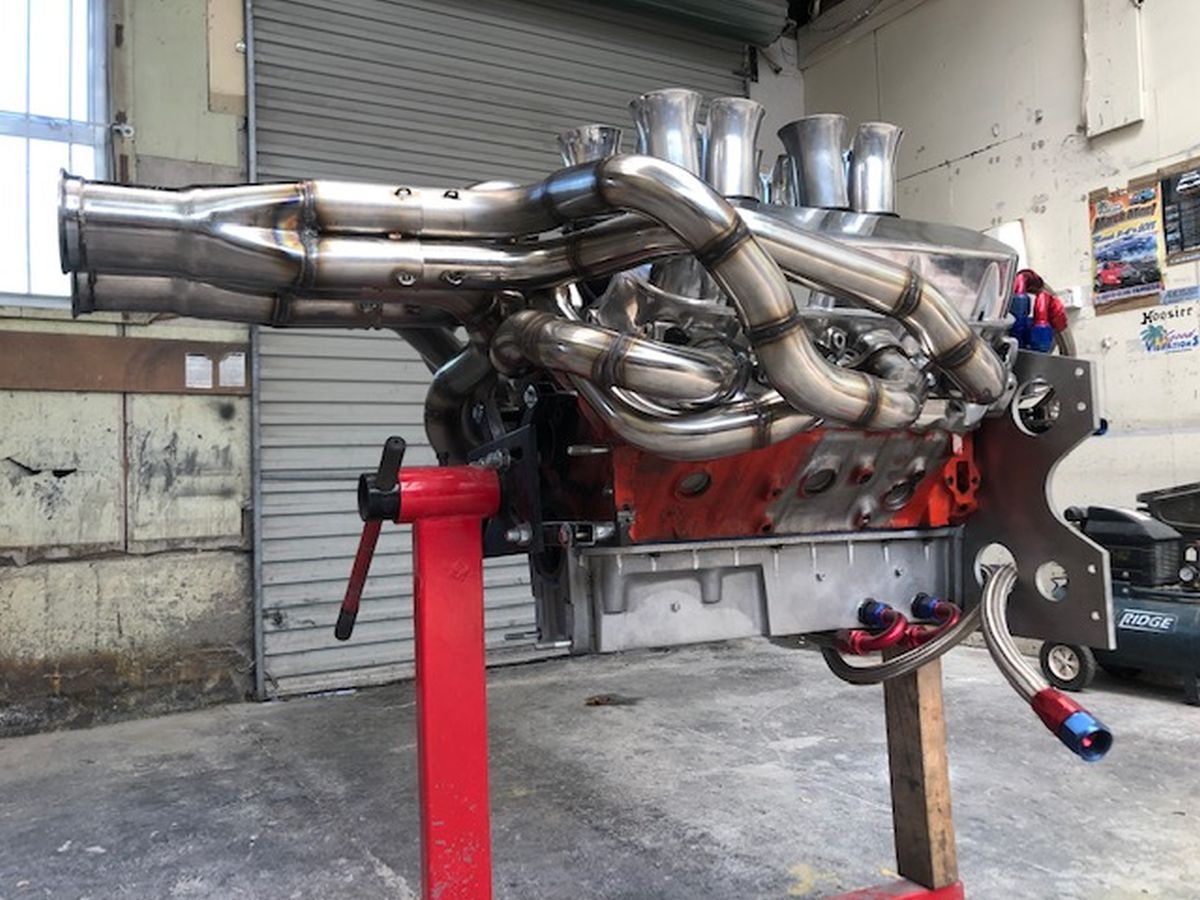

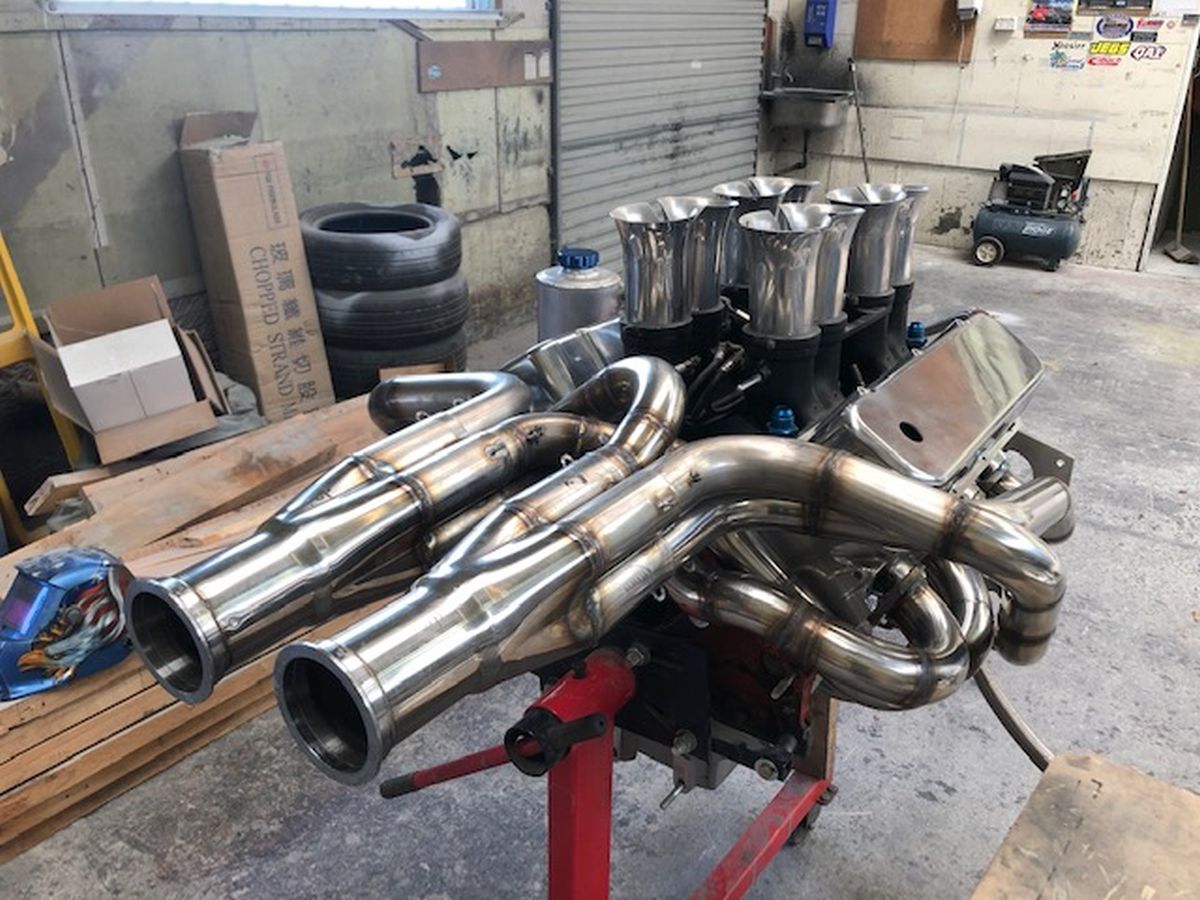

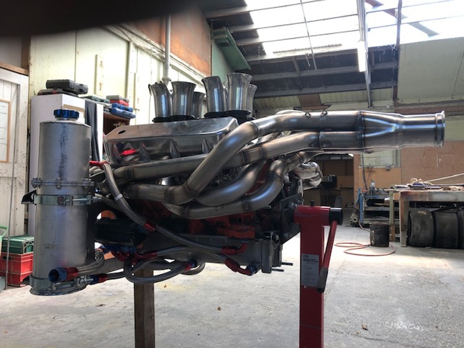

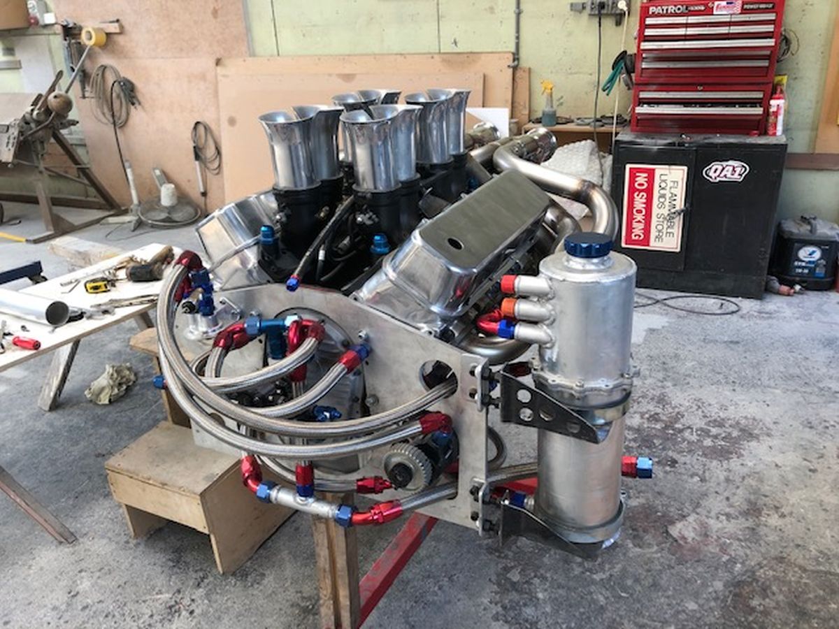

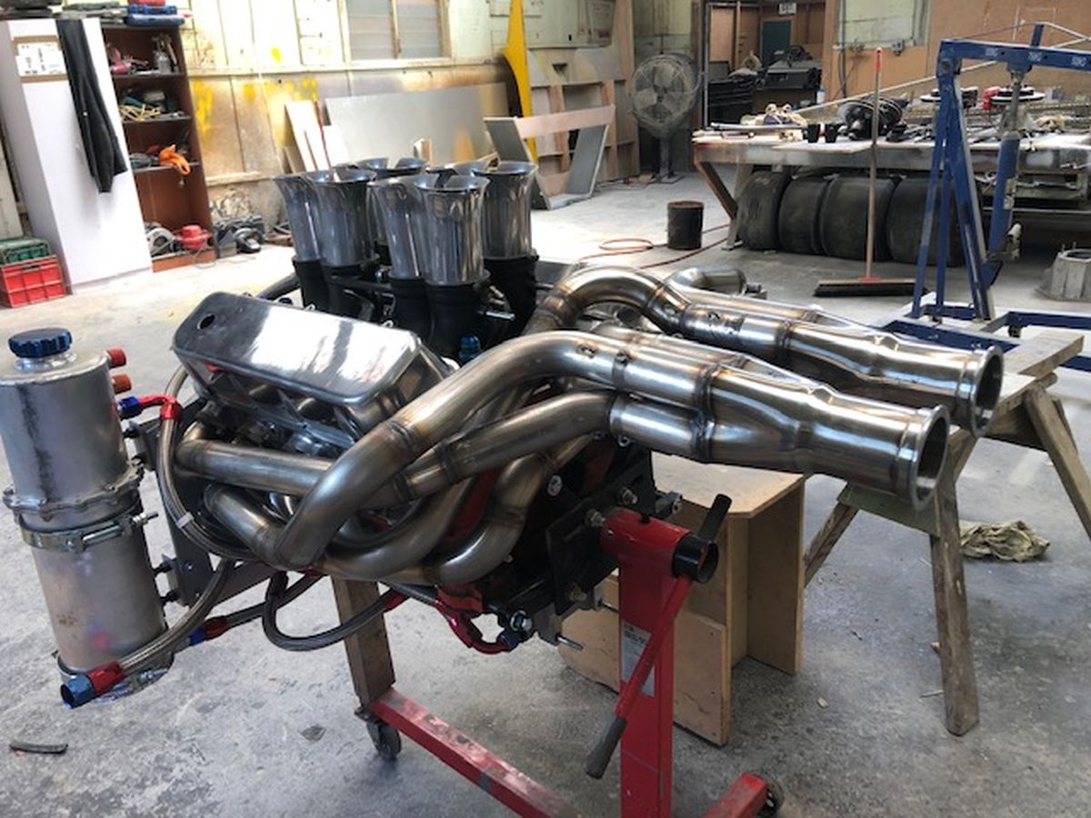

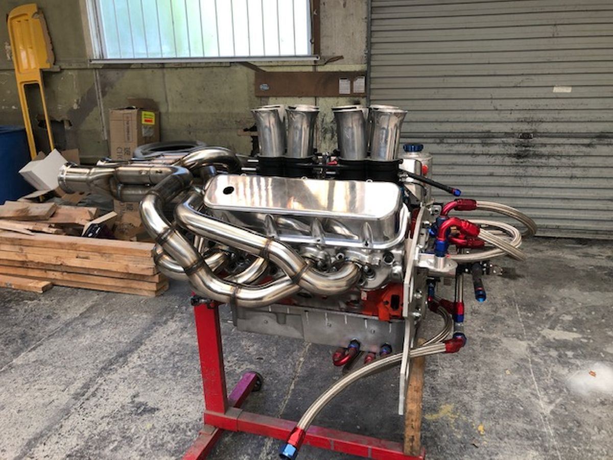

A little progress, finally finished my headers today. The engine will be next inline to get it assembled and run up on the dyno before it gets put in the car. I have all the parts so going to get the short block done by a notable race engine builder and I will do the top end. I have some photos of the headers and the dry sump as it will be run on the dyno
