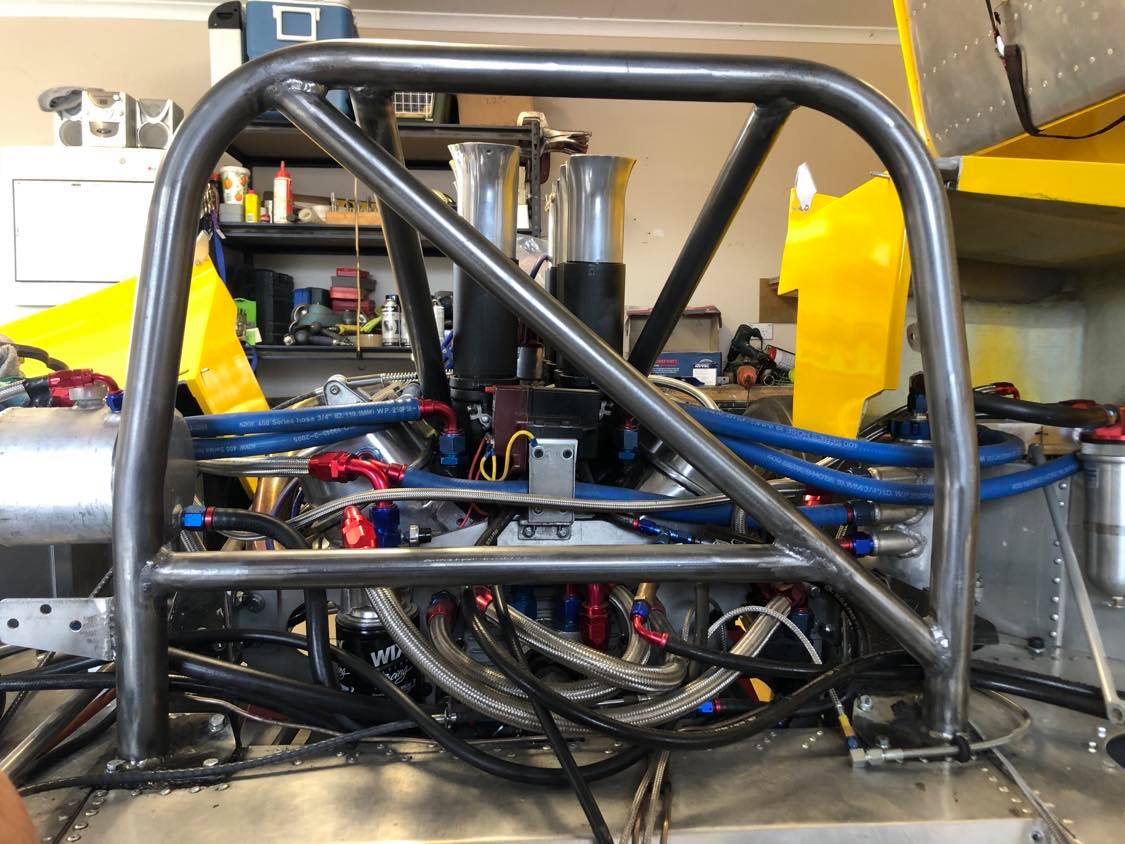

Hi people, I have had the word from MSNZ that my roll bar is good and my C.O.D and Log book will be issued in the next week or so which is a big hurdle crossed. I have been having an issue with no spark from the Mag. I spoke to a mate who runs midgets and sprint cars and also is the owner of a American speed shop here in New Plymouth. I tried a different coil I borrowed from him and no joy. so I took the generator off the base and spun it with a drill and we get spark!!! He said they had the same issue in the past and its because the starter can't turn the engine over fast enough. Not a problem for sprint cars because they push start them. I'm thinking of 24 volts up the starter to get it to spin quicker, any ideas anyone ???

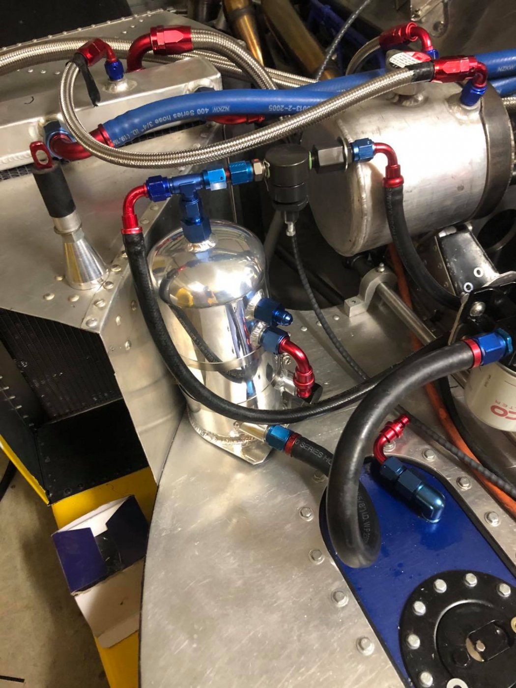

Well we had a day of trying to start the car and we were able to make a noise if only for a second at a time. The 24 volts was the trick to getting the starter to spin the engine fast enough to get a spark. The issue now is the fuel system, I have to add a surge tank as the pump doesn't like to pull and the tanks are lower than the pump and getting it to prime the system doesn't work. A surge tank will sort this issue. Thanks for your guys input, its always welcome and it good to bounce ideas of each other. Udo you are right about having good batteries it made a big difference when we got it right.

So...a question I have is about the surge tank. For this to eliminate your problem, you would still need to get fuel to the surge tank, which would mean a pusher pump at the main tank (regardless), to fill the surge tank? So either way, I'm thinking a relocation of pump is needed as well? Is the surge just an added benefit of uninterrupted fuel flow?

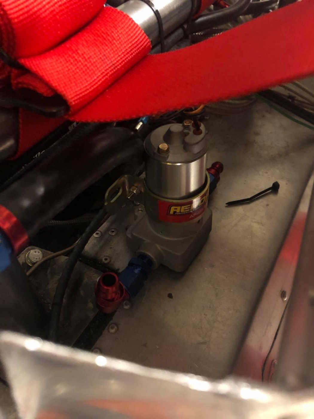

Hi Terry, The reason for the surge tank is to give the main pump a head to pull from so a lift pump will keep the surge tank full and all the by pass lines will go back to the surge as well. The High speed by pass and the secondary by pass are on the top of the tank the primary by pass still goes back to the left main tank, the surge also has an over flow going back the right side main tank. the lift pump is in behind the seat. it will have to draw direct from the battery as the car has no charging system.
A little more clarity, the original cars have a belt drive fuel pump which is located down low on the motor so the head from the main tanks keeps the pump fill. my pump is cam driven and is at the same level as the top of the main tanks, hence the need for the surge tank.
Another hurdle over come today. Finally got the engine to run in the car. It has taken some changes to the fuel system and the ignition system, we have given up on the Mag and put in a MSD. The Mag was just too hard to get started and was going to start wrecking stuff so as much as I resisted changing in the end I bit the bullet and It wound over a couple of time's and burst into life and everything was good, oil pressure, fuel pressure, throttle response is instant though I only gave it a few very small blip's it's obvious it's going to be a beast. Next step is some testing on the track.
