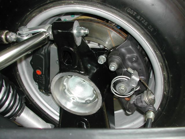

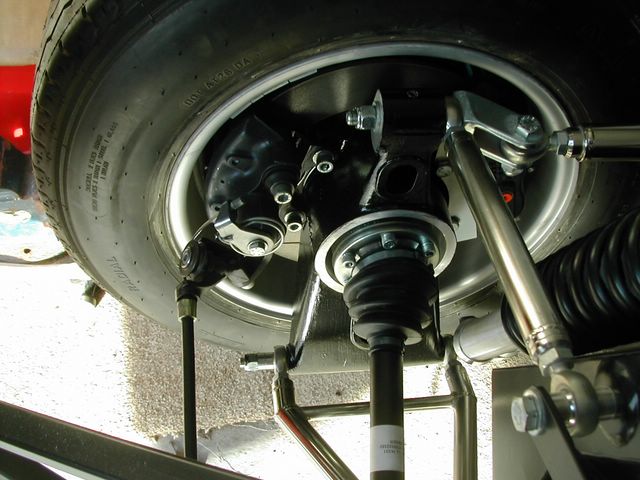

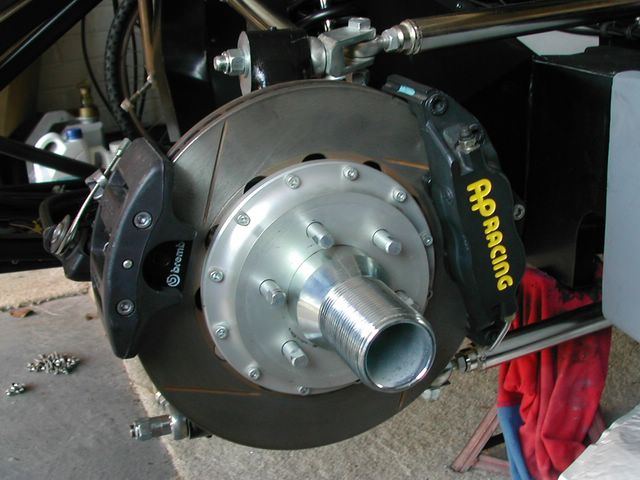

I've painted my rear uprigts and installed the rear brakes. AP Racing 4 pots with Brembo independant handbrake calipers.
Also installed the Driveshafts on the hub end.
Also taken a box full of bits to the powder coaters, so it should start to look quite good soon.:)
Martin

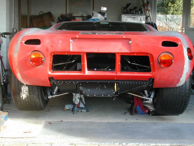

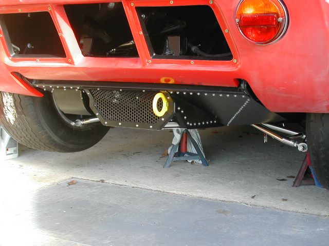

Just got back from the U.S today and managed to pick up some Megaphone tail pipes. Not sure when I'll ever use them but they look fun.
I also picked up my powder coated panels so was able to finish off the rear panel work.

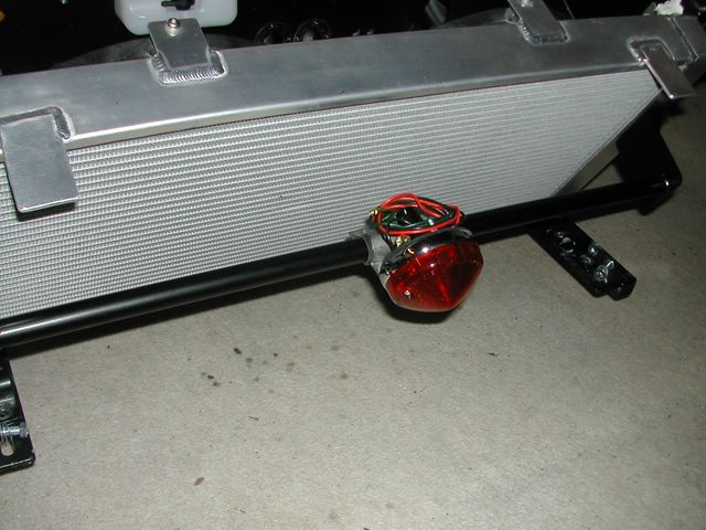

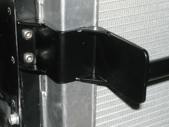

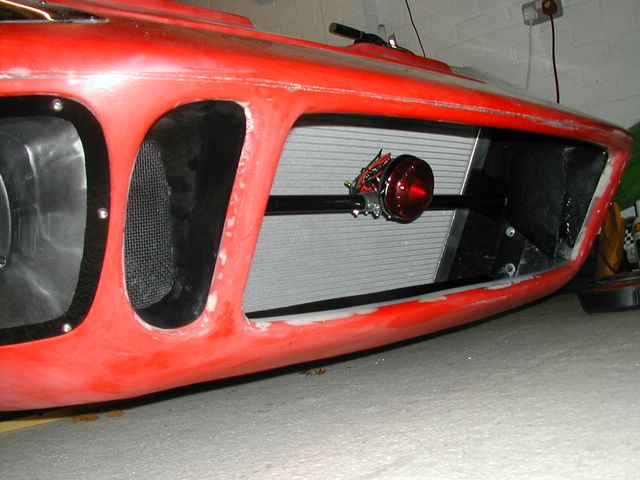

Attached the front cross bar to the chassis using M8 bolts. Then I spent all afternoon fabricating a bracket to hold my front marker light. I'm very happy with it. Unfortunately I can't move the car into a good spot for photos at the moment as the back is in the air but I should get some better shots soon.
Martin

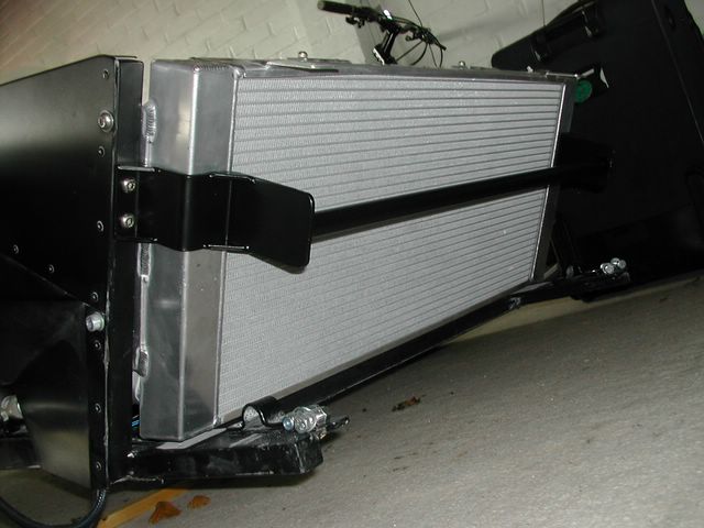

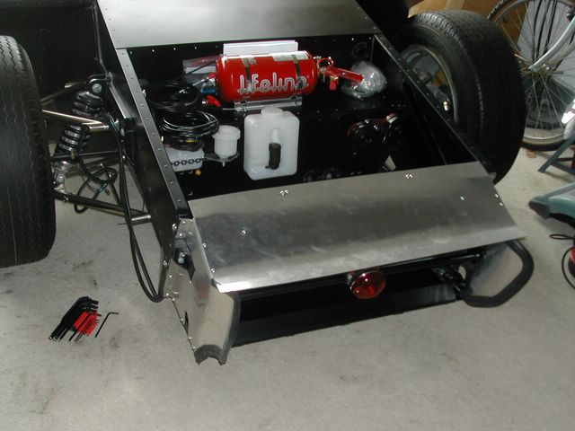

Attached my top deflector plate which directs air into the rad and stops it escaping over the top.

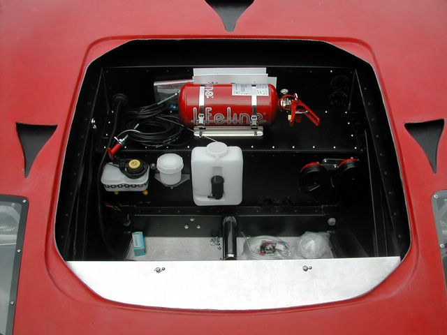

I've also partly installed a mechanical fire system. Mounted the bottle anyway.

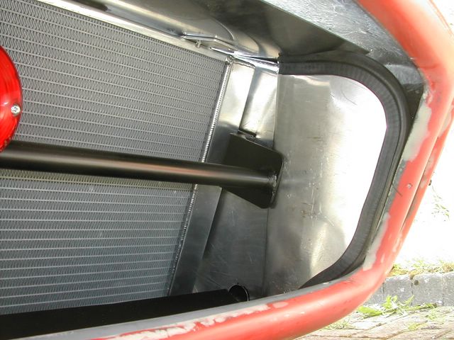

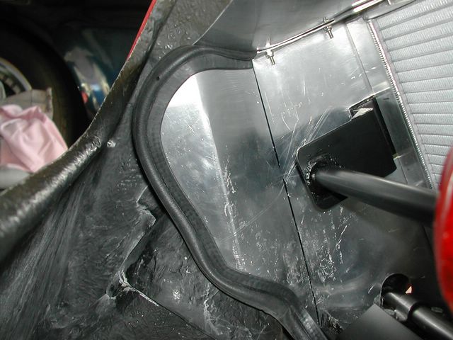

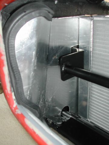

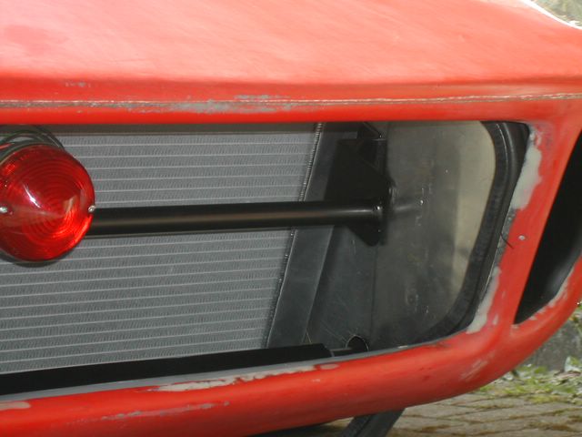

I've made up the side plates to complete the job of directing air into the radiator. The plates snug up to the front opening using a weather seal. They will eventually attach to the chassis but I've not drilled and tapped the holes yet. They attach via M4 bolts and lock nuts to the top plate. The left and right sides are slightly different as I've left enough space to fit a tow eye on the drivers side. All panels will eventually be black like the rest of the car.

Martin, very nice work on containing the radiator air flow. I may have missed it, but have you placed something to seal the bottom of the rad? I laid some ABS plactic on the "floor" of the frame in that area. Since the rad is at such an angle, I thought that incoming air might glance off the rad and flow under the car. I think this made the most difference of all the cooling mods I've done.
Thanks Mark for taking such an interest in my build. I did indeed tackle this area. My solution is on page 9 of this build log, about half way down. Before it's all finished, any small gaps will be filled by using self adhesive neopreme strips. It should be completely enclosed. The only mod I'll have to do retrospectively is to add grommets for where the air con hoses need to pass through. I just don't have the air con kit yet, so it'll have to wait.

I assume you will be taking the marker light off when you go for the IVA test? Don't want some jobsworth pulling you up saying there is a potential for it coming on whilst driving. It looks red to me, and they would probably give an automatic fail.
Brett
Hi Brett,
Yes, it will be removed. There are lots of things that will change for the test. I'm building it with half an eye on the test and the other half focused on the way I want it in the end. I do want all the stuff on now though so I can see what I'm aiming for. It will take some time to re work parts of the car for the test, but hopefully i will have pre empted most things.

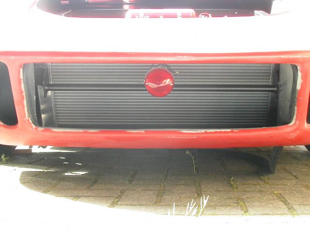

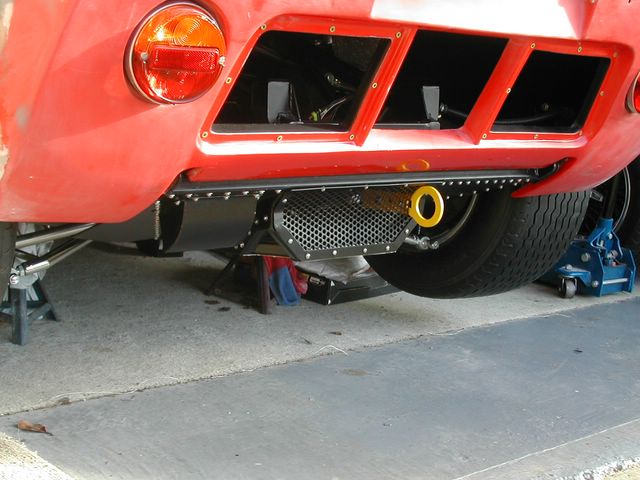

Here's the final assembly at the front for directing the air into the Rad.
