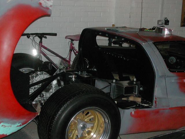

Finished welding up the frame and mesh for the gearbox cover and installed it. All it needs now is to be powder coated black.

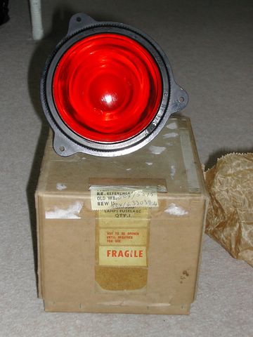

I've managed to find an original Le Mans marker light (From a WW11 Lancaster Bomber) in it's original packaging from another forum member, Craig B. Very pleased with it as I've been searching for some time for one. :thumbsup:

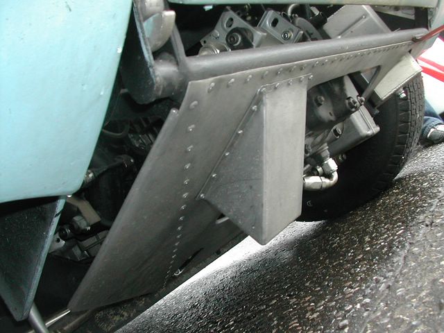

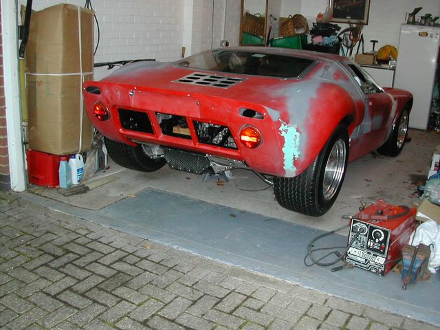

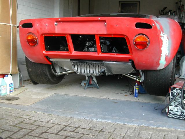

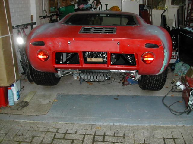

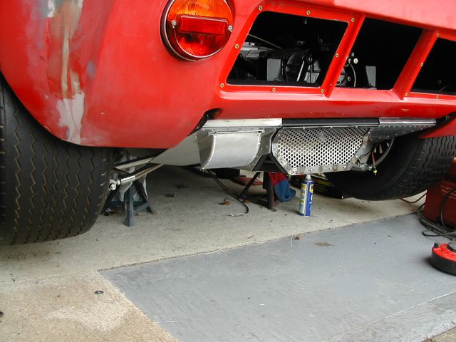

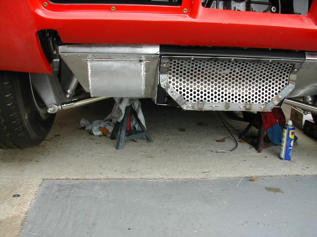

O.K, before the black goes on, one last mod. A duct to take air from under the car and onto the transaxle oil cooler (coming later)
Martin,
I too want to make the bottom of my 40 a little more slippery. However, I think your duct is in a negative pressure zone. The object of the section coming up from the bottom of the car in back, is to hold it down much like an airfoil on the top, but with negative pressure. I am sure there are those here that know more than I about this. I would check that out with someone who knows about air flow. BTW I love your build. You are doing a great job of personalizing it.
Thanks Bill,Steve,
I know the duct negates some of of the airflow but I'm also trying to replicate as close to original as possible. Here is a photo of the bottom of an ariginal MK1. You can see where I was going with it. 1075 has a more curved duct, and that's what I chose to replicate as mine will be a gulf spec car.

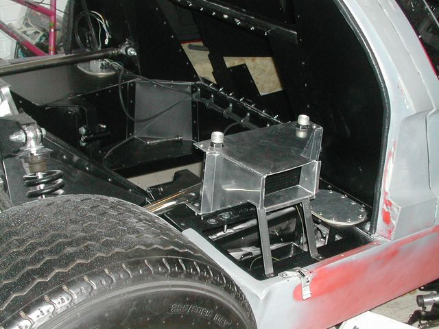

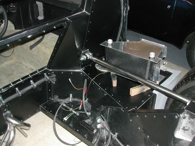

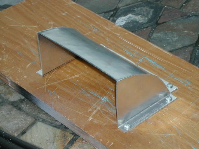

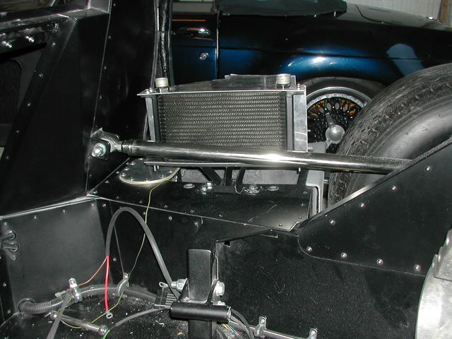

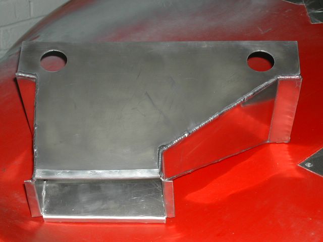

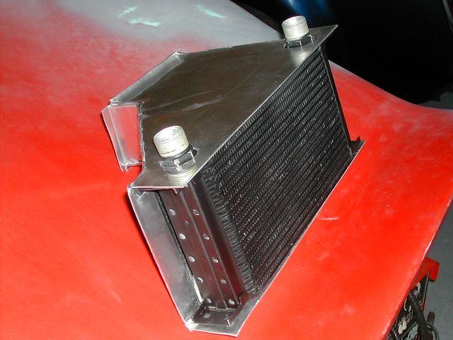

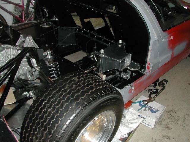

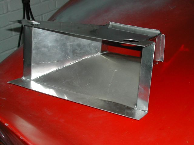

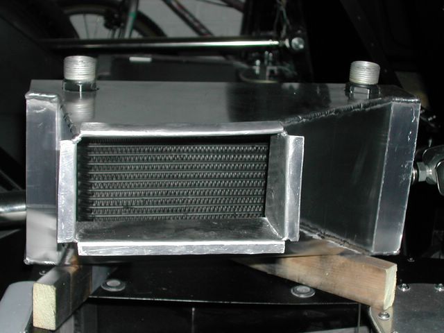

I wanted to utilise the original ductwork that I installed some time ago in the rear of the car so I've made an air box to channel the air from one of the ducts into my engine oil cooler. I fabricated this to mount about 2" above the bed of the chassis at that point in order to avoid any clearance issues with the battery which is located in that position on my MDA. Next is to make the bracket and secure the oil cooler to the box.

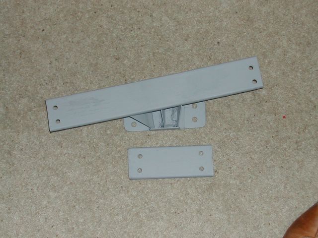

Brackets complete.
This was hard work getting everthing aligned and secure but it's turned out well. The support brackets will be satin black once I get everything together for powder coating so thy will blend into the background.

hi martin .....loving the vents.....when do you think you will have your car finished, any ideas on colour schemes????you going to try and get it finished before the SVA changes??
james
Hi James,
No chance of getting it done before the test changes, but I am going for stack injection which should give me reasonable emissions. Exhaust db should be o.k too with the MDA silencers and the other mods I can handle. I'm making sure everything I get is E-marked.
Colours will be Red with white stripes. Probably Rosso Corsa, as I've seen others in that colour and it looks great on a GT. Although I'm replicating a gulf style car, I've shyed away from the Gulf colours. Not sure about finish date and i don't want to push myself too hard but realistically, I'm thinking Classic Le mans 2010. Should get my engine soon, then I have all the major components minus the brakes.:thumbsup:
Here's hoping for a prosperous 2009.
Martin
Hi Martin
Great work. Just would like to share some "thinkings" about the ducting for the gearbox. I don't have the magazines here, but I remember, that the linden green spider was a feature in one of the last classic car magazines. There, you could see the ducting for the cooler.
I don't know the position of the cooler. Regarding your photos, I suppose, it is on the front of the hole, you have cut out for the duct (in driving direction).
If yes, there would be (for me) several risks: If you are in the gravel, or if you have mud, the part is like a shovel. Even if you protect with solid grill, this would be too risky for me. I also don't know about the "air-flow" in your engine bay. If (always in driving direction) the air will arrive on the backside of the cooler, you will produce a counterflow. So why dont you just put this beautiful duct inside, in front of the cooler, make the hole in the backplate and cut in the back plate some ventilation slots.
Further advantage of this layout (if you have enough space inside) would be some kind of "heat protection" for your gearbox-cooler) from engine/header-side.
Don't missunderstand this, I am also thinking about, to make a gearbox-cooler. And I would like to try it this way.
Regards Marcel => And of course all the best for 2009.
