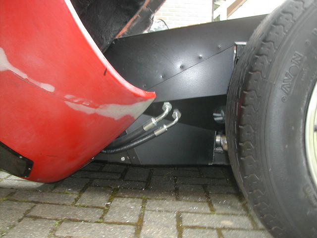

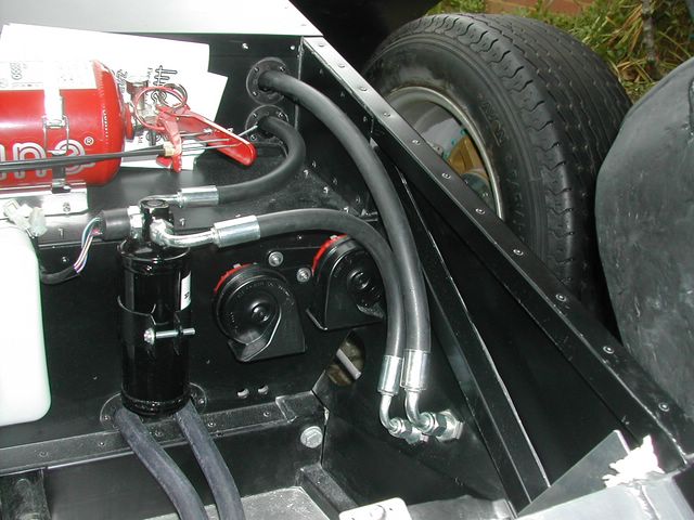

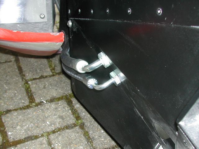

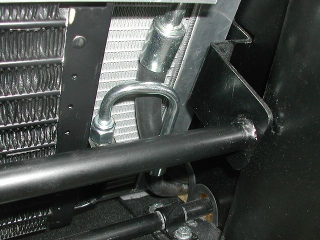

I had fun with the air con system today, running pipes and connectors. I bought some bulkhead connectors so I wasn't running pipes from the inside to the outside in one run. Thought that would make it easier to change them in the future and make for a neater installation. I'll have them crimped when I get the compressor and do it all at the end.

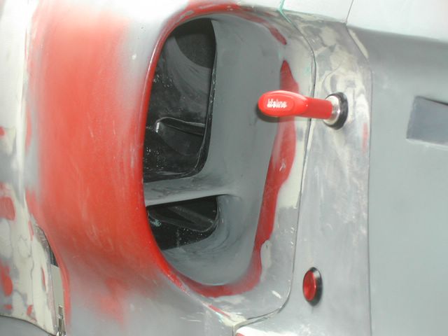

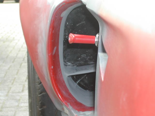

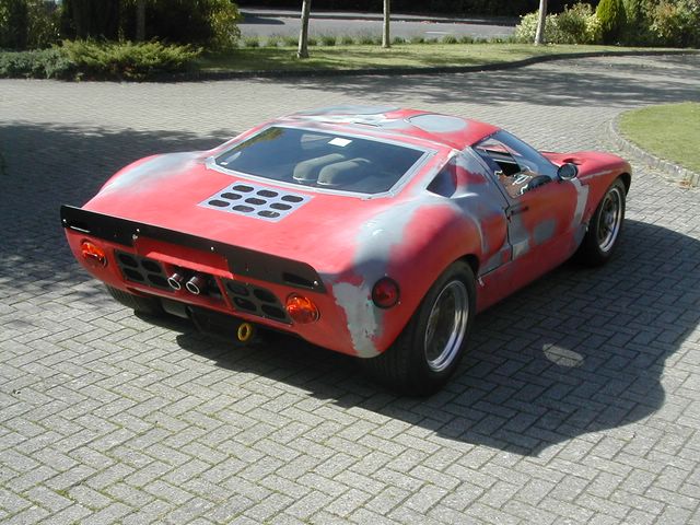

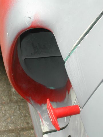

I decided to make a bit of a better job on the split ducts I have on the rear clip. I've blended the ductwork into the body so I can paint farther back into the duct.
Martin

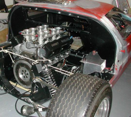

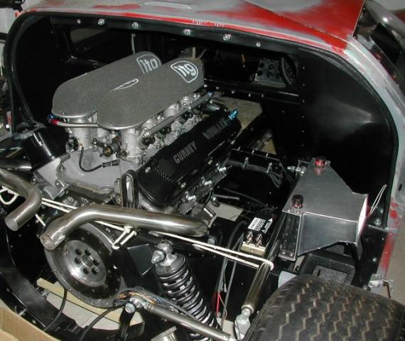

After a long long wait I am now the happy recipient of my engine. Mark Sibley delivered it over the weekend and we both fitted it together. It's a beautiful piece of kit. I can now, at last, make some real progress with the car. I've not stopped smiling since. I am so relieved that Mark came through for me in the end.
Martin

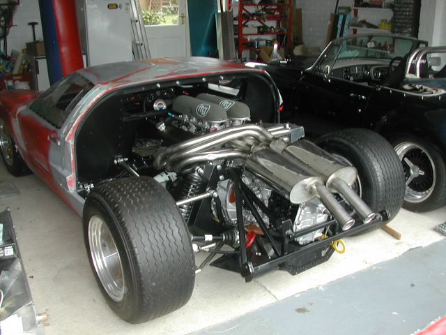

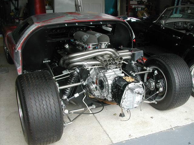

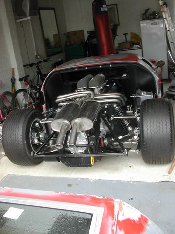

Today I fitted the clutch, made some measurements for my hydraulic clutch bearing then trial fitted the transaxle and exhaust. No major clearance issues, just some tweeking required. It's great to see all the major pieces mated together. I attached the rear bodywork last thing but it was too dark to take pictures.
Martin

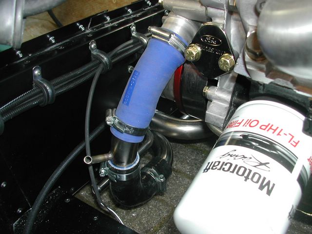

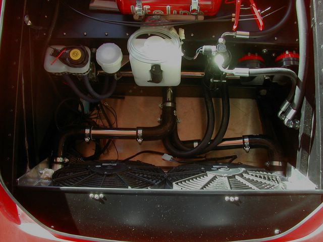

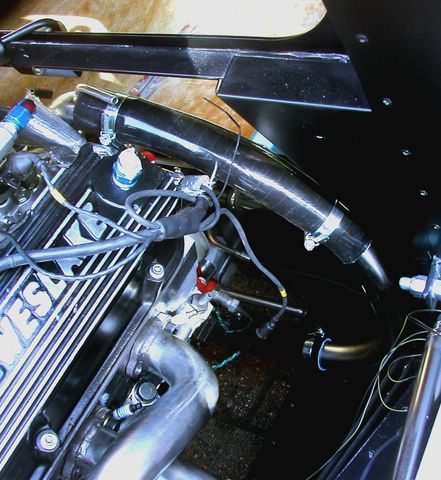

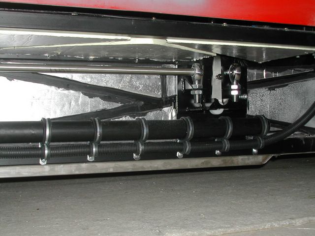

Finished installing all the remaining cooling pipes today. I got the majority of the hoses in black silicone to go with my basic theme of black and silver.
The only blue hose is the reducer which I couldn't get easily in black.
I also offered up both front and rear anti roll bars. I don't have all the items needed to finally fit them yet so they are just placed in position.
I also looked at the routing for the main ECU harness.
Martin

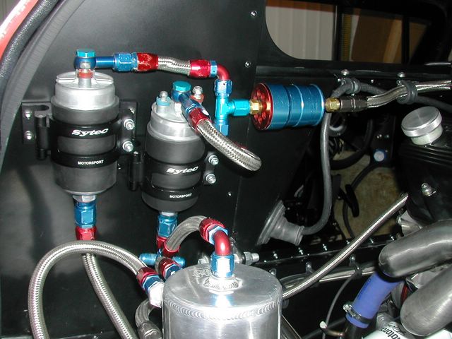

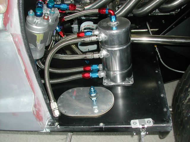

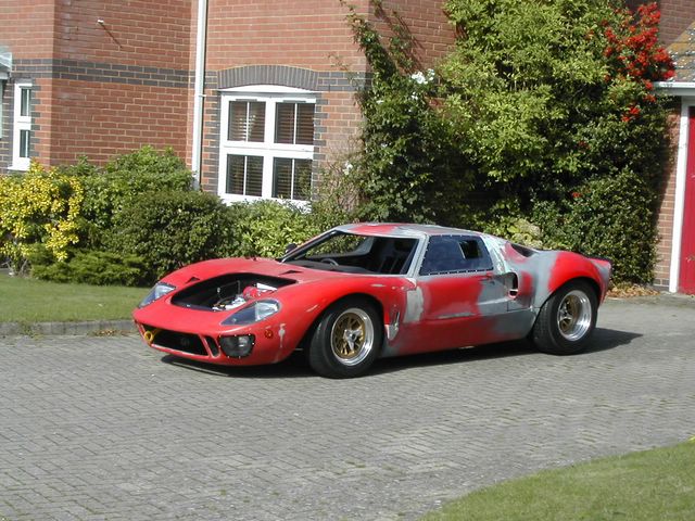

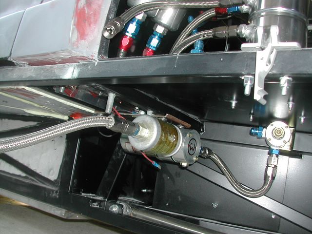

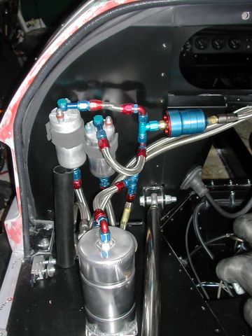

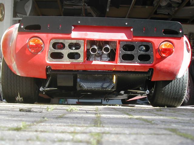

Latest progress. Decided on the location of the swirl pot. It's directly in the draft from the side vent. I've also loosely installed the high pressure pumps and on the passenger side under the pontoon, i've also positioned the low pressure pump, filter and regulator. Also run most of the lines with the exception of the bulkhead fittings, which I still need to get.
+ a couple of pics taken today in the sunshine. The one showing the rear shows my finished rear Le mans vents which I had meshed and powder coated black.
Martin

Today I fitted my high pressure pumps. I went for some rather expensive brackets to set them off nicely as the ones I got with them were poor. These came with sound reducing jackets too.
Martin

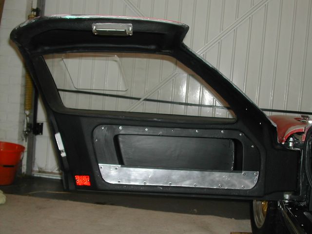

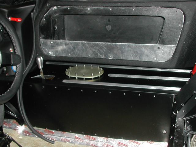

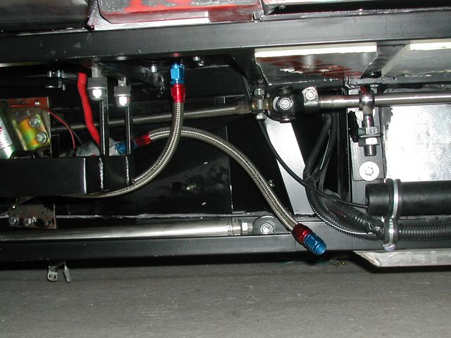

Made a start on the rod gear change set up. Located the front bracket assembly and cut the hole for the gearstick through the sill. Then located the next bracket and fixed it in position connecting the rods and UJ's to get the position for the next cut out in the chassis panel just behind and below the engine mount. The next part will be the tricky bit, but I don't yet have all the parts to complete.
I've also found a convenient location for the Motec ECU. It is completely hidden from view.
Also installed hand held fire extinguishers for driver and passenger.

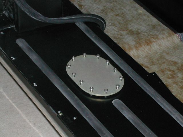

I've made sill ribs from extruded aluminium and these will be powder coated black so as to match the sill panel. I'll attach the fuel blanking plates and sill ribs once I am sure of the full throw of the gearstick as I want enough space in that area to make a proper gate for the gearstick.

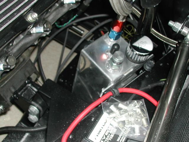

Positioned the catch tank, started finishing the door bins and added a reflector to the door.
