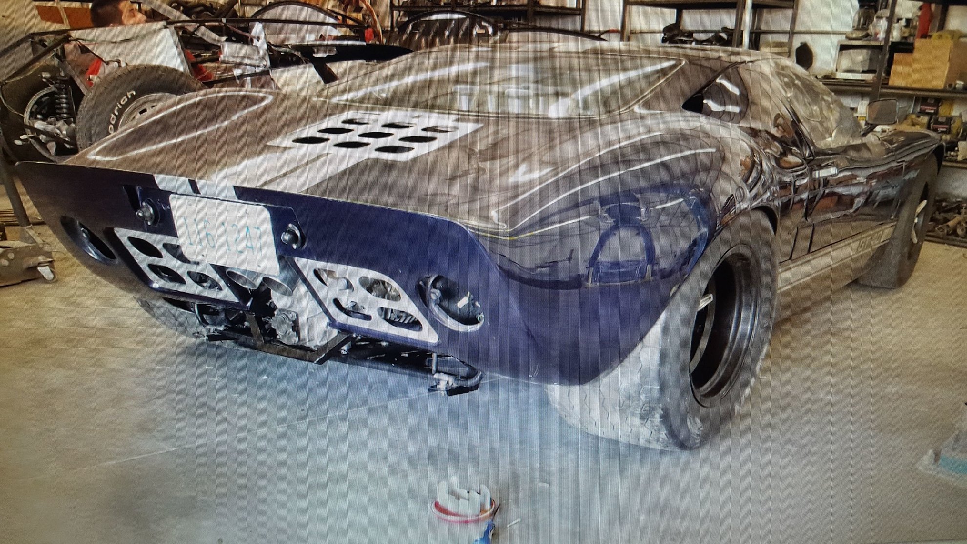

Jon, at the time I was having my SPF GT40 built, it was popular to use the new at the time Quaife transaxle. I chose the RBT because it is time tested, parts and service are readily available, and you get to select the ratios to suit your engine. It has performed perfectly behind a 440" 630hp motor for eight years now. For these reasons, I recommend the RBT. (BTW, I don't regret passing on the Quaife).
I've also got a primarily track/some street Porsche 930 with a 434" SBC that makes over 600hp. It has a 930 transaxle with limited slip that has never caused problems despite a huge number of track days on race slicks. So I'd also recommend the 930 transaxle as another, somewhat less expensive transaxle option for your car.
