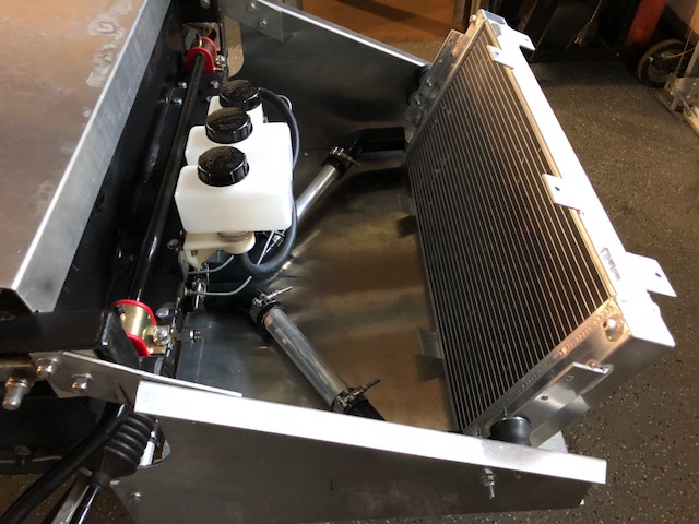

I’m building an Active Power Car also. I bought a used bare chassis that was never completed.

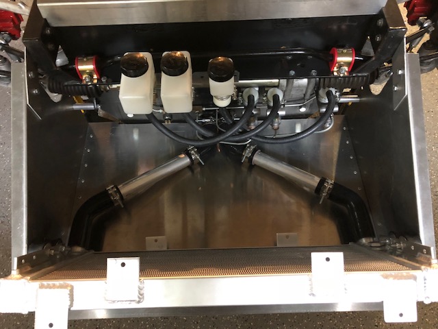

I’m starting in the front and working my way back. I just finished the cooling system. I’ve added the master cylinders, sway bar, steering, pedals and C5 suspension.
I really like this chassis.
Steve

Steve, you are doing an amazing job, looks great. Chris the owner of AP is very helpful and can get most of everything you need at a better price. I just ordered the engine and transaxle adapter from him at a better price. My roller is still a couple of months away and he sends me progress pictures. I tried posting a few but was unsuccessful. I will find a way and post pictures.

I’m going to start a build thread soon. I’m in no hurry, I’m taking my time and enjoying the ride. This is one of the most rewarding builds I’ve done.
I usually work on old cars that are greasy and filthy. This is a new build and everything is new and clean. I think I like this better!
I’m going with a Coyote engine and a Porsche transaxle.

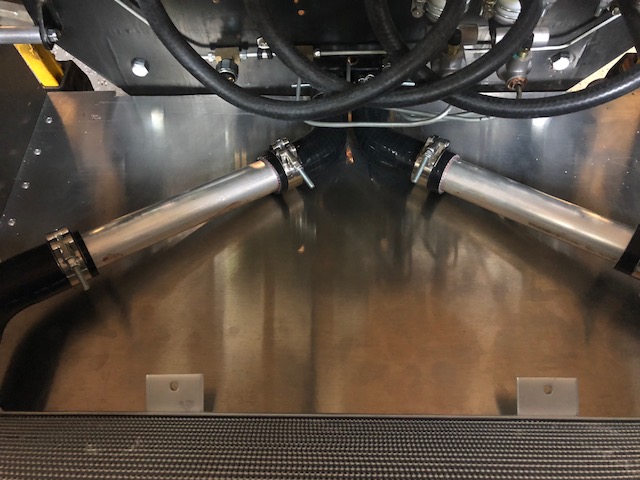

Just finished the cooling system today.
Here are some shots of the completed cooling system.
Keep me posted on your progress.
Steve

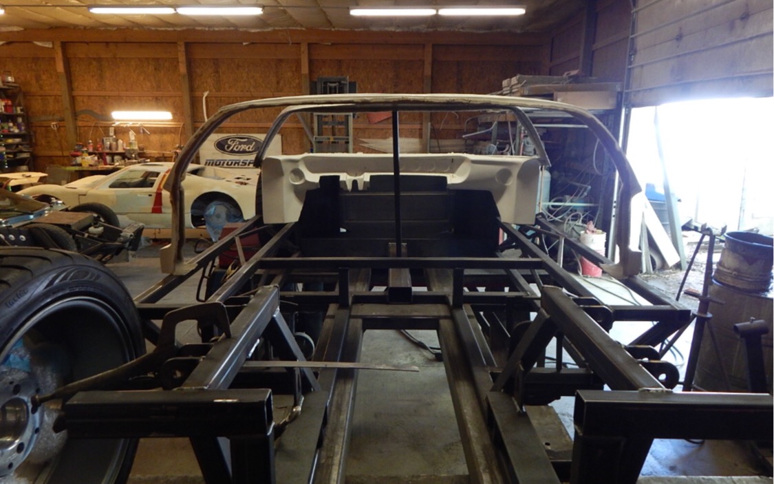

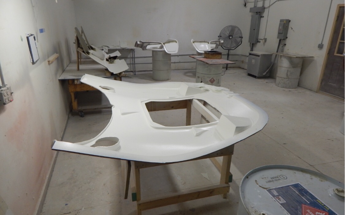

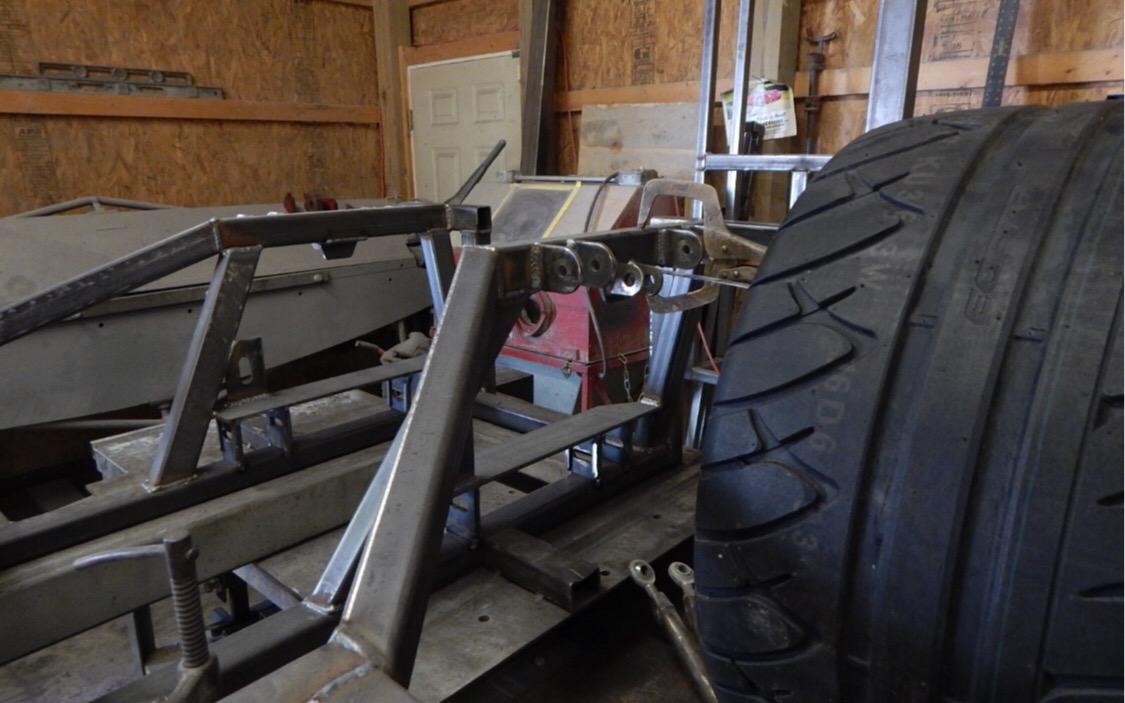

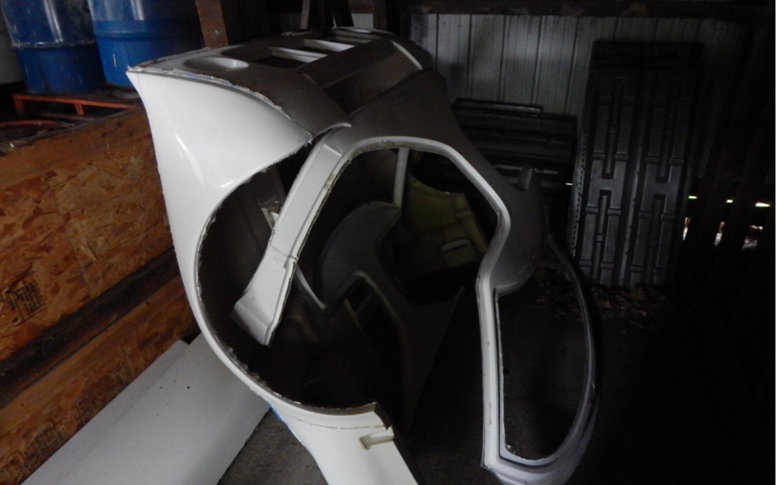

These are some of the pictures of the chasis and body work currently being done at Active Power. The chasis should be powder coated next week and 3 inch flares will be added to fit the 12.5 inch wide tires.

No, I’m trying to keep my cost (and marriage) in control. I bought an OPL radiator and it took some modification, but it looks like it’s going to work ok.
The cooling fans should be in this week.
Steve, your cooling system and the install looks great and without a doubt it will work. Keep up the good work.
