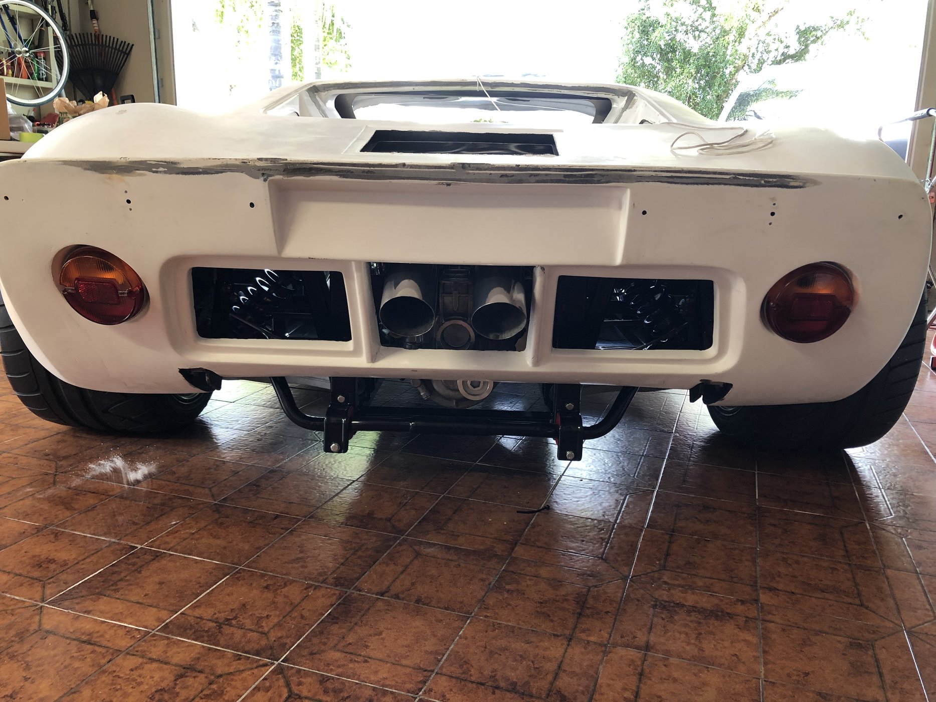

Rob the wheels are from Vintage. Fronts are 17x8 and the rear are 17x12.5. I ended adding 3 inch flares to fit the rear tires.

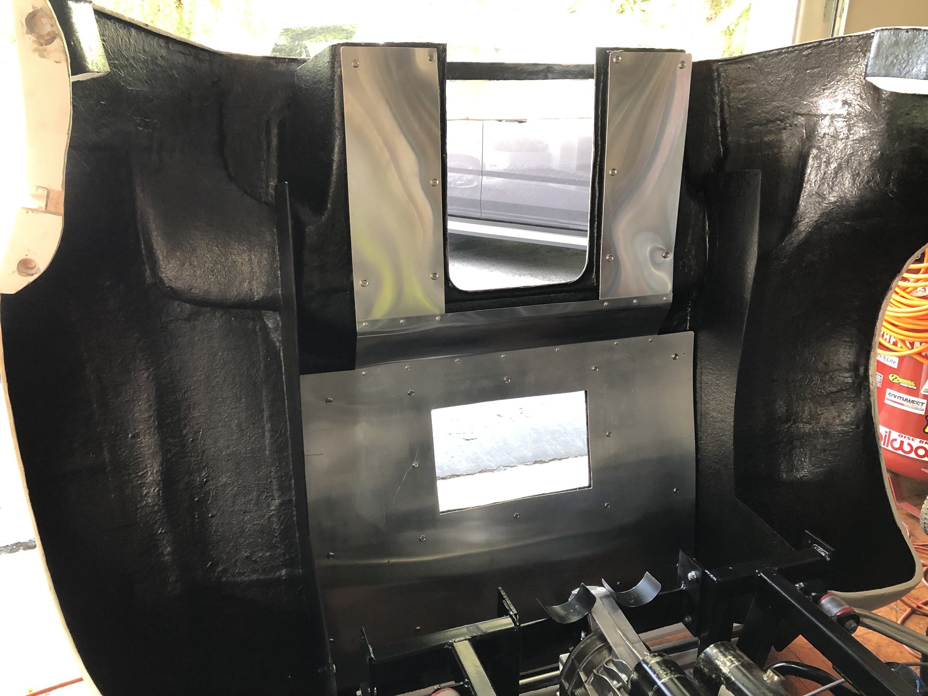

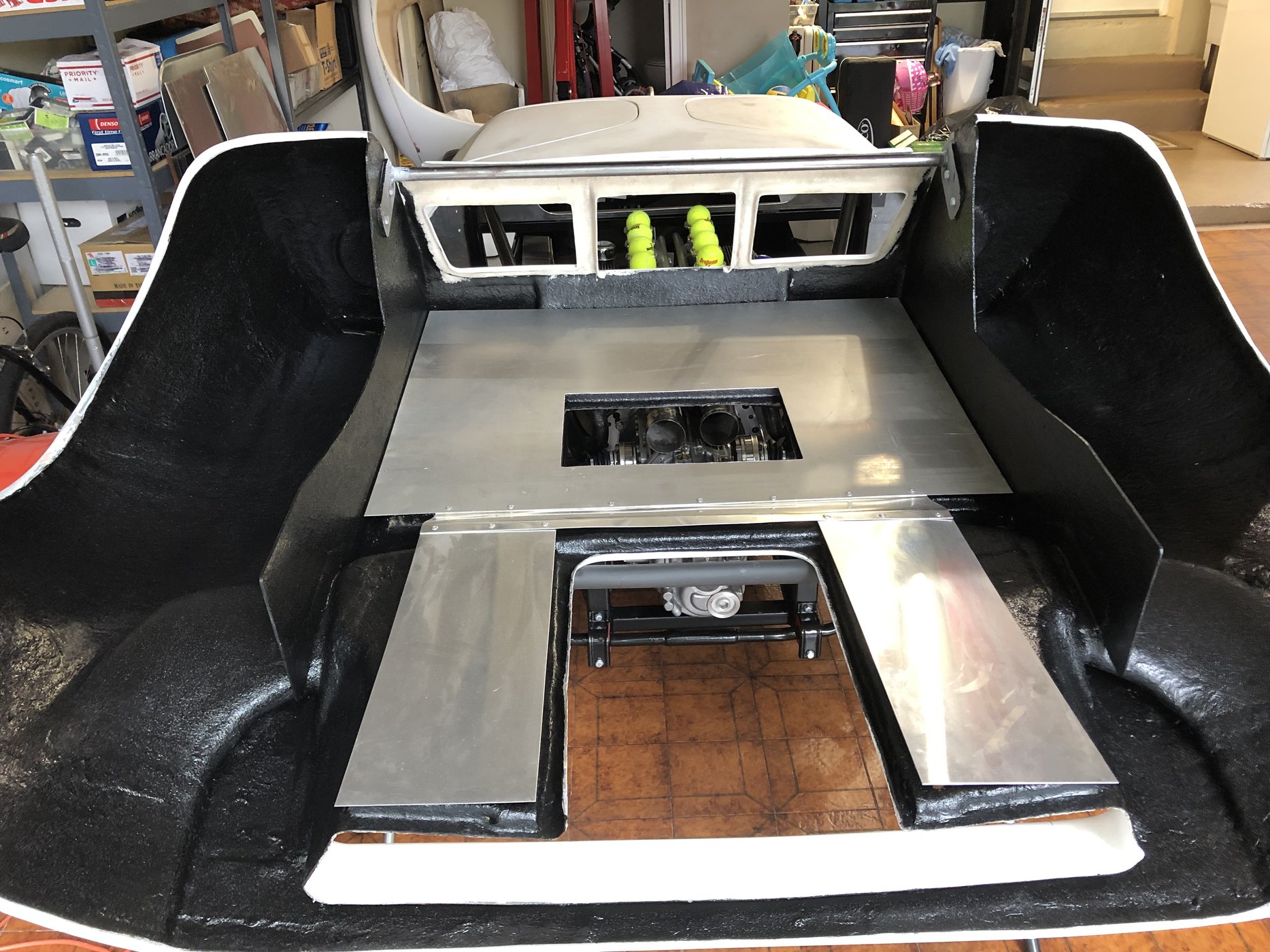

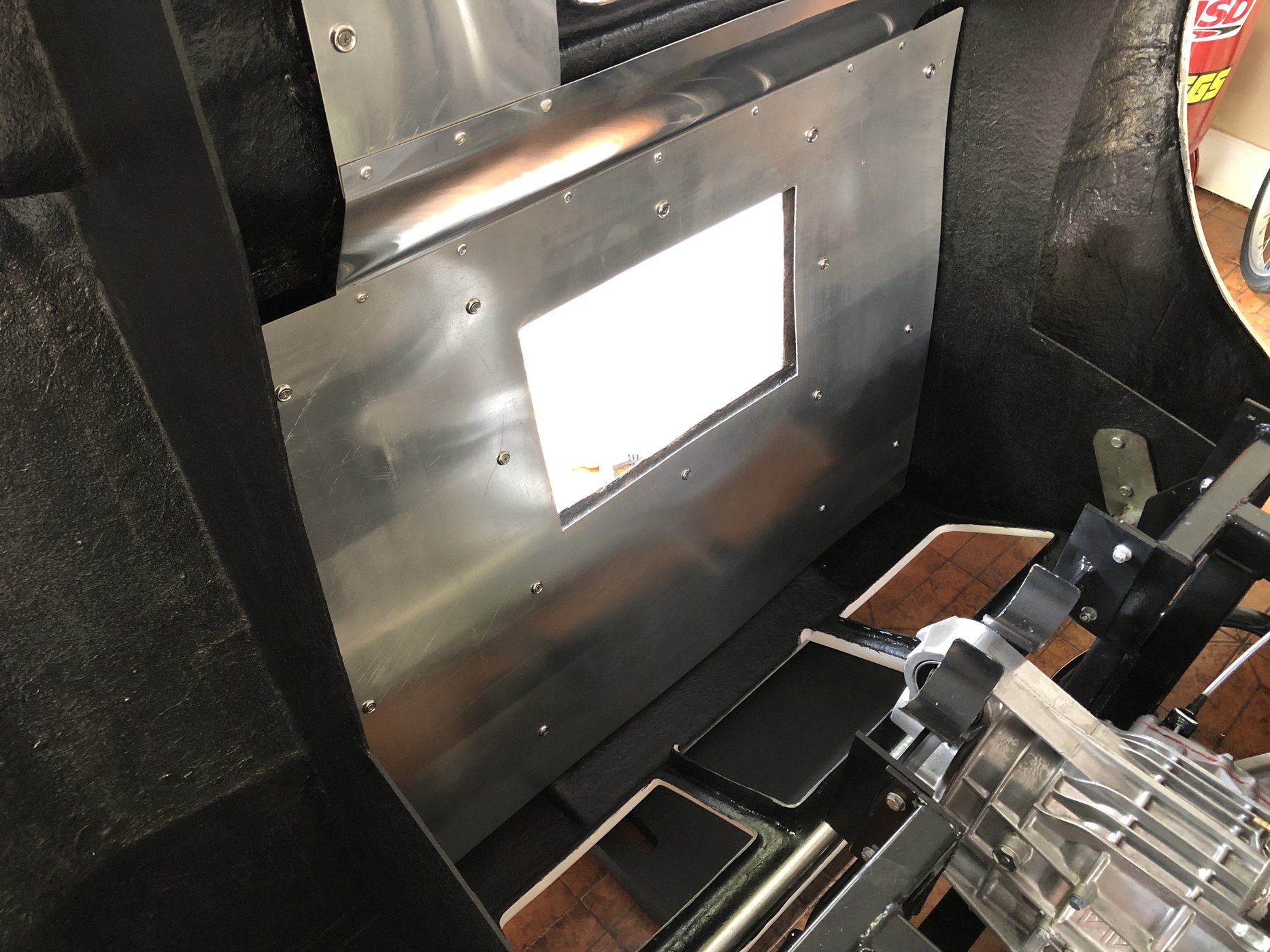

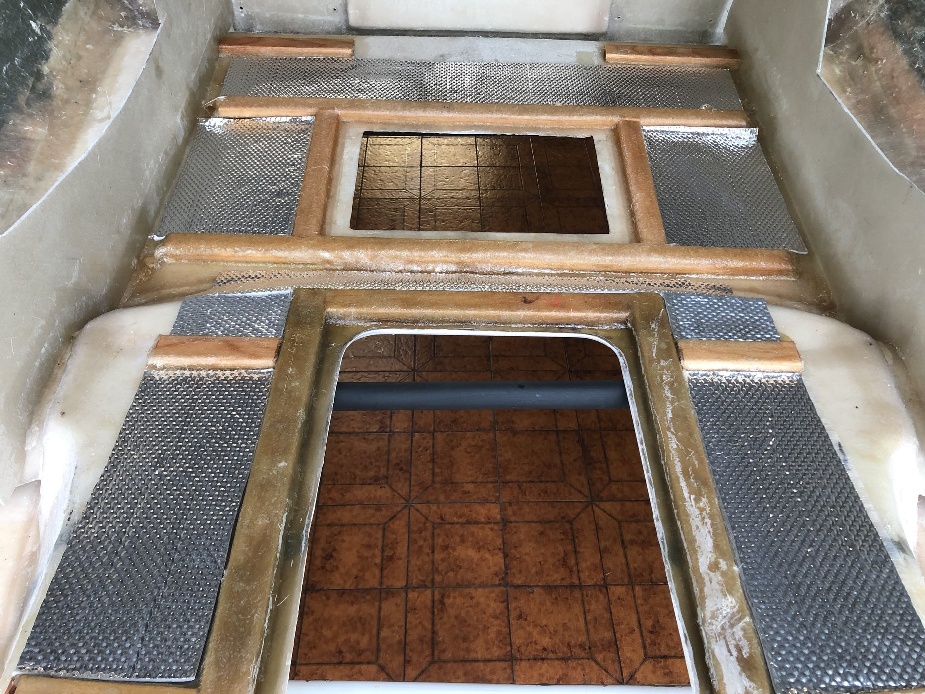

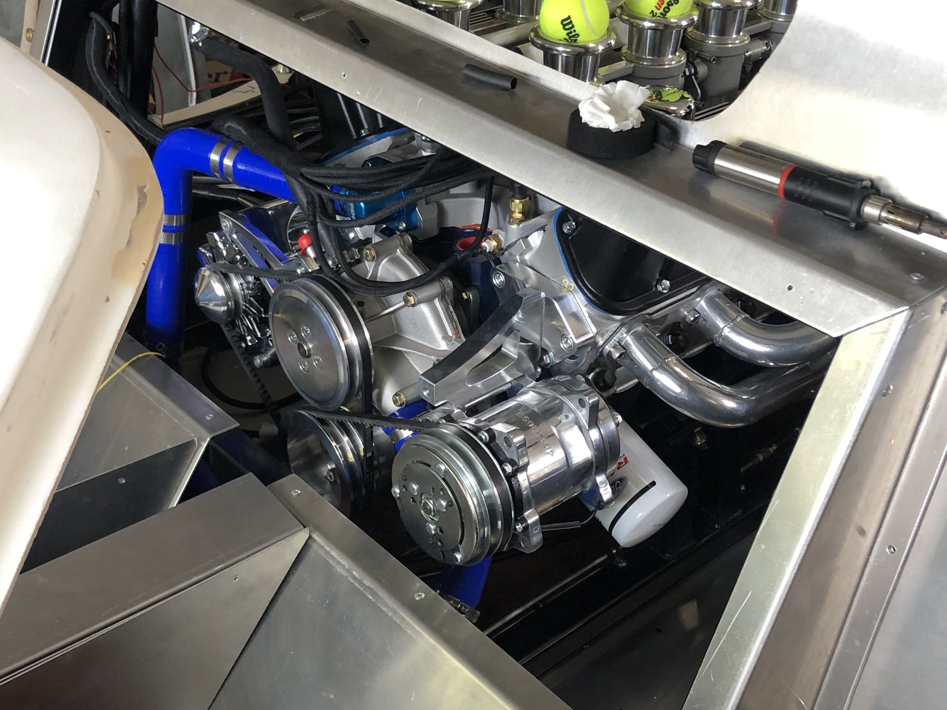

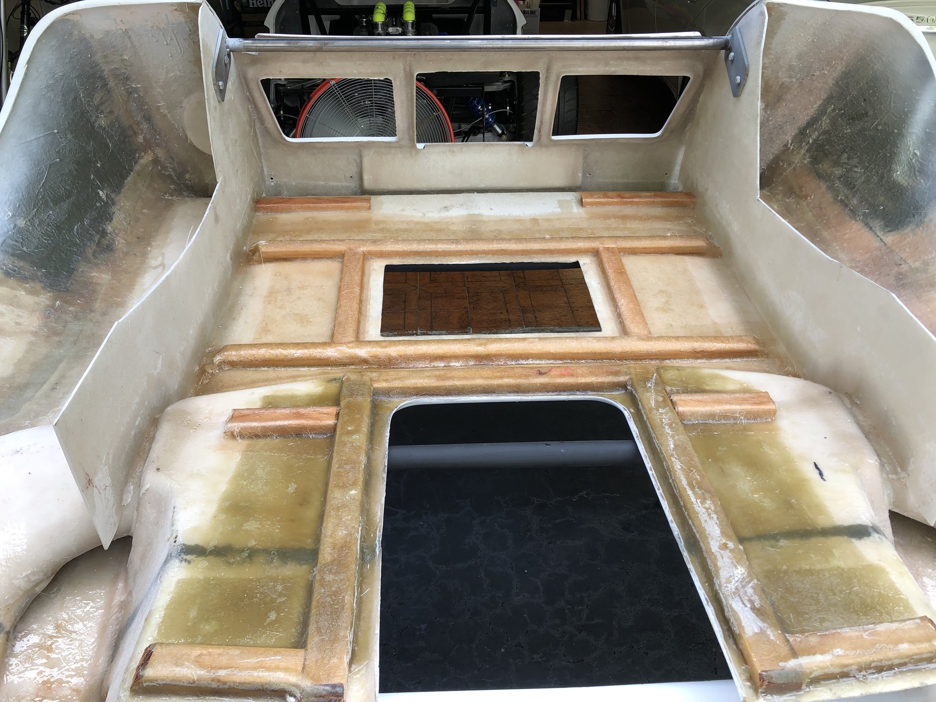

Used some of the ideas discussed in the forum and just completed adding strength to the rear shell and solving the exhaust heat issue. I fiberglassed 1x2 wooden strips and placed sticky shield as you can see from the picture. I then used aluminum sheets and created what I believe will work great.
I coated the shell with POR15

George, your heat shielding looks great. Glad you could do it before paint. Give some consideration to the vertical walls that are close to the headers too. I guess you saw my solution.

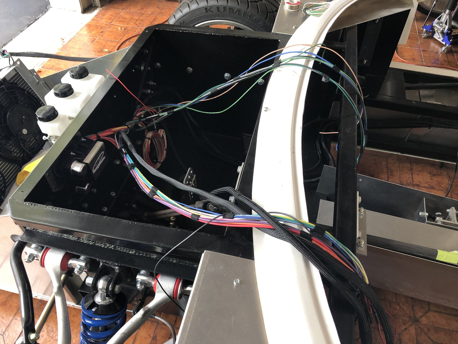

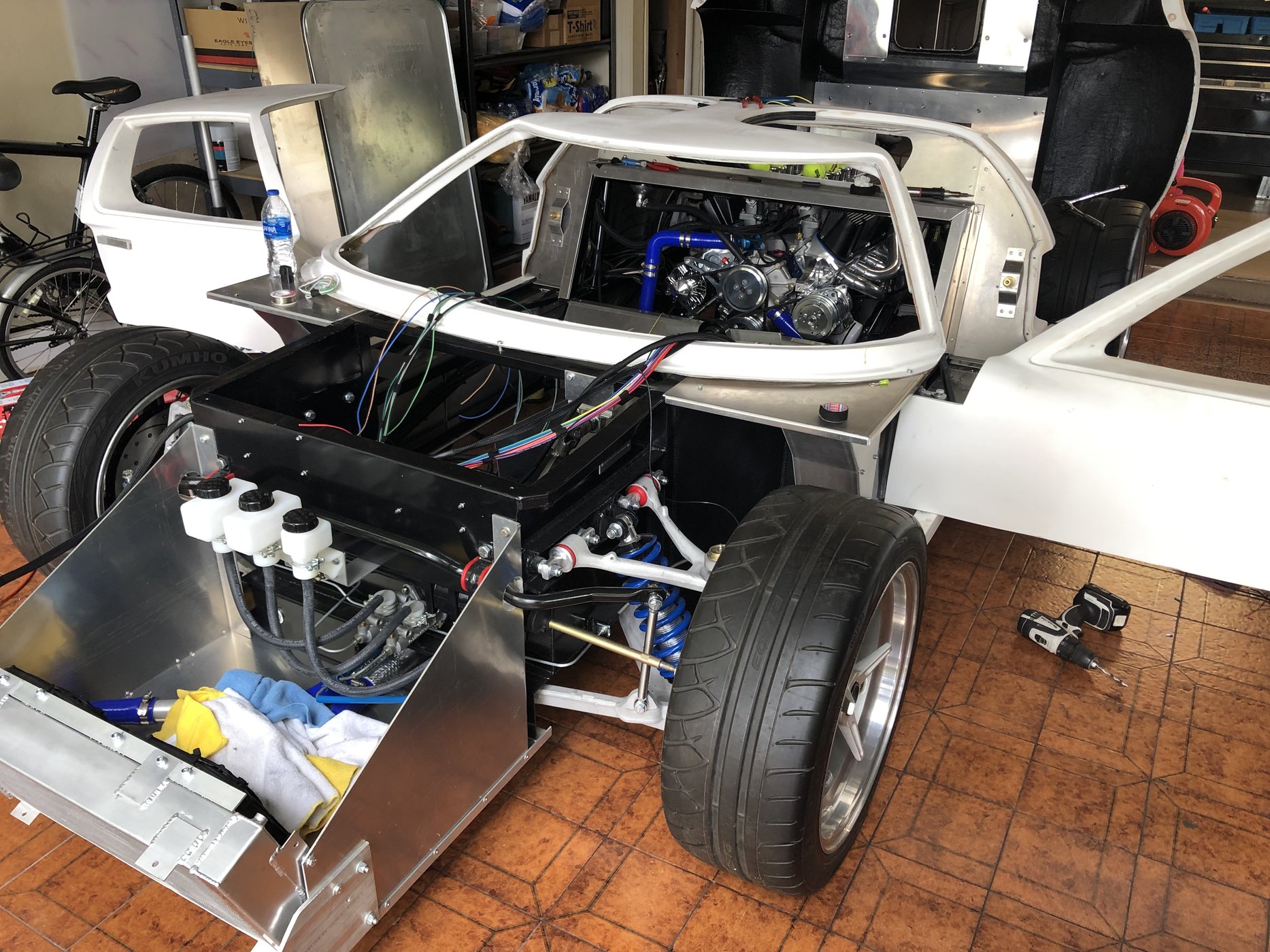

So far its been fun and currently working on the wiring and fuel cell plumbing. Planning to start the engine by the end of the month and hopefully with no leaks.
