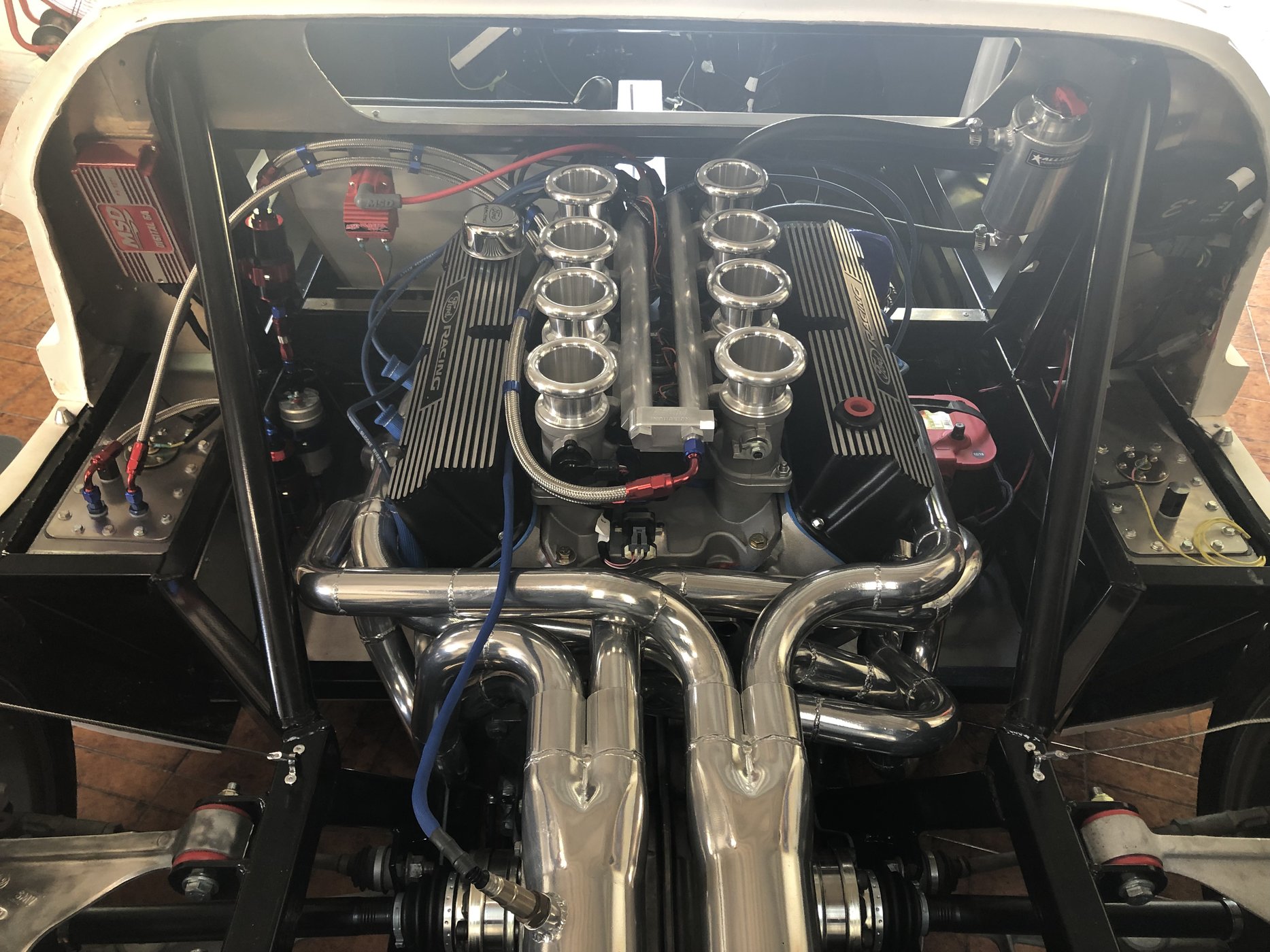

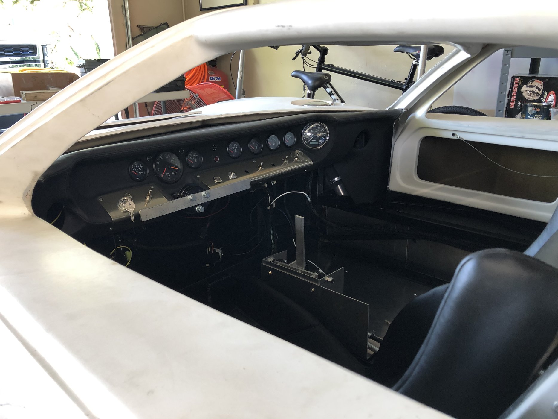

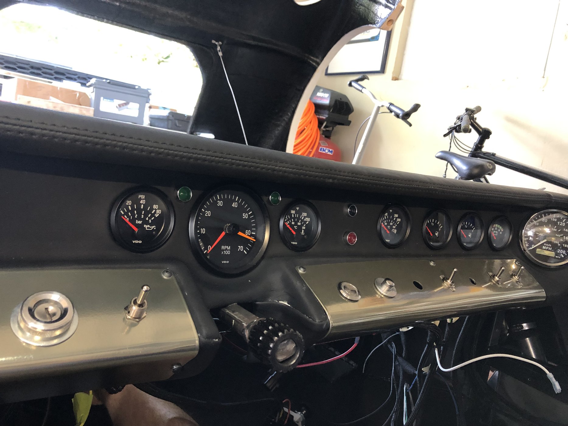

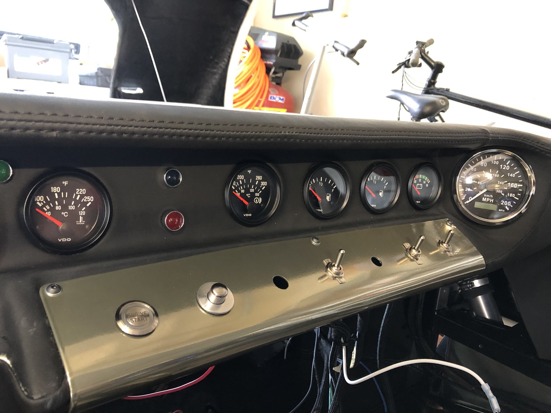

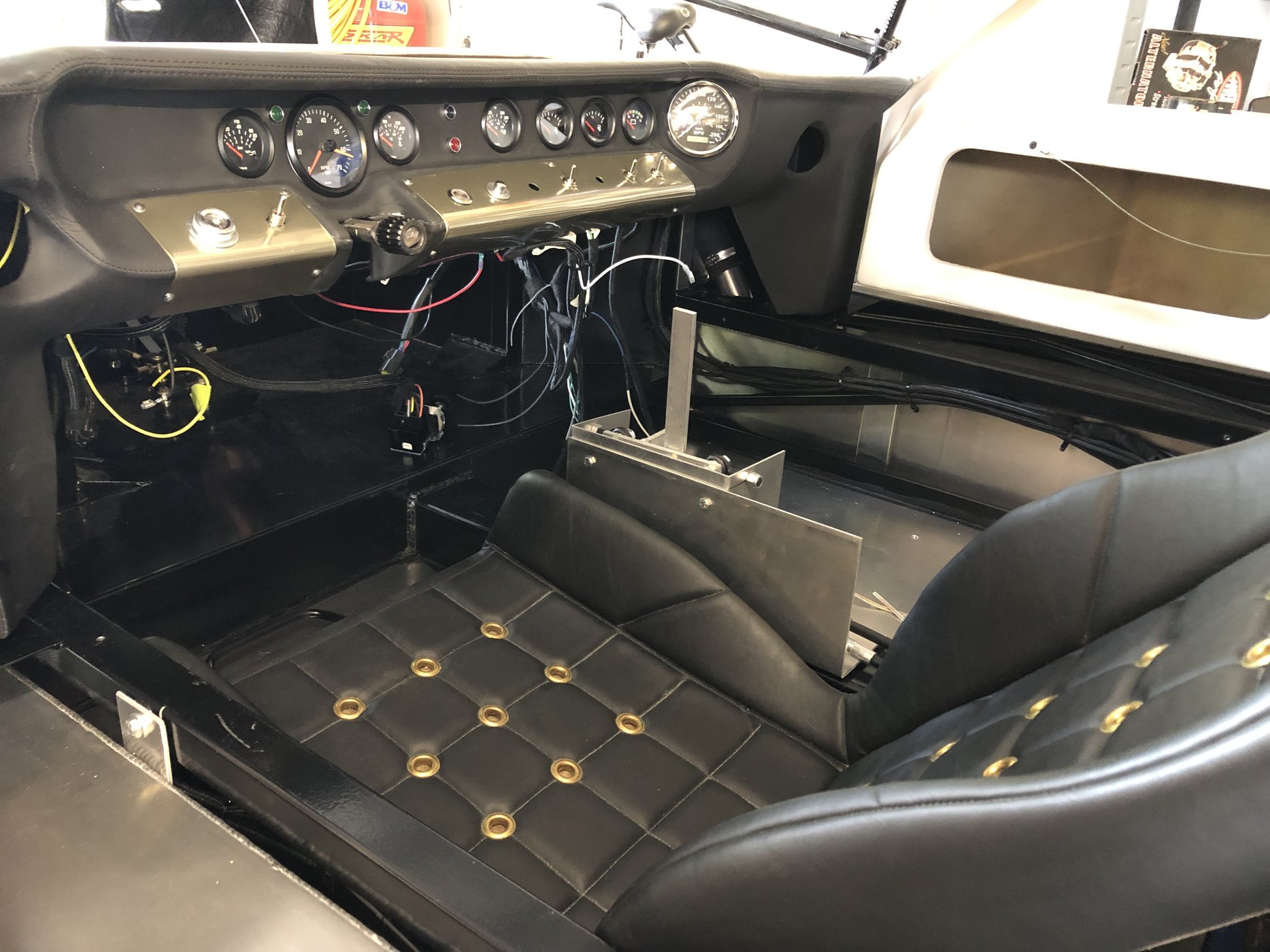

Dash and wiring almost completed. Plan on starting the engine Saturday.

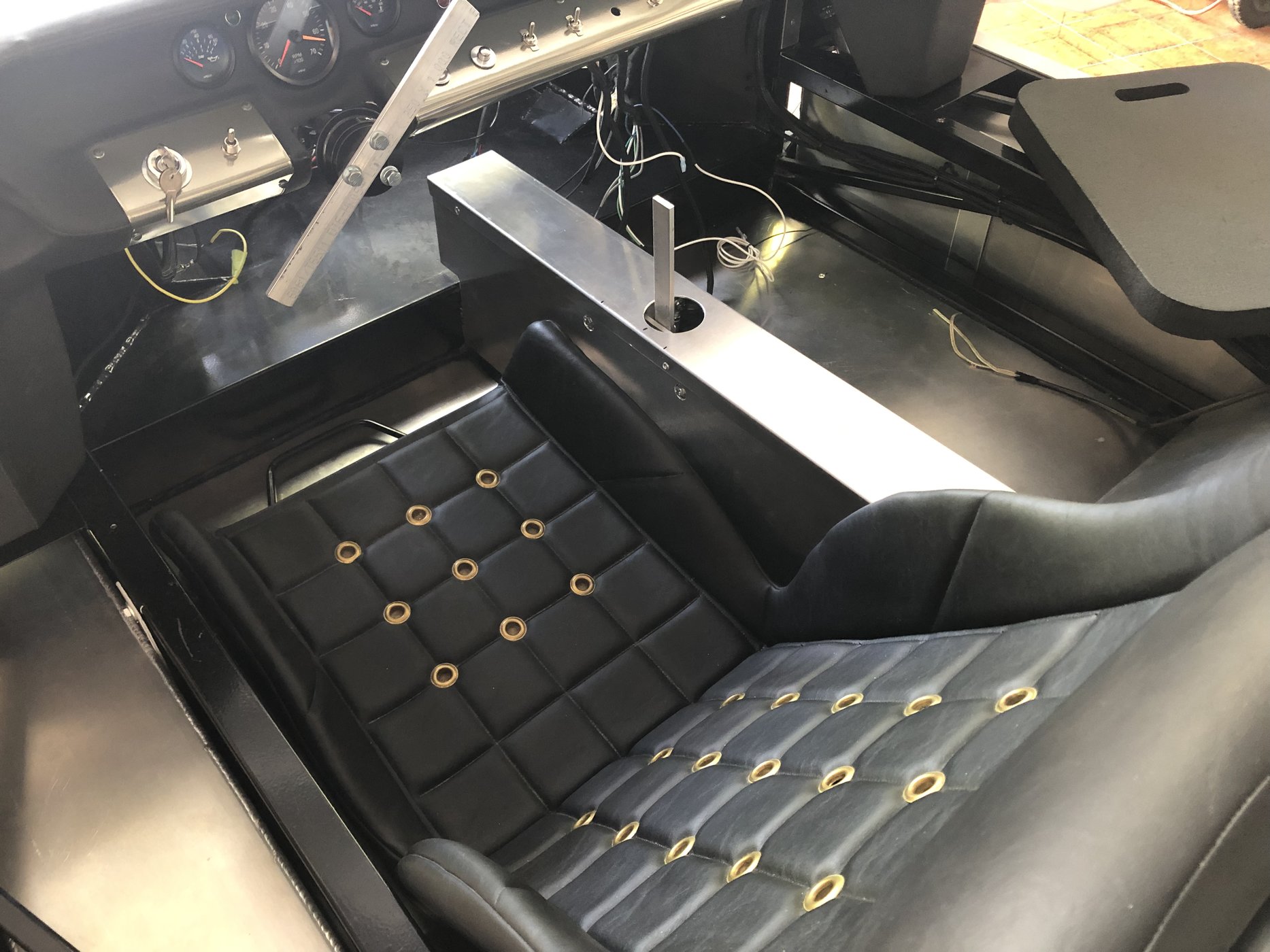

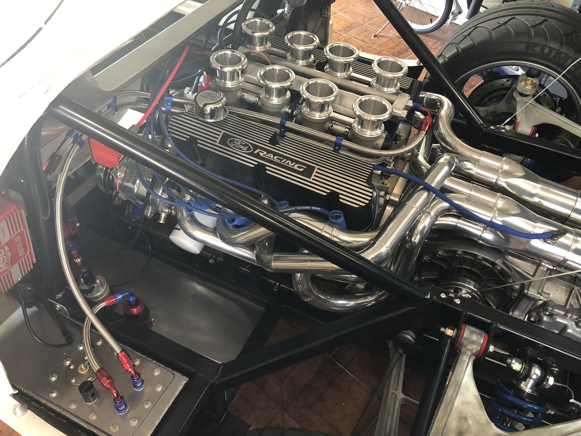

Electrical and all plumbing completed. Shifter and cables attached and working great. Mounted seat sliders to both seats. On the first attempt the engine fired up and ran great with Ed, a Borla technician, on the phone. He provided the necessary information for the first startup. Now in the process of finding someone for the bodywork and paint.

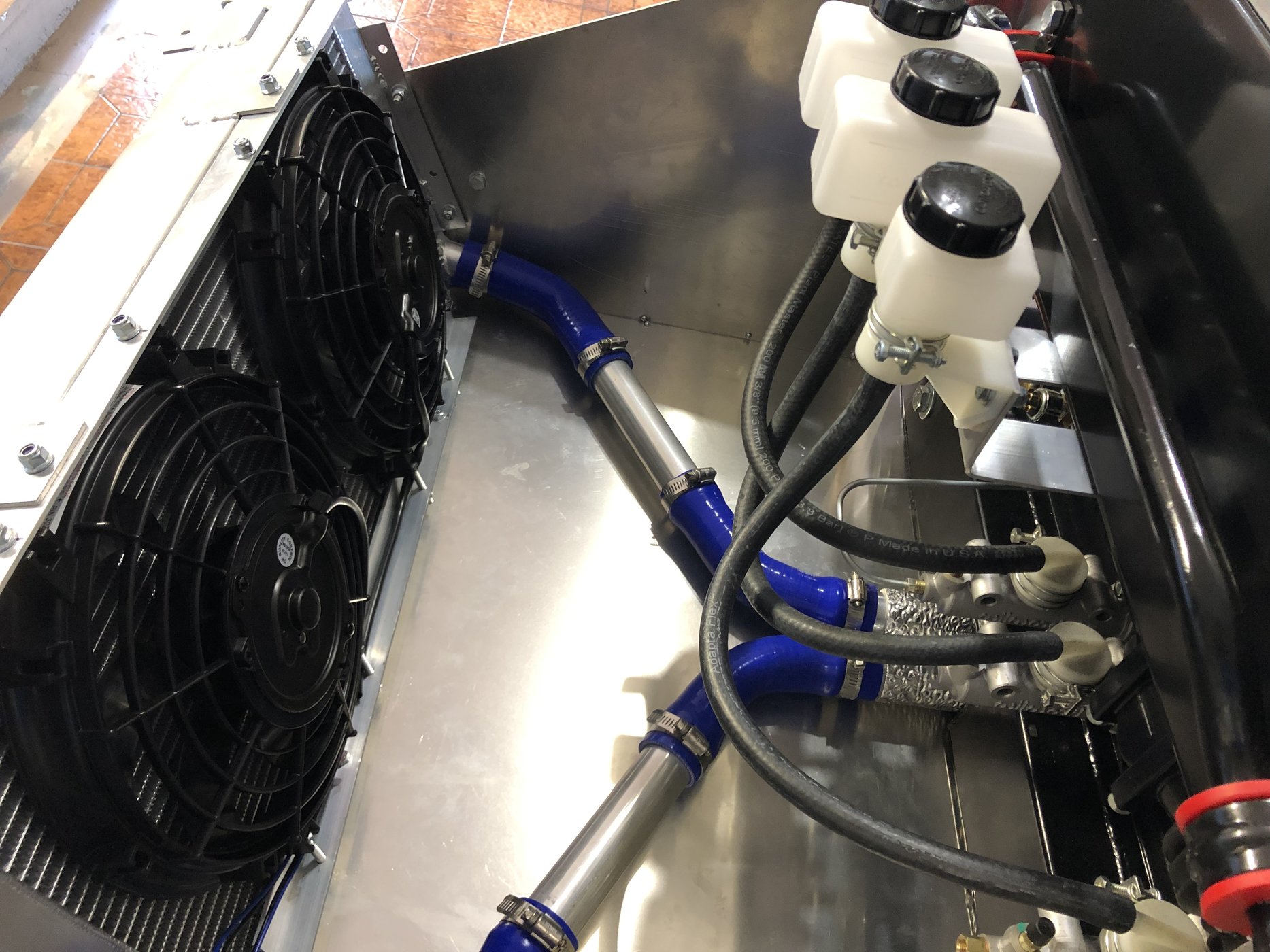

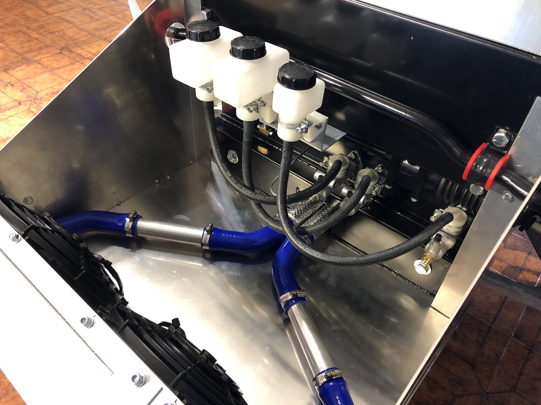

*How did you mount your coolant hard pipes through the central chassis tube? Mine are just laid in there for now...but I'm trying to figure out how I could attach some P-Clamps to keep the coolant lines from rattling around, as well as routing the brake lines.
I wrapped the aluminum tubes with Sticky Shield, a great heat insulator. I also ran the clutch and brake line through the the tunnel. A good fit with no movement and not needing clamps. I’m getting ready for the paint so the dash, seats and steering wheel will be coming out. I ordered a 14 inch Moto-Lita steering wheel.

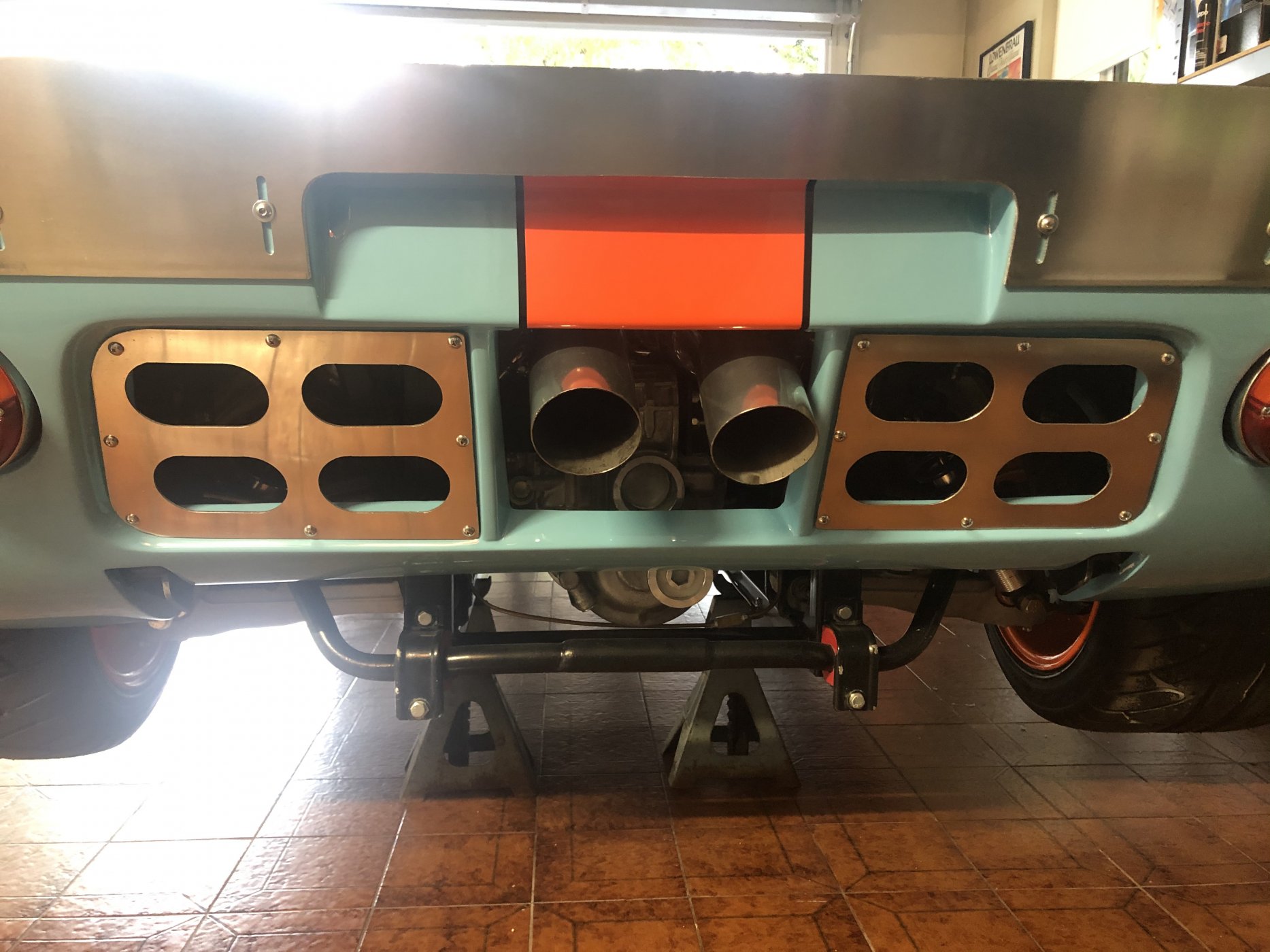

Peter here are a couple of pictures.
Hi Steve I purchased two adjustable fuel senders from a forum member. I had to modify and shorten them to fit. I used aluminum fuel cell rollover 6AN adapter valves on both tanks for vents and they work great, no gas smell. I just figured out the gas pedal and throttle cable install for my EFI. I’m still trying to figure out the layout and installation for my emergency brake bracket setup. If you did yours and can share I would greatly appreciate it. How is your build coming along???

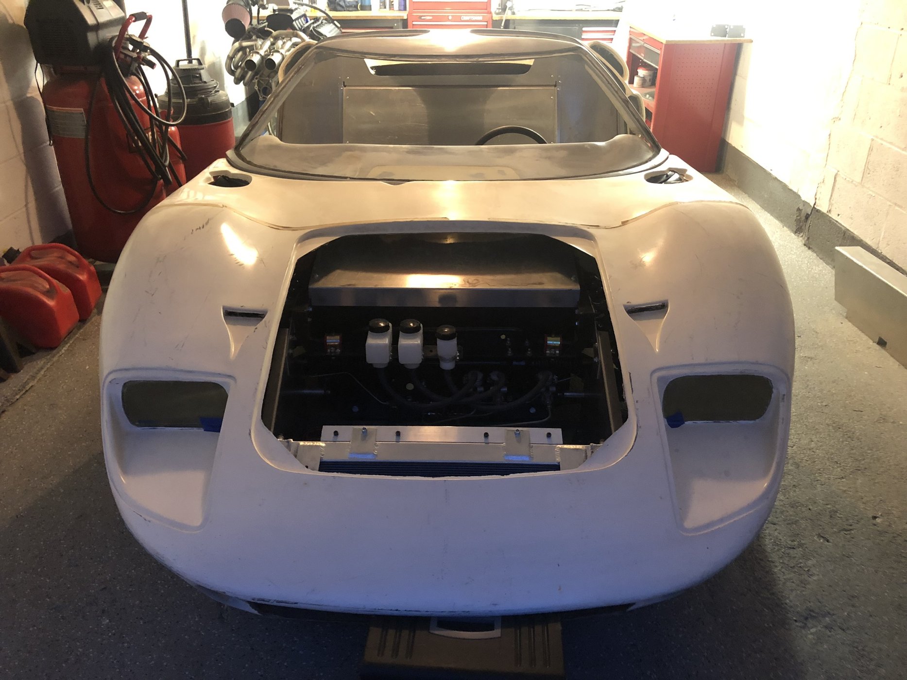

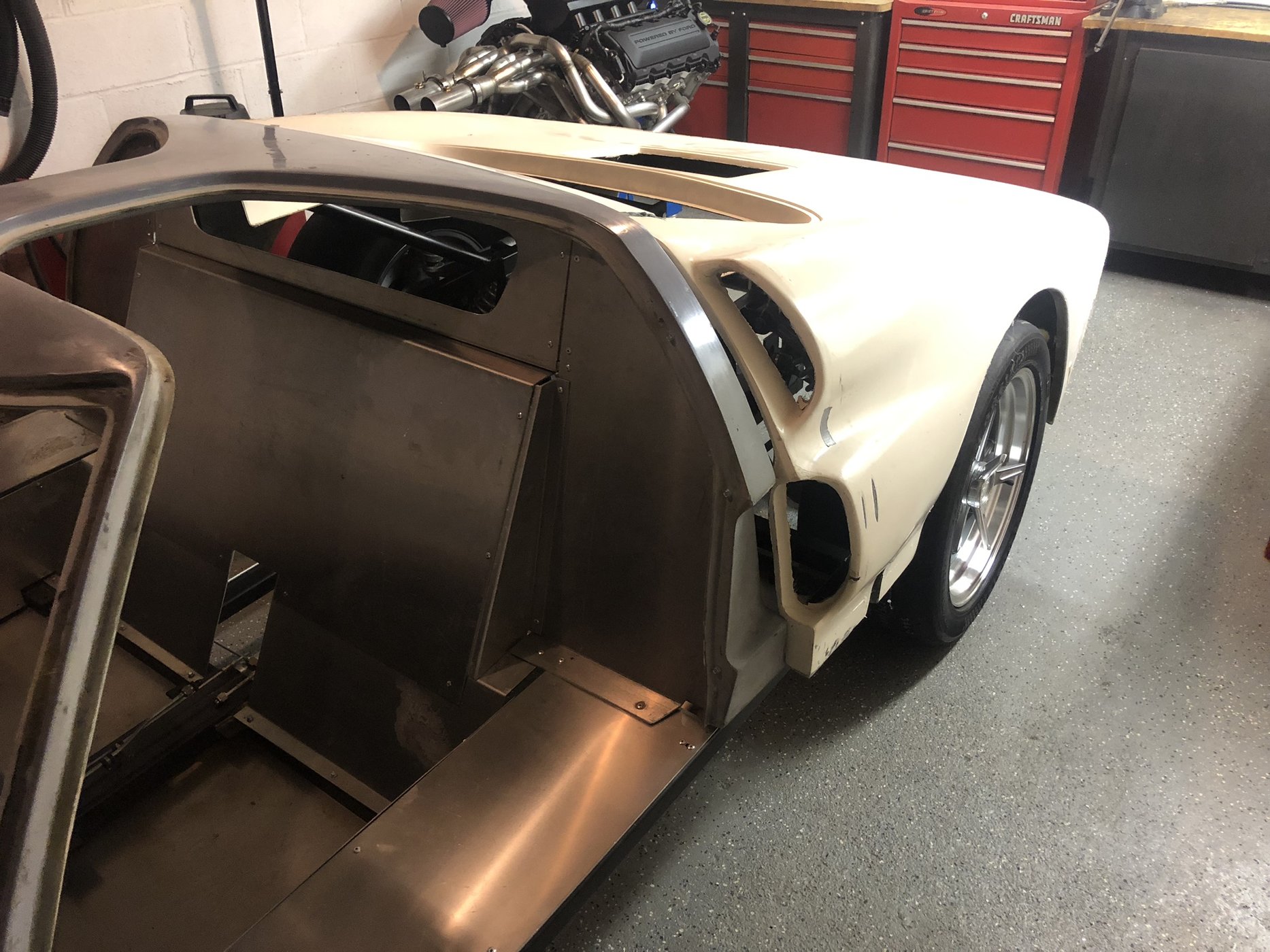

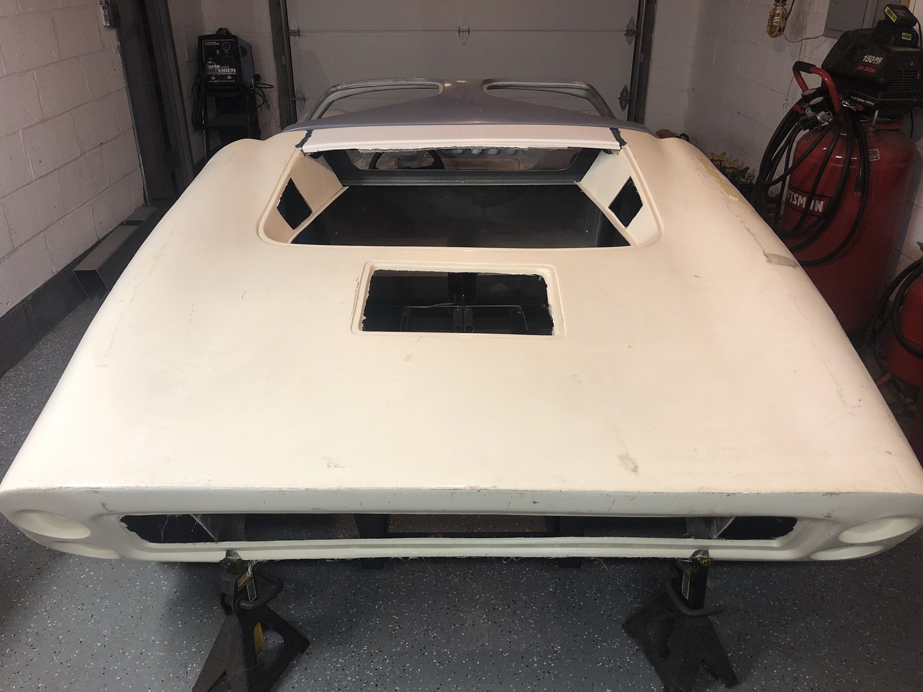

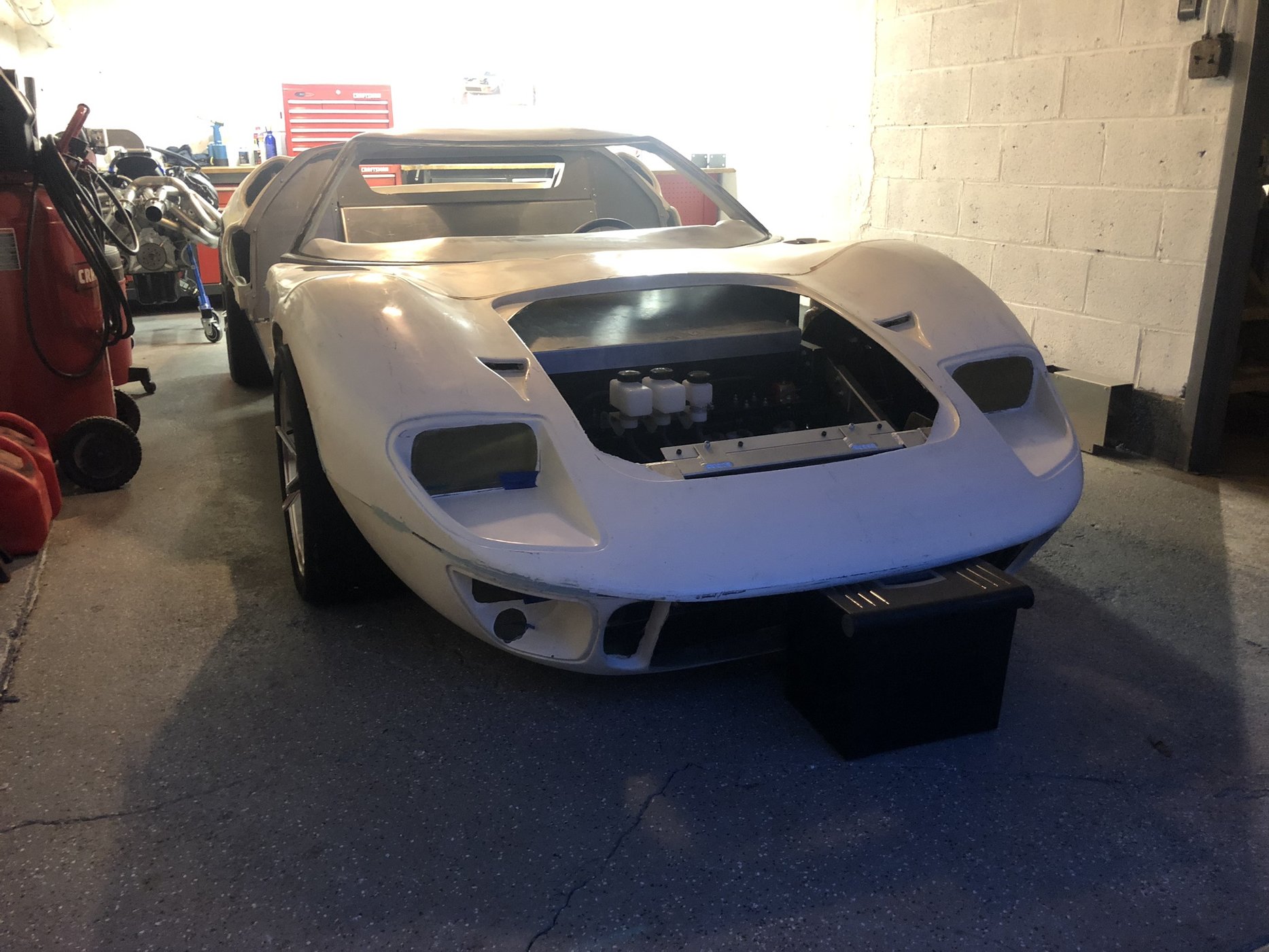

Hi George. The build is not going as fast as yours, but I finally got my body today. It’s a bit rough and will need a ton of work to make it fit, but I’m pumped
I got this from Ted Baird who says that this is a splash mold from an original 40. From what I understand a splash mold is a mold from an original car and only a few body’s were made from the mold. So this may be the closest body to an original GT40 that I could get.
Here are some pics, but it’s going to take a long time before the body fits correctly, but that’s the fun!
Take a look.

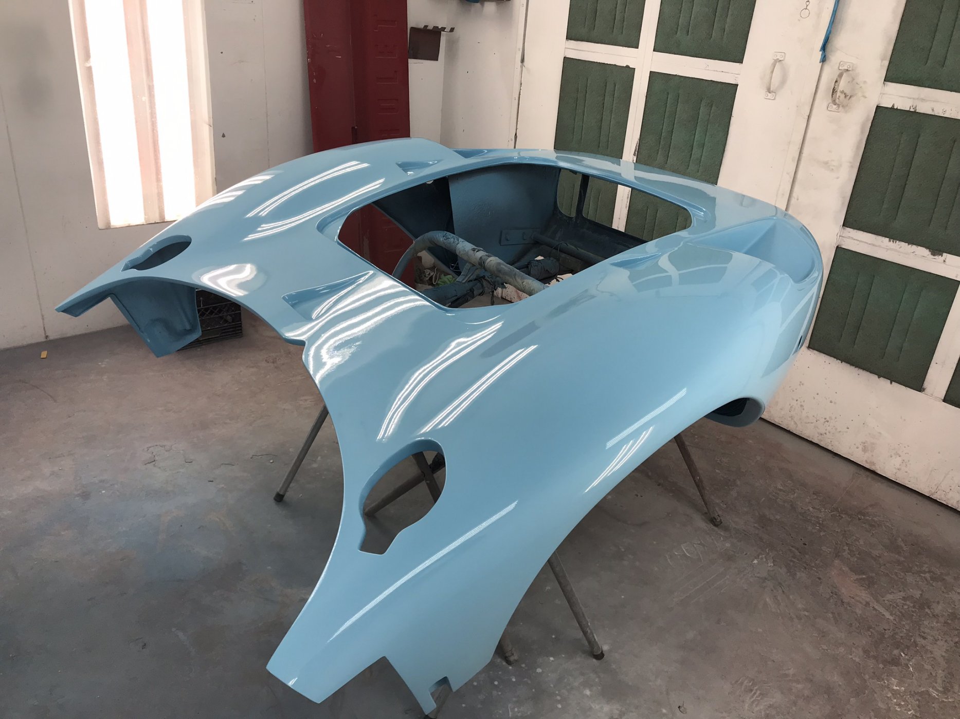

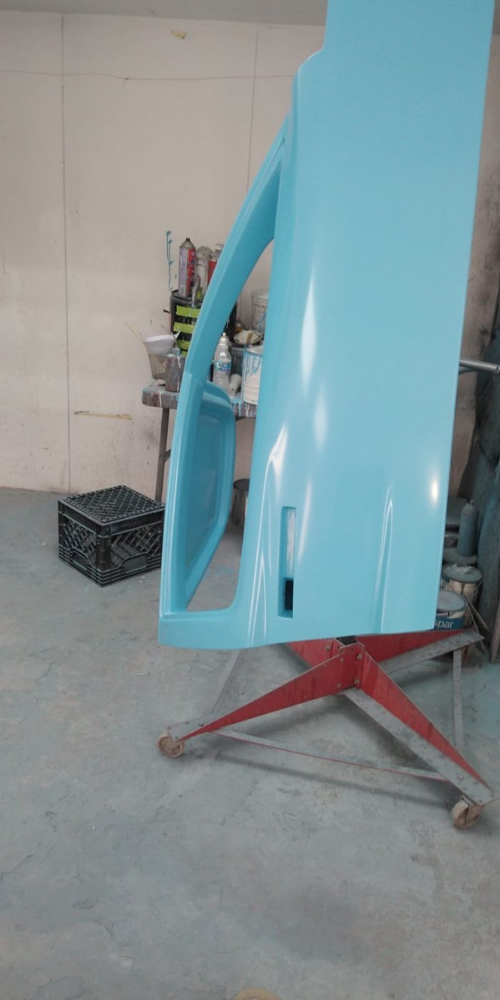

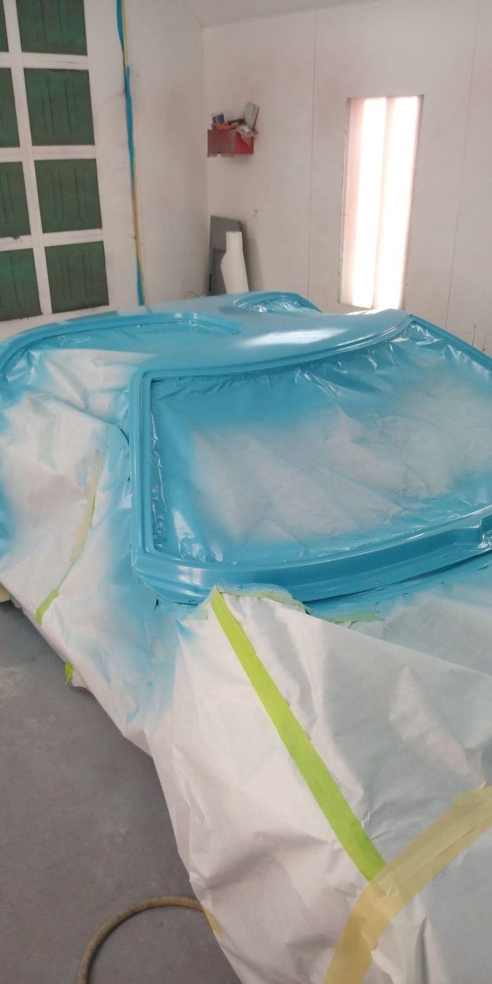

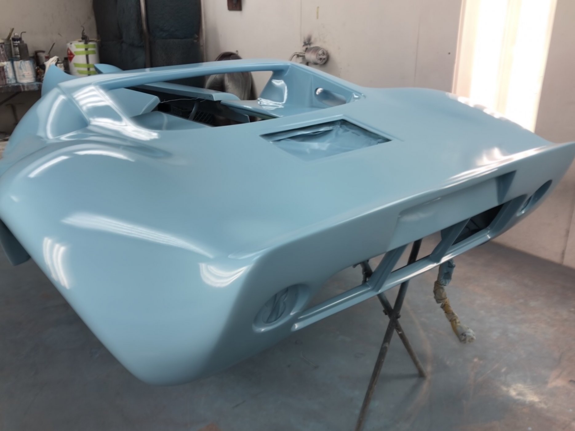

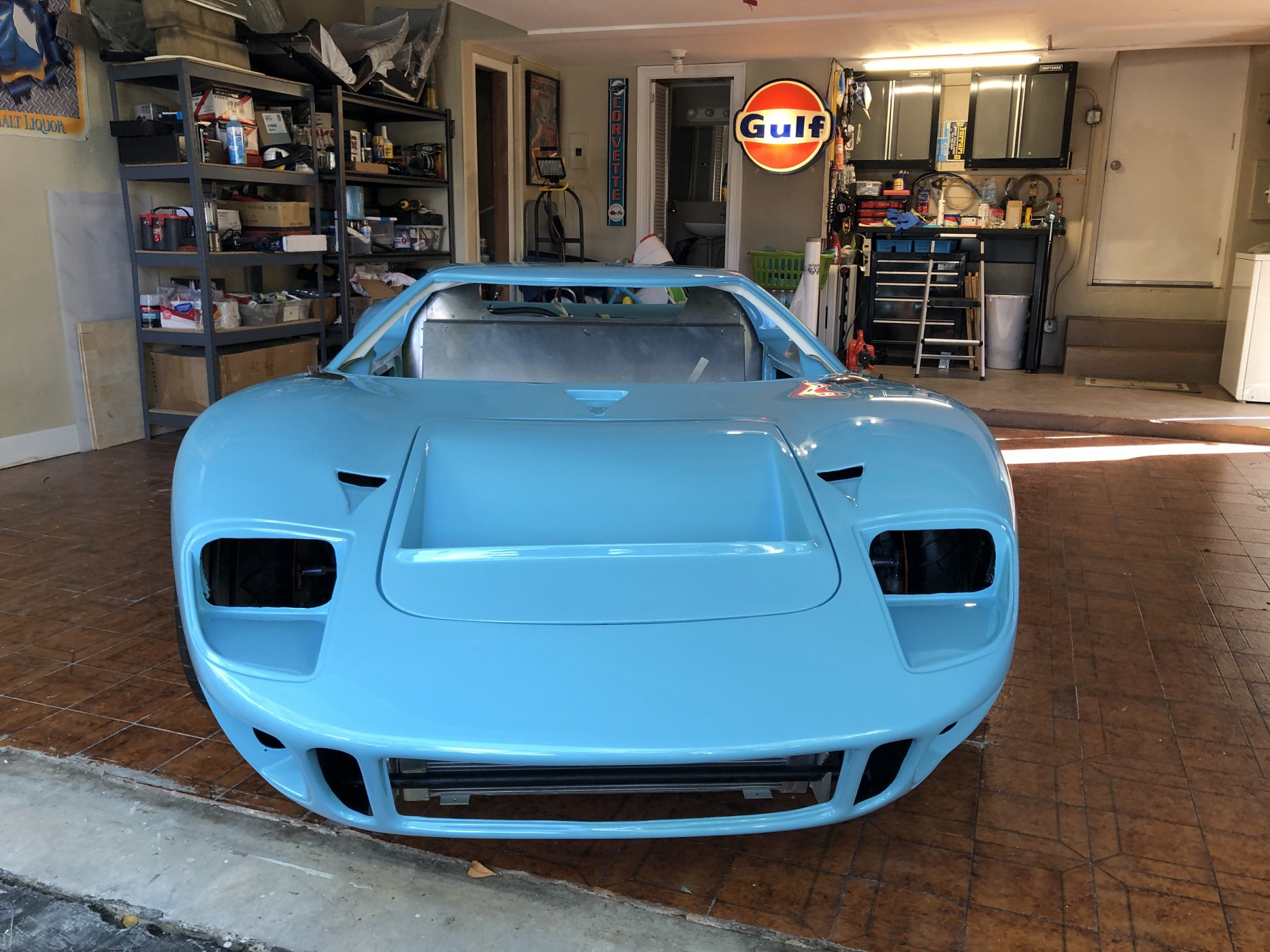

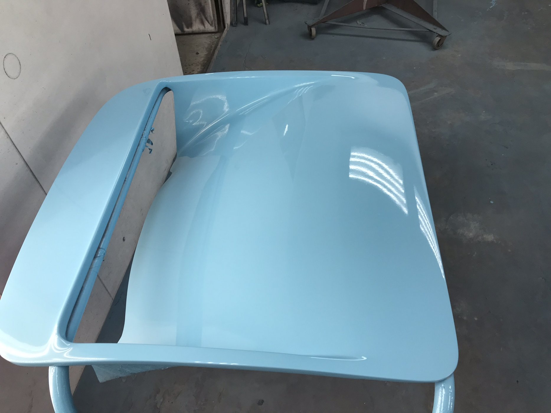

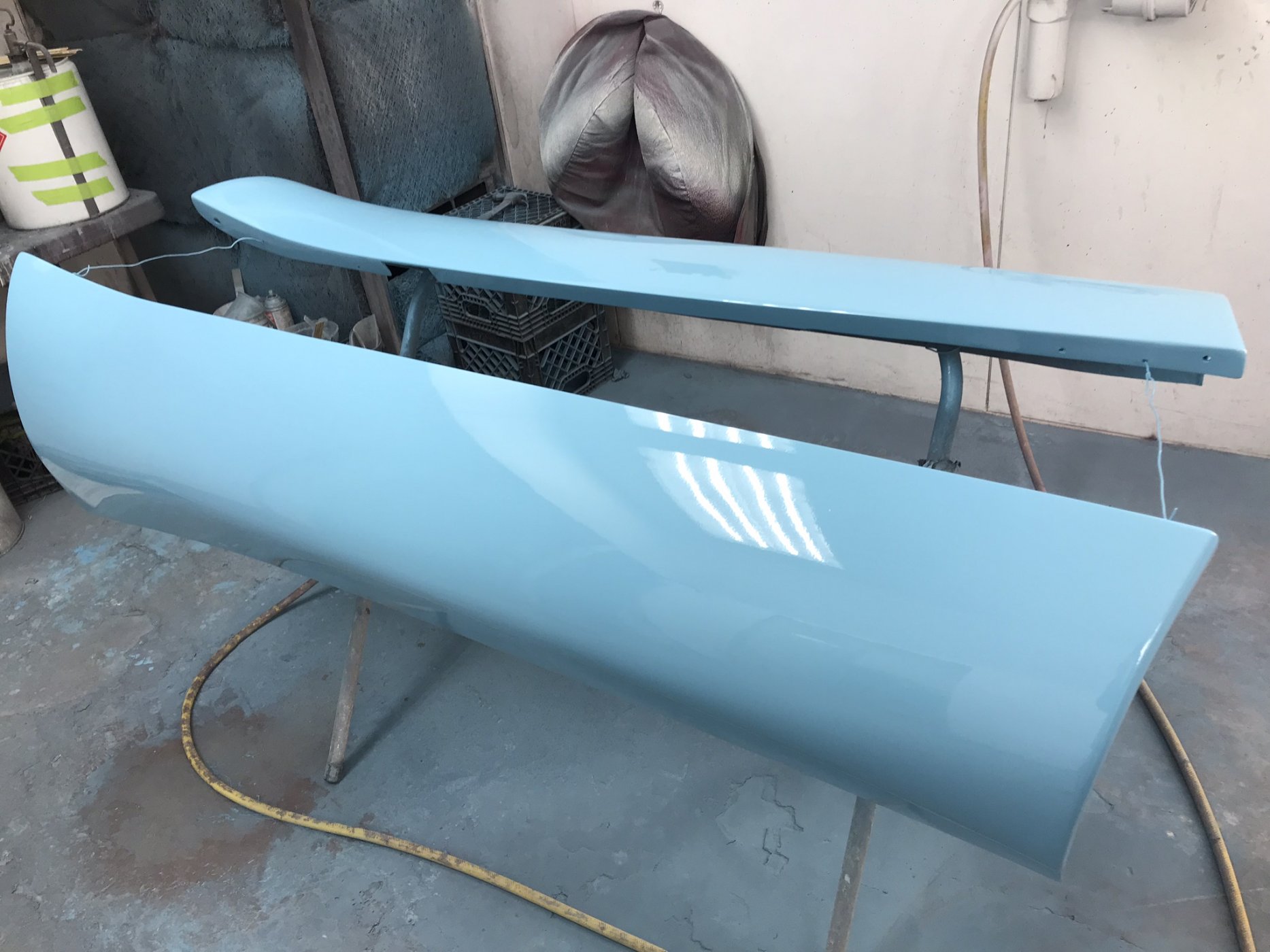

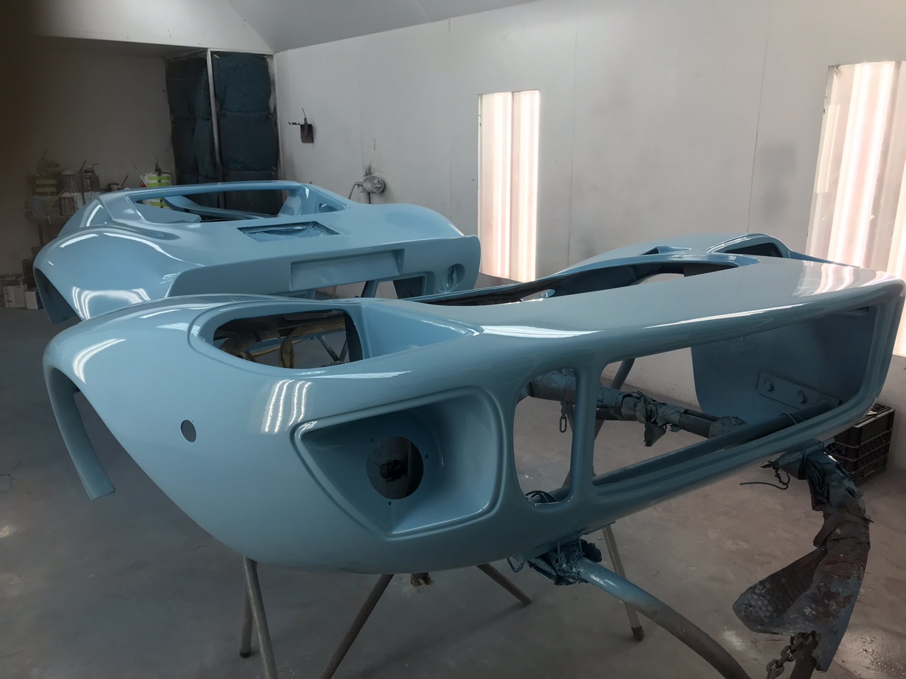

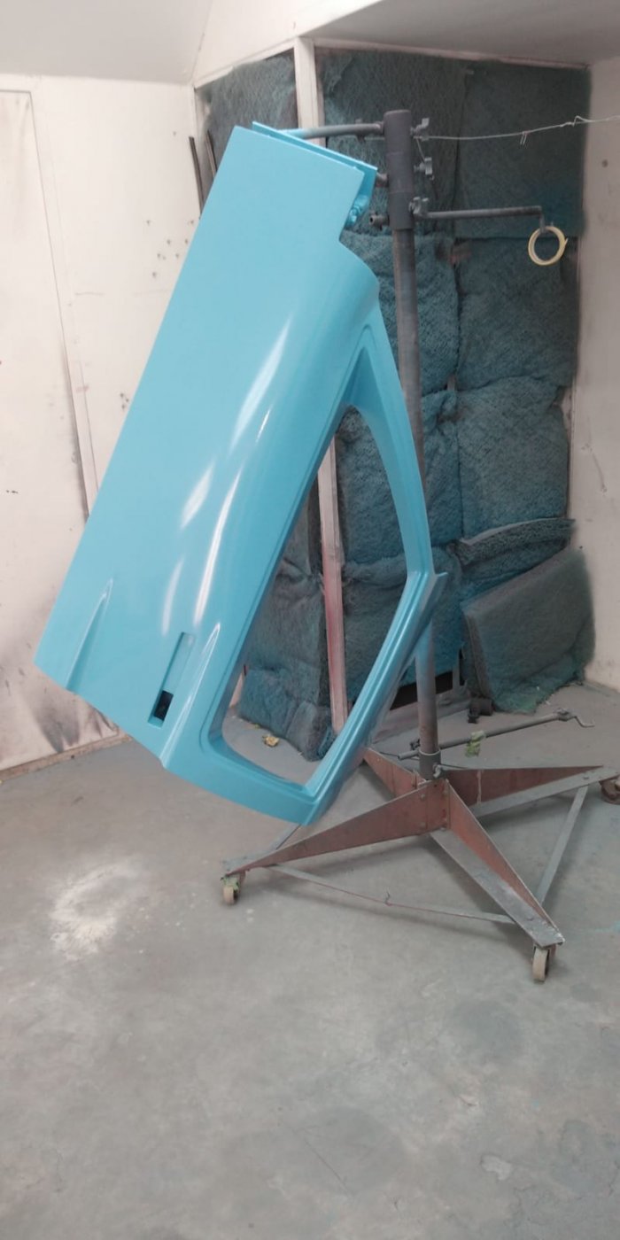

After 5 months of body work and paint it is almost finished.

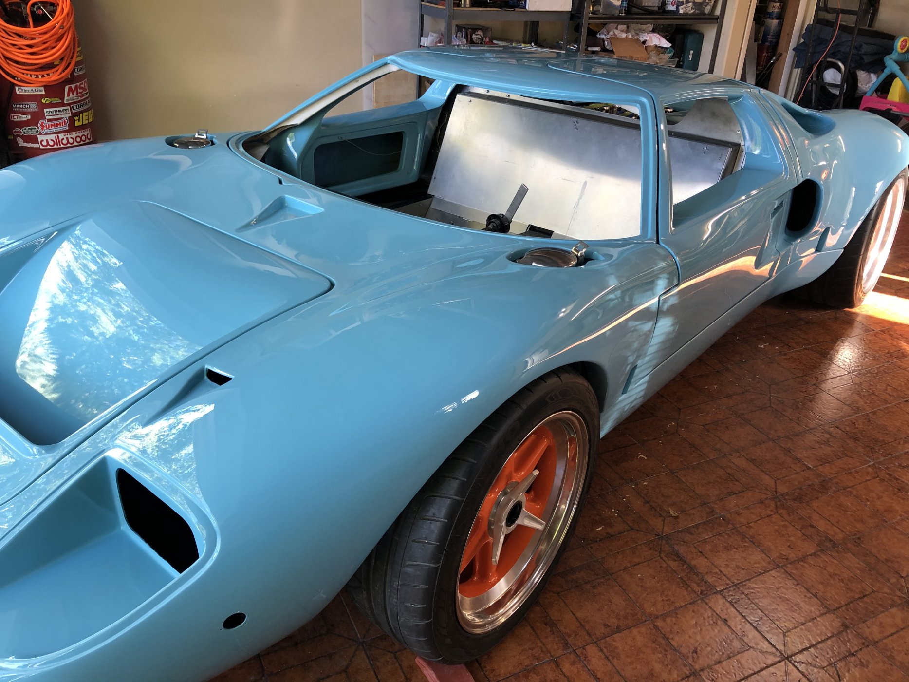

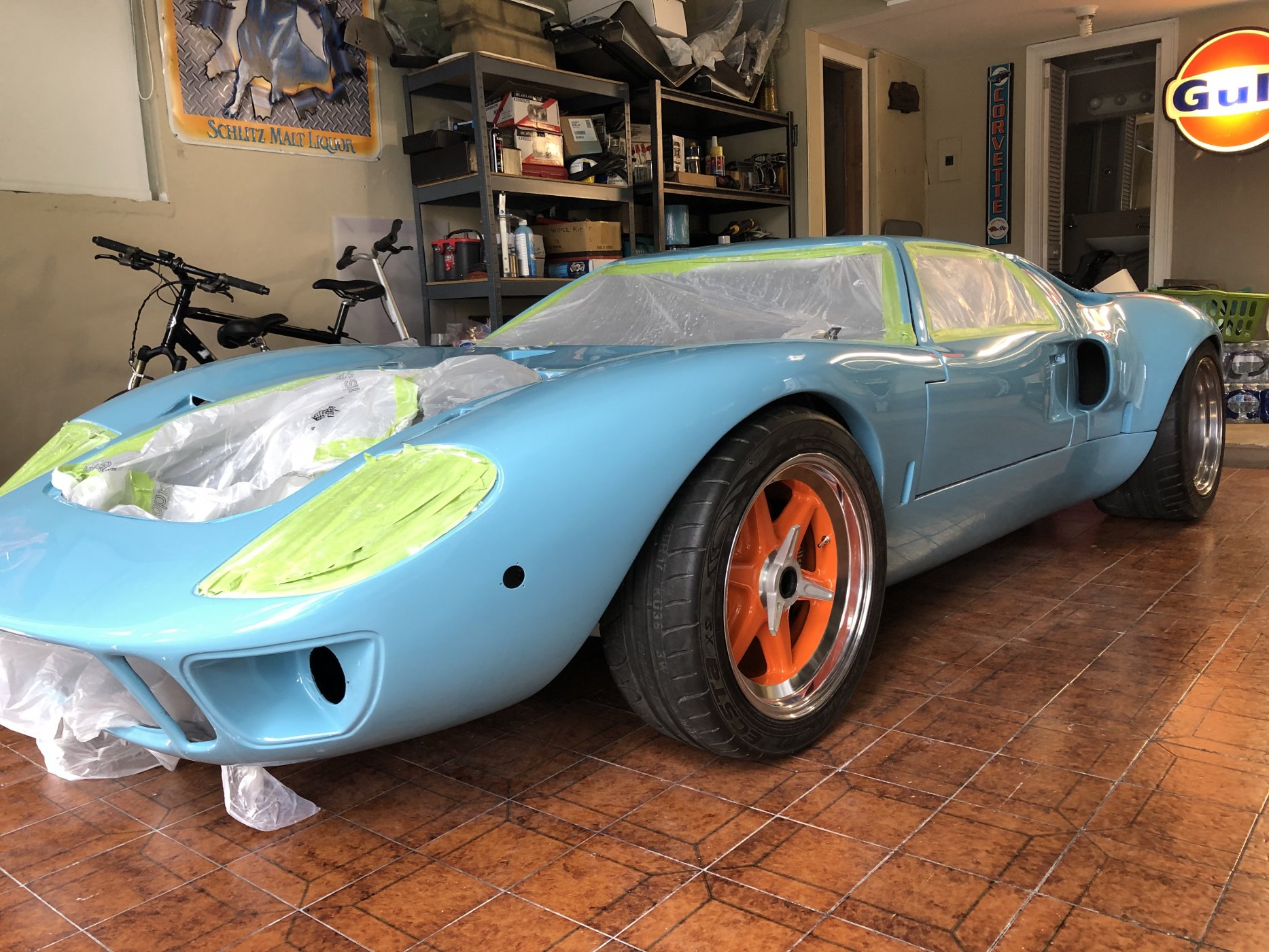

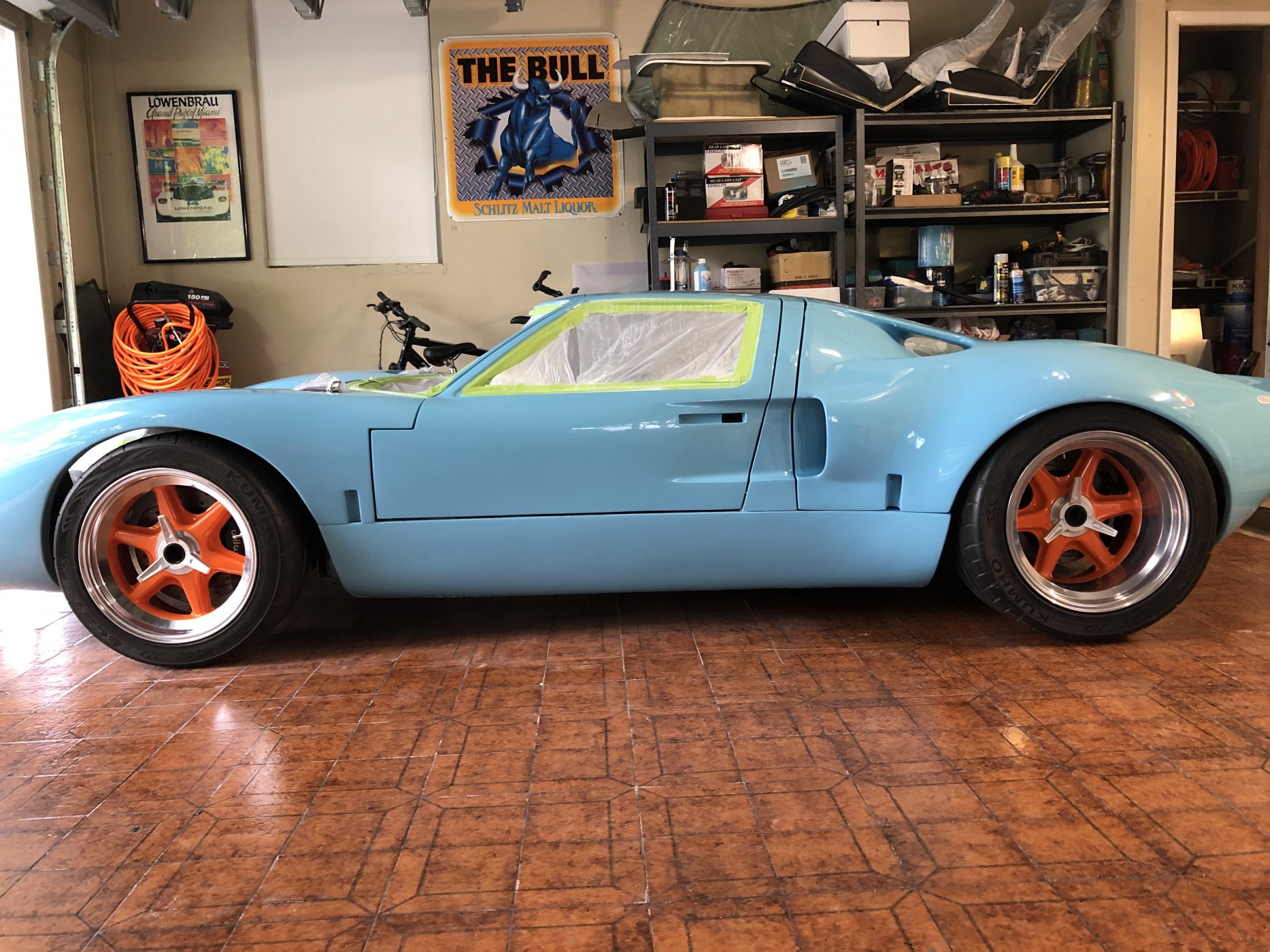

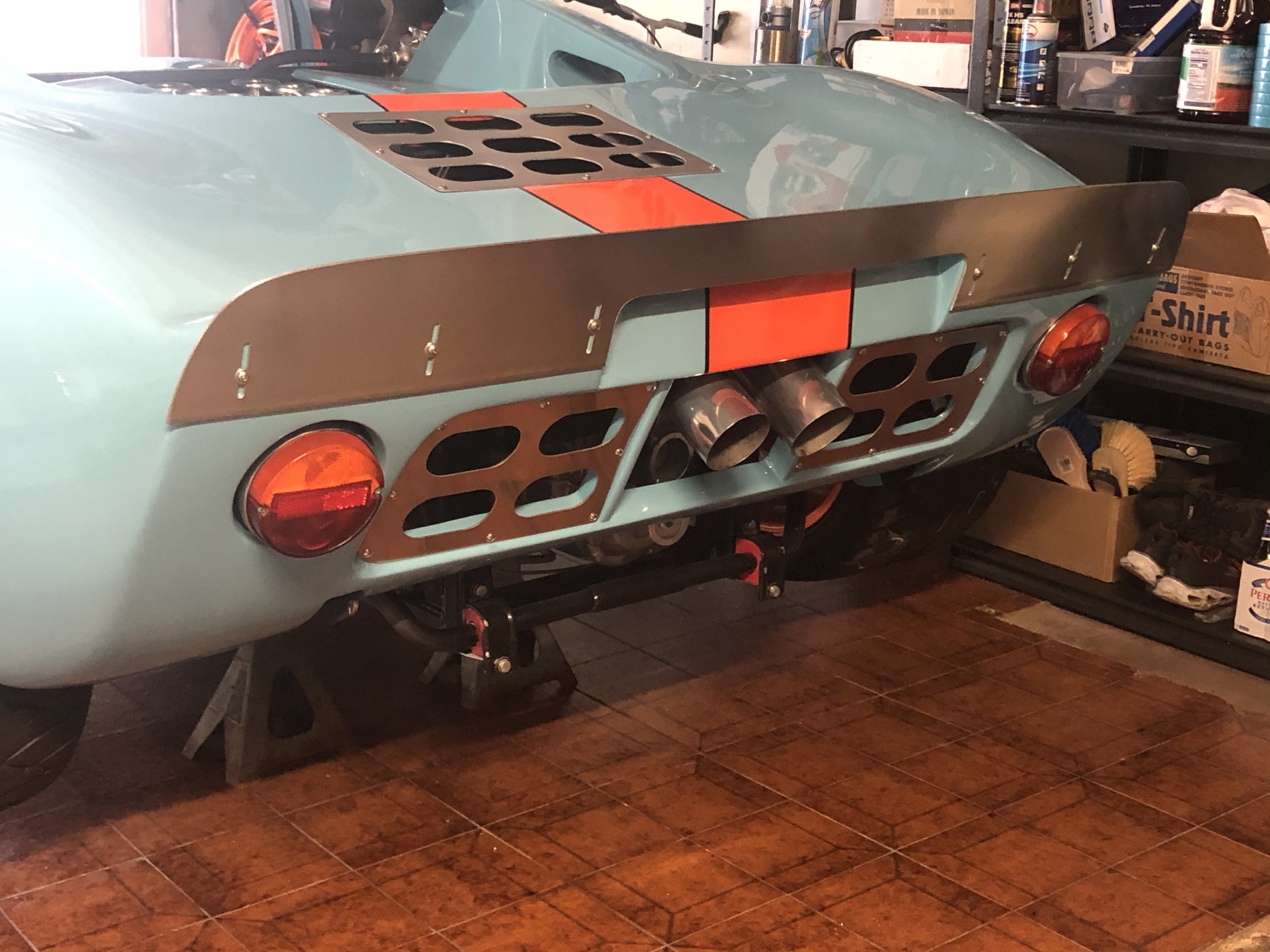

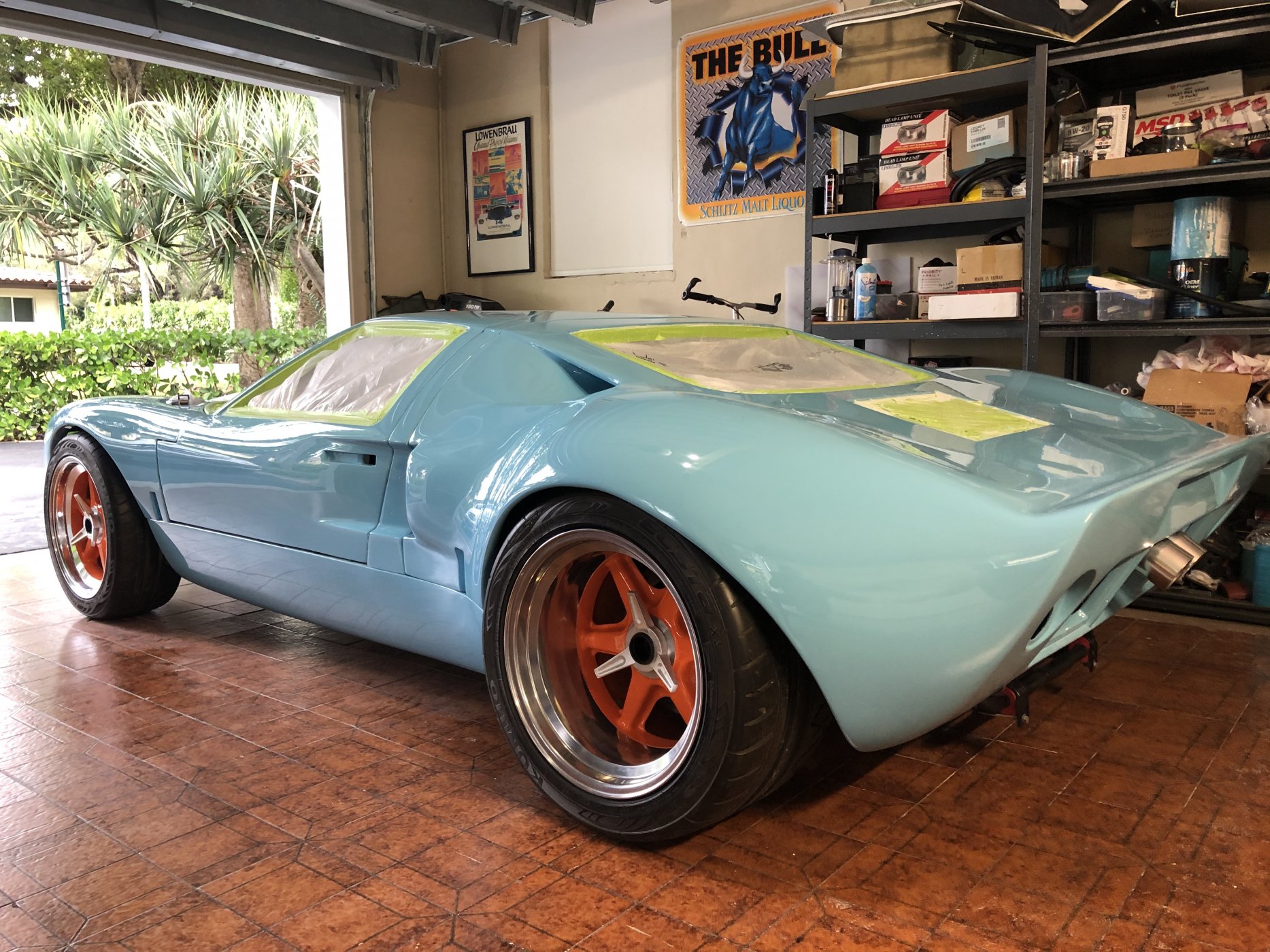

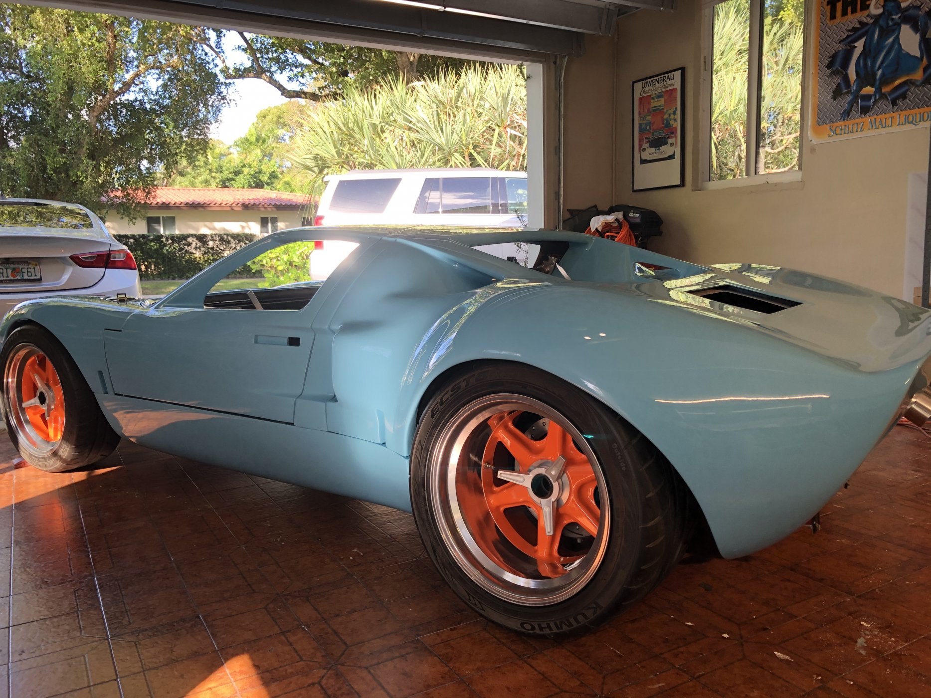

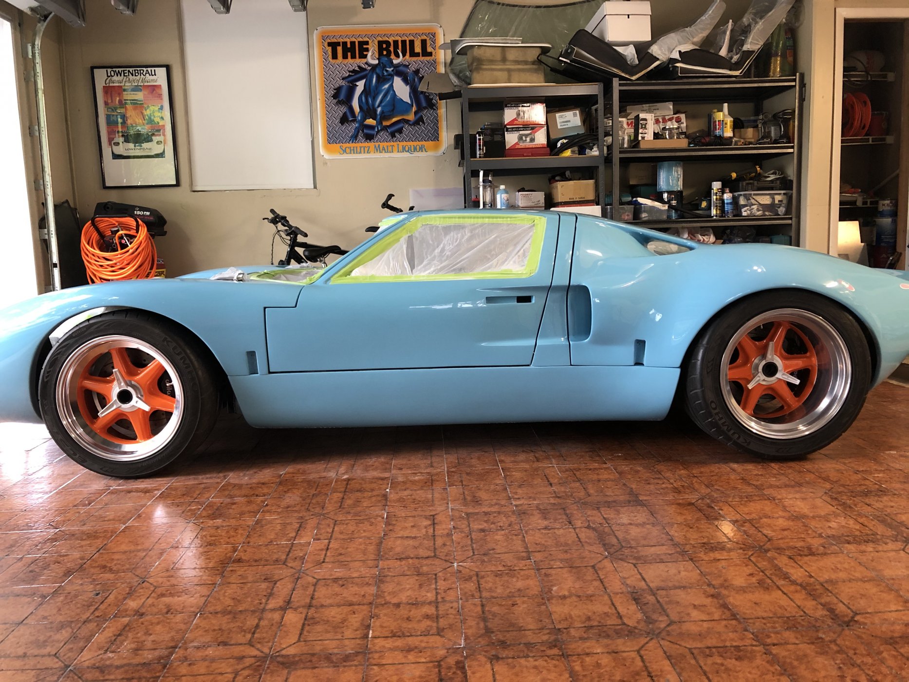

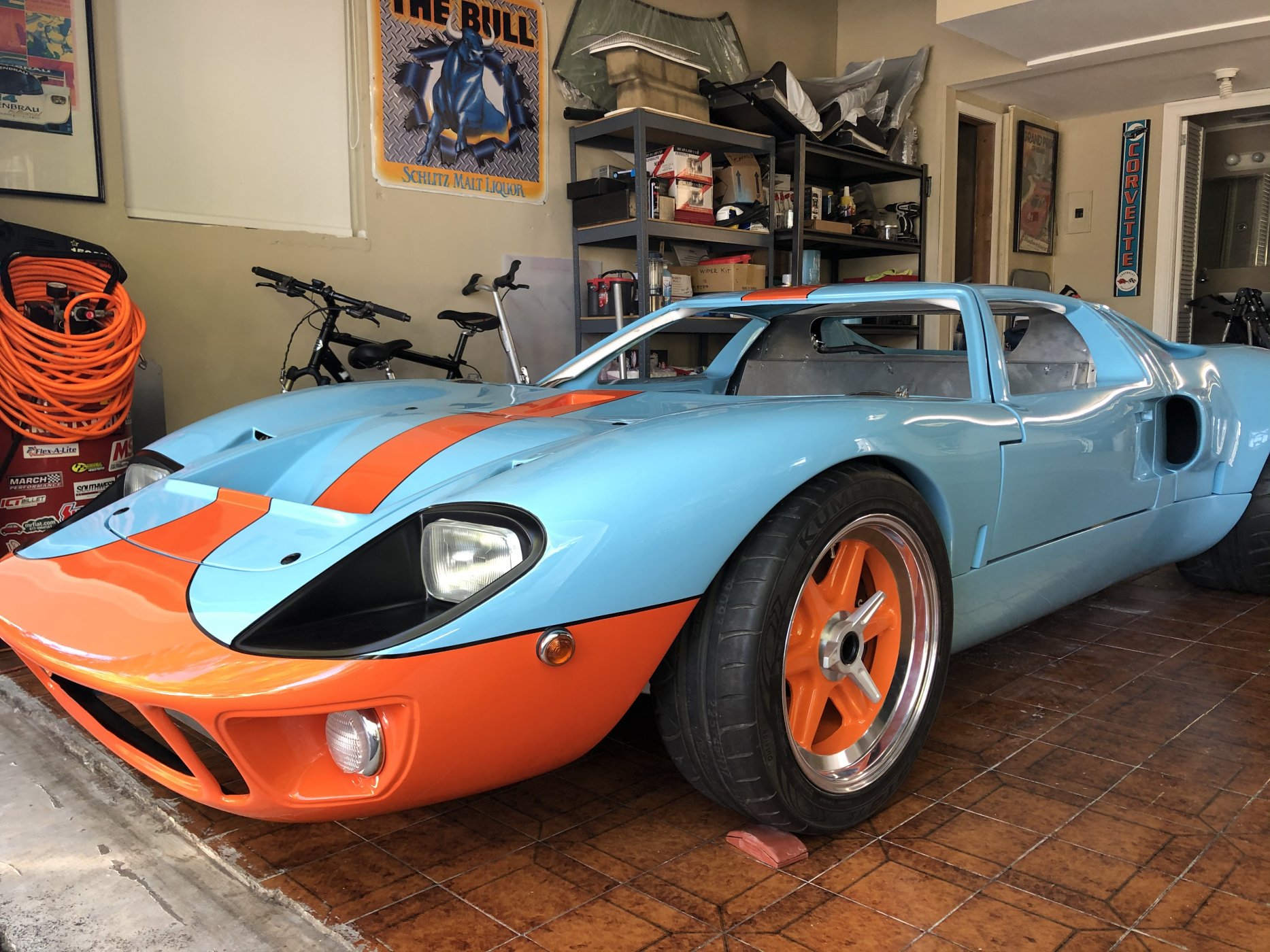

Paint buffed, wheels powder coated and will be adding orange stripe this week.

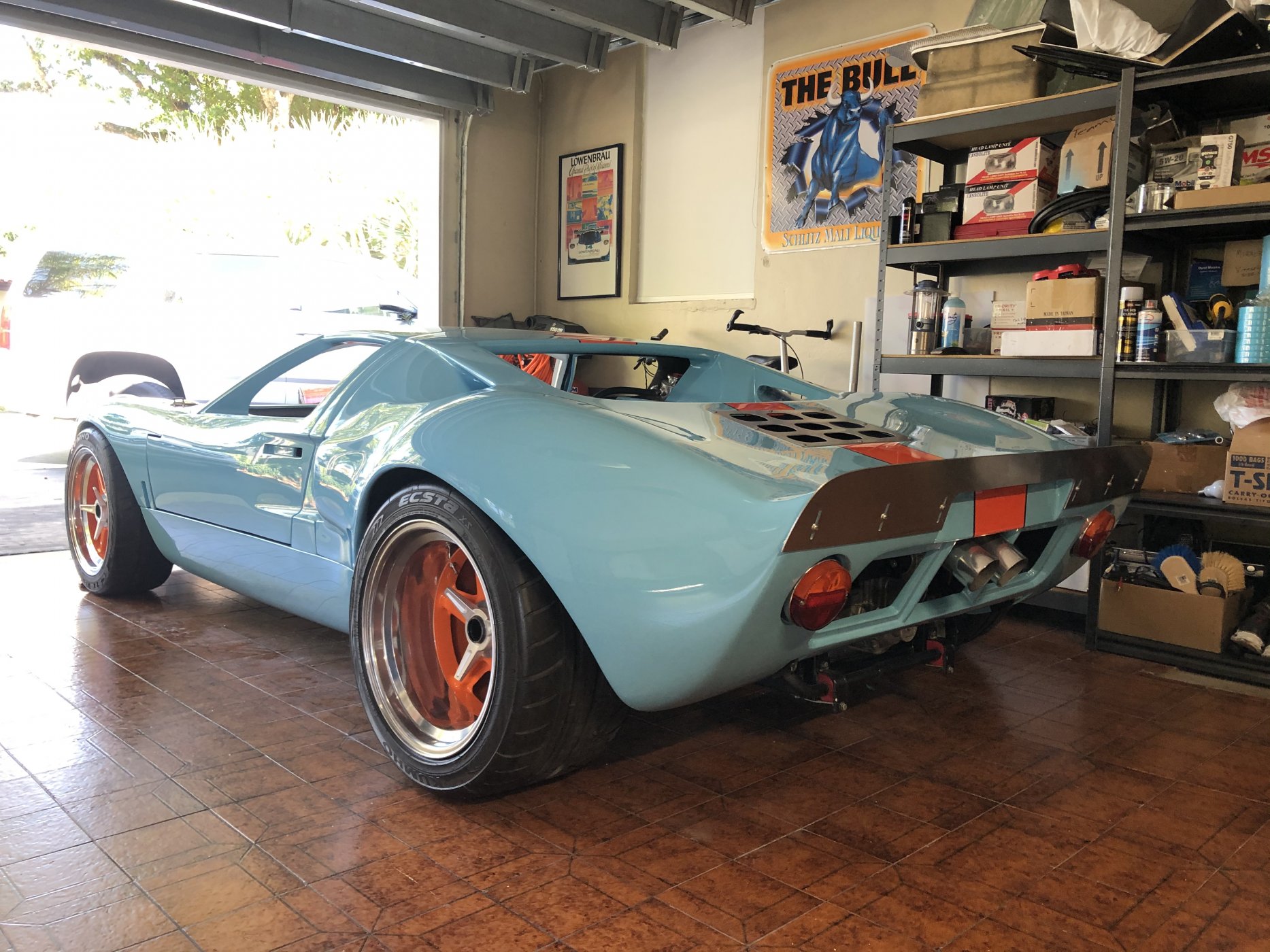

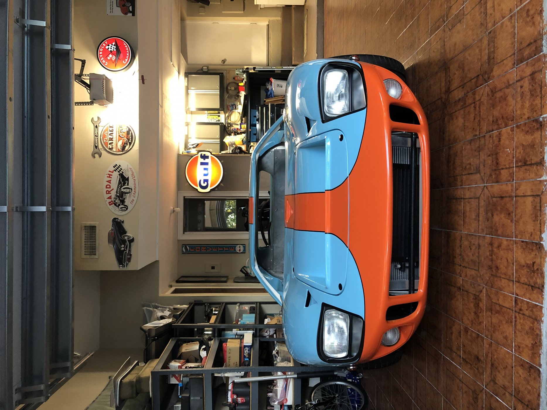

Putting her back together. Just finished with the air conditioner and starting on mounting the windshield wiper system.
Wow, you’re killing it! Looks beautiful.
