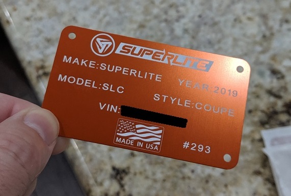

Go to *any* trophy shop and have them stamp engrave the VIN you are assigned or one of your choice in a piece of brass or stainless steel. VIN plates must be either welded or riveted in place from what I recall. You can buy VIN plates and special rose-rivets (pop rivets that look like flowers) on the WWW.
That is exactly what the trooper told me as well, but I couldn't bring myself to do something plain since it could be seen. I have great friends with the skills and tools to make something happen so we came up with this as my VIN tags. In Louisiana I had to have one inside the car (above master/power cell on passenger side) and one outside the car (passenger side by firewall), both had to be fairly easily seen if I got checked on the side of the road.
