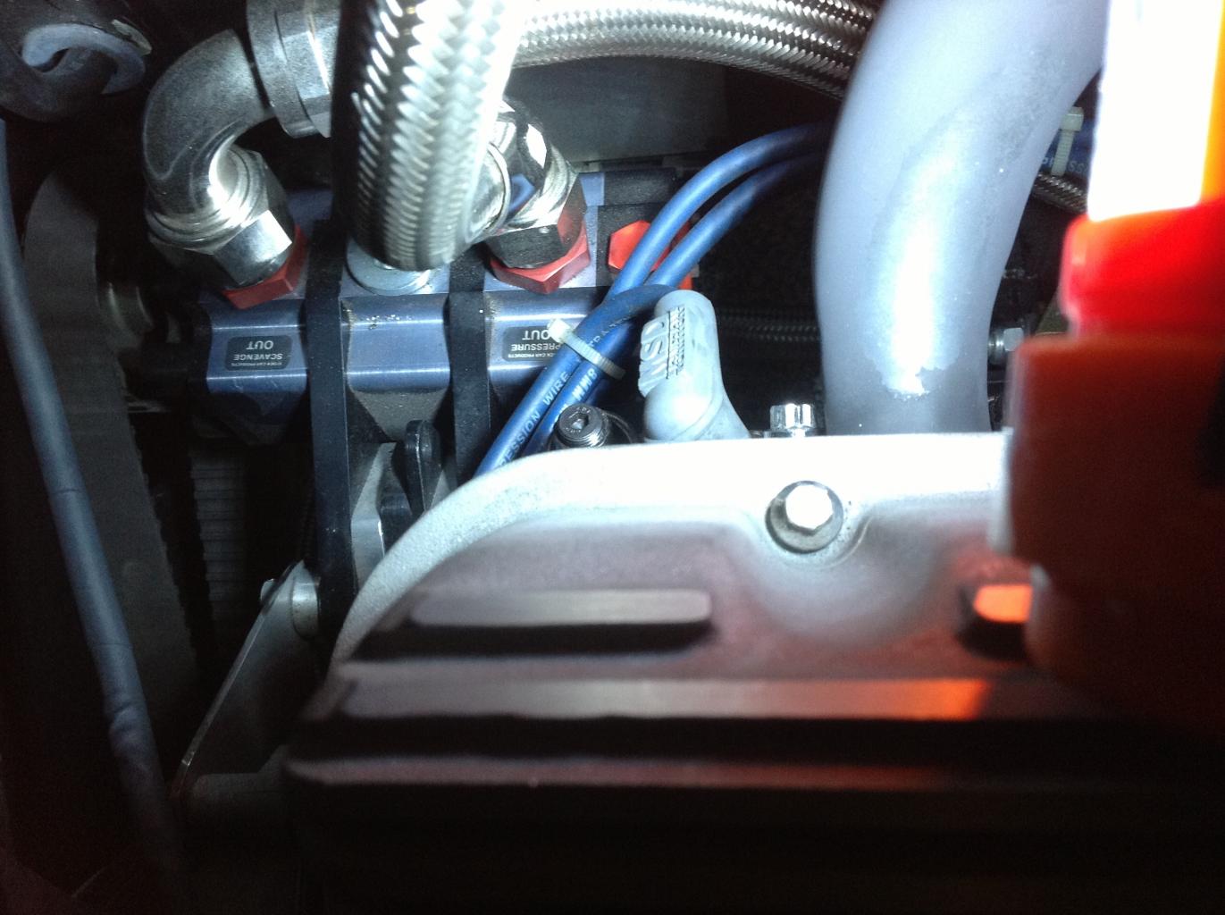

(Sorry, pic of pump upside down.:shrug:)
Tim Kay
I finally got a mirror out to see if I could find a name on the pump. Turns out it's a 3 stage "SCP" pump. Now the question is how it operates and is this sound normal, their website does not go into that detail. At least not that I could find.
