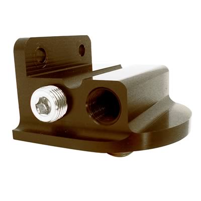

I recently discovered this convenient piece by XRP, part number 987810 for 10AN, 987812 for 12AN. Might allow you to sneak in a temp sensor without re-plumbing. It's expensive though, ~$70.

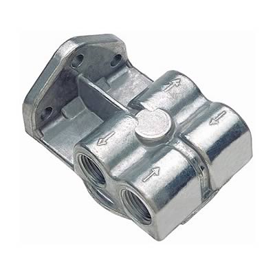

And then finally, the way I solved this problem: Transdapt 1045 mount for my oil filter, which has two 1/2" NPT ports in each direction.

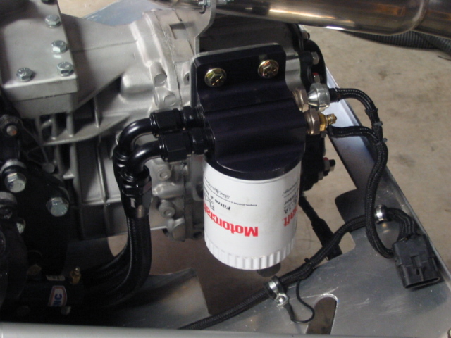

Canton 5065 Oil Filter holder.
Sensors are (1) oil temp and (2) low pressure warning light. Works great.

Let me qualify my recommendation of the Transdapt 1045 part: I discovered after designing and implementing a whole oil flow layout that the adjacent 1/2" NPT holes are too close together for a pair of 12AN fittings. My fault for not checking, of course. So, keep that in mind if you are going to put your input and output on the same side of the filter adapter.
Chuck -- I was looking for the Canton 5065, and think the Canton number is actually 22-625. Beautiful part.
