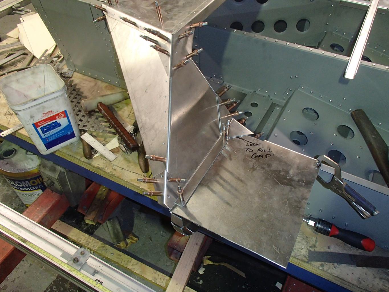

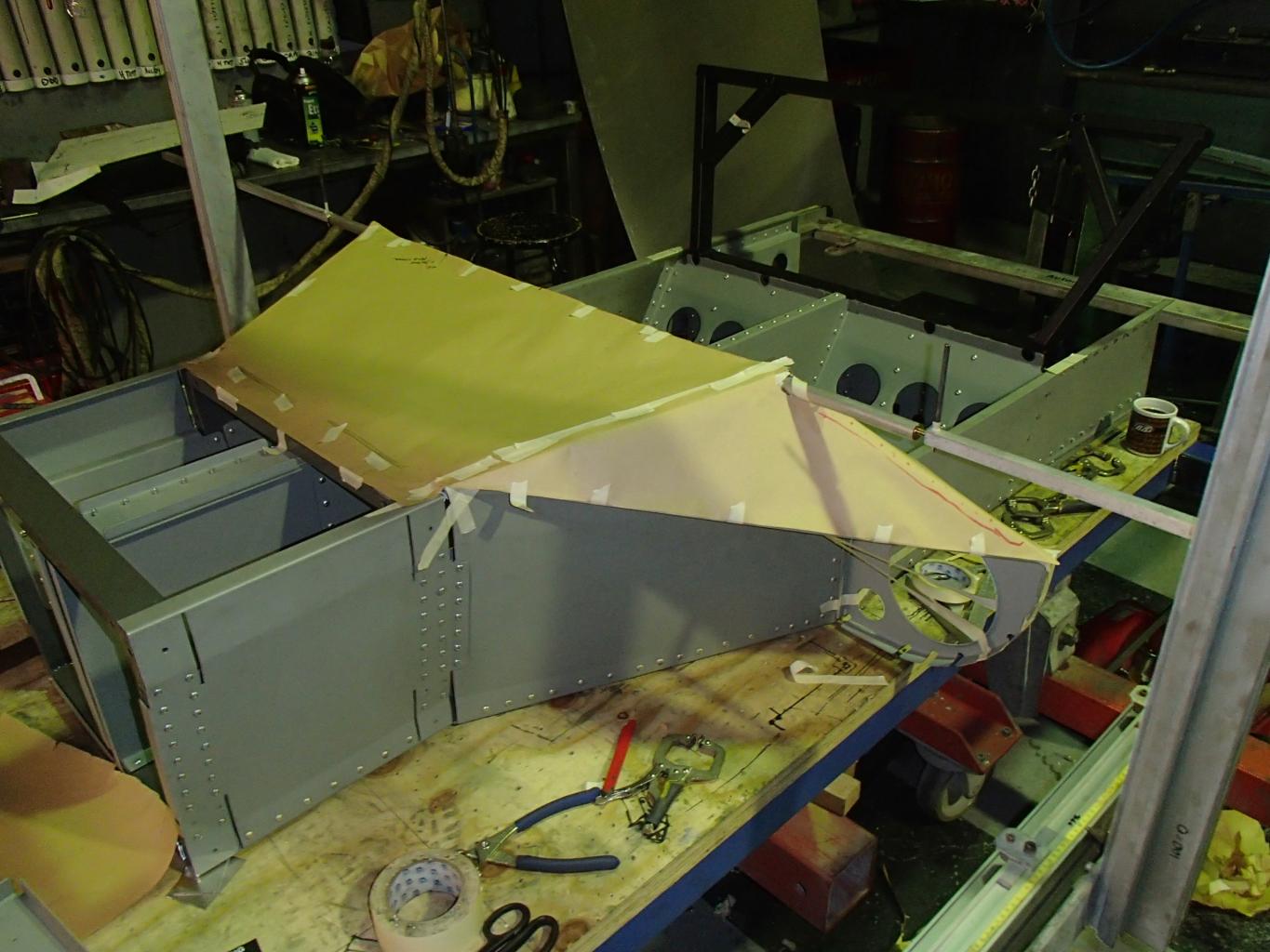

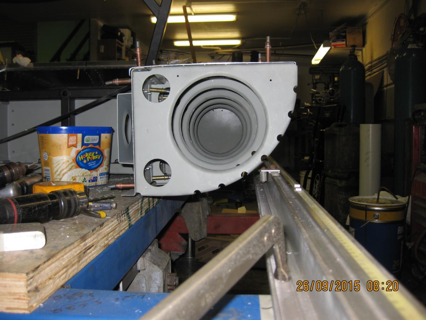

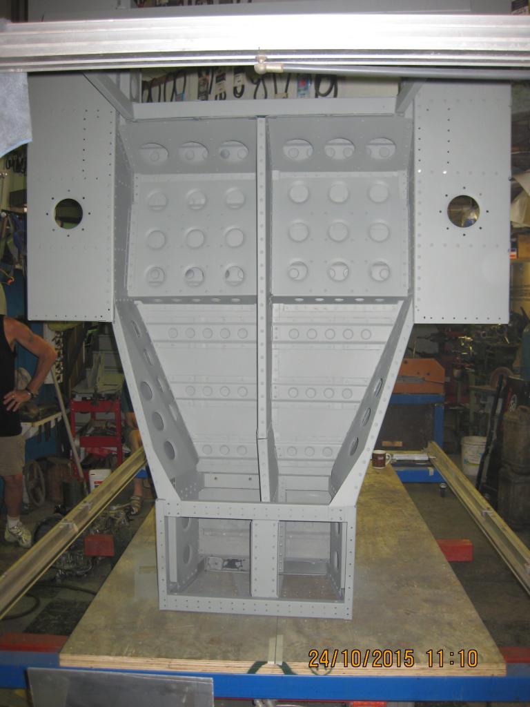

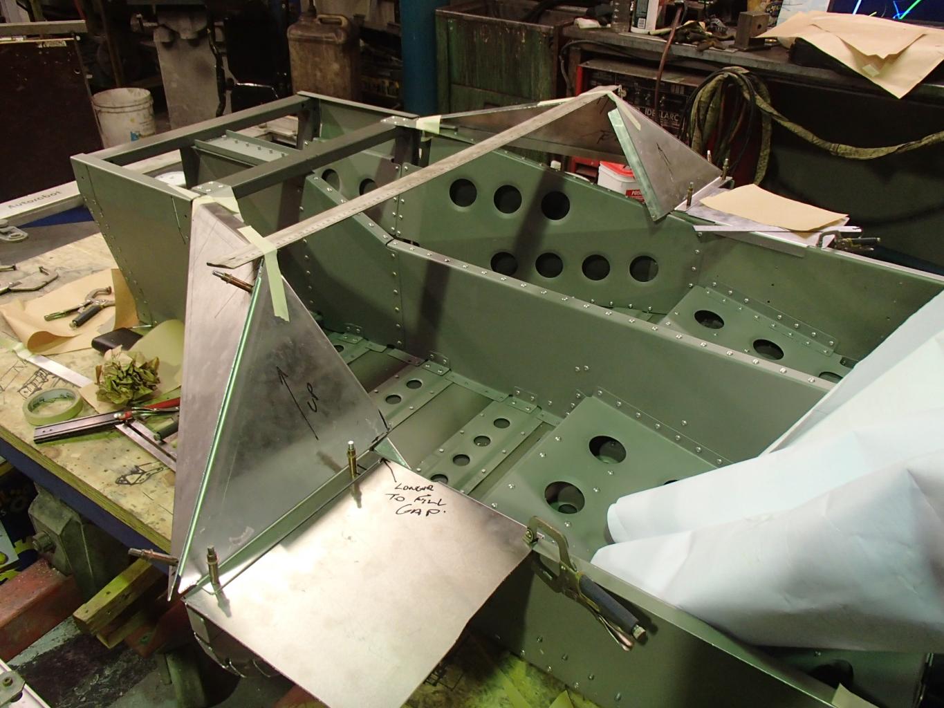

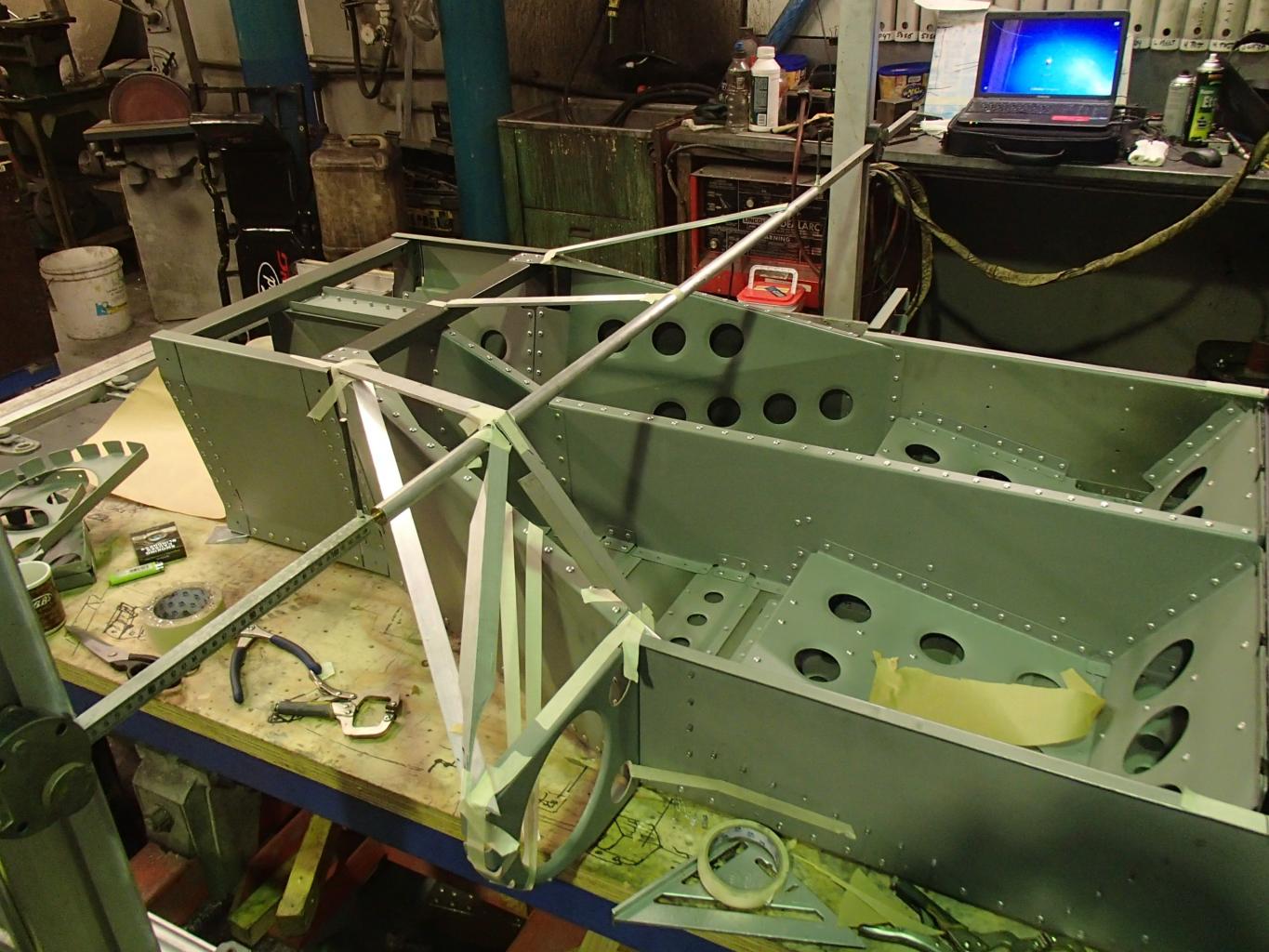

I am up to the structure under the dash.
All I have to go of is a tube on the drawings that the lower part of the dash mounts to.
So that is my datum and I am basically emulating the tube work location but in sheet.

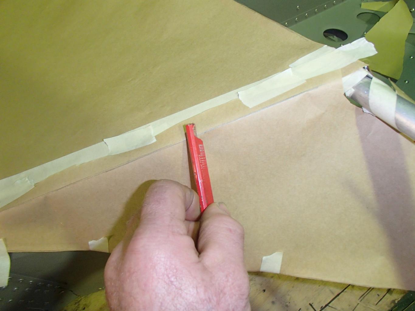

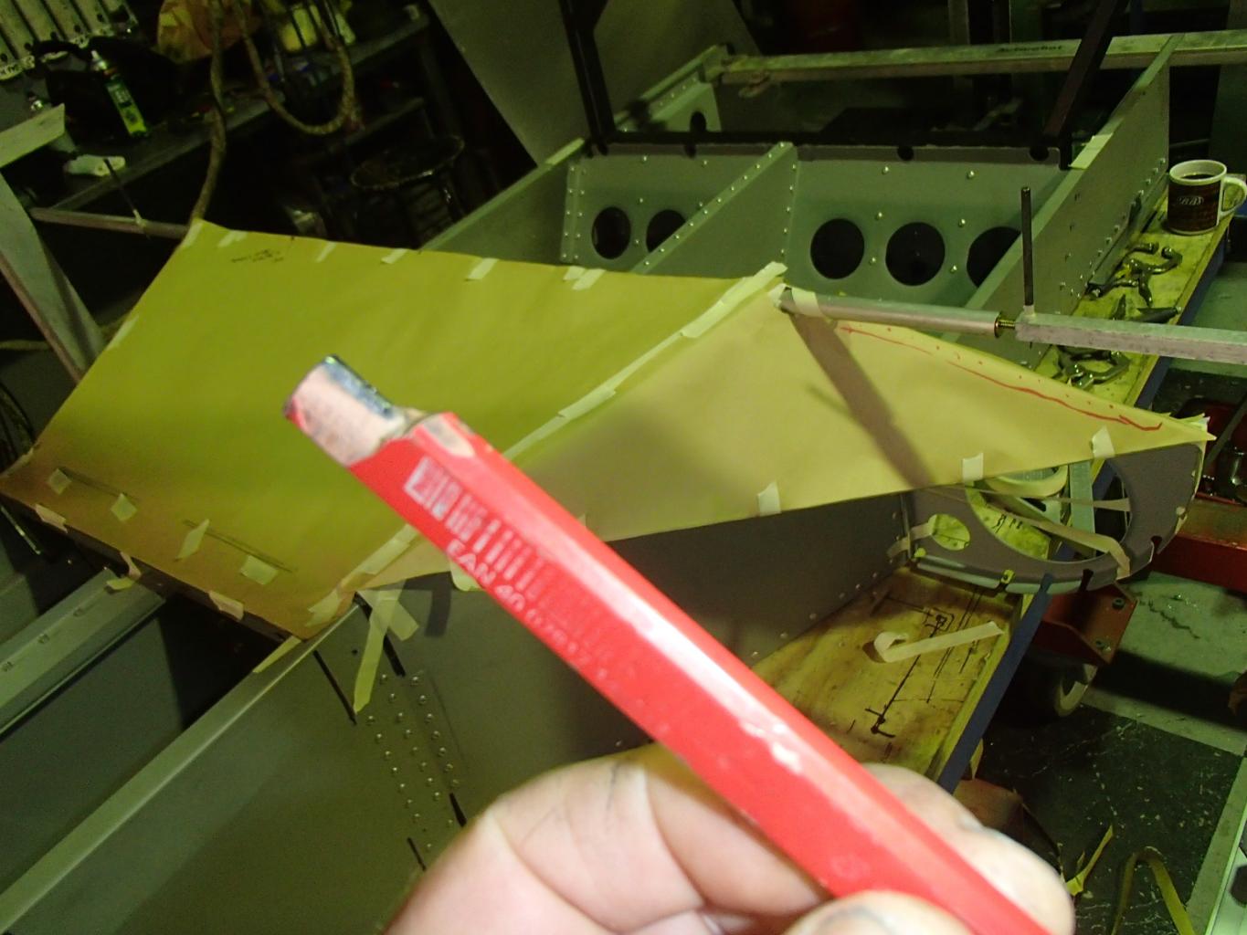

To get the spot I user the overhead measuring gear, then used tube and flat bar to give me the lines to make patterns .

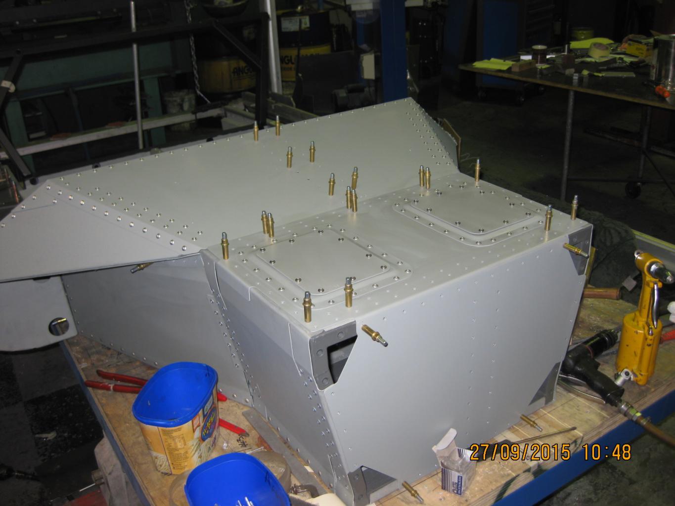

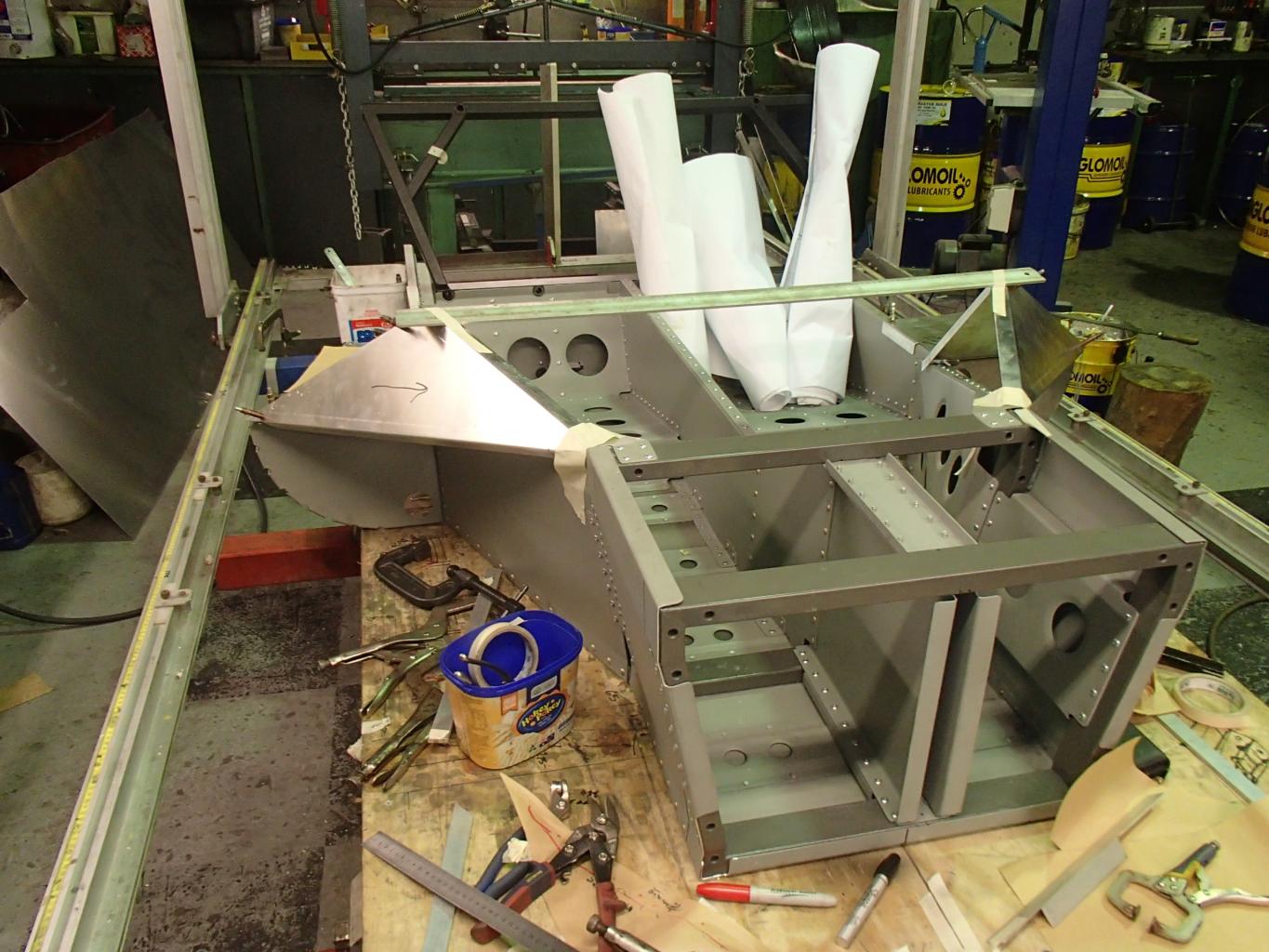

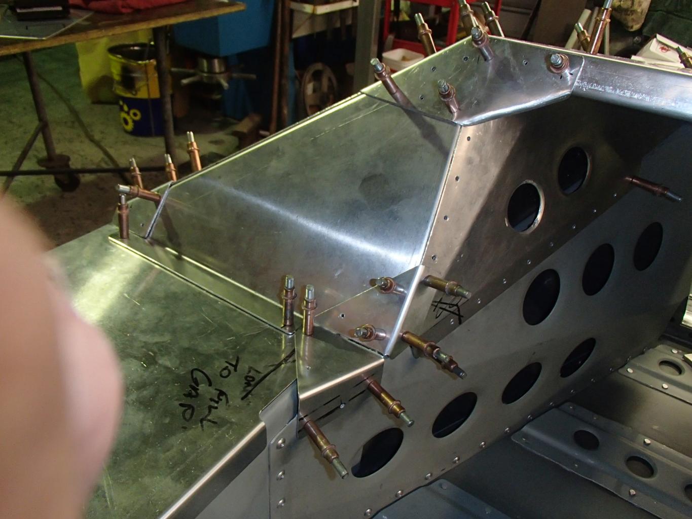

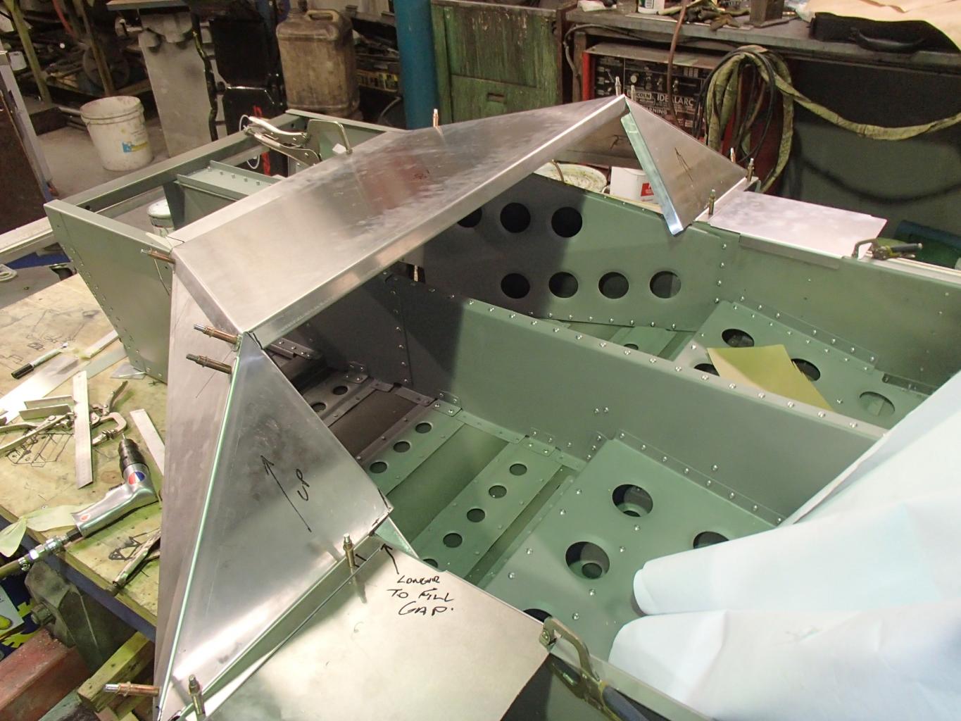

I started on the sides first, these are a pyramid when put together so they are pretty strong.
Then the top panel, I folded a U channel that is riveted in on the ridge.
As the column is attached at that point I wanted extra strength.
Corner gussets are to tie all the corners together.

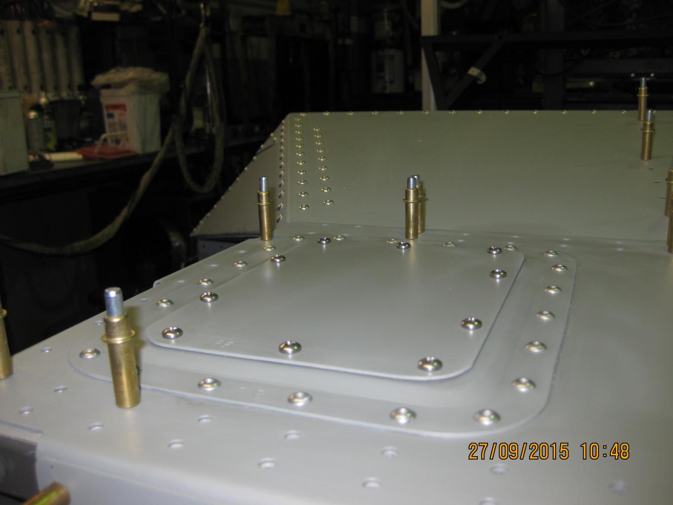

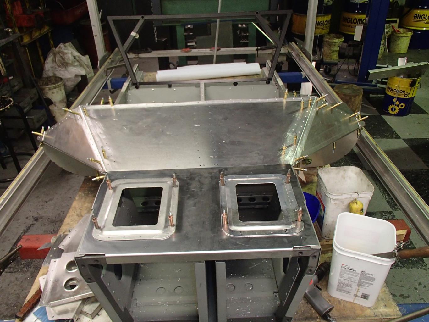

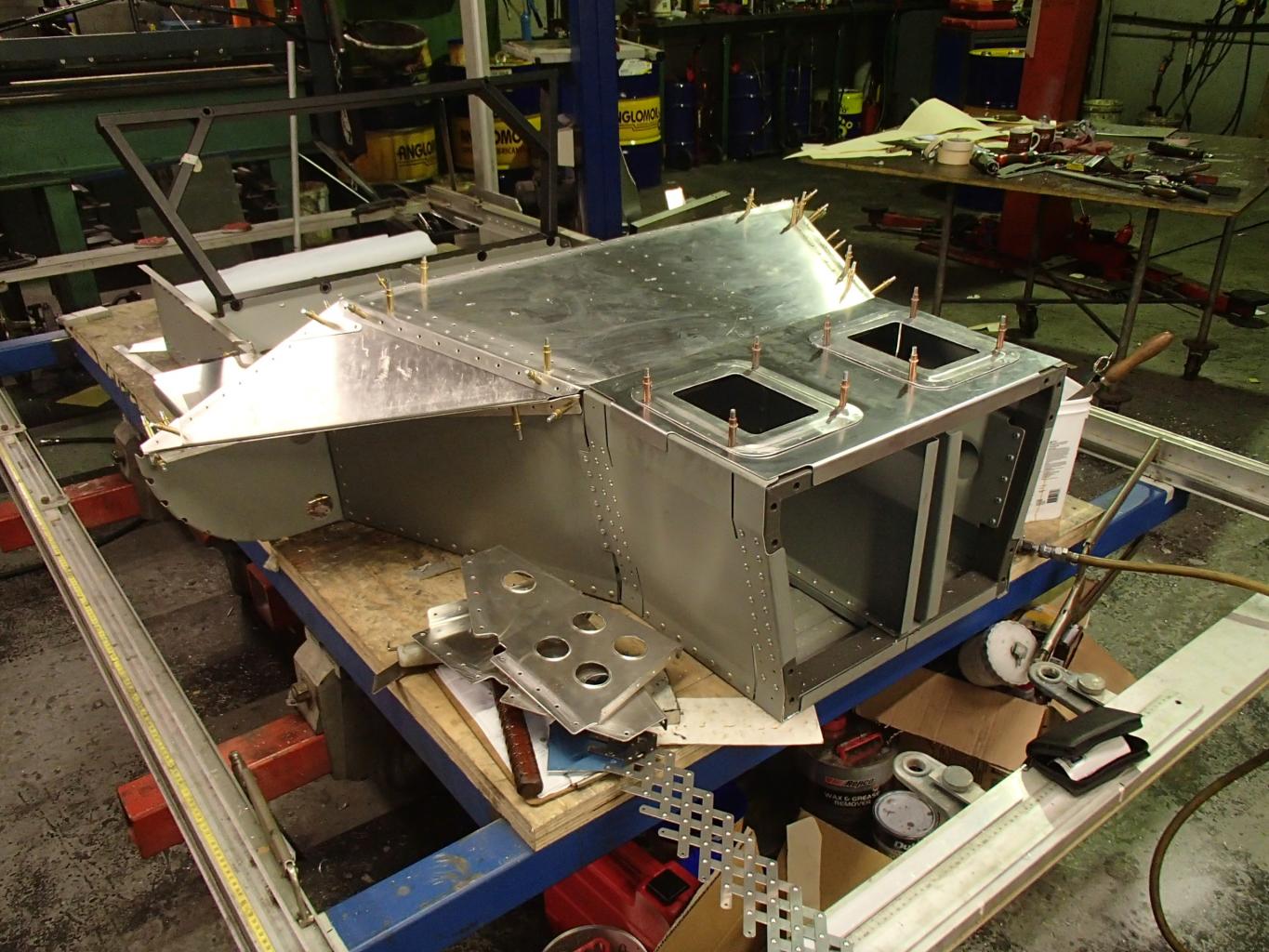

Front top panel I need access to get at pedals and suspension bracket bolts.
I made two raised panels to keep water out.
They will then get covers to seal the hole.

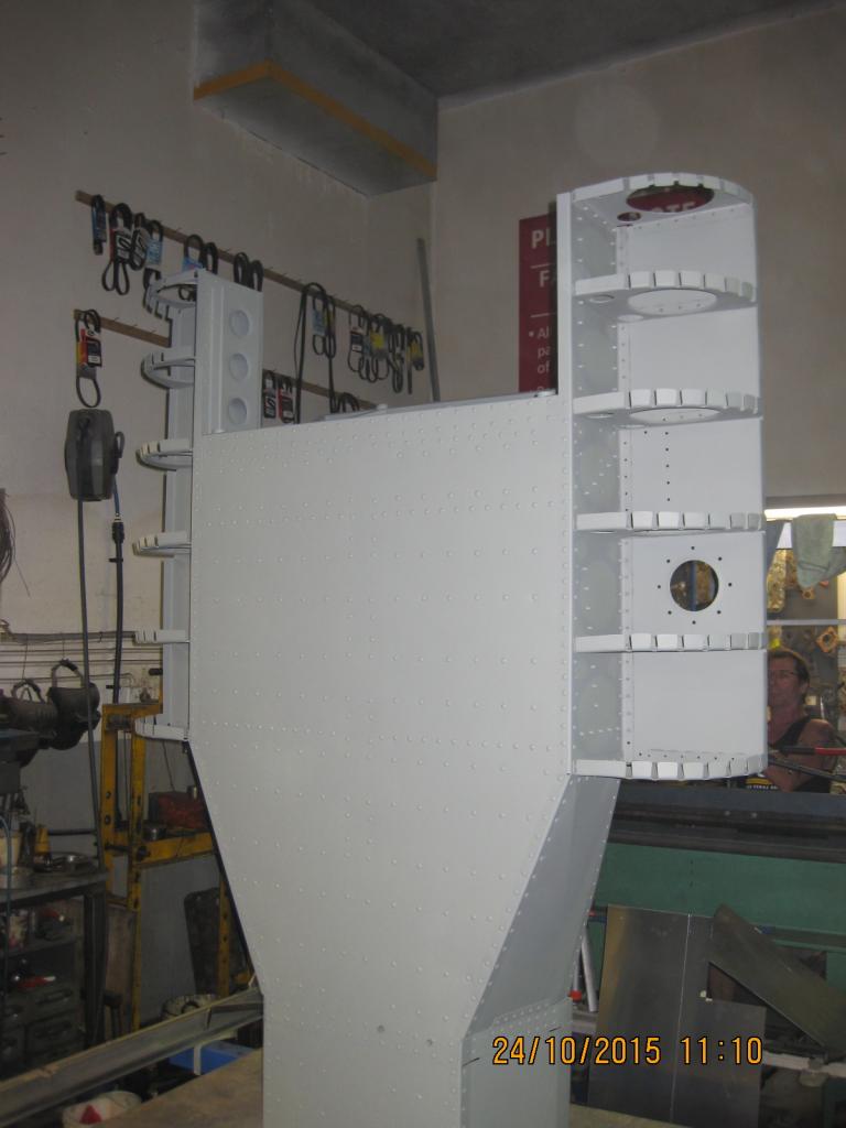

Some up dates the tub is finished, Funny I didnt have a completed photo but these are close enough.
In a bit of a hurry so I will wack up photos and brief description.
this is the tube nearing completion.
The last 2 are in the paint stage before the dash structure was fixed.
It made it easier to paint.
I decided on a very practical easy to maintain line on this car so the lot gets painted,latter on if it gets knocked around it will make touch ups easier.

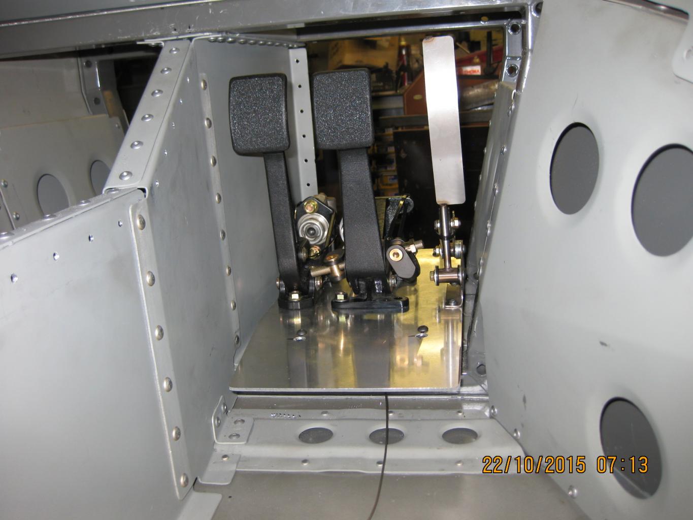

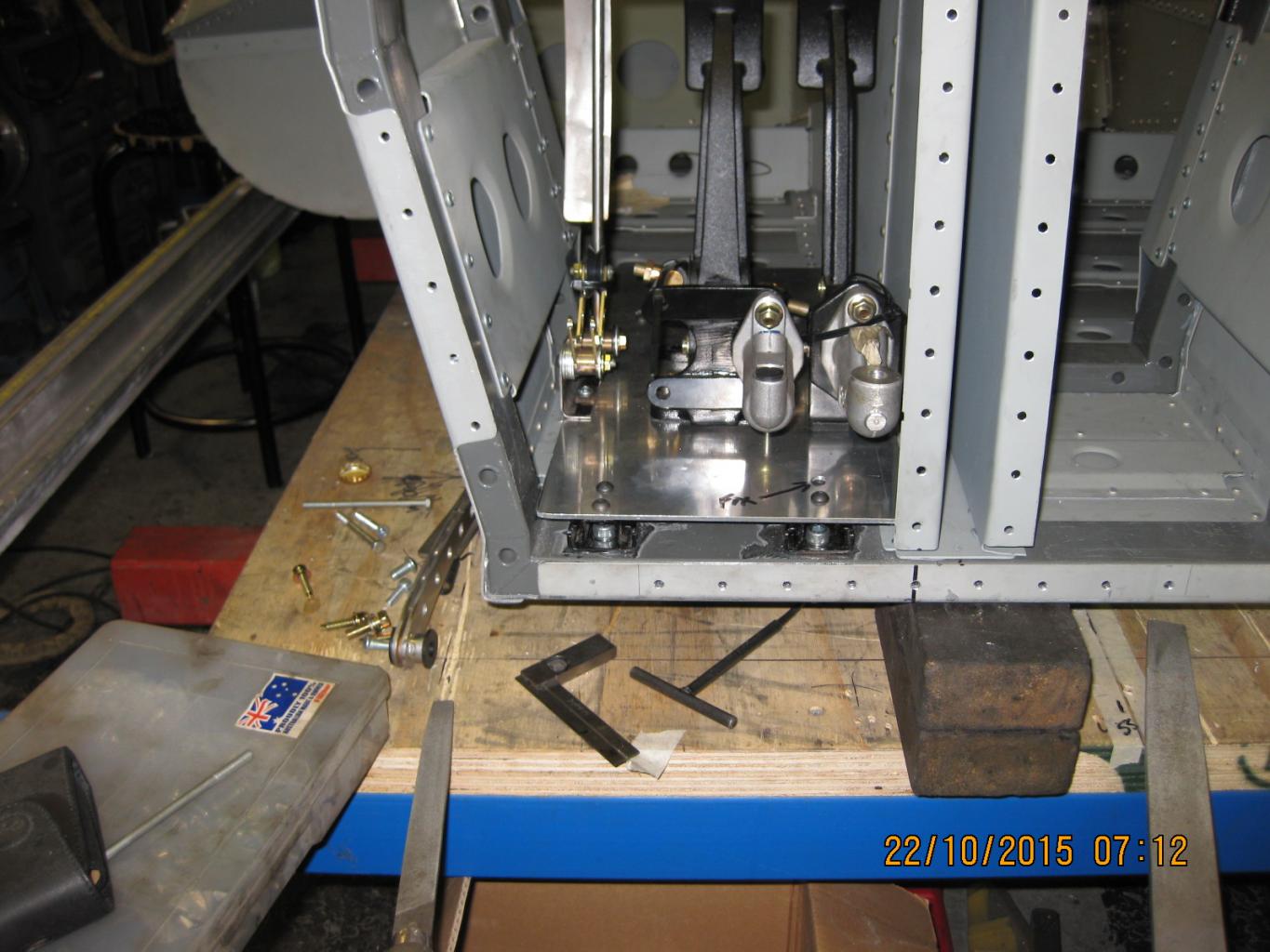

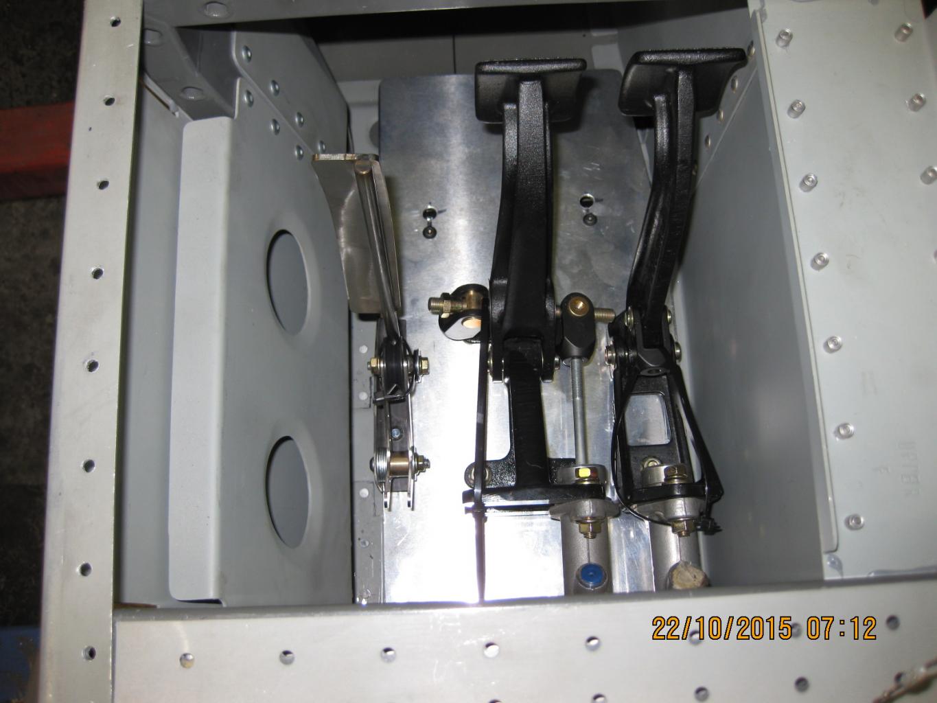

As the seats are fixed the pedals need to move so I put them on seat tracks.
I made the throttle pedal ,brake and clutch is wilwood, they are separate pedals.
They where to cheap to make and they are light.
I sorted all this out before fixing the top structure as it would have been a pain working through the inspection holes.

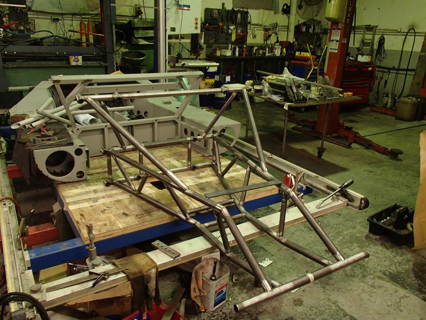

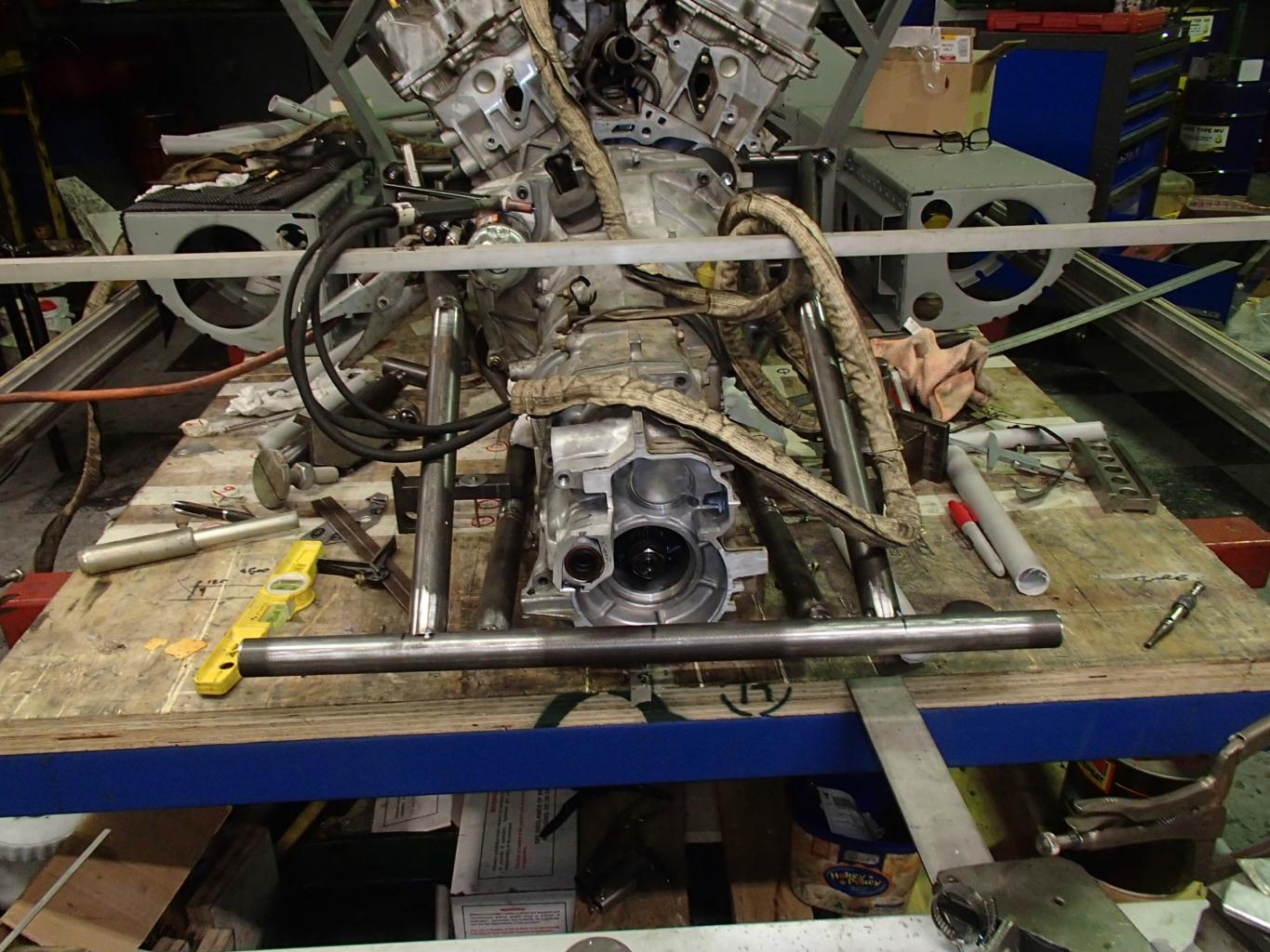

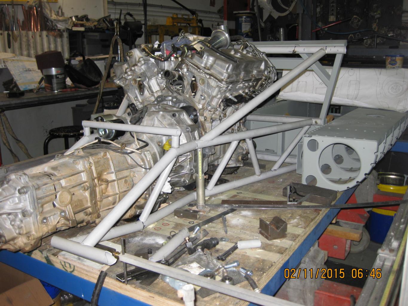

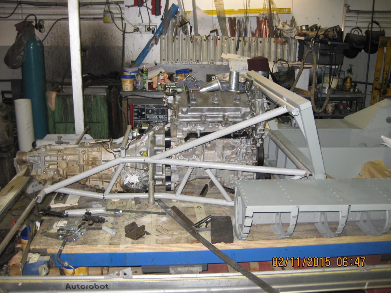

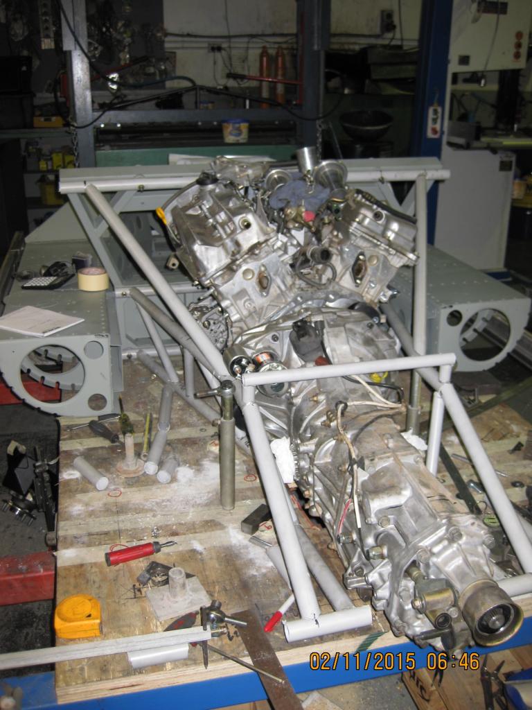

The rear frame I tried drawing twice and gave up because you need to do real life sometimes.
It will be 32mm and 25mm x 2 chrome moly, dont know what you guys pay but its $22 per meter.
So you dont want to start throwing it around.
My approach was 32 mm and 25mm electrical condute and a hot glue gun, condute $30.
I am glad I did because I did change my mind on a few things along the way.
I used the measuring table to get all the pick up points and I made them out of alloy sheet and glued them on as well.
It was well worth the days work as I resolved several issues before starting for real.

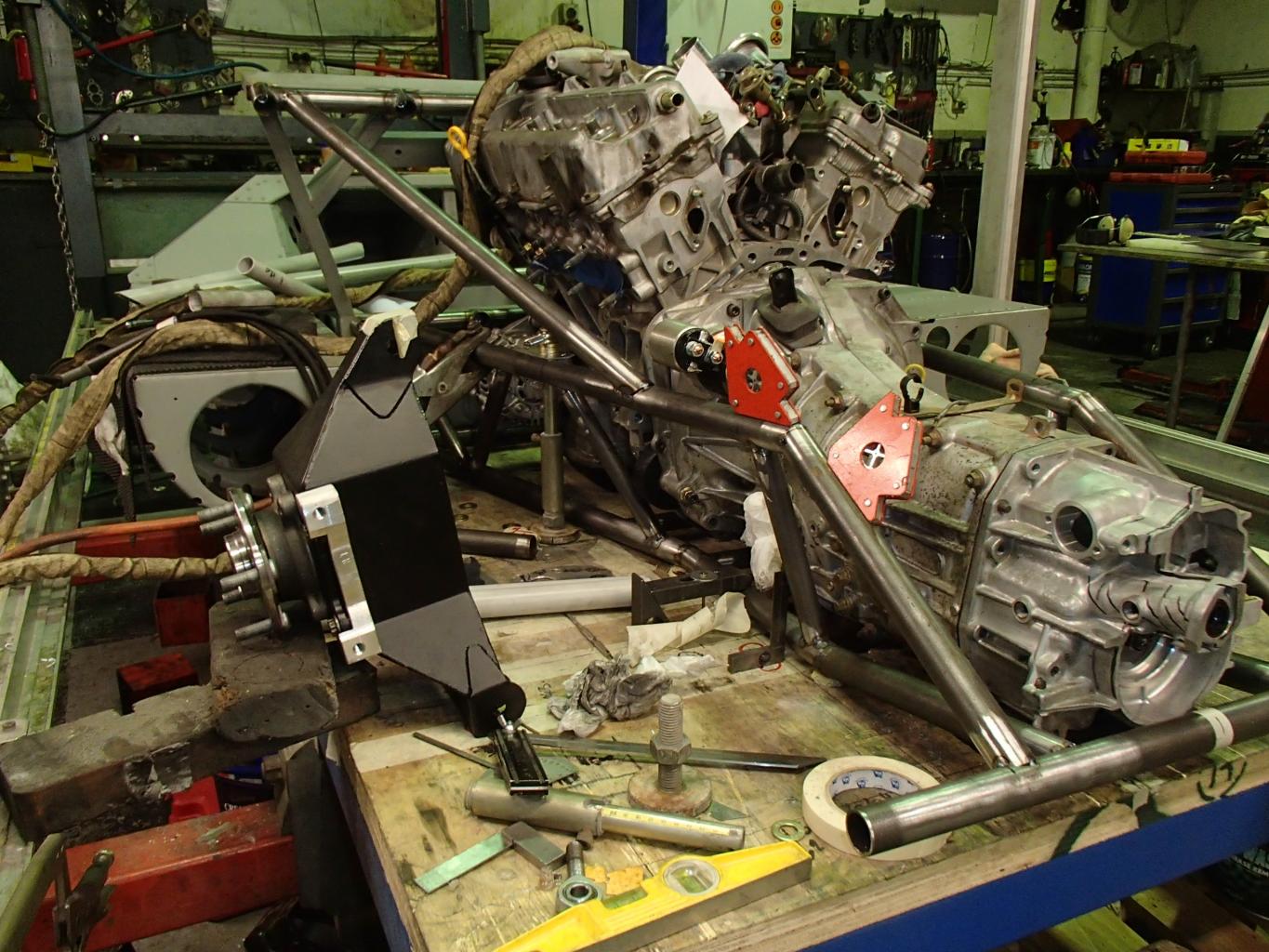

And yes guys it is a Subaru box, you remove the center diff and transfere gears out of the rear and bin them, you buy a splined sleeve and rear case that will loose about 200mm of the back.
link
Subarugears
The box cost me $250. You can buy diffs /gears/cv flanges ect ect.
The engine was $700.
I am going out off my way to be mean on this build.
Thats it, dosnt look much but it takes time.
Chassis weighed in at 56.2 kg.
jim

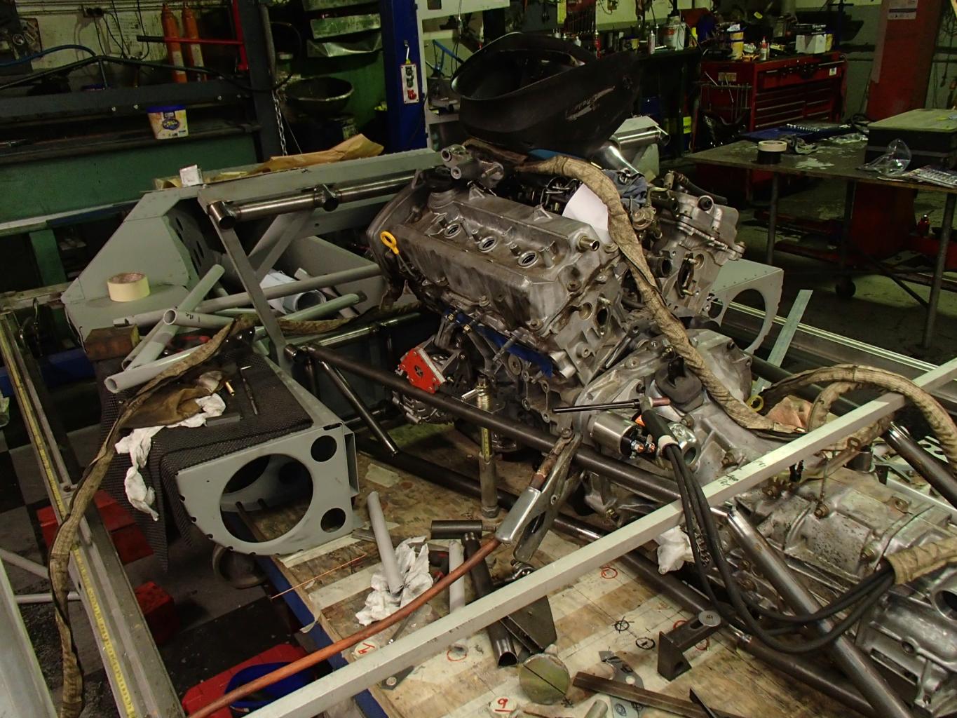

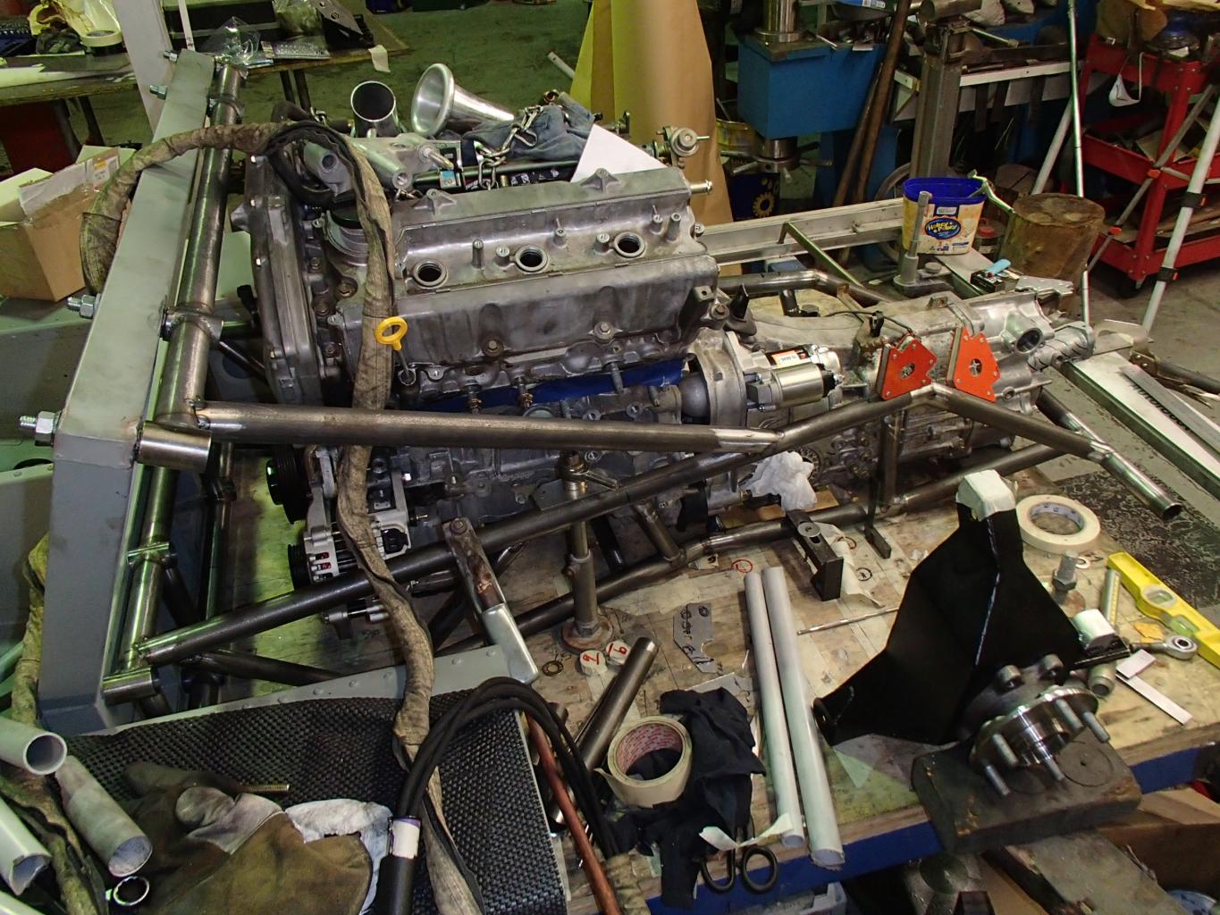

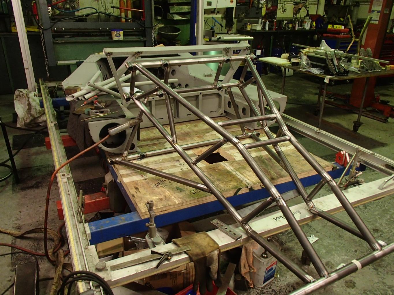

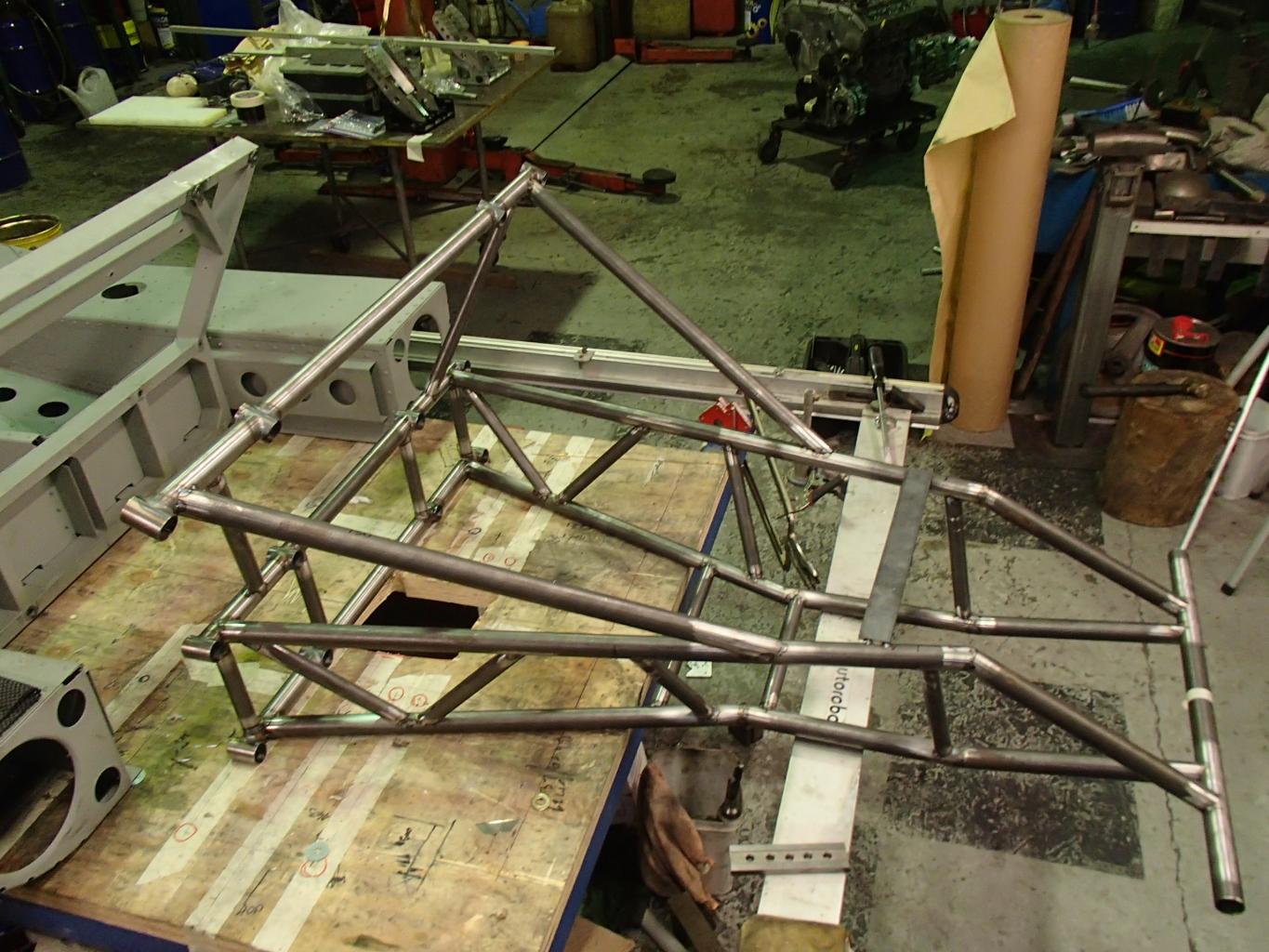

This is the rear frame in chrome moly tube.

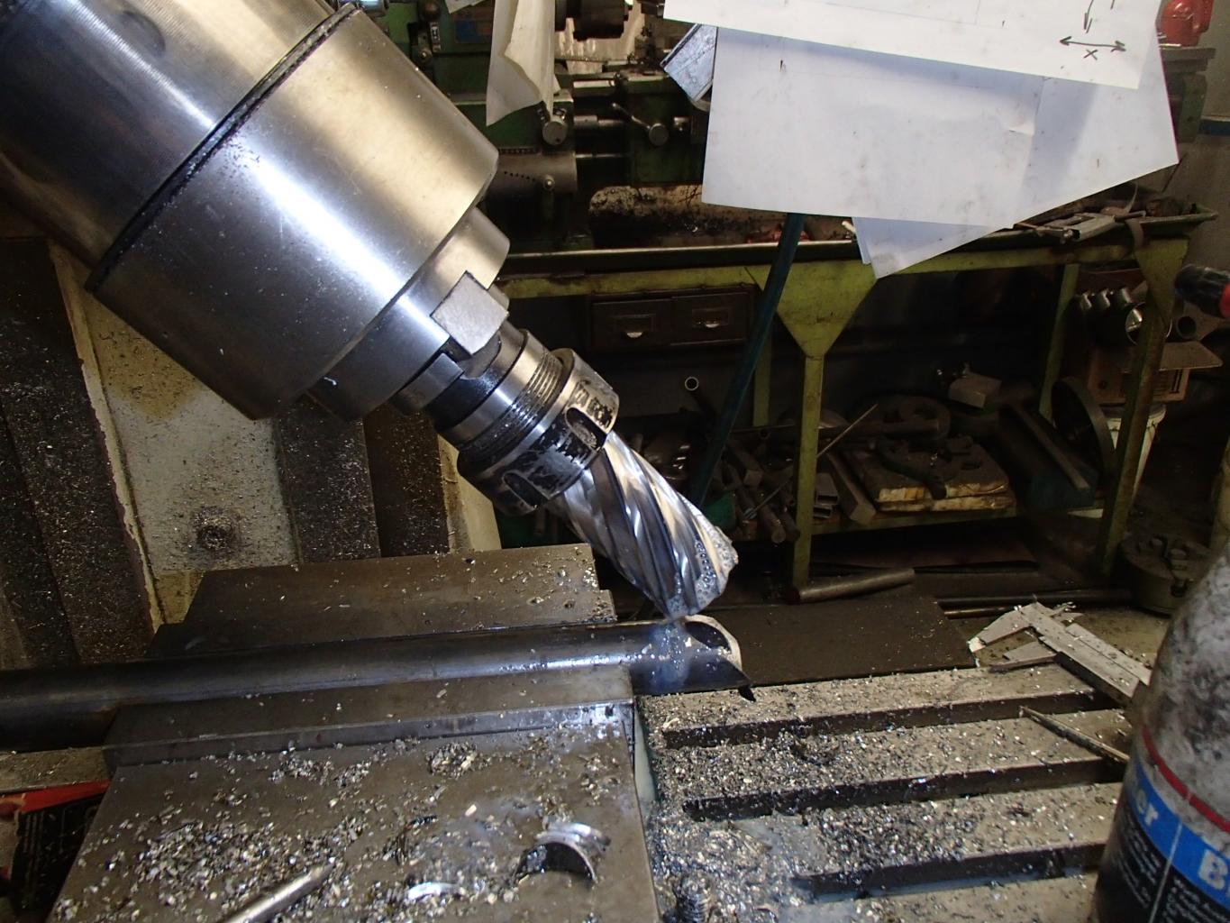

The mounts that bolt to the chassis I machined out of 4130Cm solid bar,they have a 4mm thick floor and a 2mm wall, they are a cup.
This is all tacked up and ready to weld.

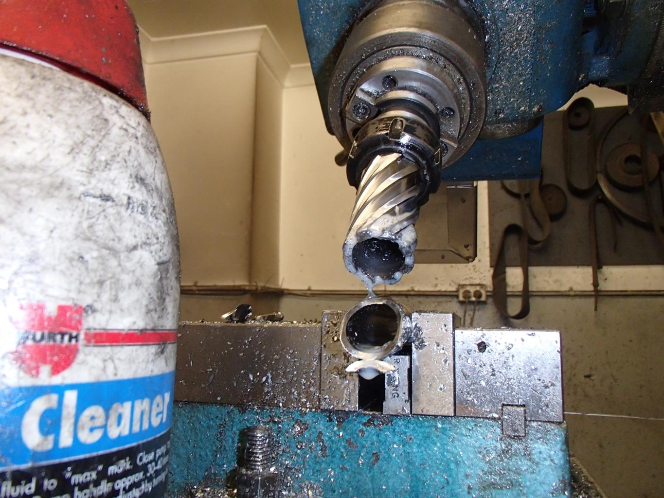

The machine tool is called an annular drill. it is a drill bit for magnetic drills for beam work.
They are cheap and work well.
The pic of the frame Is where I was at this week so I went in at 4am and got stuck in.
By 4 in the afternoon I had it ready to weld.
jim

This was today's progress.
next stage is eng and suspension mounts.
Jim
