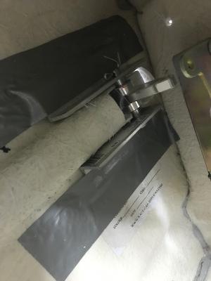

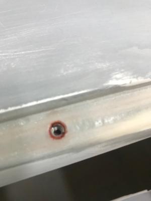

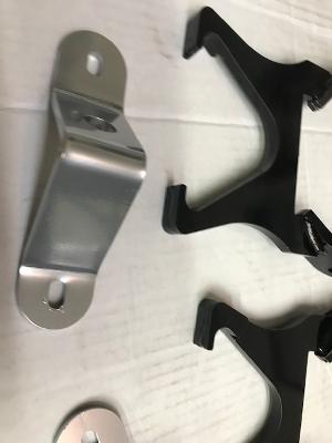

I spent some time today on the door handles. There was not enough meat on the fiberglass to drill a hole and install a pin to hold the door handle. I cut and drilled a couple of pieces of angle iron and made a small pin to hold in place. Worked out good..just need to fiberglass the angle iron in place.

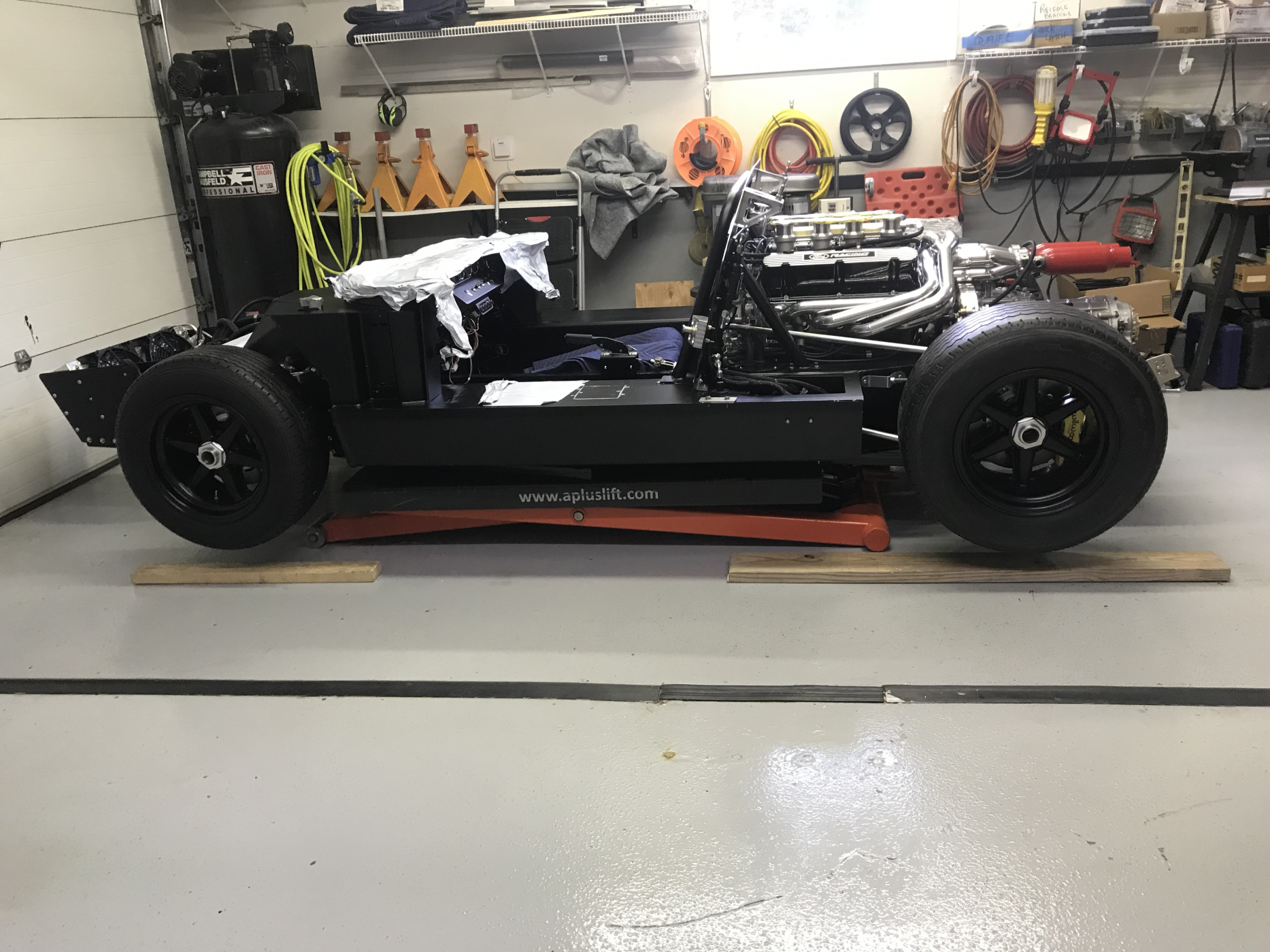

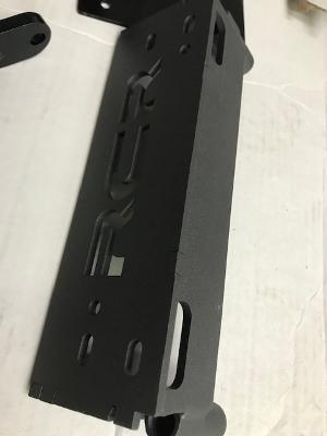

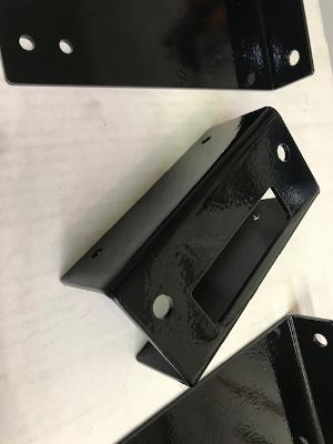

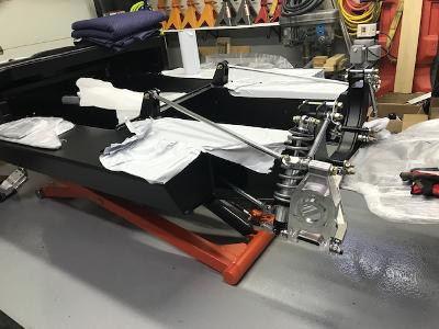

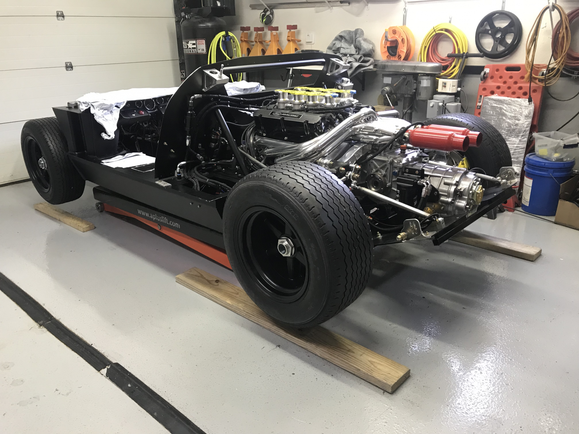

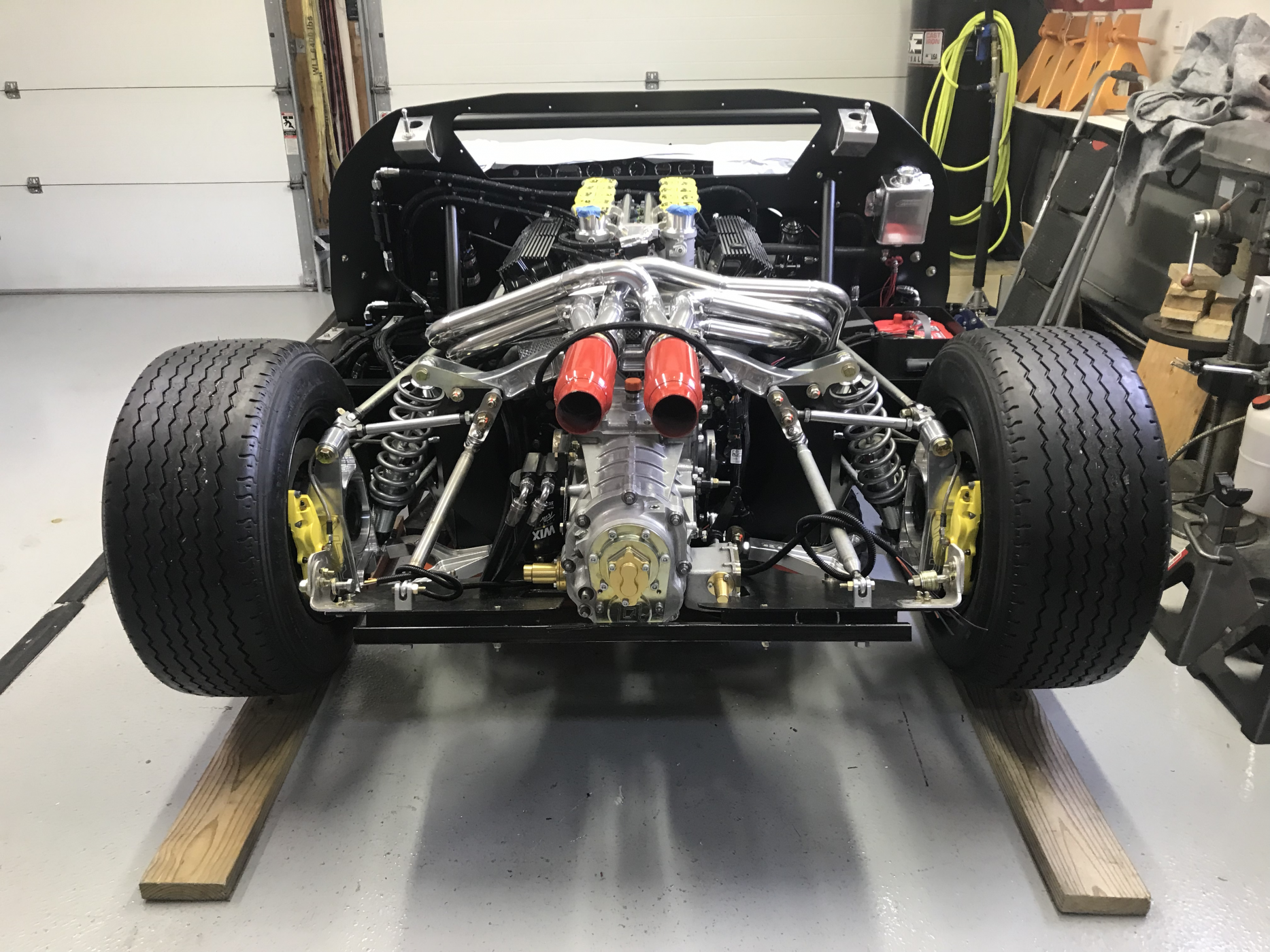

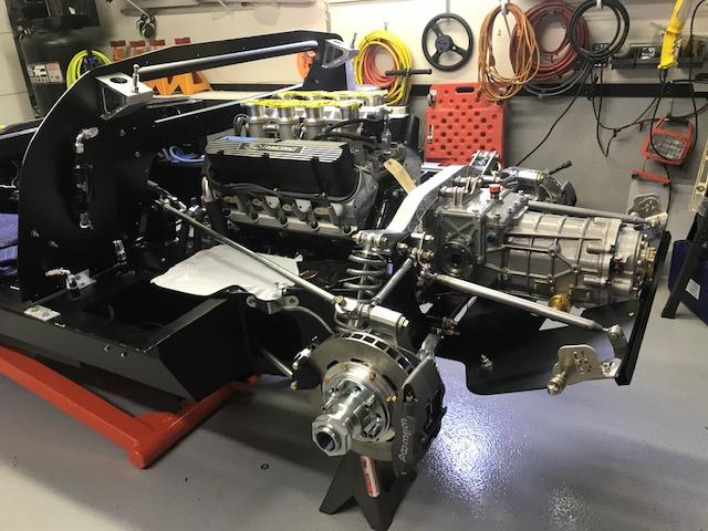

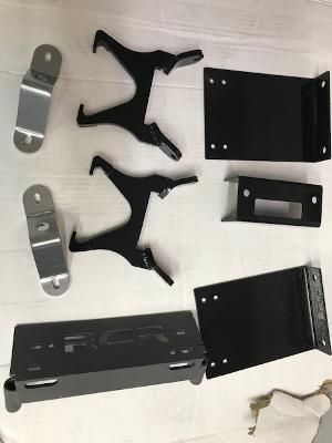

Got my chassis back from powder coating. I had them use a Satin Black powder and I am very satisfied with the way it came out. I will add an undercoating on the bottom. I started the process of re-assembling the front and rear suspension and some panels. I am taking my time polishing some of the aluminum and powder coating some of the smaller uncoated pieces.

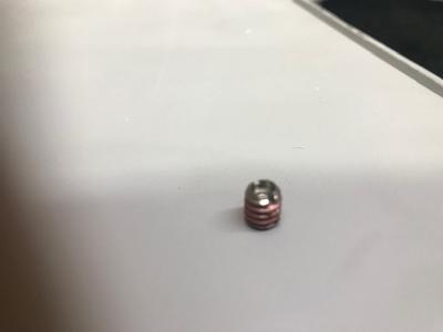

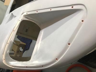

Today I spent some time finishing up installing threaded inserts for the light covers. After trying a couple of different fasteners I decided on these 6/32 #9024A008 from McMaster Carr. I drilled and tapped then added a spot of glue before installing. Theres not much room and meat to work with in some areas but worked out fine.

I think these inserts work fine on the Light covers however I am not sure about using them on the side windows.
What are most guys using for side windows. ? any suggestions?

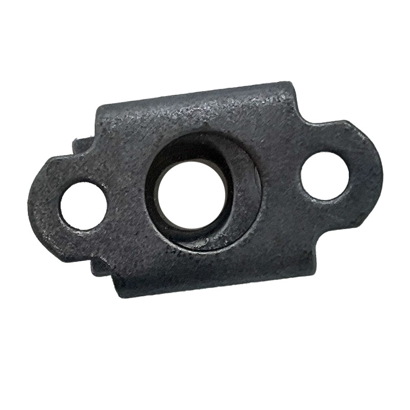

Neil
These will not twist out and they provide a self-locking feature for the threaded screw. The "floating" insert allows a little misalignment of the hole pattern in the window.

Phil, I like the look/function of these and just went to the McMaster-Carr site. Were they really $9.45 EACH?

Neil
I am not sure how I would attach those. Wouldn't I need access from the back which is not possible?

The Stainless inserts come in a pack of 5 for $10.38. They are the thick wall ones 90247A008.
You can also get them in Black Phoshate @ $6.75 for a pack of 10. No reason they shouldn't work just as well. #90248A017
Hole needs to be drilled and tapped then just screw in while adding some type of glue preferably something like super glue. The driver bit they sell works great.

For those of you that have considered setting up to do your own powder coating I say go for it. I did not realize how easy it is to setup and powder coat. All you need is a small blaster, an electric stove ,and Powder Coat Gun setup which is about $100 and of course Air but most of you have that.
I set it up in my basement and takes up about a 8'X8' area. Theres hardly any mess and takes about 20 minutes start to finish to get a piece done.
Unlike paint there are no fumes and it is totally dry in minutes. One of the best decisions I have made.
