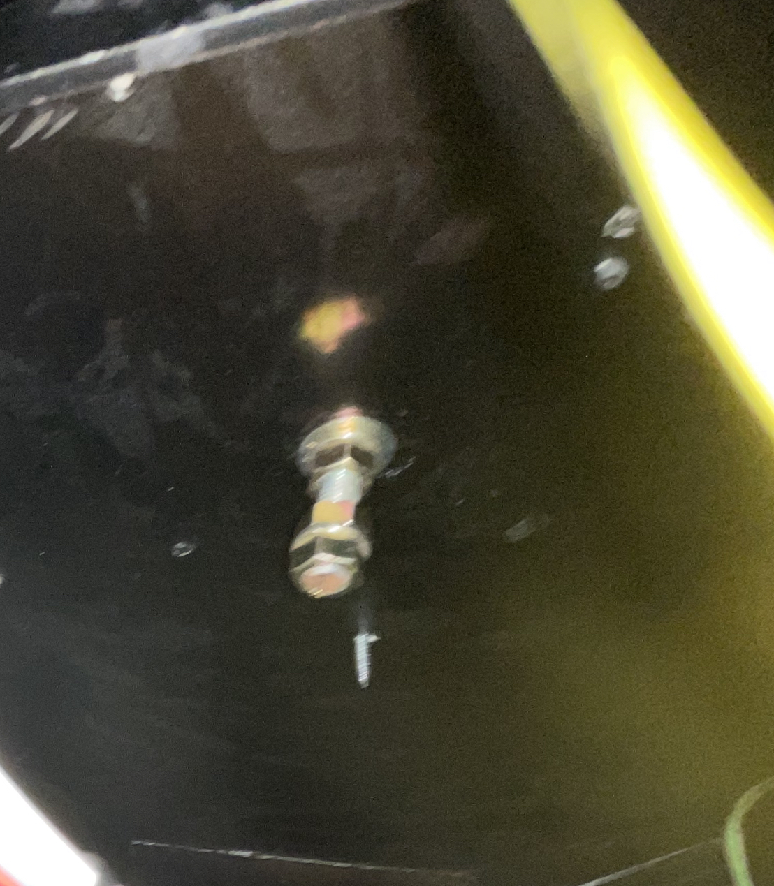

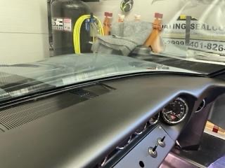

I figured I would post a little adjustment I made on the dash today. I remembered reading a post on threading a couple of bolts into the chassis under the dash to raise it up to meet the spider supporting the windshield. There was a good size gap there. Not sure if you can see the difference in the photos but it looks much better now sitting flush with the spider. For guys building the GT40 if you plan on this make sure you do it prior to installing the dash...I didn't remember about it until after the dash was installed. All though it was not that bad I only banged my head 3 or 4 times and I didn't need any stitches lol.

Phil G
I could only attach one photo. For some reason I cannot seem to attach any photos..keeps telling me the attachment is too large for the server. I never had this issue before...anyone else having this issue?

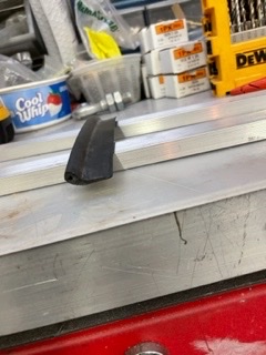

This is what I used on the dash.

Not sure where I got this seal from I think it was some household item I had laying around..I think it may have come from Home Depot or Lowes.
For some reason I had a slight uneven gap there and did not like the way it looked so I used that seal for a better finished look. It really should have been laying flat with no gap so yours may be ok and you should not need it.

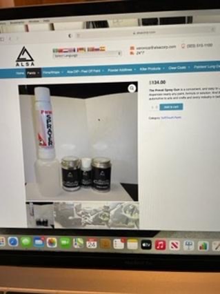

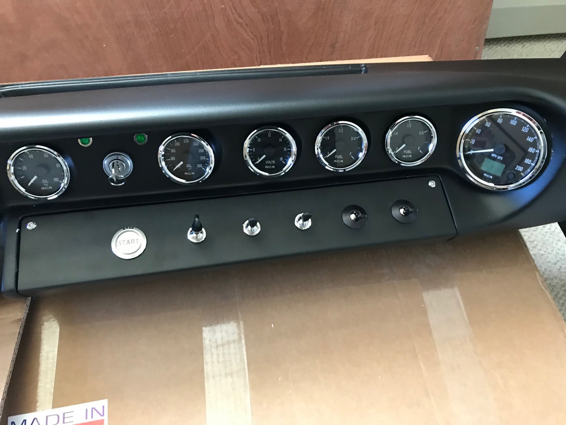

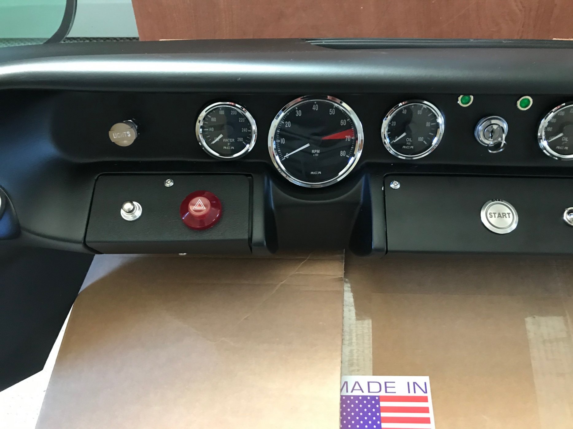

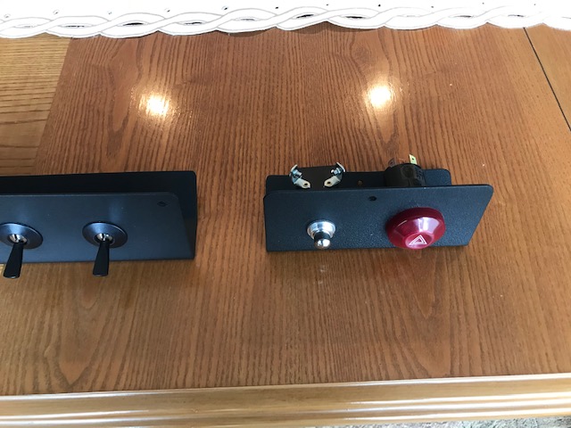

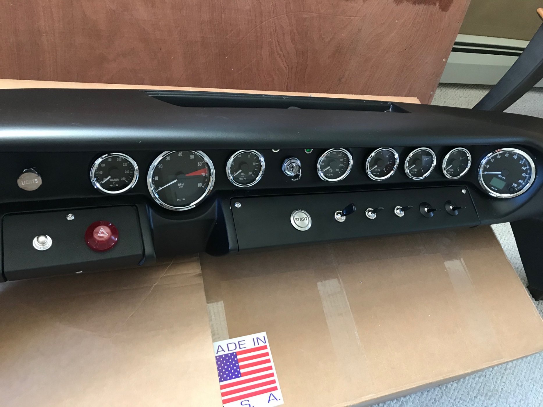

Since my body and chassis are at the bodyshop I started work on my dash. Started by making the aluminum switch plates which where kind of a pita. I made a template then ordered the aluminum pieces (0.63) online which I had cut to size. I used a cheap 18" bench top brake to make the bends then powder coated them in krinkle black.
I painted the dash with ALSA Soft Paint. This paint as the name implies is soft to touch and looks a little like leather when applied over krinkle paint. I used Black Krinkle for the base coat then applied the Soft Touch which is clear for the top coat. I thought it came out nice and I am happy with how it looks. I am not sure how durable the Soft Paint is so I guess only time will tell.
