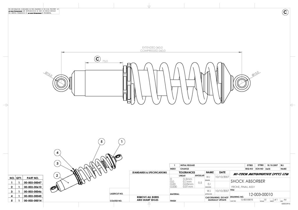

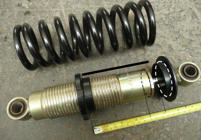

As Carlos seems reluctant I think the attached picture shows the information you are looking for.
The shock length has been adjusted to the fitted length at standard ride height.
The bottom spring seat has been screwed up the same number of turns as on the picture from Carlos.
The spring is the standard item. As you can see it is normally fitted with pre load with the bottom spring seat at or near the bottom of the shock..
The distance between the spring seats is just 5 1/4" with the bottom seat screwed up to that position.
The actual shocks we use have a shorter body length and rubber bump stops fitted.
To compress that spring to 5.25" or shorter as would happen during wheel bump would without doubt result in a coil bound situation resulting in damage to the wishbone and/or chassis.
This is why there is a warning in the manual.
The unknowing do not realise how critical shock length, spring length, bump stops and pre load are in suspension control and that damage can ocurr if all of these elements are not correct.

(C)arlos, the statement from you in the above post is totally incorrect, The coil spring should NOT go into BLOCK or COIL BIND, to do so creates an instantaneous shock load thru the coil over to both the bottom arm and chassis points at which the coil over mounts, coil overs usually have a rubber or soft compound buffer fitted to the coil over shaft as seen in the attached photos, if not fitted then you must fit a rubber 'bump stop' to some part of the car chassis or suspension arm to perform this function. I have read both this thread & your build thread....you chose to not use the Tornado spring damper units, but sourced & fitted the ones on the car yourself, given the above statement its obvious you made a bad choice & chose/fitted a spring that was/is totally unsuitable for the application, under the circumstances you should perhaps be thankfull that the bottom arm failed in the manner it did. Would not matter what type of bottom arm was fitted, if you use BLOCK or COIL BIND as a travel limiter in any form of suspension it will eventually cause further damage or component failure. Looks like you might be the guy who needs to read some books!

Spring lengths and rates are not relevant.
You can clearly see in the picture that the correct spring will not fit between the shock seats without being coil bound when adjusted as in the picture from Carlos.
Andy
I don't have a dog in this fight, but purely for my better understanding of the factors involved, I had to take the photo, determine the wire width, multiplied by the number of turns (and partial turns), to come to the conclusion that the binding point at full compression was most likely the spring, but it was very close between that, and the shock itself binding. The thick black line (in the photo below) is the full length of the spring at full compression, as I've guessed it to be based on adding up the wire width turns.
Even though it has been stated that spring length and rate are "not relevant" in this discussion, I ask, "how can that be?". Is this because a too severe a rate would have been only slightly preferrable to the weaker rate that would have bound (and thus causing the arm to bend)? Was the rate so weak that it had to have all that preload in order to hold the chassis at a proper ride height?
