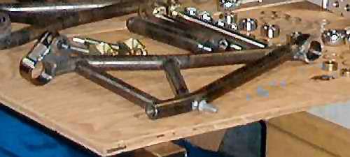

in the more original GT40 style (see look alikes?) they also have it more to the hub so the stress on the arm is less.
03 - Front Suspension, Shocks, Steering & Related
one part out of that link>>
yhst-79022529958143_2219_17235472
not that those parts would fit on a Tornado GT40, but as example.
the closer to the hub (shok mounting point) the less stress on the arm, not that the original look version looks so strong, but that you can work on also if you need.
