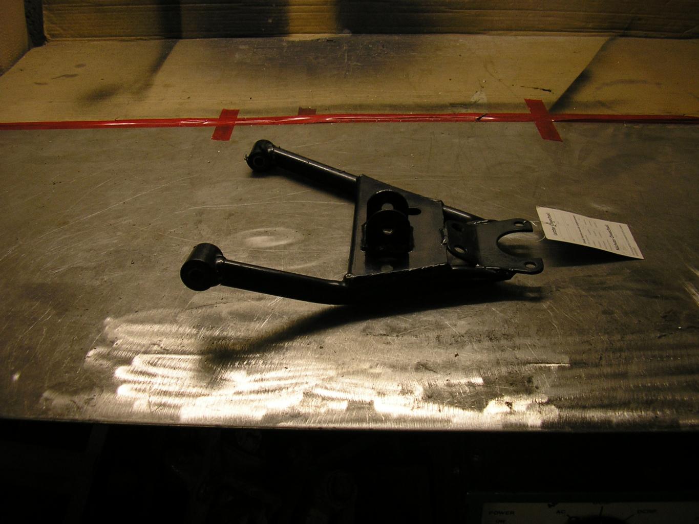

here is the promised pic taken from the left arm.
As you can see it is also bend.
This is not because of any over stressing while racing, this is because the material is to weak and was bended over time.
It is not a good pic as we where already packing the stuff to send it for inspection and making new ones by another vendor ..
Unfortunately my Job is eating me up at the moment and I am traveling like hell across Germany, I will come back to you all over the weekend with a calculation example and pic why the design is seriously wrong

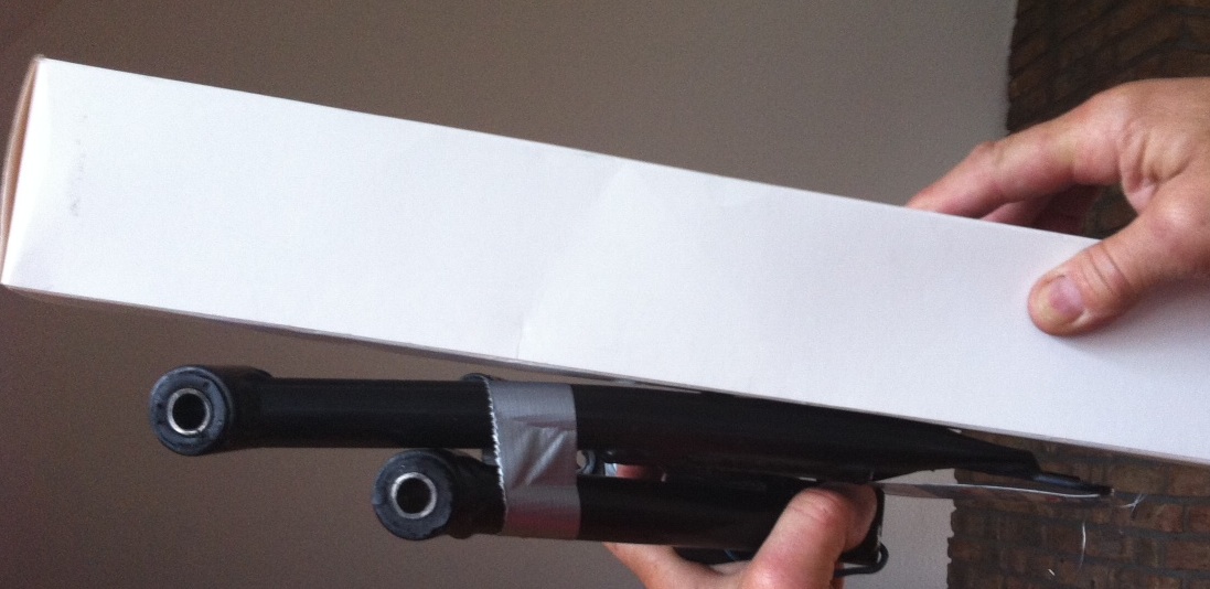

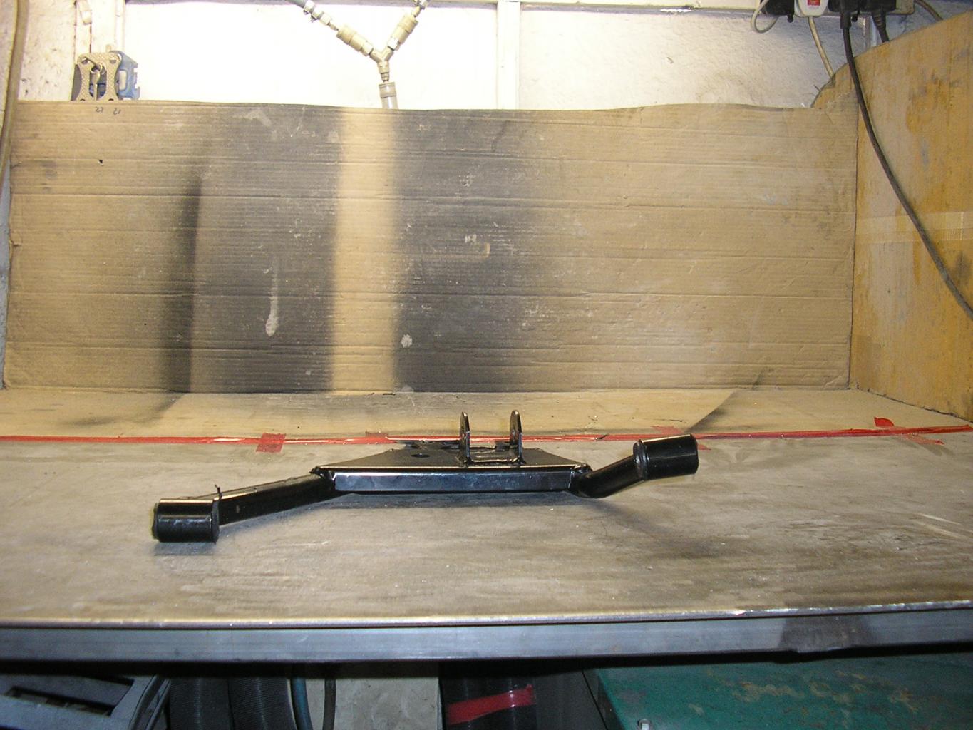

These are the arms reffered to in this debate, sent to the UK by Carlos

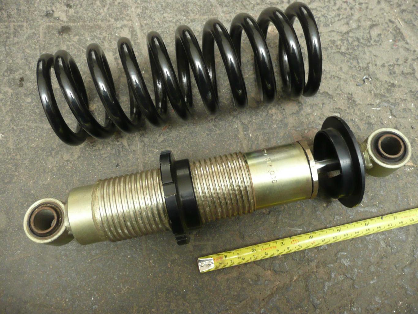

As Carlos seems reluctant I think the attached picture shows the information you are looking for.
The shock length has been adjusted to the fitted length at standard ride height.
The bottom spring seat has been screwed up the same number of turns as on the picture from Carlos.
The spring is the standard item. As you can see it is normally fitted with pre load with the bottom spring seat at or near the bottom of the shock..
The distance between the spring seats is just 5 1/4" with the bottom seat screwed up to that position.
The actual shocks we use have a shorter body length and rubber bump stops fitted.
To compress that spring to 5.25" or shorter as would happen during wheel bump would without doubt result in a coil bound situation resulting in damage to the wishbone and/or chassis.
This is why there is a warning in the manual.
The unknowing do not realise how critical shock length, spring length, bump stops and pre load are in suspension control and that damage can ocurr if all of these elements are not correct.

Spring lengths and rates are not relevant.
You can clearly see in the picture that the correct spring will not fit between the shock seats without being coil bound when adjusted as in the picture from Carlos.
