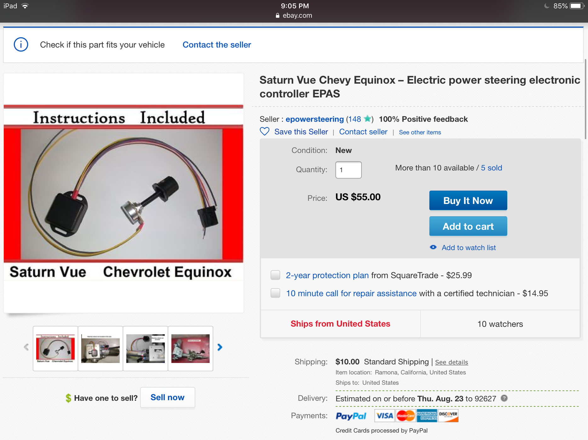

Stateside people that want EPS should look into Saturn Vue and the Ebay controller. Dirt cheap if you go to the U-Pull yards. A little more if purchased on eBay.

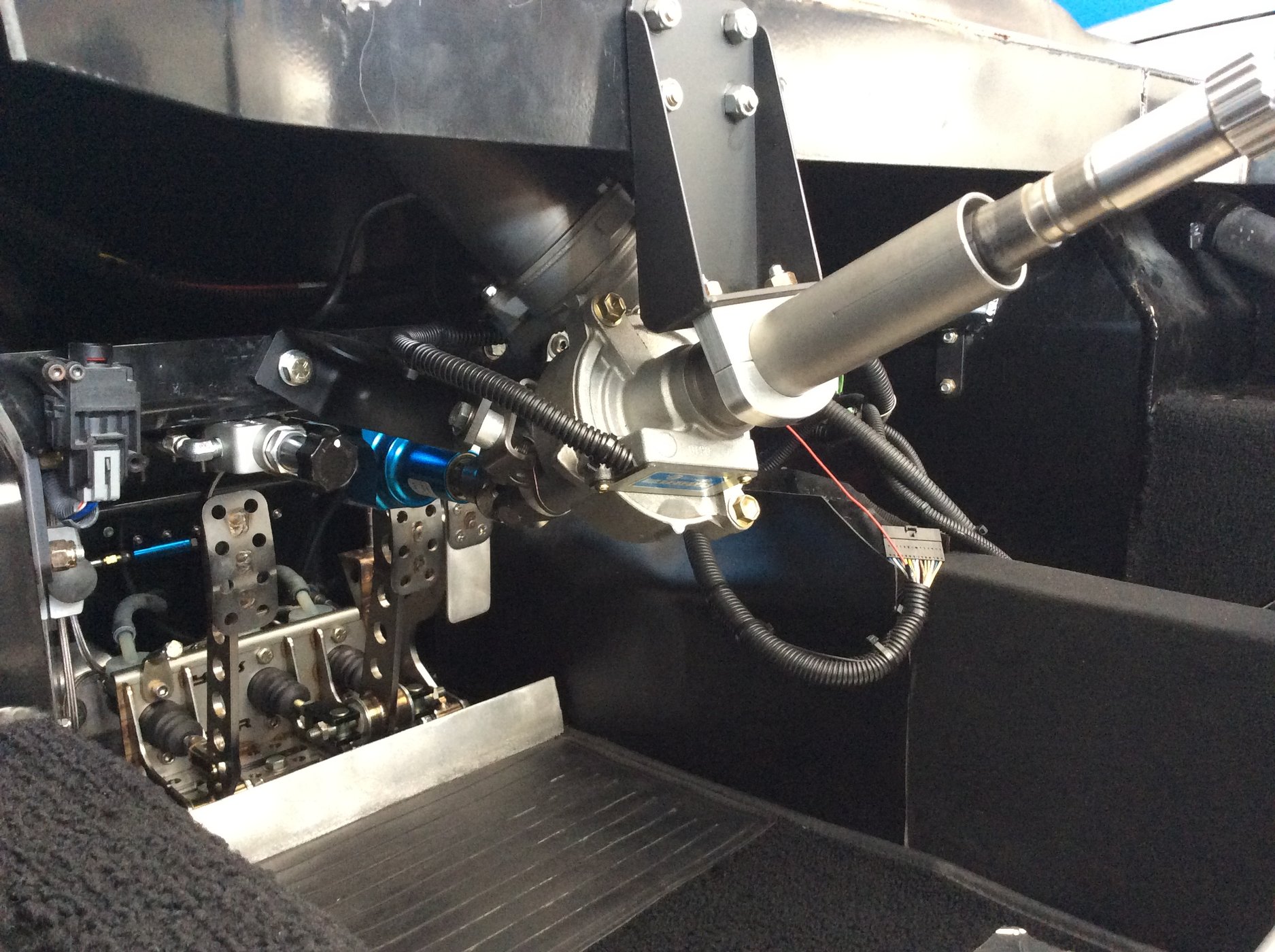

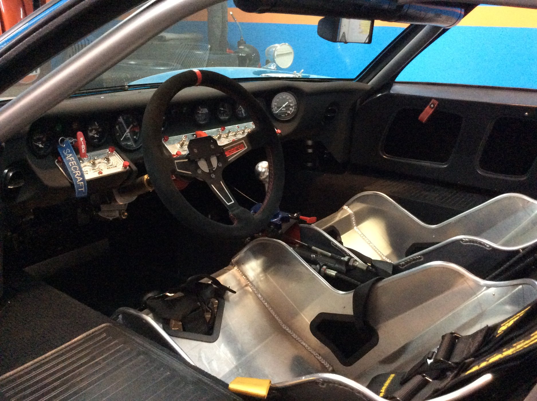

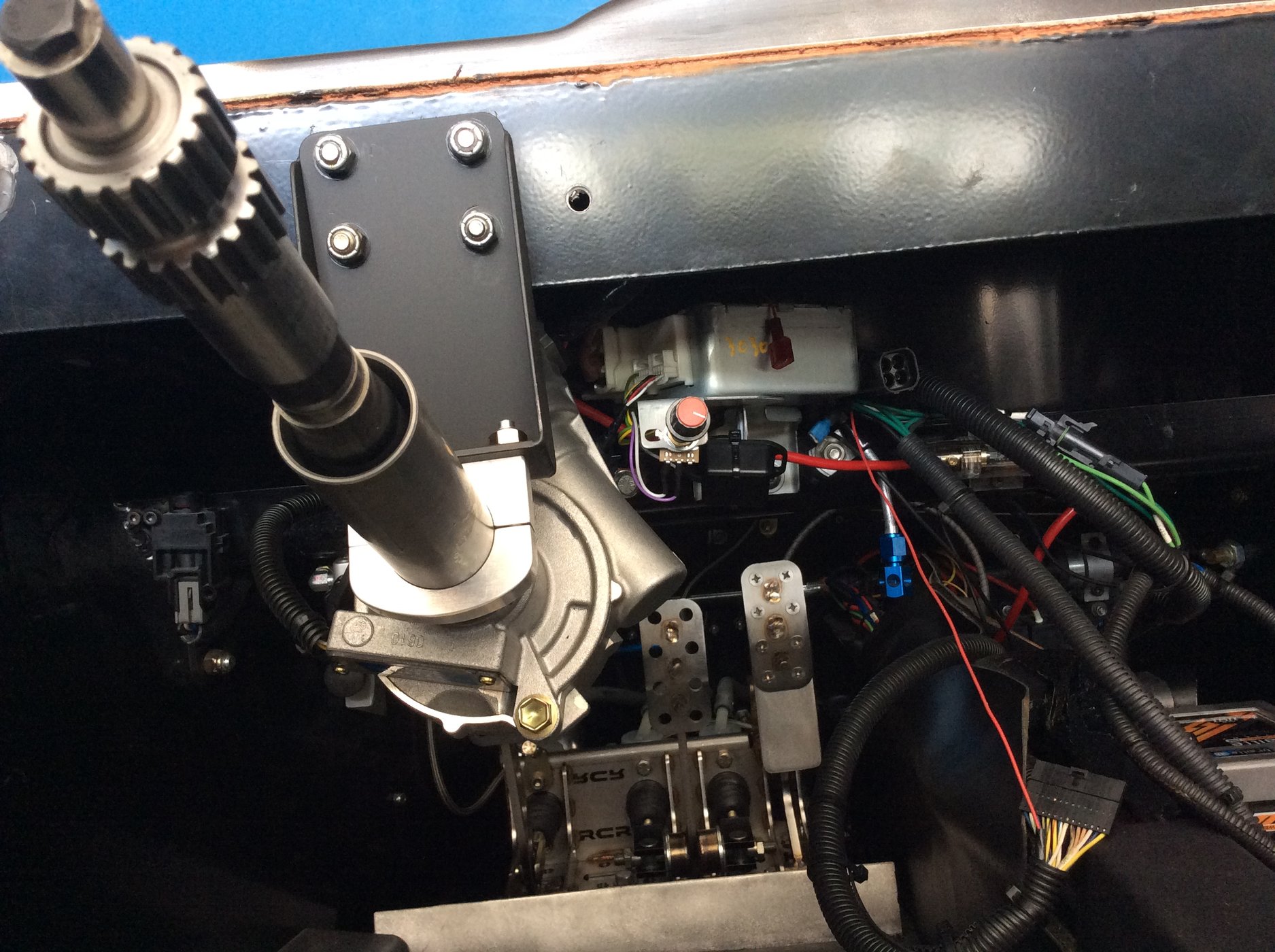

I made one fit from the Prius with the 1.5 :1 Steering quickener was like driving a different car on the track never liked the slow steering on my RCR this makes it way easier to correct the car

If anyone is considering fitting a power steering system, they can put pretty significant loads on their mounting points, just make sure they are fixed to something substantial.
