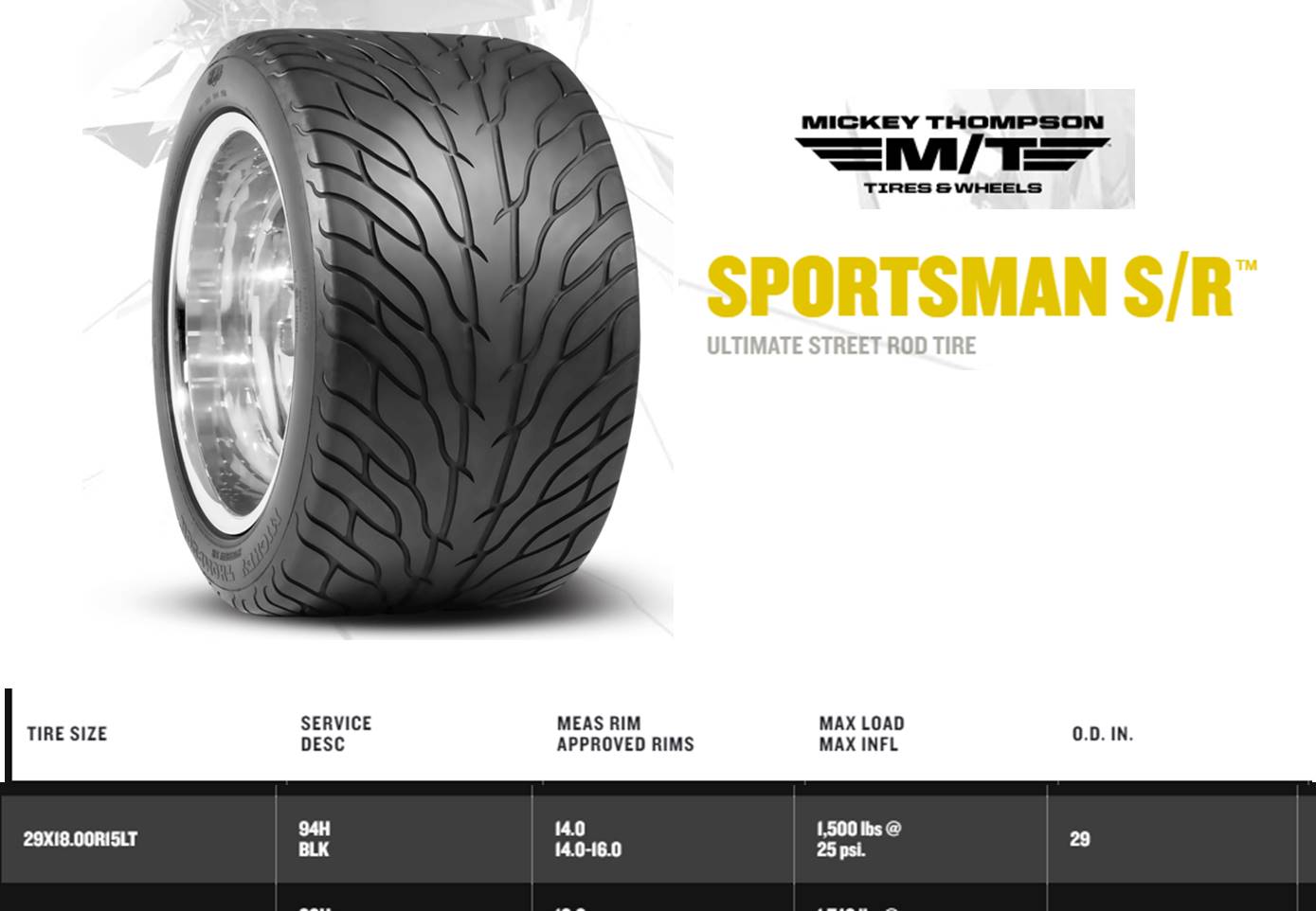

The Mickey Thompson tires come closest; but seem to be more of a 'show tire' than a performance tire - I wonder if anyone has experience with them ?
Anyone got experience with these ?

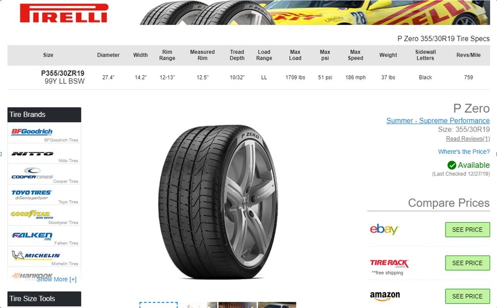

The Pirelli P Zero is a much better tire than the Mickey Thompson; but requires 12"-13" wide rim and 19" diameter. Not much good if running 14" wide and 15" diameter rears.

We have customers using them on Cobra, none on a GT40 as far as I know. Here is a size chart:
https://mickeythompsontires.com/street-tires/sportsman-s-r#sizes
Note that they carry the "LT" (light truck) rating. The people we have with them on Cobras are in the 2300-2550# weight area and they are happy with the grip.
Hi Rick ... No; I do not believe the Mickey Thompson Sportsman S/R has a LT (Light Truck) Rating ... they do have other tires that certainly do, but not the Sportsman S/R. My personal opinion is that it is an older technology (Speed Rating = H is a clue) Radial Show Car (Hot-Rod) Tire. Which is why I am curious about anyone using them for circuit work. I do not mean to offend the Cobra guys, but I suspect their chassis / suspension is not sufficiently refined to fully load up very high performance radials (eg. Michelin Pilot Sport / Pirelli P Zero class tires)
