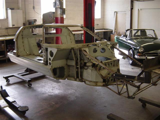

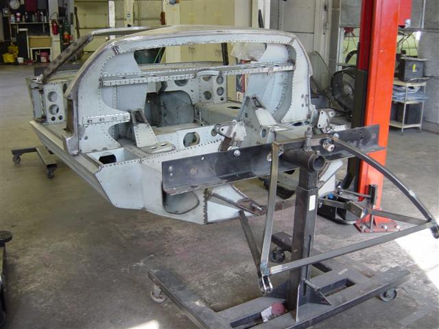

This should show a couple of photos of 1149s tub on the rotisserie rig. If I've done this right :)

Jim Rosenthal
Note SunbeamTiger in the background, evidently these guys are Ford aficionados....nice. Not a GT40, but then again you can't put the top down on my car, either.

Very nice Jim......very nice....... would love to see the build-up pictures after the paint goes on.
The chassis looks like its zinc plated sheet steel.... what surface prep, undercoat and final coat are you having done?
(Vested interest in this as my mono is zinc plated)

Jim Rosenthal
They will rough up the existing surface to get a tooth on it, then epoxy primer and a two-part epoxy paint, which is a dark-gray metallic. Including inside the sponsons. The areas which are not zinc-coated will need a little sanding or glass-beading to get the rust off, I think. I don't know what we're going to do with the bottom of the tub- some kind of lightweight undercoat or something like that.
We are still talking about what to do for fuel tanks. I don't think we're going to the trouble of bladders that fit into the sponsons; with cold fuel going in and out, it virtually guarantees condensation inside there, which in turn makes rust likely, especially in a car that isn't driven daily. I think I would favor plastic or poly tanks that can be slid in from the end, with access ports in the top. We're still looking around on that one.

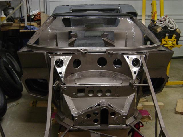

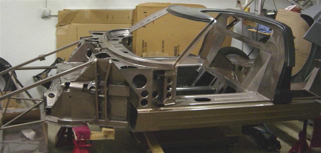

This should be a couple of shots of the painted monocoque of 1149, just back from the paint shop. Buildup now begins.
Jim Rosenthal
Also note the vintage 289 SBF with RIS (rope induction system). How this works: we saturate the rope with fuel, start the engine up, and the airflow vaporizes the fuel in the rope and pulls it into the intake. About every hundred feet or so, we have to stop, get out the fuel can, and resaturate the rope. However for the cost of Webers we can buy lots of rope.

Ohh that's what that is. I thought it was a new take on the bundle of snakes exhaust. :)
