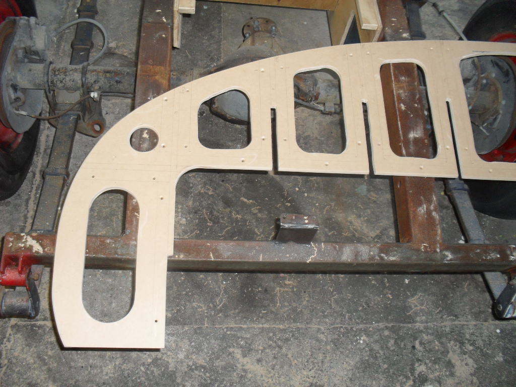

I am using reliable drawings to create the body shape, absolutely no digital stuff here. Manual drafting board and then manual hole, band and jig saws to do the wood work on the buck. After studying the scale model I have, I realized it is not even close to accurate . So Jack I decided I am not going to use any scale model what so ever.
Graeme S.-- Thank you for the suggestion but I want to do the aluminum body work myself.

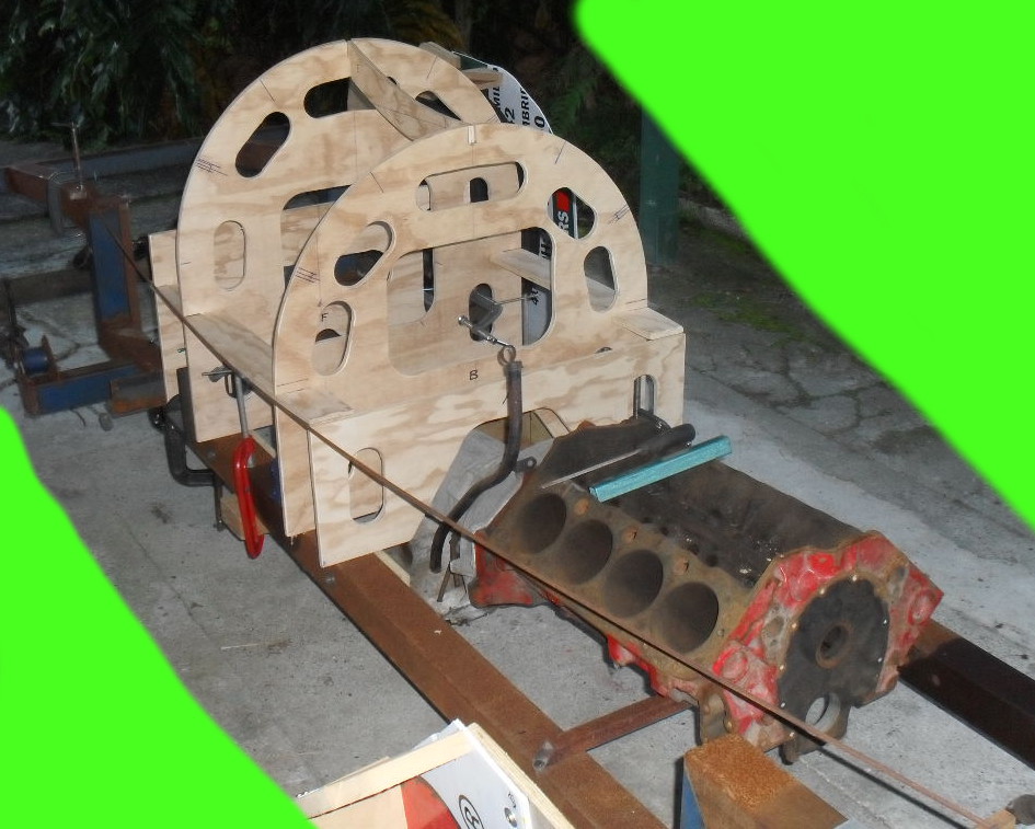

Started on building the body buck. Reasoned to start in the middle with the scuttle first and then work forwards and aft .
Z.C.

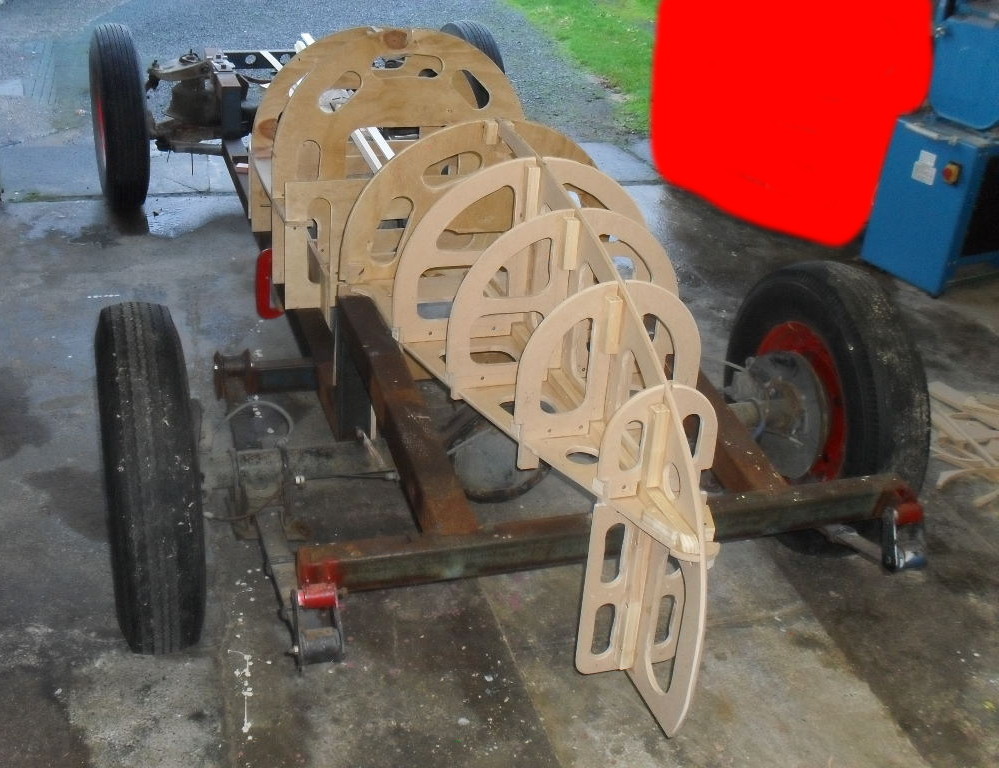

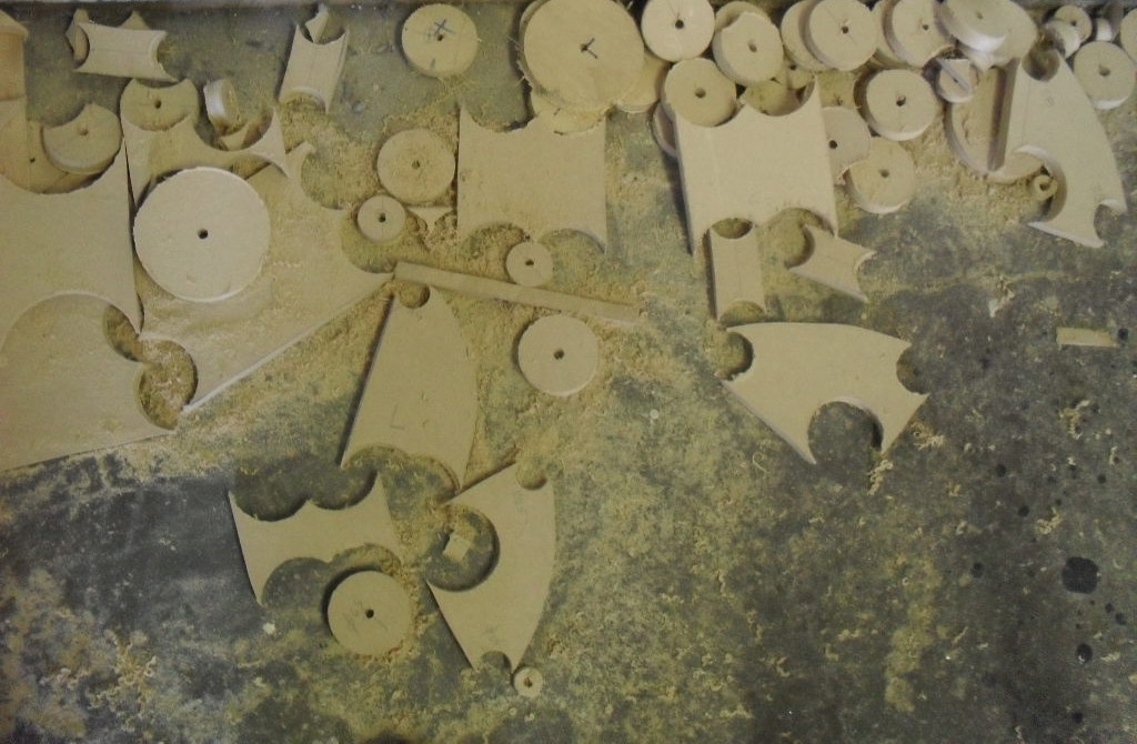

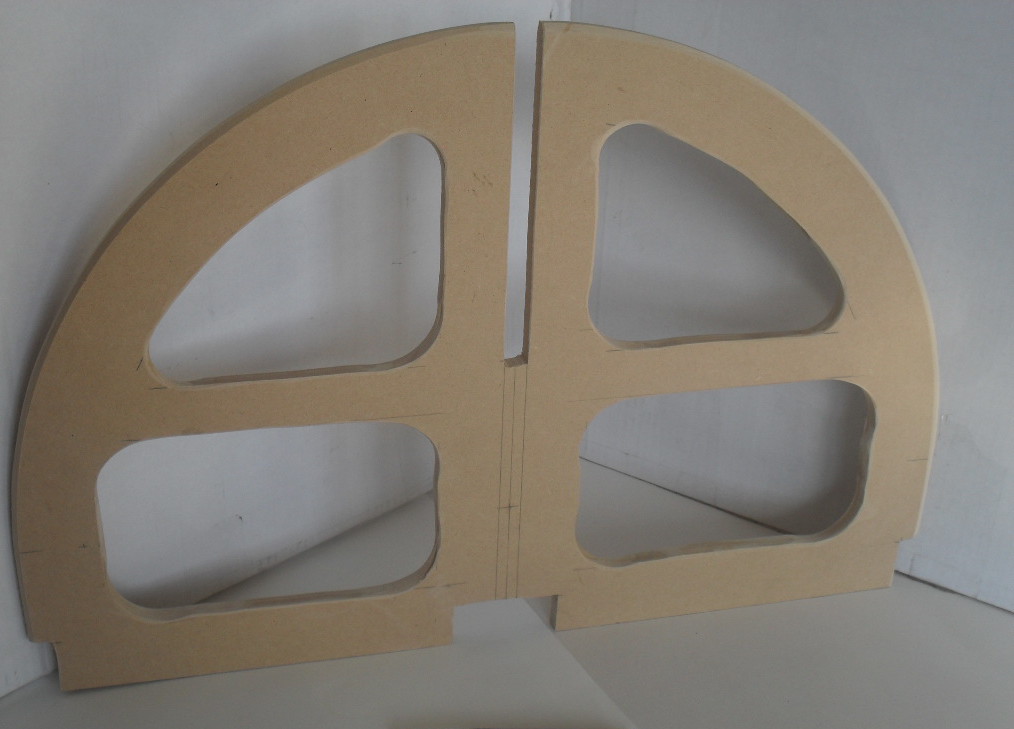

A few more progress pics of the buck. Plenty of dust and off-cuts were generated with this method. For me it is quite satisfying to stand back at the end of day , have a look and see something I just created.
Z.C.

Great work so far.
Stupid question of the day:
The engine, transmission, and driver are all inline in a pretty tight package. Where does the shifter for the transmission go?
Hi Justin, that is a GOOD question without an answer. As for now, the body shape is the overriding priority. All the " little" things eg. alternator, battery, shifter etc. will find a space where to be placed later on.

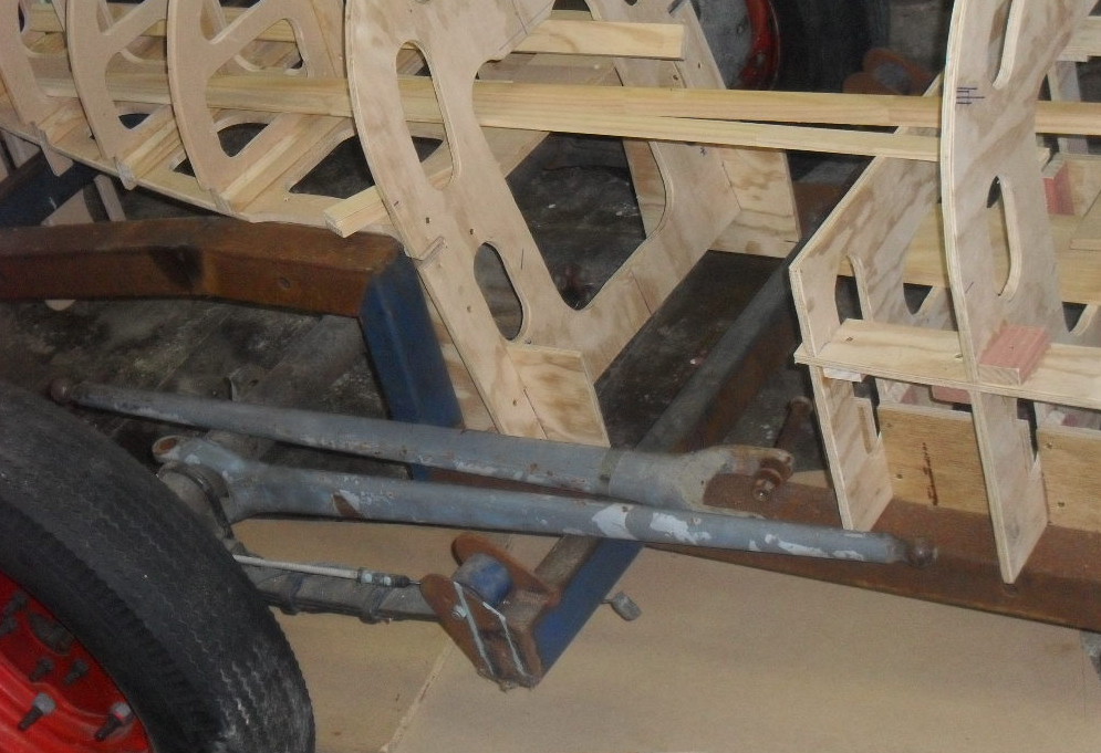

I agree with you Jim, those leaf springs have to go. The further this project advances the more I feel to get it nearer to " look-a-like". So please have a look and see what I got for diff control arms.
Z.C.

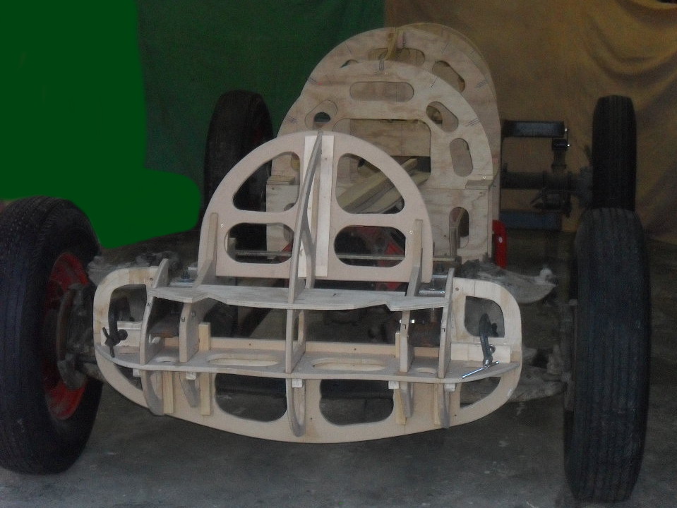

After a few hours behind the drafting board I had full scale templates that were transferred on to the wood. These were cut out and then glued and screwed to form the 3D nose buck. I wanted to show the progress although the nose buck is not completely finished yet.
Z.C.
Looks real good, you can see the shape of the body starting to come to life in the buck now, how long until alloy starts to grow on it?, Question about the rear suspension, how are the original cars set up ? are they an independent or live axle or did I read somewhere that they were a "Di Deon" set up, if so, the P6 Rover used a Di Deon rear end and I'm sure you could find one of them in a wrecking yard for very little money and you get inboard disc's and a diff that will handle SBC power as well. just a thought.
Cheers Leon
