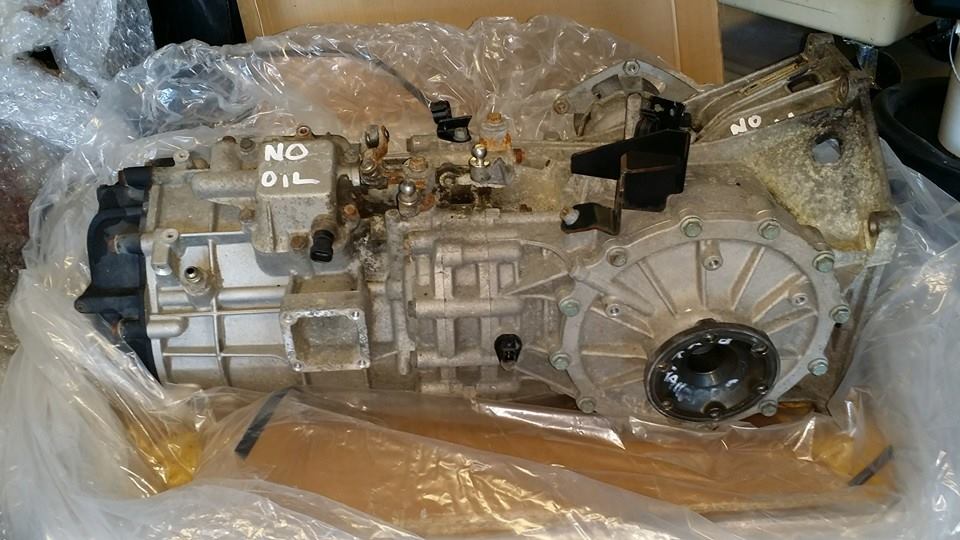

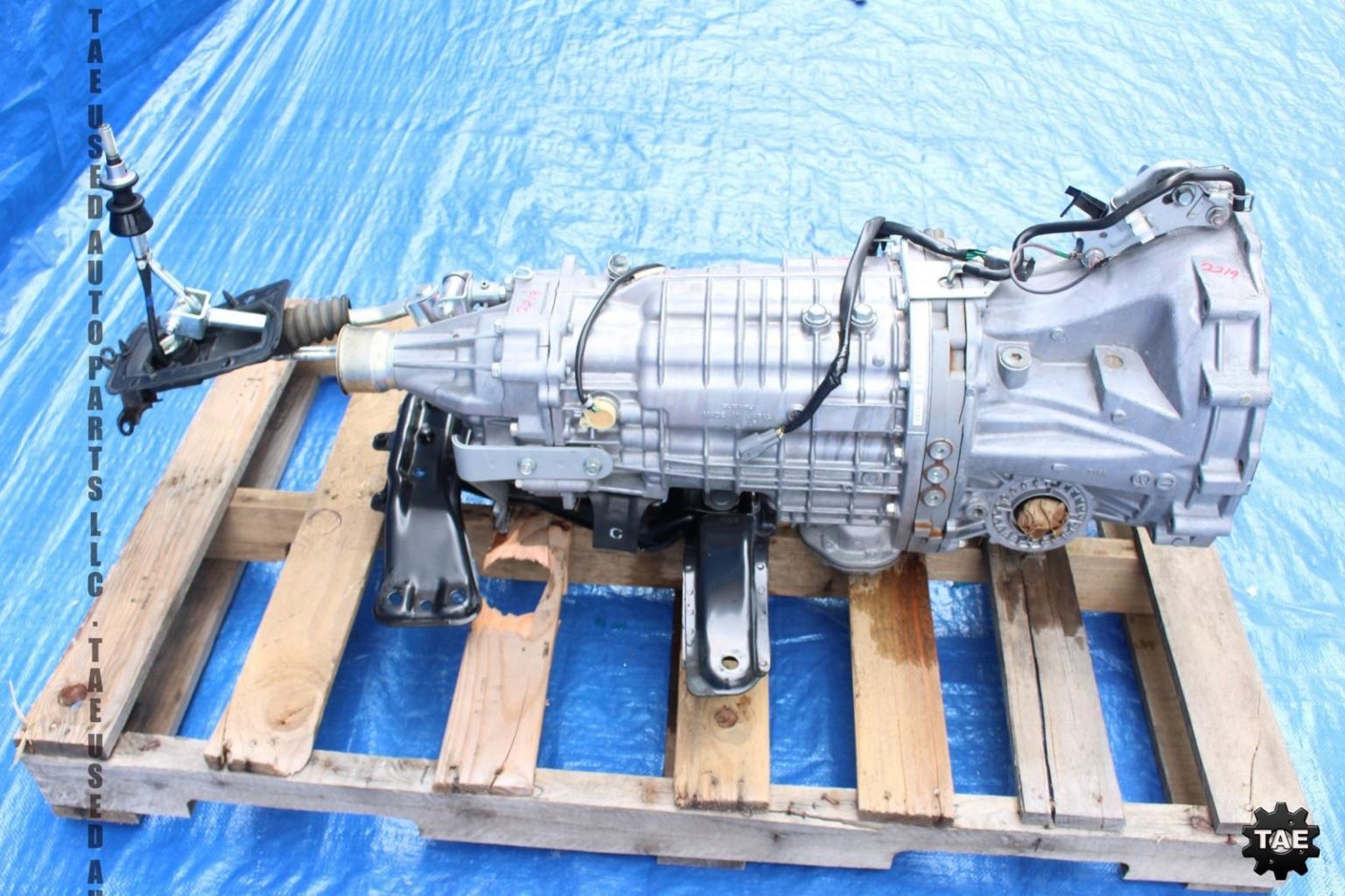

Looks a bit tall, but it looks shorter than a Graz
I think this is a 6MT:
Graziano:
It does seem to be shorter than the Graz, however, it can also be shortened.

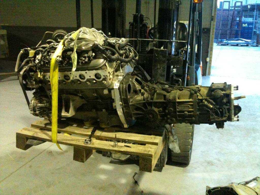

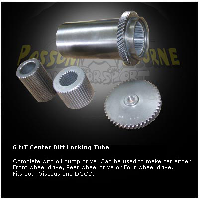

Not sure the exact dimensions, still trying to find that. Here are a couple pictures though.
