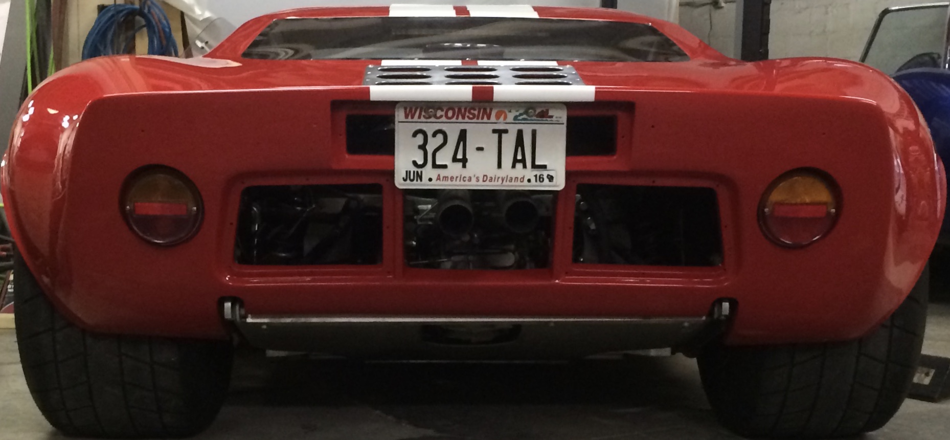

Awesome looking car Gary. Does your car have any rear quarter extensions? Or does the 295 tire fit in the stock fender well? That may be wide enough for me. But I'd have to see an ass end shot of the car to be sure.
And Walter, I'm glad to see you're a "Keeper of the Speed". ;)

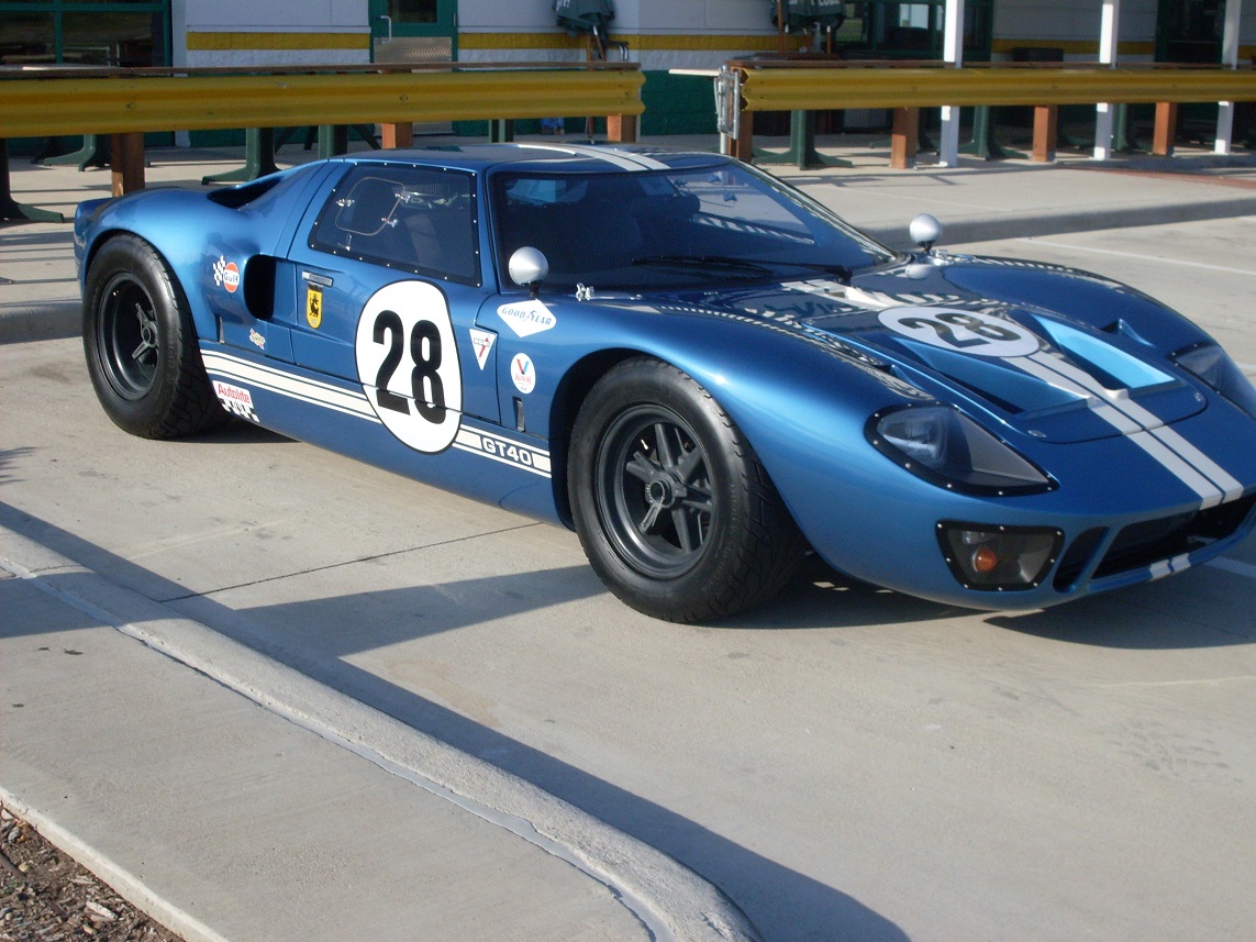

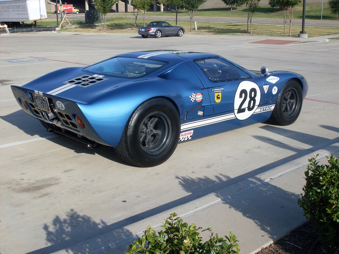

No extensions or flares on my CAV GT 40 as it is the Standard MK1 design. I had bigger Mickey Thompson Radials on it that slightly rubbed on the drivers side (big bumps) on the lower rear bottom Quarter. It really had the big tall tire look of the 60s but AVONs are much better tire.

At the time this video was taken my rear track is 71 3/4" (camber @ -1.1) and front track is 69 3/8" (camber @ -1.8). There is no tire rub at these settings.
How are you defining track? Your numbers are really "large".
Track is usually defined as the distance between wheel center-lines.
Hi Bob, I went with the outside measurements, sidewall to sidewall, for this RCR example. Since the OP was wondering about widest combinations within a +2 or +4 and what would fit without tire rub.

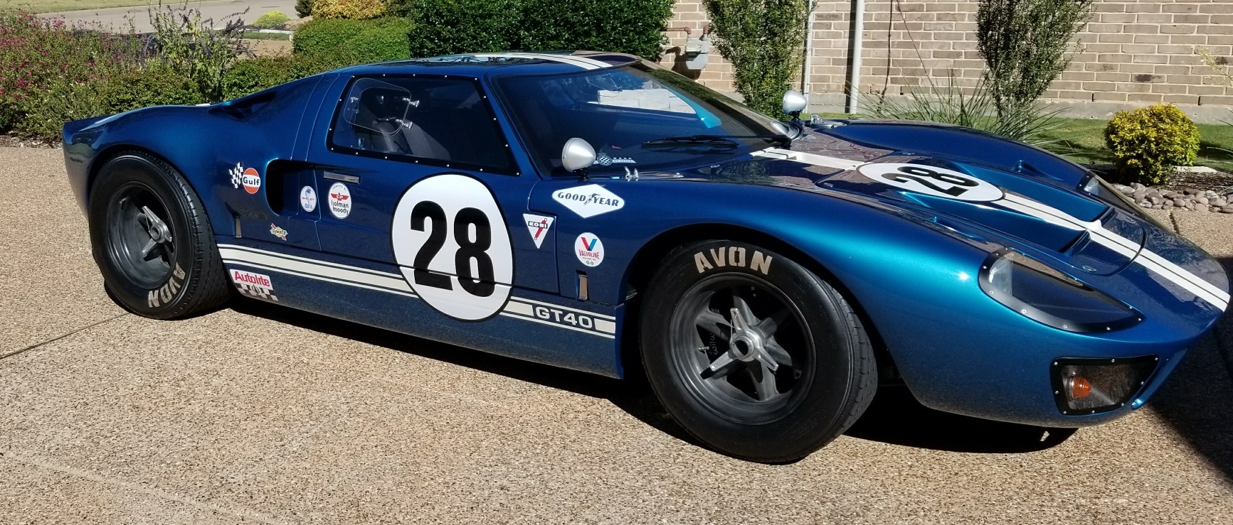

I have a CAV GT40 MKI Std body and I'm running AVONs and love them!
Frt: 225/60R/15
Rear: 295/50R/15

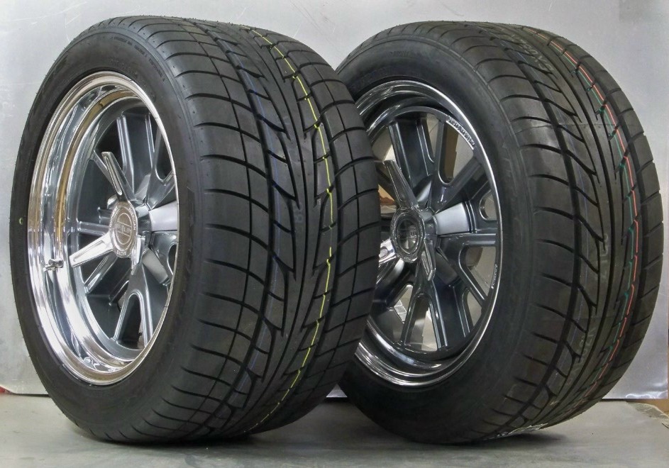

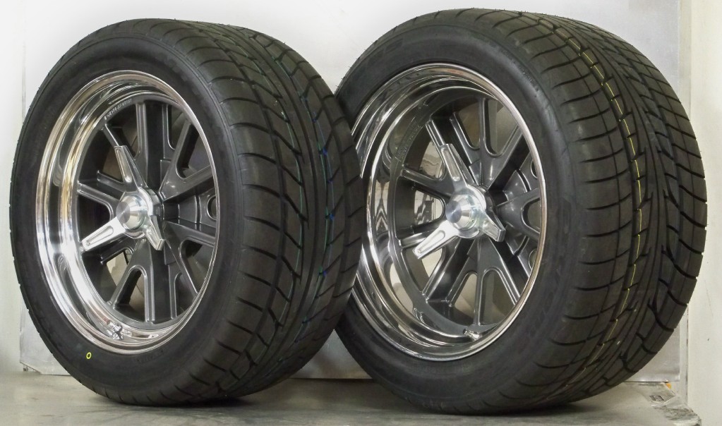

These are the VN427 Wheels I ordered from St George Tyres in Sydney.
Package Deal with Nitto Tyres. Deal is with 18", but when you place your order they could probably do 17" instead. 2 photo's one 17" and the other 18".
I had ordered 18x8 and 18x10, but unfortunately can't get the 18x10 anymore, only 18x9.5".
With the change in Rear Rim I had to re-think tyres and Backspacing.
Nitto Invo - Front 245/40ZR18, Rear 275/40ZR18.
