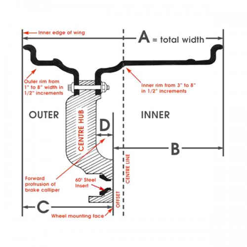

Tyre/wheel sizes all differ from what offset you will run, which uprights, suspension arms, which chassis etc. I have 295 avons on one MK2 which I have shortened the initial track to squeeze my tyres inside the arches. On my Mk1 with 2" arches I have same 295s, and it works ok with ally uprights on these Southern GTs. All 6 peg knock on one piece rims RBM/Halibrands. I would measure up everything and see what wheels will fit. For sure 4" Gulf arches, approx 80" across the arches will need some wider wheels, like 14" I'd recon. But it all depends on offset and uprights setup.
Link to measuring the rims/ offset etc
Alloy Wheel Technical - Image Wheels
Good luck

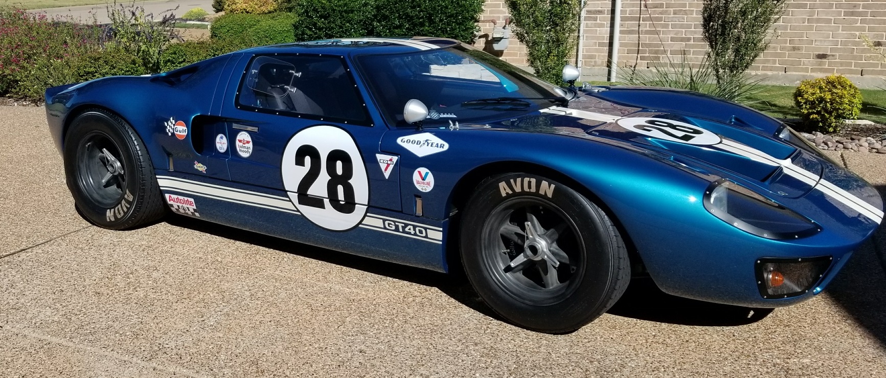

I have a CAV GT40 MKI Std body and I'm running AVONs and love them!
Frt: 225/60R/15
Rear: 295/50R/15
I was running Mickey Thompson Radials prior to the AVONs and had Goodyear Billboards on my last Cobra and neither can compare to these AVONs. They ride and handle outstanding and have great traction also. A lot of the GT40s vintage racing are using AVONs.

Awesome looking car Gary. Does your car have any rear quarter extensions? Or does the 295 tire fit in the stock fender well? That may be wide enough for me. But I'd have to see an ass end shot of the car to be sure.

FWIW, I don't see why you should cheap out on tires after investing all the time and money into a GT-40, only to lose control of the car or lock up wheels prematurely due to traction/instability issues. The Avons work great all around on the track and on the street.
A different perspective for you to help you decide. The following video was taken by MHNCO as he followed me down the highway last fall. The car has the +2" rear fender with the standard Avon CR6ZZ 295/50R-15 rear and 225/60R-15 fronts.
At the time this video was taken my rear track (measured sidewall to sidewall to simplify) is 71 3/4" (camber @ -1.1) and front track is 69 3/8" (camber @ -1.8). There is no tire rub at these settings.
