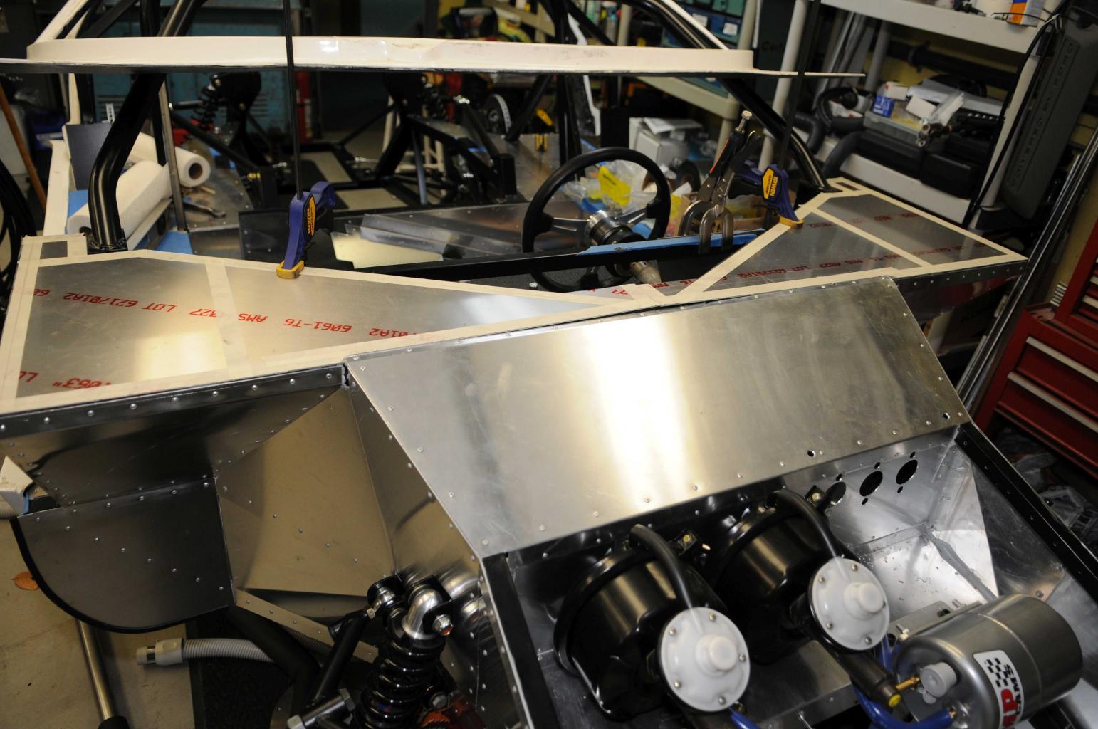

Chassis

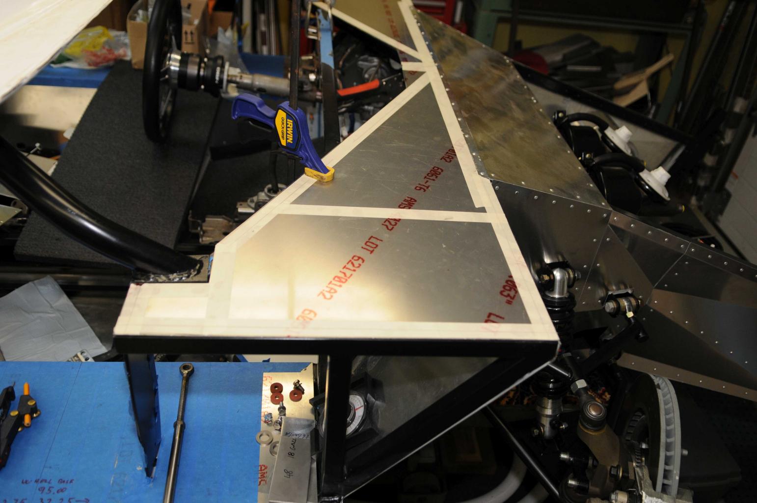

Back to paneling for a while. A quick job to cover the top front bulkhead. My Sikaflex from year ago dried completely, had to buy new tubes. It was a sealed tube and it was garbage. I guess, use it or loose it...

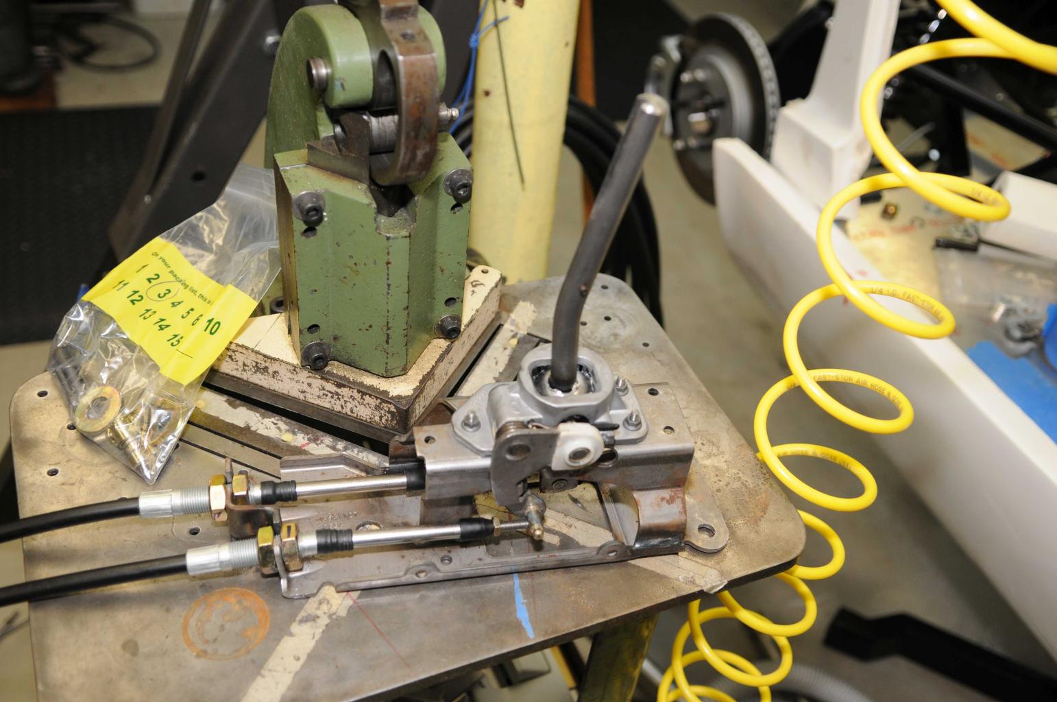

Shifter

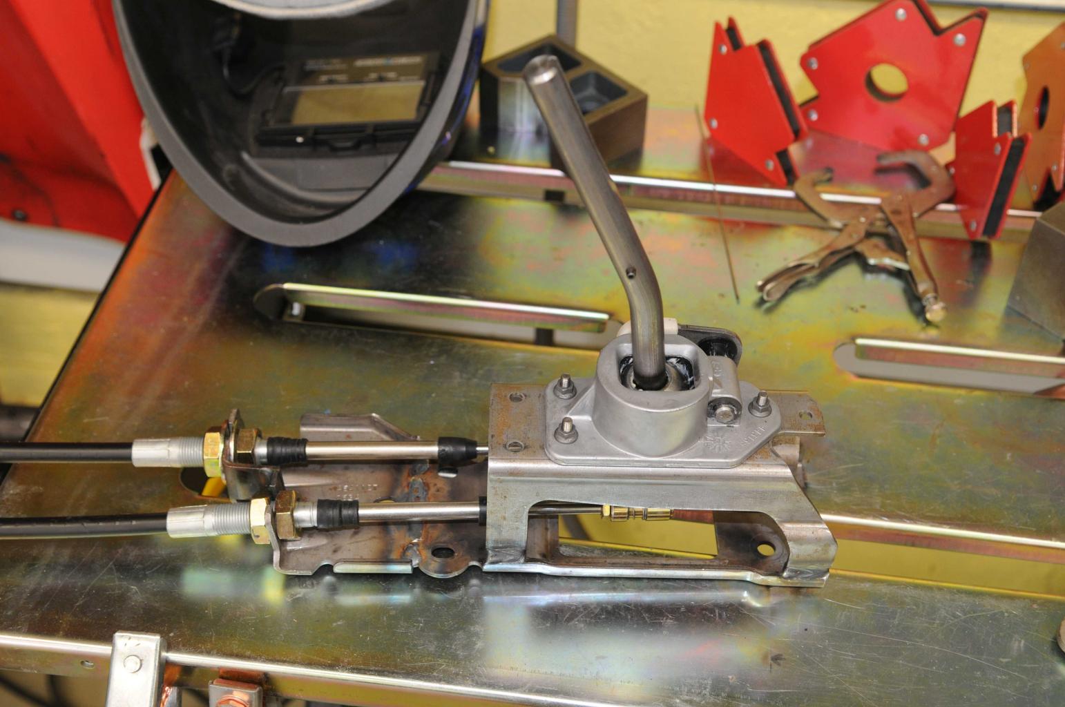

Looks like another possible donor for the shifter. It came from 99 Dodge Neon and can be found in every junk yard cheap. It looks very similar to Toyota that is hard to find in the US. It should require minimum modifications to get it to work. The forward/backward cable fits perfect. The left/right cable mount will have to be moved back an inch or so.

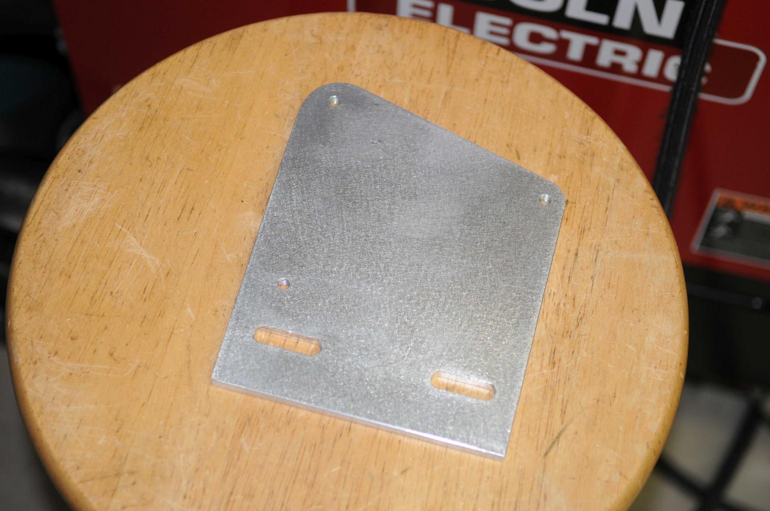

Throttle Pedal

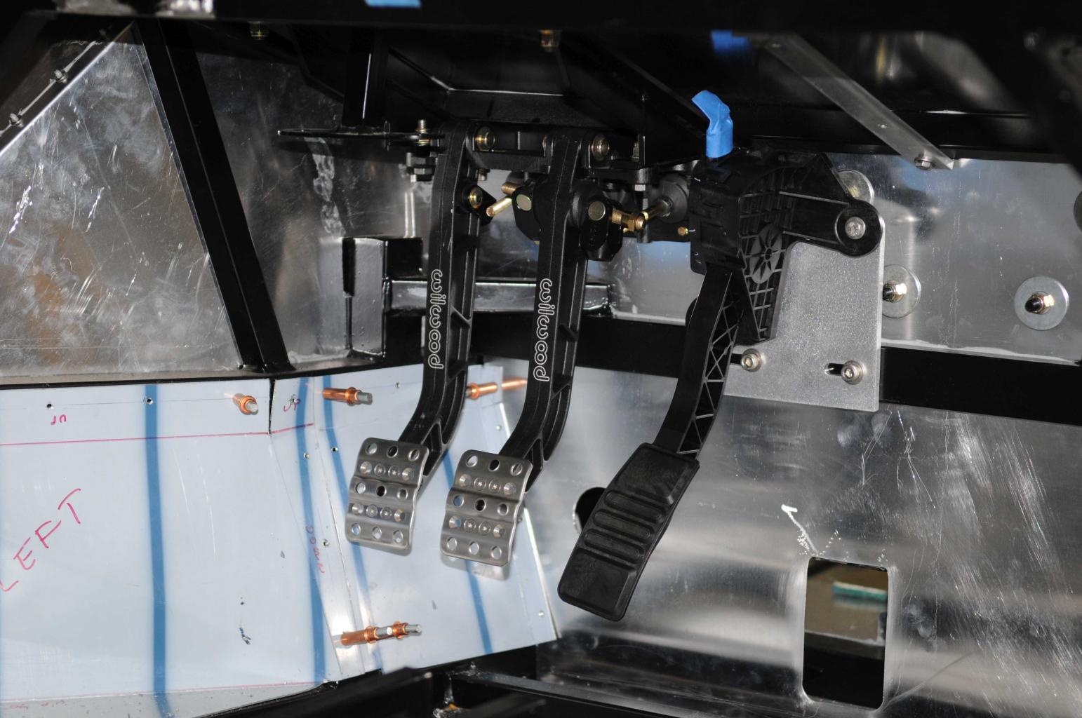

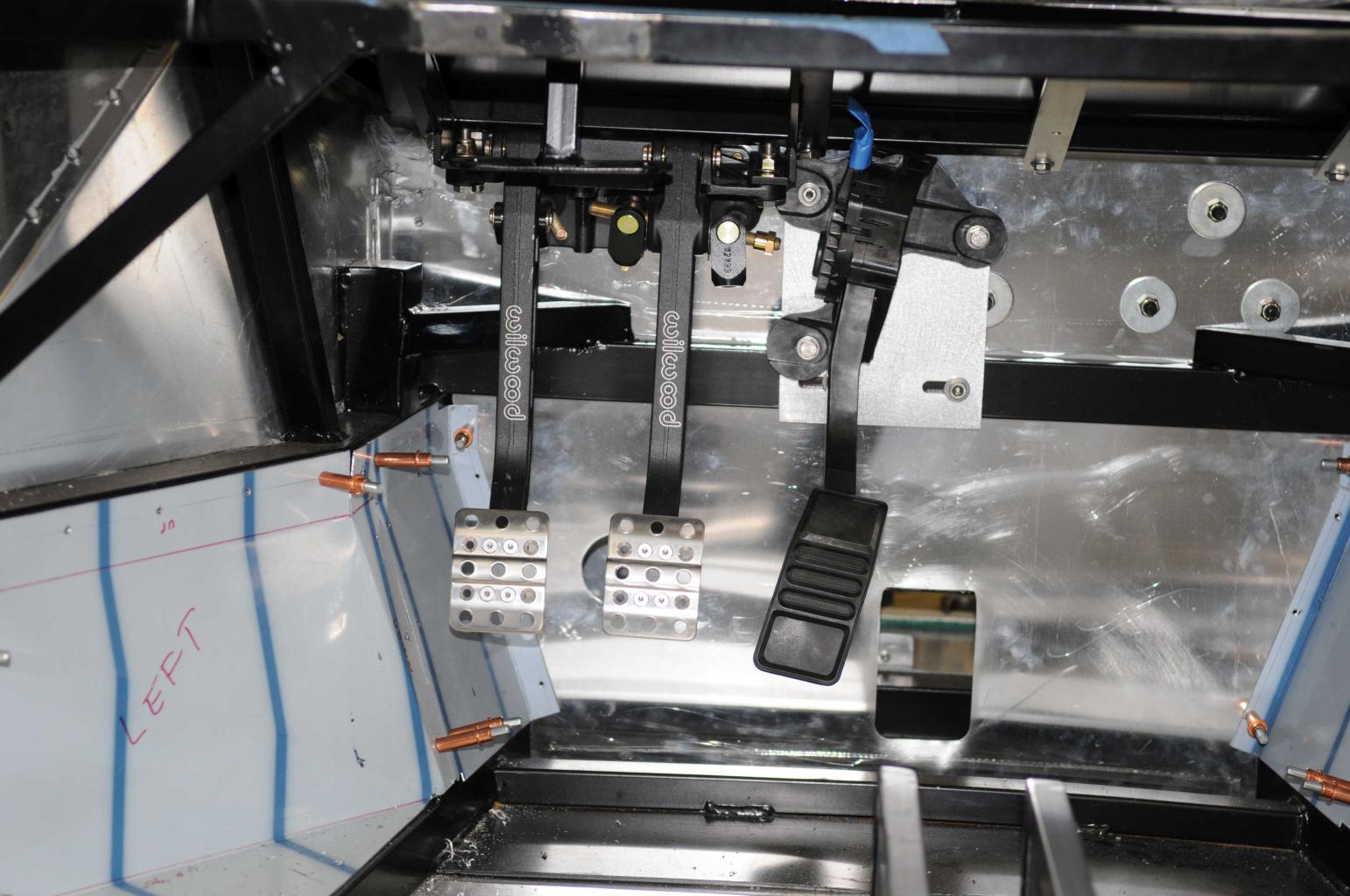

Fabricated mount for throttle pedal from a piece of 1/4 aluminum. Made it adjustable so I can get a better fit after all is done. Pedal is part of Ford Control Pack for Coyote engine.

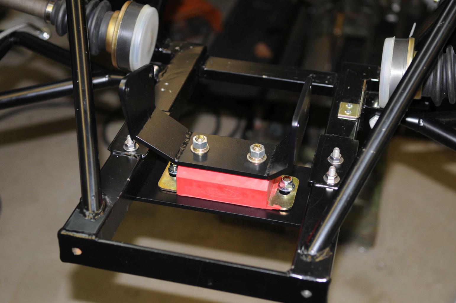

Engine Mounts
Quick update, got the engine and transaxle mounts powder coated and installed. Test fit the engine.

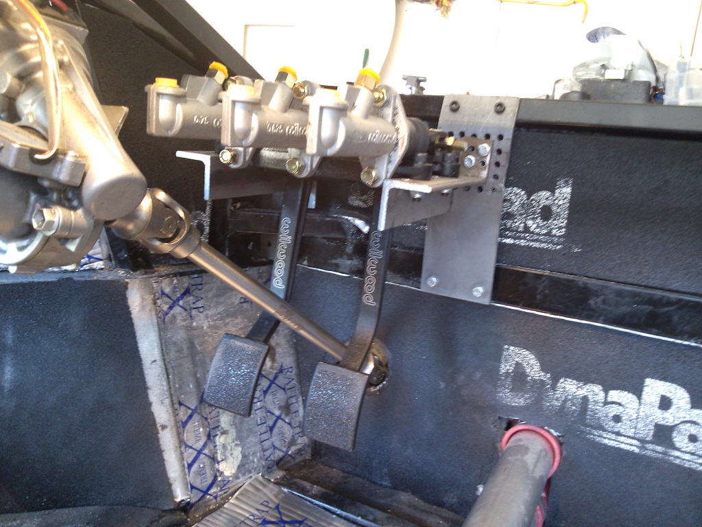

Throttle Pedal
Renato
You might want to sit in the car and put your feet on the pedals. When I first installed mine I noticed they sat too low where too much of my feet hit them. It looks like yours are OK but just wanting to make sure you don't have to rip it all apart later to lower them.
Renato
Good point Darrin, they do feel a bit low.
It shouldn't be a problem to move the foot plates higher, they are bolted on. The accelerator is one plastic piece. I guess it can be cut and re-bolted to gain height.
Not sure how annoying the pedal position will be. Do know that pedals are closer than I would like them to be.

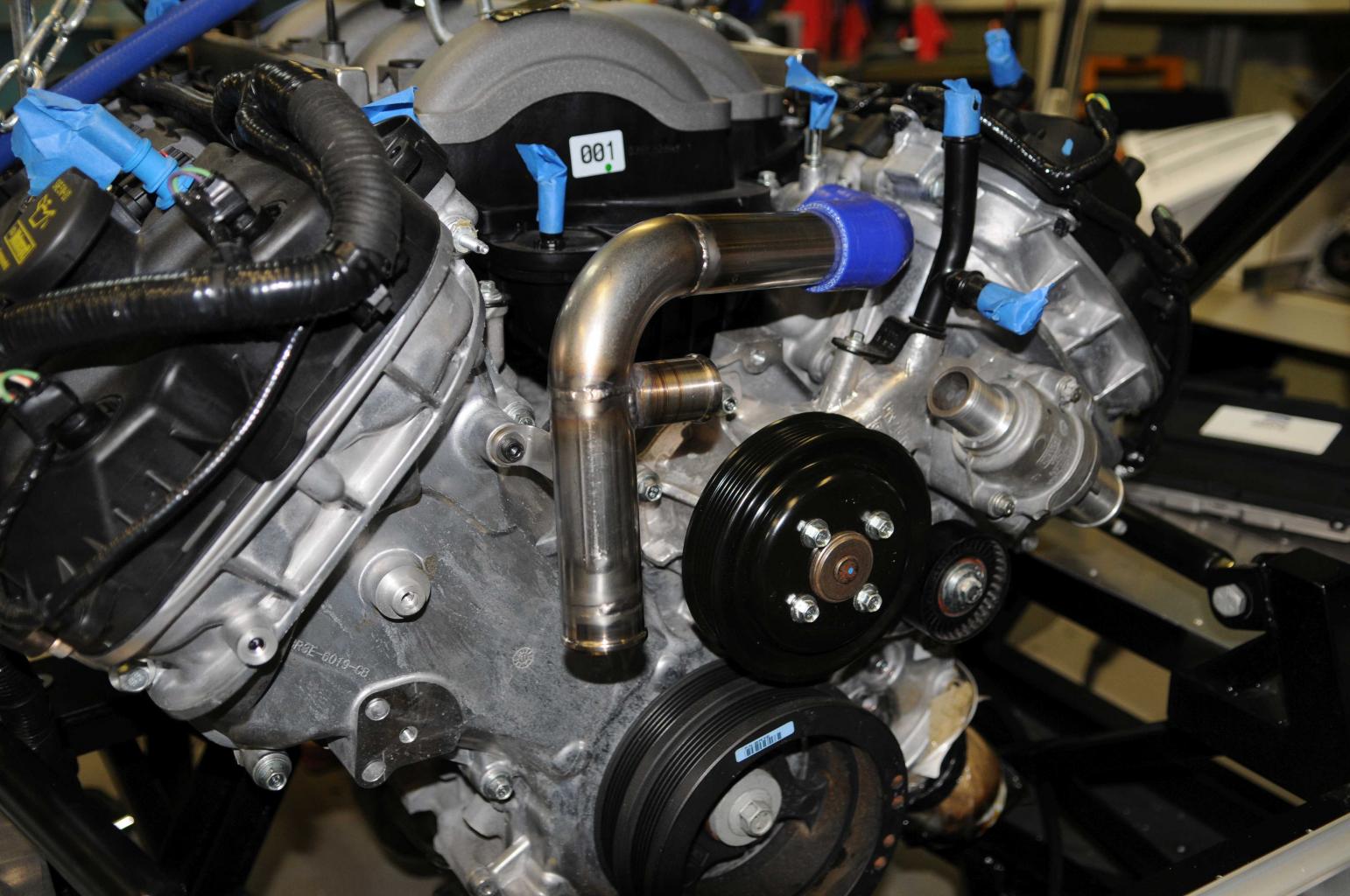

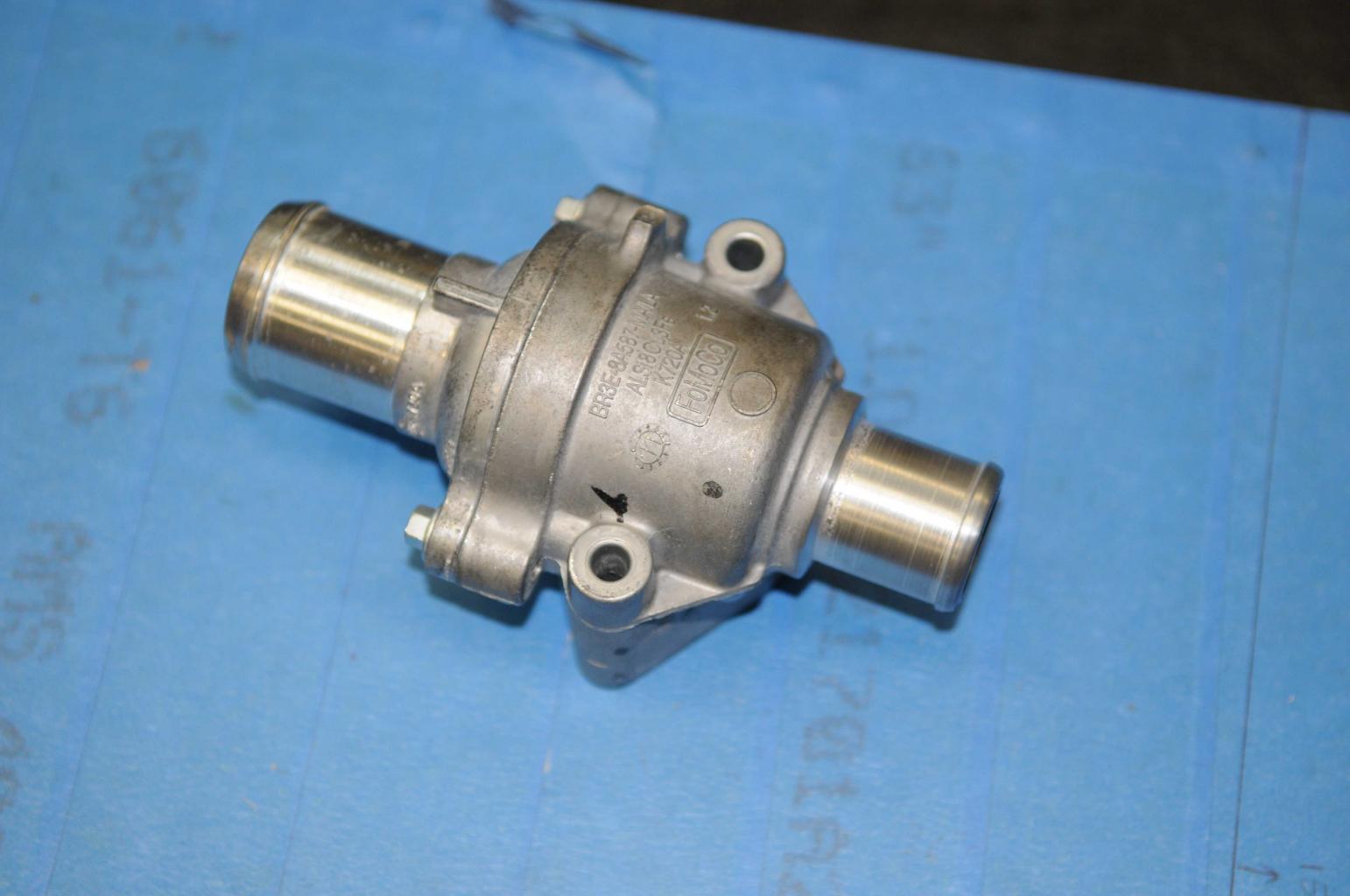

Engine
Long time since my last post and not much done. Lots of things happening around me that took priority. Trying to get back the momentum...

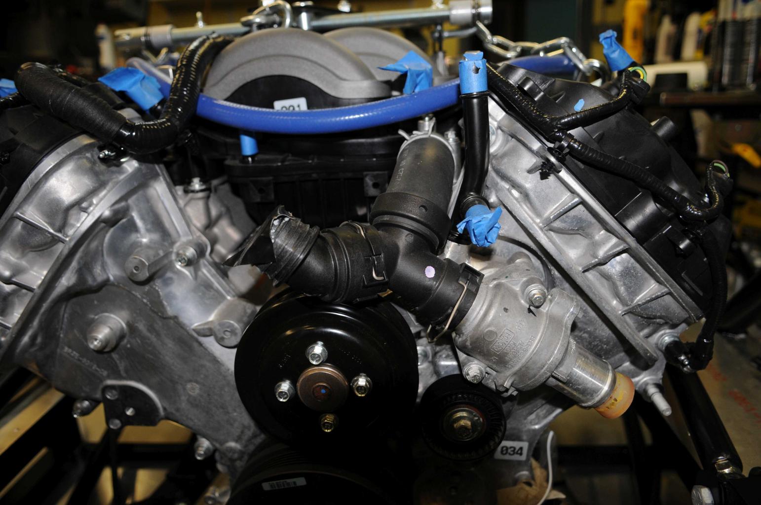

Machined the thermostat housing to accept a regular hose rather then special quick connect. Also fabricated a piece of pipe to make connections a bit easier and cleaner.

Thanks Rick!
Darrin, you might have to do the same to get better clearance. The original quick disconnect turns towards the firewall and is not practical to use.

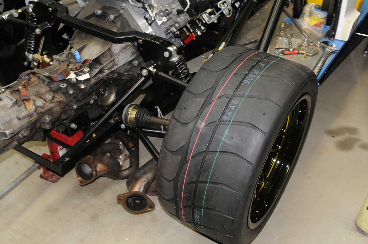

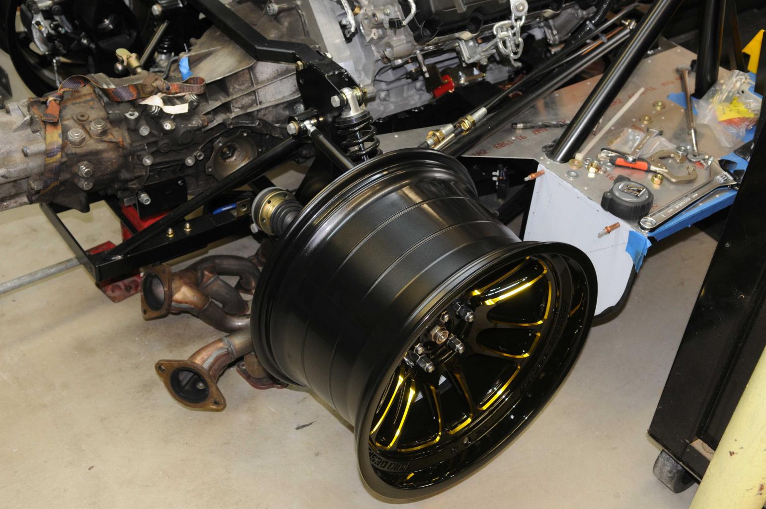

Wheels
Haven't spent much time on build do to family health problems. Things are getting better and hope to spend more time in the garage.

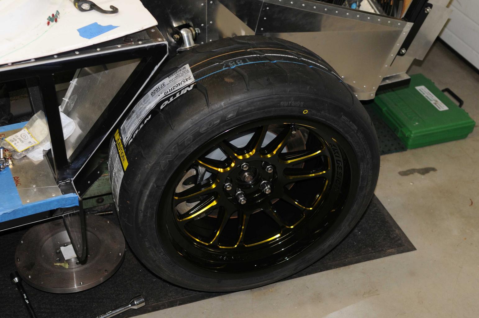

Wheels and tires arrived. After much thinking I went with 18 x 9.5 front and 18 x 11 in the back. Tires are Ditto NT01.

Wheels
Renato
Excellent choices Renato!
Renato
Thanks Larry!
Now I just have to figure out the rest of my paint scheme.
Kind of backwards... :laugh::laugh:

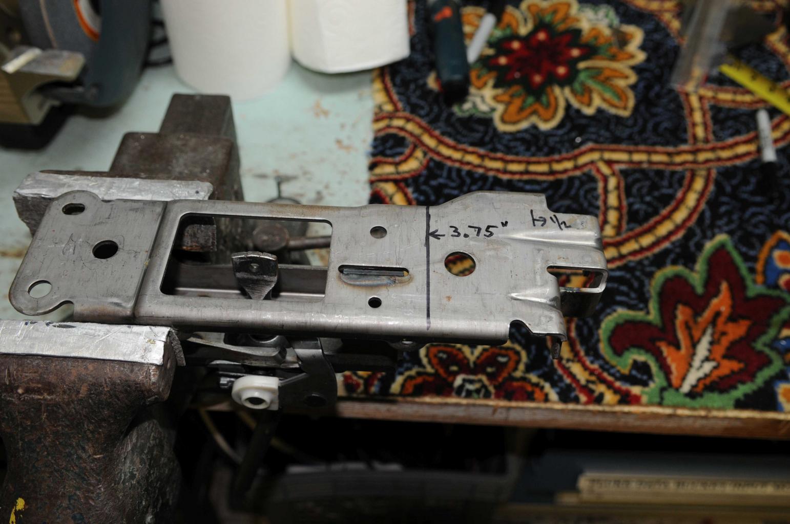

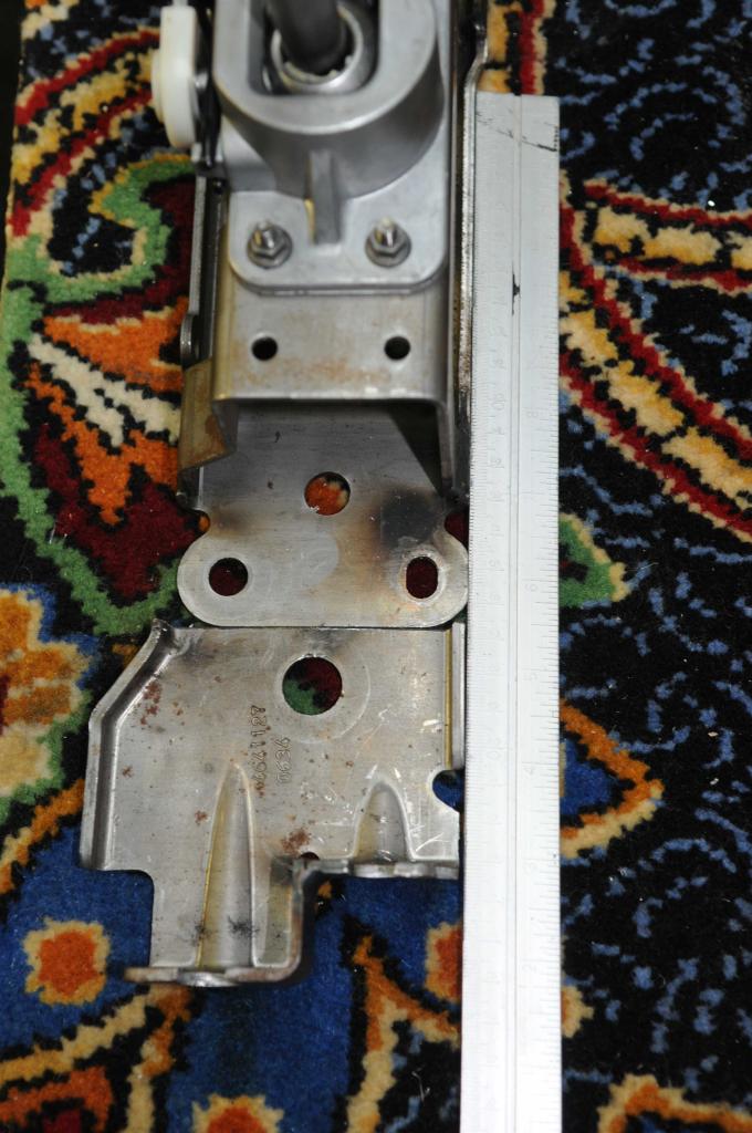

Shifter
Haven't done much lately. Just a few small updates.
Modified the shifter to work with 01E. Cut the base and welded it on the other side for proper linkage movement. Fits pretty good. It is getting crowded on the center tunnel.
Hope to start on the shift mechanism soon.
