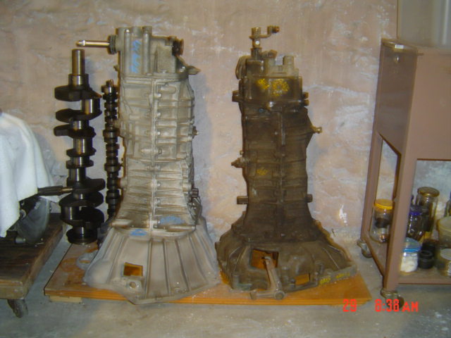

The UN1-13 was from the 21 turbo only. The standard Renault 21 sedan has the NG series gearbox, which is somewhat smaller and very less capable of handling any large horsepower.
