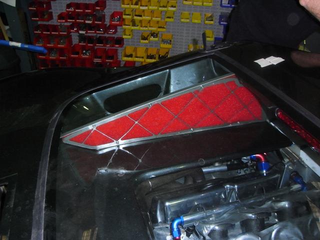

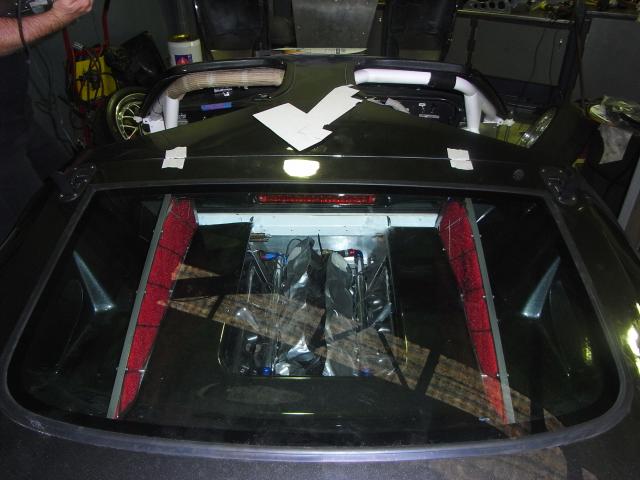

The attached photos show our solution to the air filtration on the car. Normally I take a backwards step when it comes to the engineering on the car however I can say without fear of conradiction this is all mine !

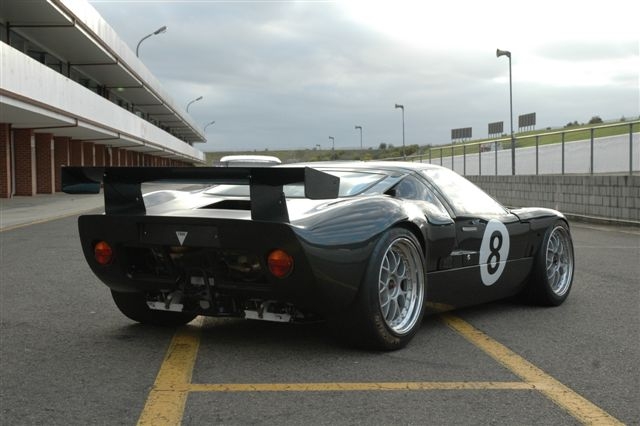

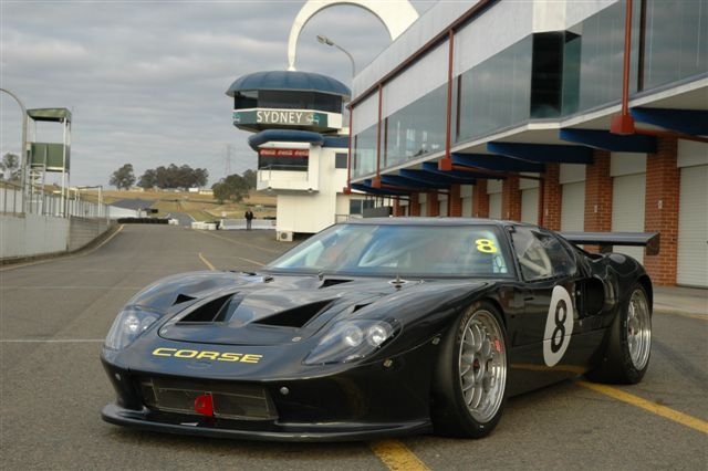

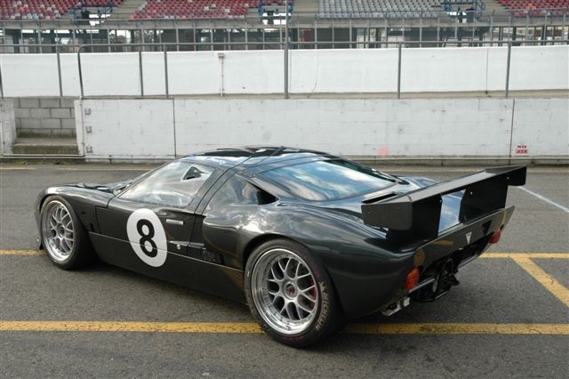

We finally made it to the track and had a successfull test day, no squeaks, no leaks, no rattles !

What were your impressions from the driver's seat Ian? Was the wait worth it, all that kind of stuff. Tell me that wings available and not worth a million dollars, please!
Looks magic
Ross
In no particular order:-
Driving position... better that expected, good visibility, can easily see turn in points, my neck will be stiff by tommorrow but should improve over time
Brakes.. Huge difference will need to adjust driving style quite significantly
Handling .. Huge difference .. HUGE difference...but I like it
Power steer.. spot on
Engine... despite being solid mount very smooth but way too quiet ! I have previously relied on exhaust note to pick engine revs for gear change.
Gear Box .... Holy moly, this is going to take some time.. I ended up steering with one hand and leaving the other hand on the gear shift. We need to get the gear shift way closer to the steering wheel and alter the ratio. Hewland do not use any centering detent which feels a bit odd but should get better over time.
Gear ratios are not quite as nice as the Holinger but the torque available more than covers any shortcomings
Cooling system....Spot on, runs at @85deg, we have no radiator fan but can warm the car up on stands for 20mins without any problems.
Alarm lights, shift lights and Motec dash .... needs sorting, way too much information to digest with everything else going on !
Tyres (We had a mixed bag of unknown vintage)
Temps.... Rears came up quite quickly as you would expect, fronts needed 2 laps more than the rear before they felt OK,
General impression,
First session 5 tenths
First session of 15 mins was used to confirm engine, radiator, gearbox temps...all good
Check nothing rubbing...all good
Check Power steer & ratio ...all good
Bed in new pads... probably did not acheive full heat penetration
Check front to rear balance... unknown
General feel.... not going fast enough to pass meaningfull comment
Second session
7 Tenths
Bring tyres up to temp... better
Give the barkes a work out.. 3 rd lap braked really hard into turn 2 and locked front passenger ... flat spot of some significance but still driveable.
Rev the engine out to limiter & check temperatures... all OK
Push a little harder into some of the "safe corners"
Turn 9 (My favourite) shows signs of understeer which you could drive around with the throttle but will need attention
Turn 12 Nicely progressive oversteer that could easily be controlled with the throttle
Generally, as the tyres came up to temp and my confidence in their condition increased the car gradually came alive. The front passenger tyre meant hard braking was not really on the cards but turn in was really good, mid corner was really good, exit on some corners will need an alteration to my driving style, some fresh tyres will also help.
We had to curtail the last session as the front tyre was locking everytime the brakes were applied and the thumping noise coming down the straight was louder than the exhaust noise.
lap times were really encouraging given the circumstances.
Iain
Impressive what two wings and modern wheels can do to the cars appearance.
That thing doesn´t look like a 60´s racecar anymore. It looks slick and modern.
Just another proof of the timeless beauty of the GT 40 design.
