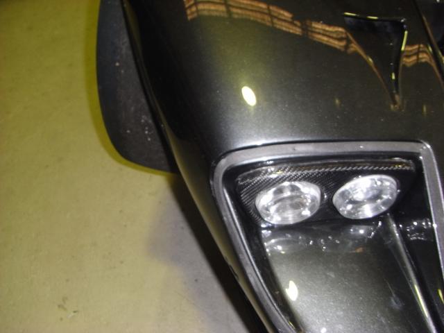

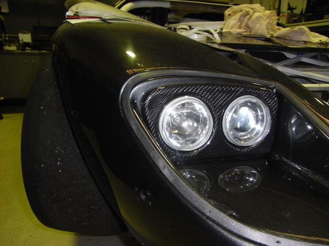

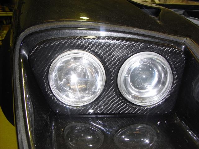

Bling,
A couple of shots of the headlamp set up

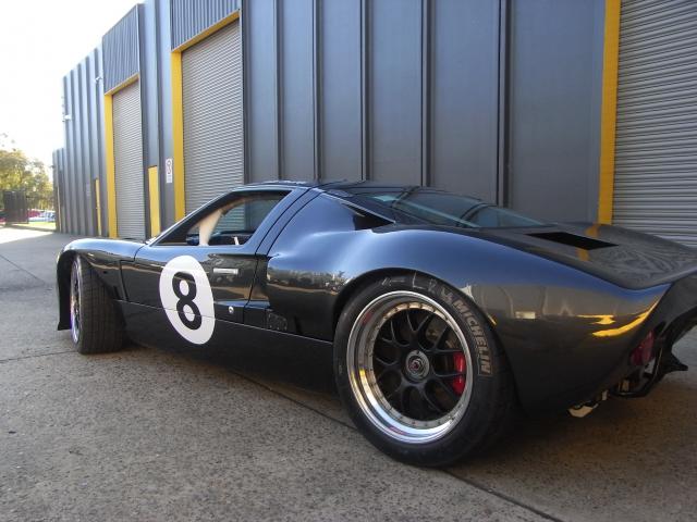

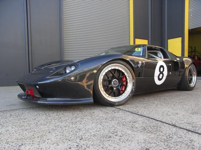

Thanks for that Ross, After 3 years we finally got it down on the deck !! They are very very low are'nt they ?

This car would have to one of toughest looking GT40s I've seen.
Great work and well worth the 3 year wait.
Hoping we'll see some vids of this Beast in action?
Wish I had a GT40.....:cry:
