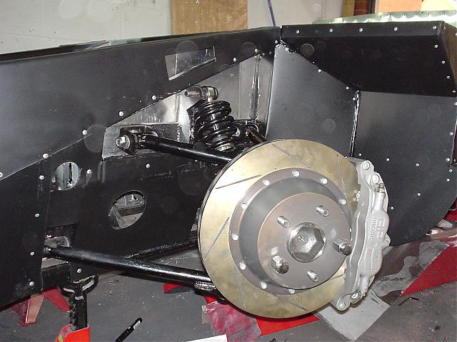

Iain,
Not quite :) they are my front brakes as I originally got them. They look a little more like the below now.

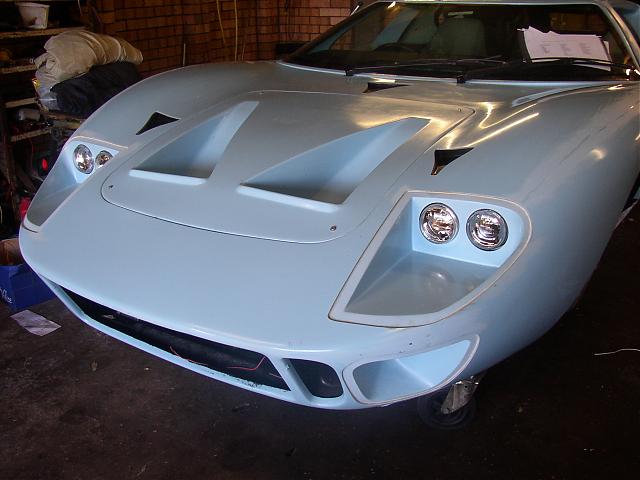

Iain attached are a couple of shots of my DRB with the Hella lamps.
Darrell
DRB#46

Iain, I have the car ready for inspection it is booked in for early February.Everything is working fine. A/C,engine temp,wheel alignment, speedo calibrated etc, it drives really well and very Quite. LS1 feels great and fitted easily to the DRB.
I am getting it registered before painting as I wish to to most of the body prep between drives myself before giving to the paint shop.
Darrell

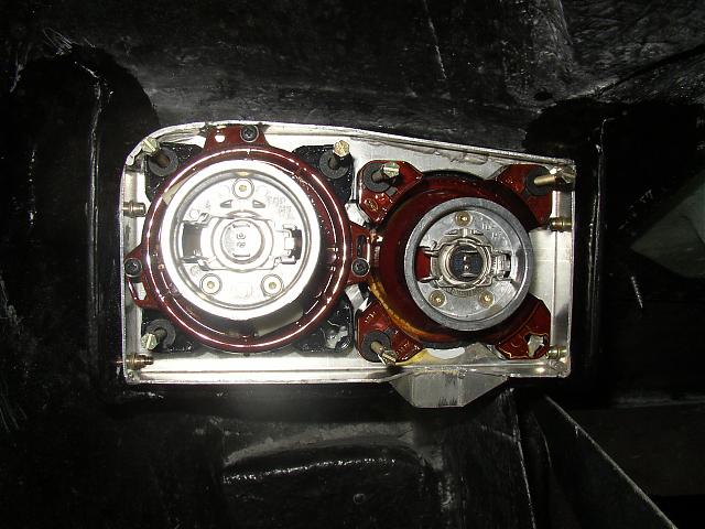

darrell did you make the mounting bracket yourself and i see you have mounted the rivet nuts in the sides do they not come through the bodywork on the outside edges
chris
Chris I make the mounts up with 1.6mm alloy plate to fit the adjusters etc of the lamps, I had a friend of mine glass in two panels either side of them with 5mm bolts going through the panel than some washers to align the lamps in the holes in the front clip. I do have the prototype(stuff up) laying around some wear if you would like a clearer pic.
