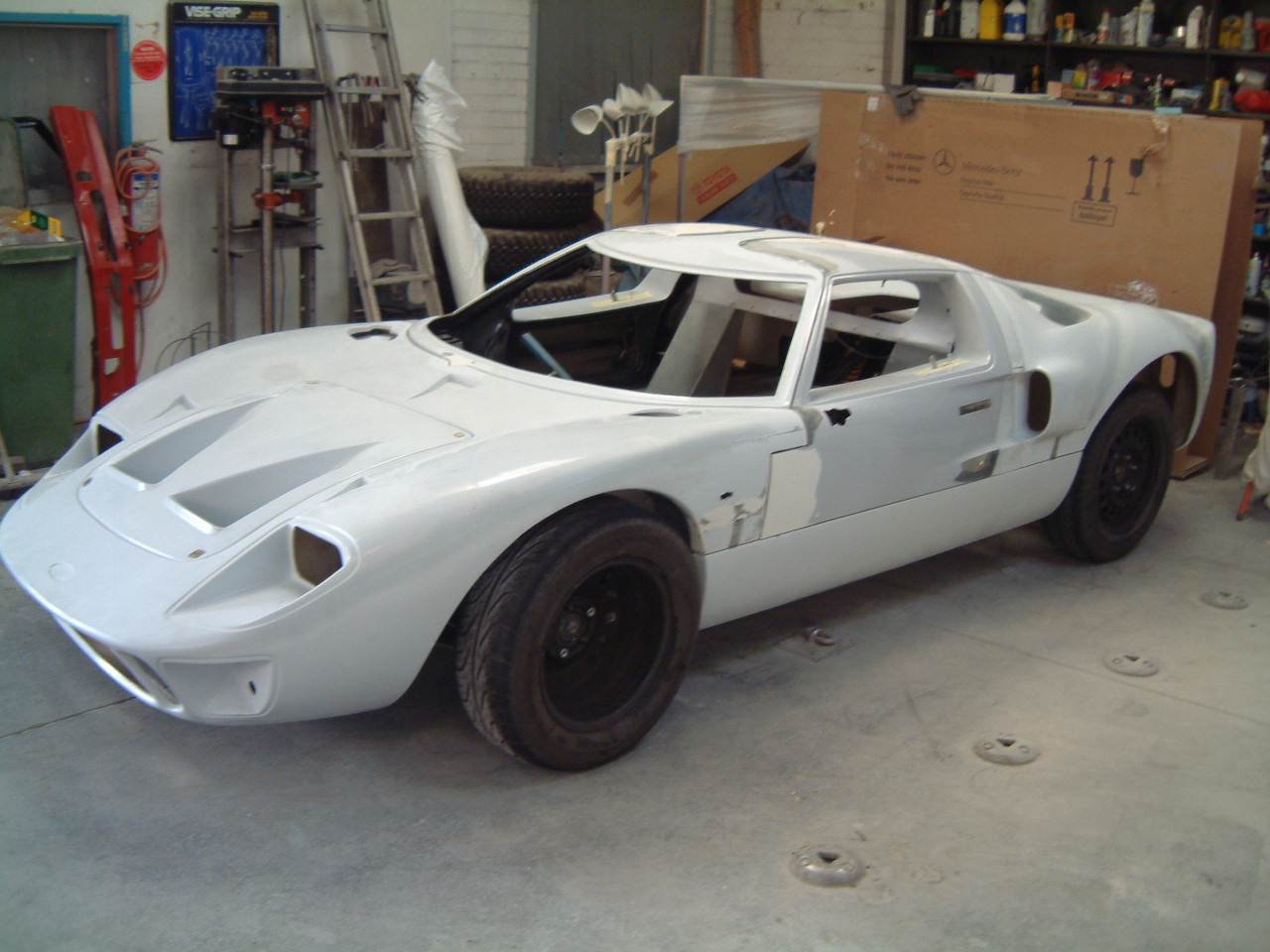

My car has now been fully primed (except for the nostril - I think), with the sill panels and mirrors already painted. Today's weather was pretty good, so everything has been baking in the sun and things look on track for colour at the end of this week.
I'll put a few more photos on here over the next couple of days, showing the next phase of my build (starting about a year ago) right through the paint process. Hopefully I'll be up to date with photos in time for the latest shots of the colour on the car by the end of the week.

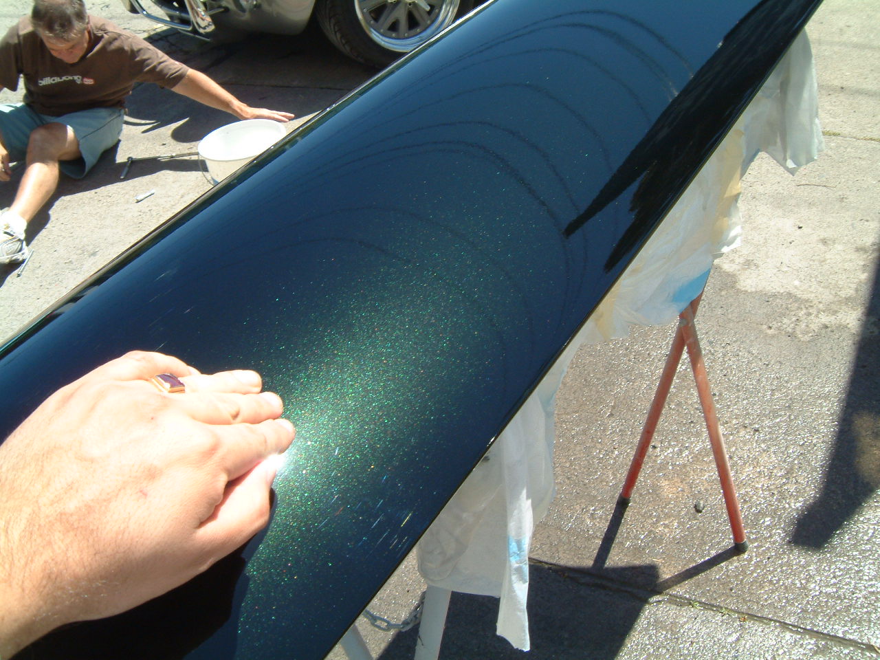

The pics of the colour came out great Bill but I guess its one of those colours that looks best in real life. Andrew, the colour you chose is great too. One of the better yellows that I have seen, and I am saying that after having seen it in life too (at Allan's). Pictures just do some colours jutice /ubbthreads/images/graemlins/grin.gif

Chris, you are right about the colour looking better in real life than in photos. I am sure this has been said before on the forum. Andrew's colour in particular is miles better in person than in photos.
I'll put one more colour shot up before giong back to my build progress photos.

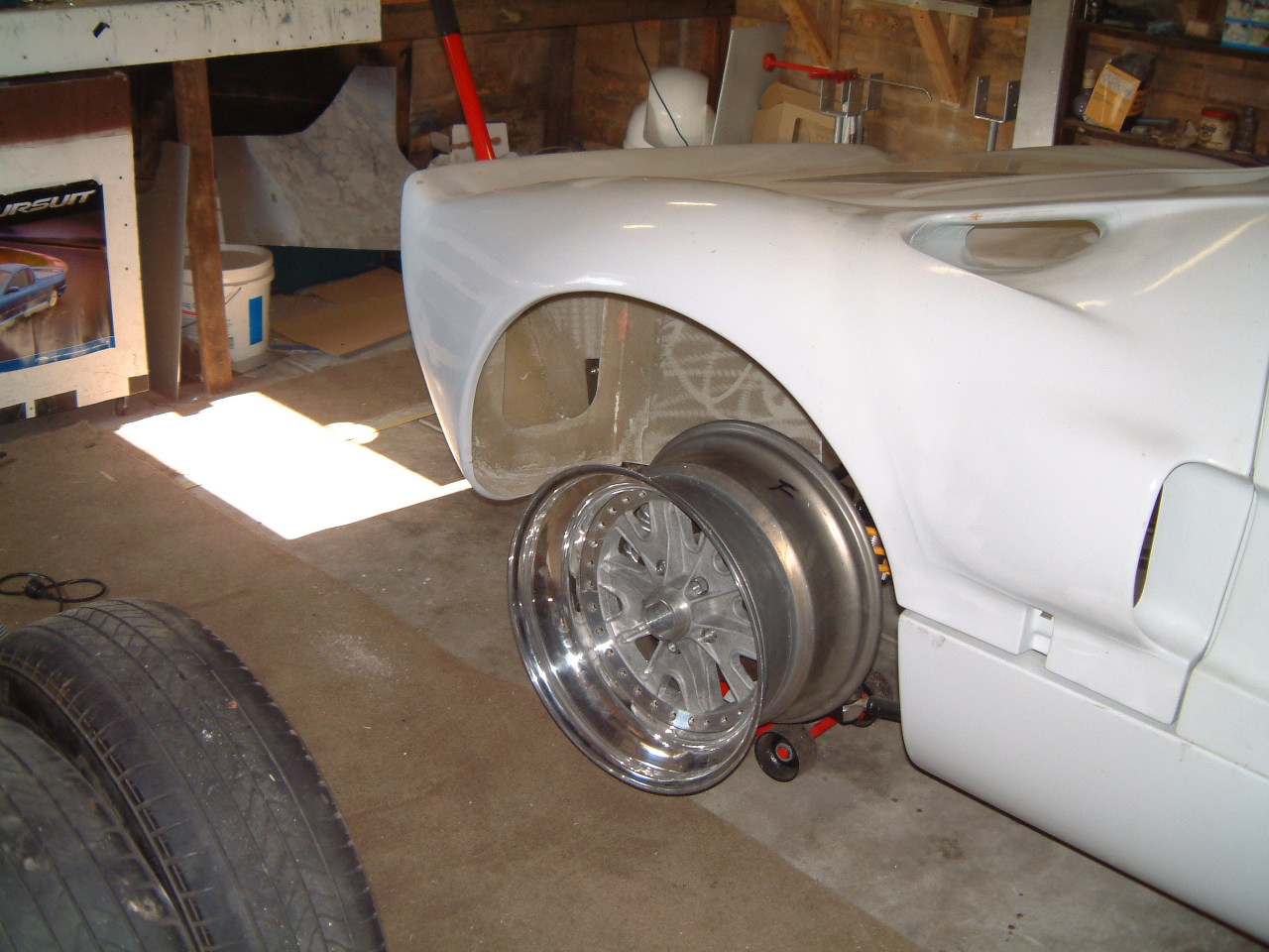

Well before I was having my sills painted, I was trying to decide if I should get Halibrands or BRMS. A friend had some Cobra Halibrands so I put them on to see how they looked.

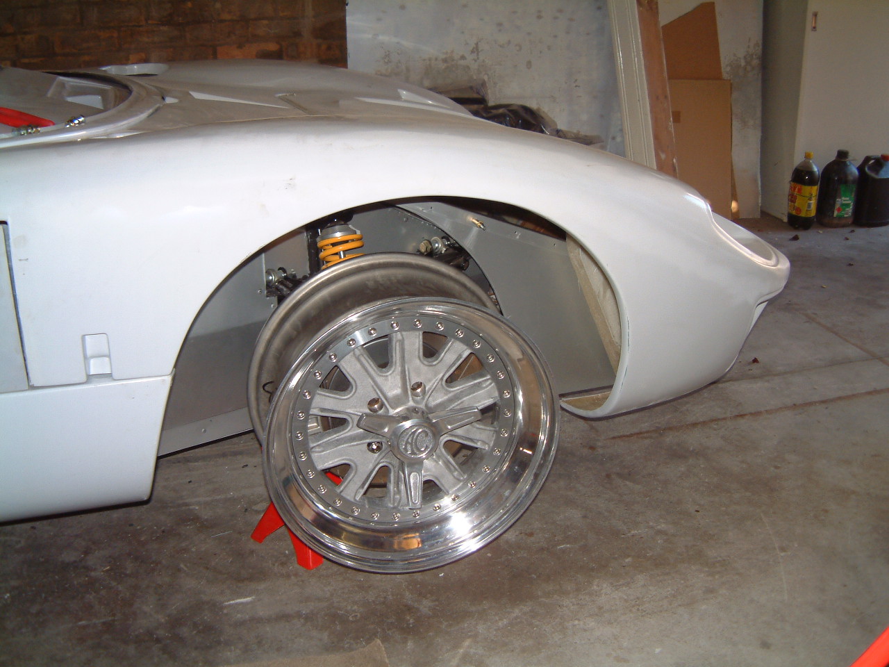

This is an overhead shot and shows just how good the panel fit was with the fiberglass unmolested (ie. no cutting or filling - other than the spider front apron to fit the clip in).
It was around this time however that I decided to get RF to help me with the body fit. I was travelling overseas for a month and wanted the car to progress...

We try not to use the C word here /ubbthreads/images/graemlins/tongue.gif
Yes it is a Cobra (and quite a beautiful one at that). That's Lee the owner of "Daisy" sitting on the ground - obviously he enjoys the lower seating position of the 40...
I forgot to mention in the last series of shots that I didn't particularly like the 3 piece rims, although they make the car look good even in such an unfinished state. To get the look I want, I need to use BRMs so hopefully Robert can bring me back some of those 17s he showed us in one of his South African posts.....
Maybe he's paying his respects to the GT40 by praying in front of it /ubbthreads/images/graemlins/flehan.gif

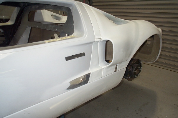

I sent the car to RF while I was away lazing on Mediteranian beaches for a month so that the doors & sills could be fitted properly - including latches, locks etc.
Great work again by RF, here are some shots:-

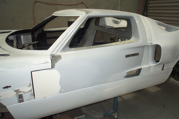

and this is how it looked when it arrived at Allan's paintshop, prior to any paint work being done.
