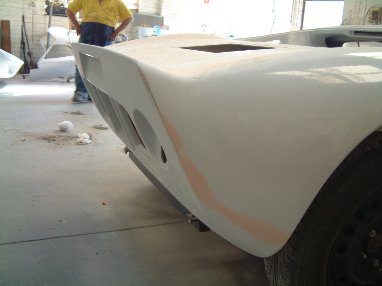

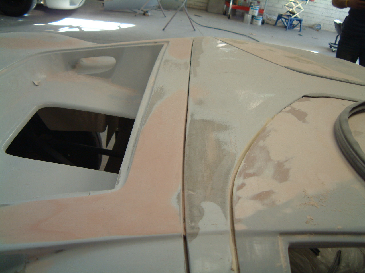

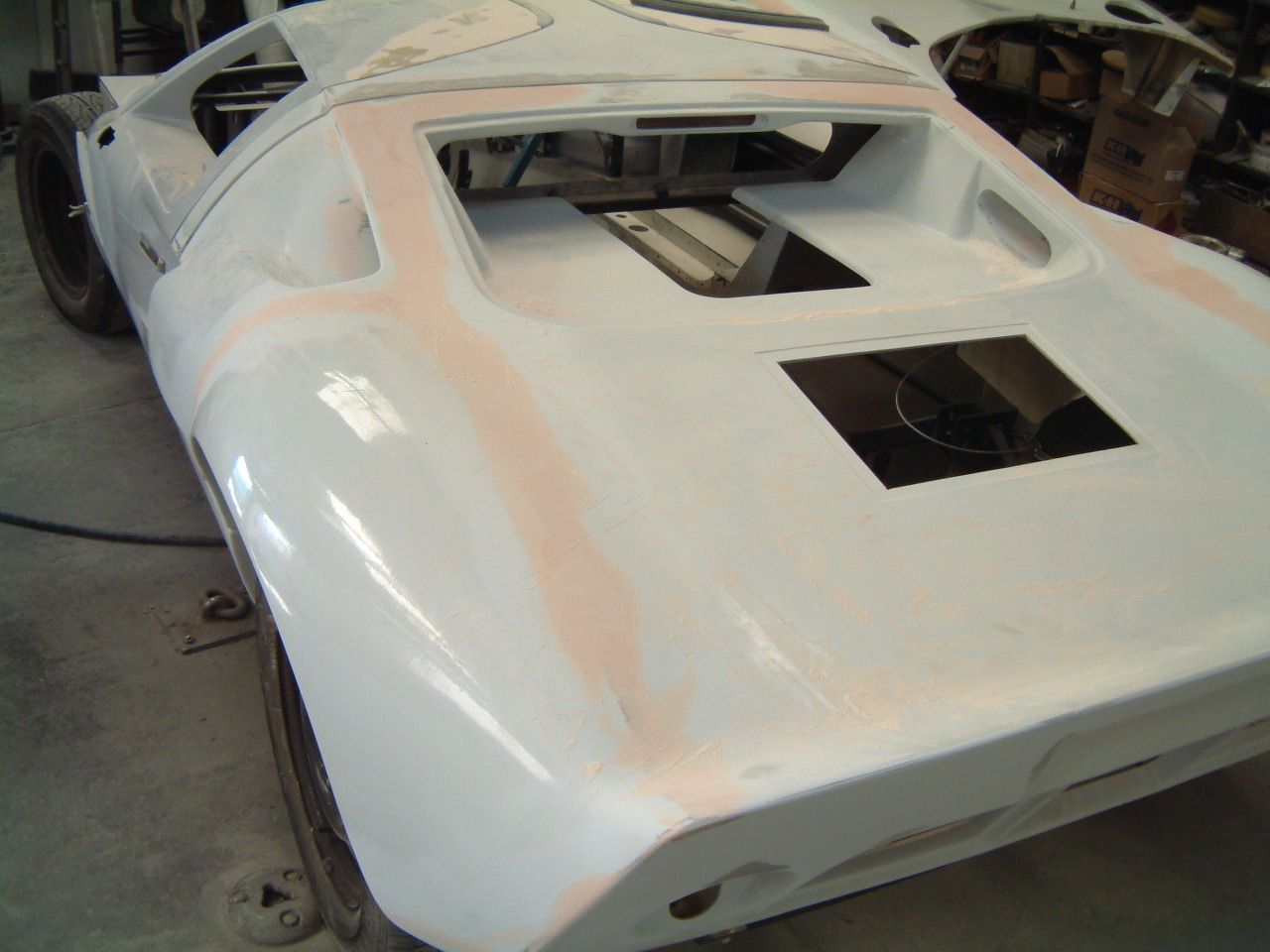

I'll keep the build progressing by showing you some photos of stage 1 of any good paint job / body prep - getting rid of the high stress seams.

I call this the ugly stage. Visually the body has crap all over it and you almost feel like it has gone back a step. The truth is, this is a vital step in getting the finished product to look straight.

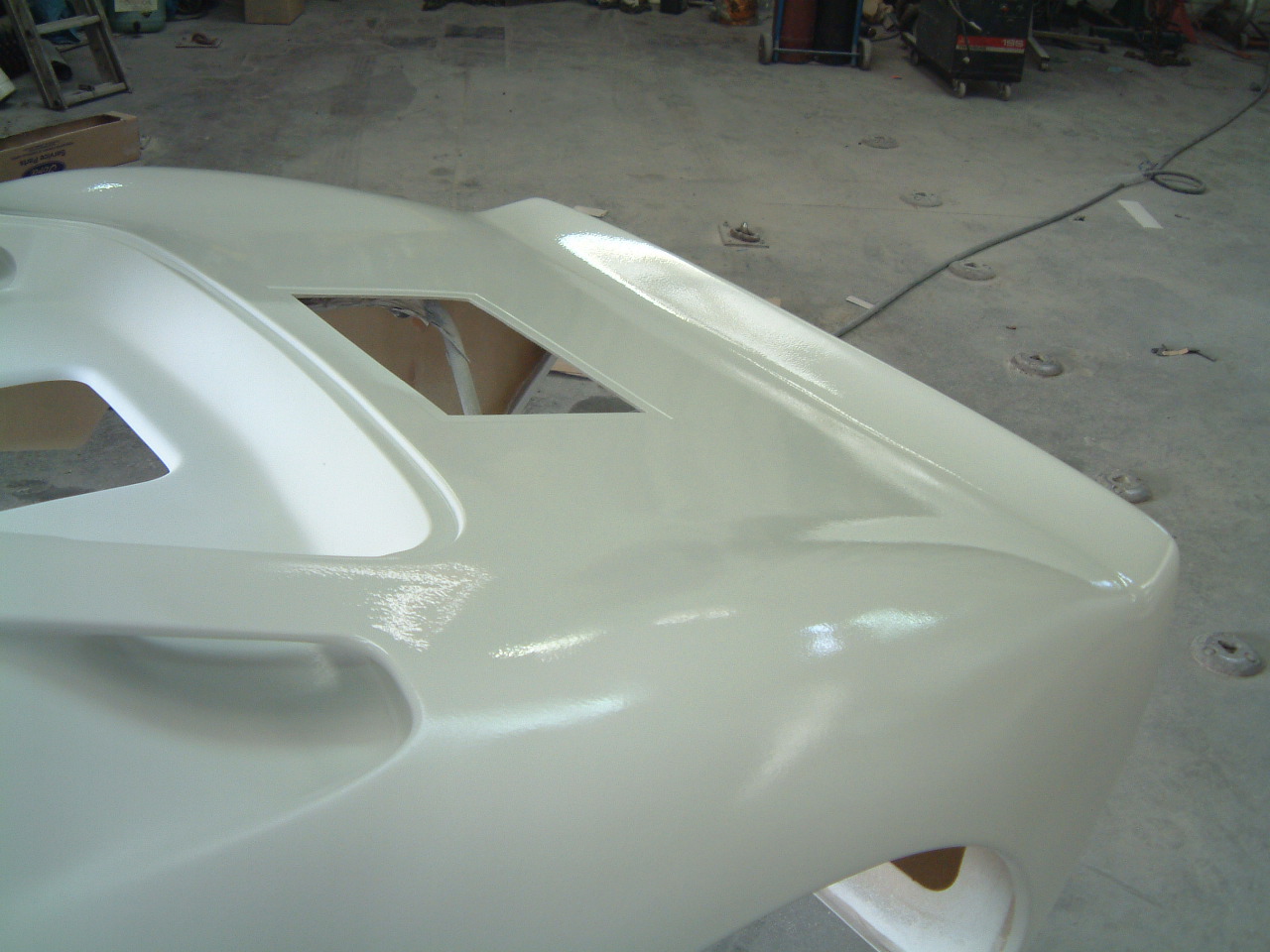

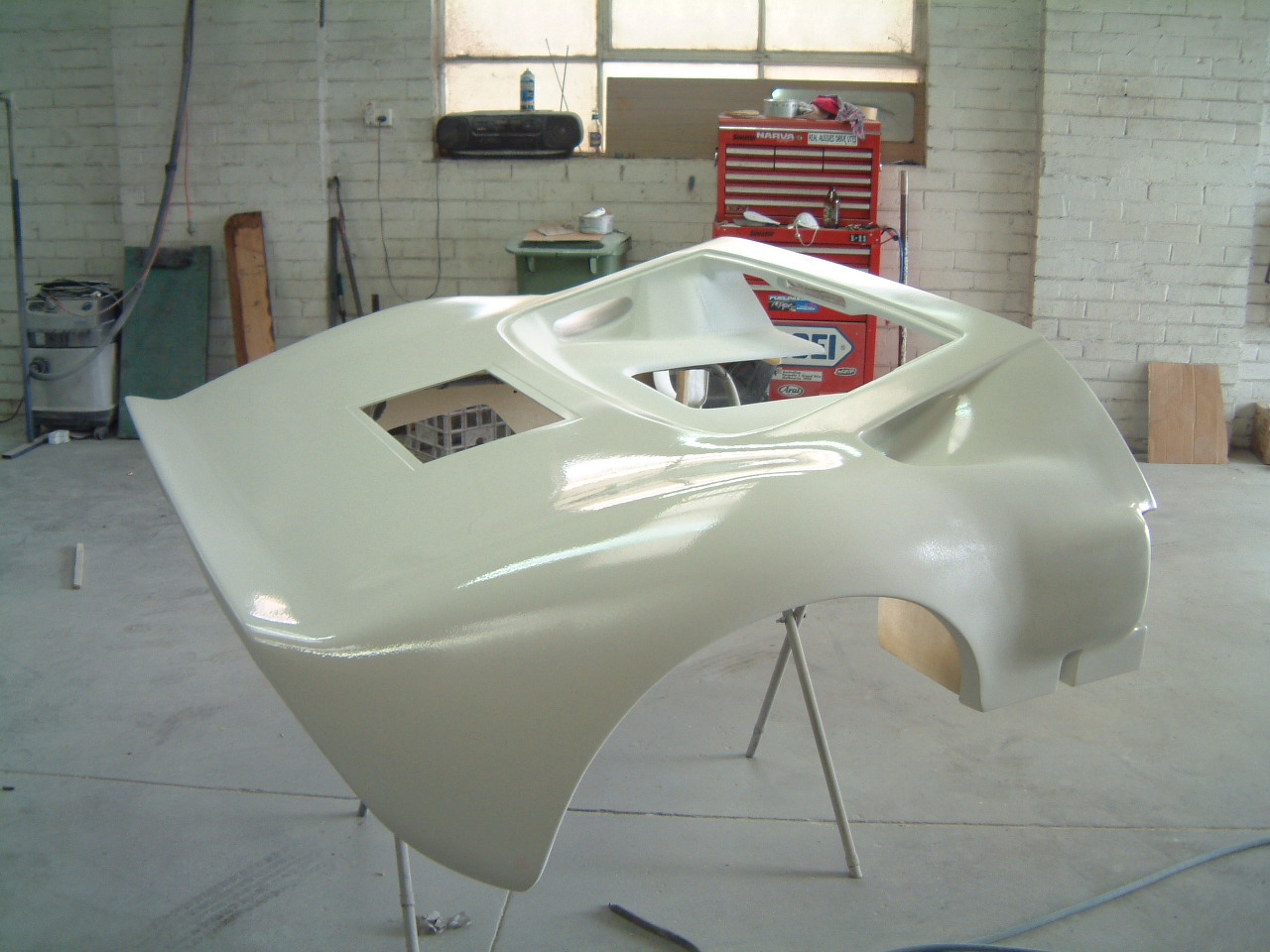

The very next step utilised on my car was a polyester sealer - liquid filler. This stuff is a 2 pak application that goes rock hard, seals the fibreglass, fills in minor imperfections and shows up any weak areas in the fibreglass. Amazing stuff - just don't have a camera operating whilst this stuff is being applied. If it gets on your lens, throw the camera away. /ubbthreads/images/graemlins/shocked.gif

Bill, that is not the ugly stage - its all coming together beautifully ! I agree with you on the polyester sealer - it is the "magic bullet" for f/glass. It goes against the grain to really whack it on (thoughts of all that extra sanding), but more is better. I made the mistake of being a bit stingy in laying it on & thinning it a bit much (not surprising at around $100/litre) & reaped the rewards - over 200 pin-holes revealed after blocking back the black guide-coat ! Heaps more work to fix all that than just blocking back a really solid coat of filler - one lives & one learns !
It looks like Allan has laid on a nice thick coat (maybe he's been down this road before !), so you will end up with a damn nice job.

Great pics Bill, thanks. From your pics you elected to lightly remove the surface area of the seam just below the top level , and refill to avoid a line setting in ? It looks like you used standard body filler to skim coat the areas, correct ? Thanks again, Dan

By ugly stage, I was referring to the previous photo, the one with the seams filled in - different colours etc. The photo with the rear clip in polyester looks a million bucks!
Polyester is awesome and I don't think you did the wrong thing by putting it on thin to start with. The pin-holes would just have been masked by the thicker coat and would eventually have come through to the final coat. By filling them at this stage and then re-applying a thicker polyester coat, you seal the body without pin-holes. Admittedly it means a hell of a lot more rubbing, but worthwhile.

The seam is removed in a wide v-groove (130 degrees - approx) for 50-70% of the joint depth. This is removed to move the tension area as far away from the surface as possible. Body filler is top grade Standox, not sure of the codes, but it is used for the bulk filling needed. Once it is shaped, the polyester goes on and the seams are / should be invisible.

Was the "Standox 2K-Easy Filler" the product you have used to seal the body? I am a little surprised because of the gloss of the coating – the filler and sealer we get from Standox here are all flat or semi flat.

the primer filler that was used is Standox HS System Filler,and the coating appears very high in gloss because it was only just applied and still wet when the photo was taken
