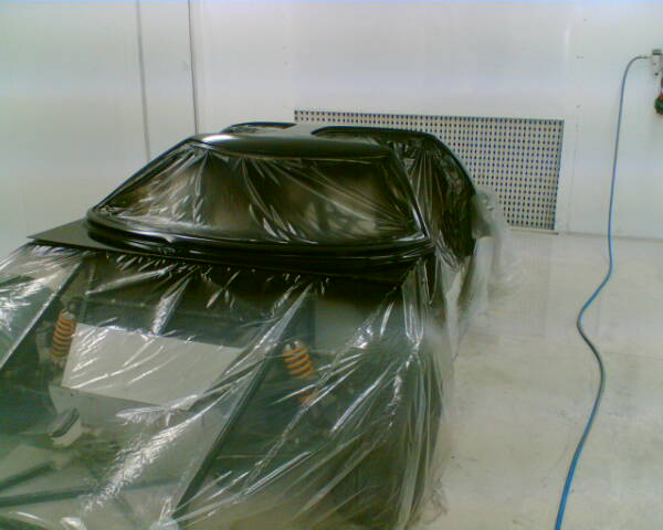

Bill Hara
Old Hand

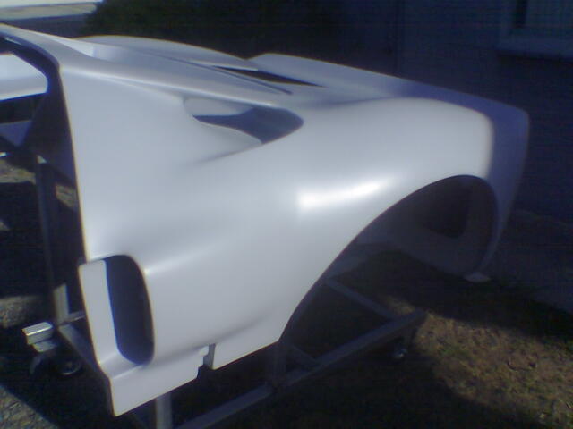

Here is one of the spider, freshly painted again. Note that the last 4 photos (including this one) are all taken moments after spraying and do not look like this when dry.

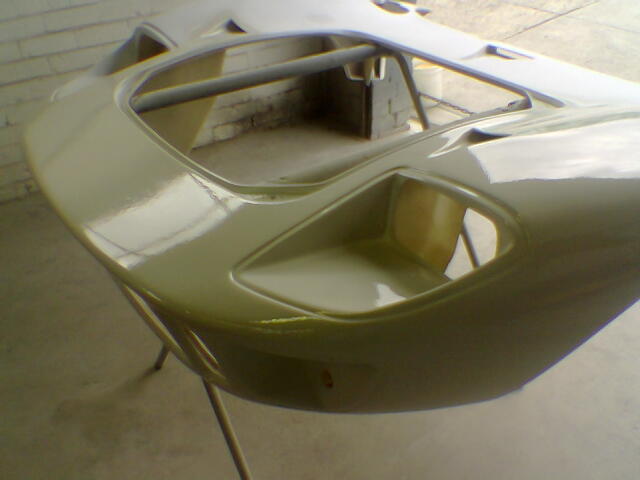

Bill Hara
Old Hand

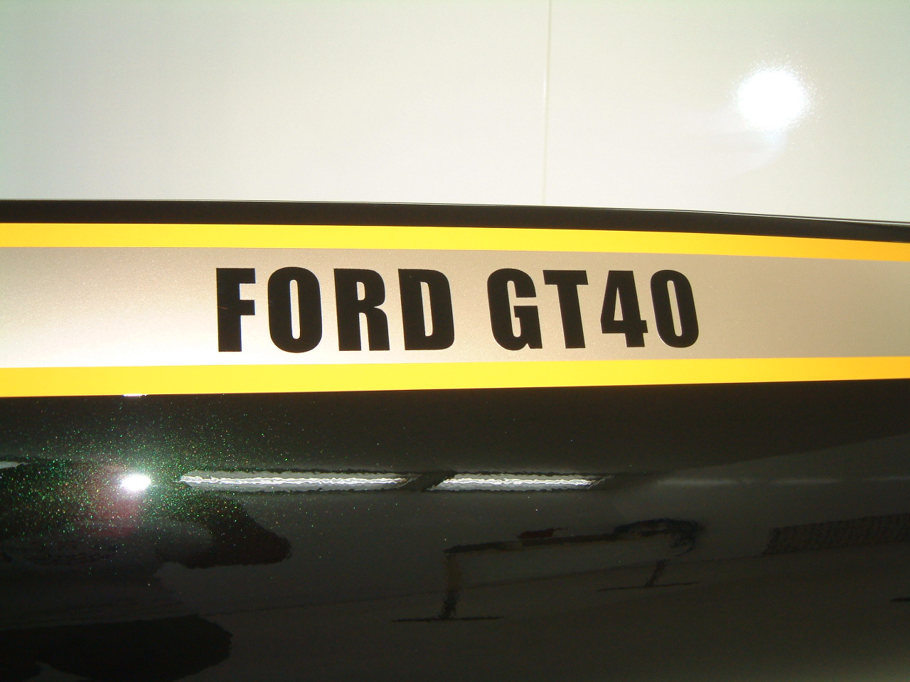

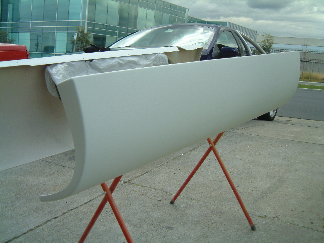

Here is a shot of my sill panel when it was primed

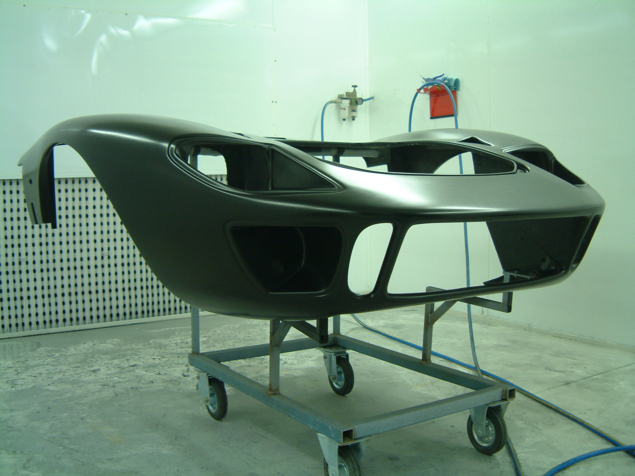

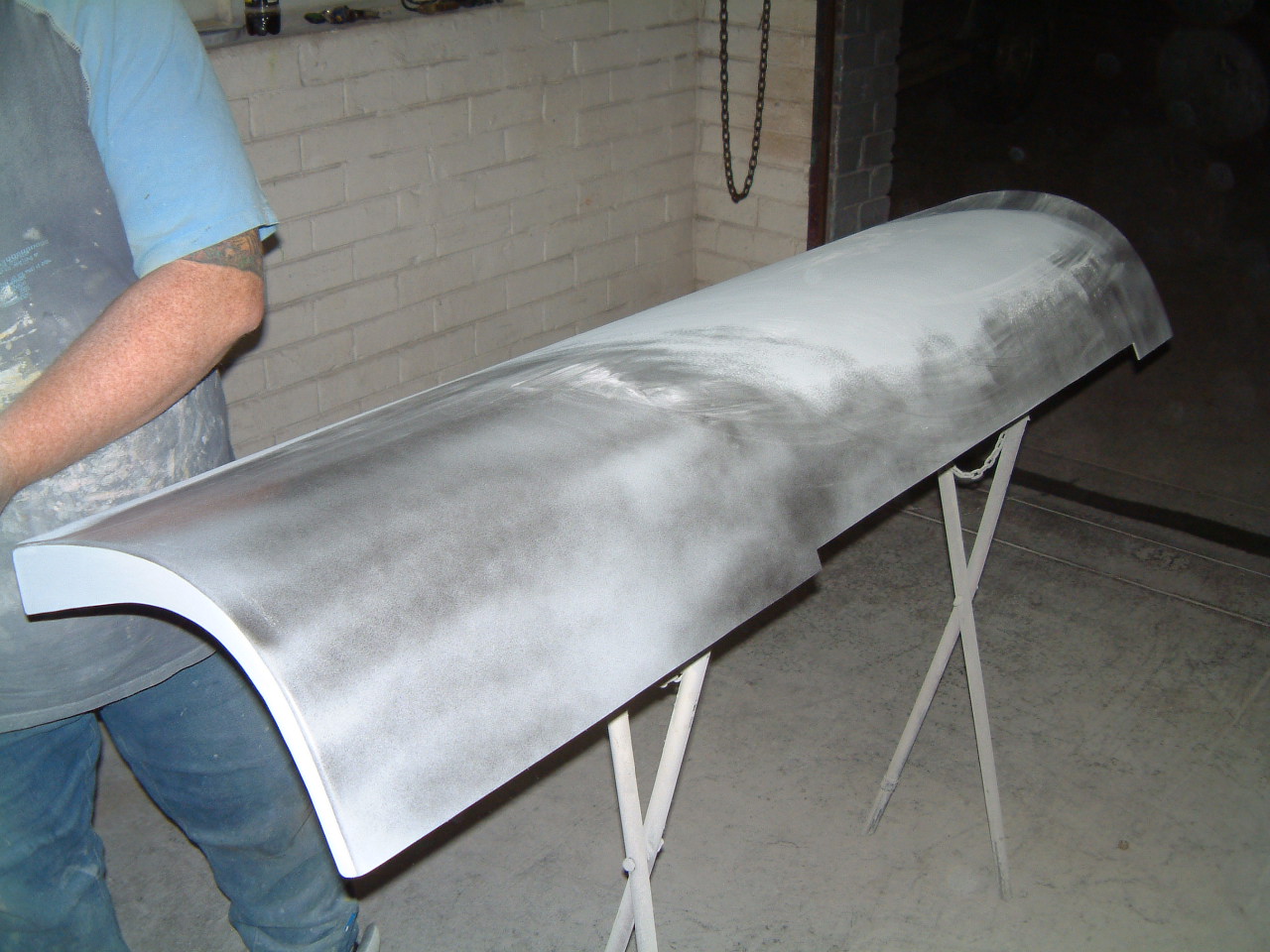

Bill Hara
Old Hand

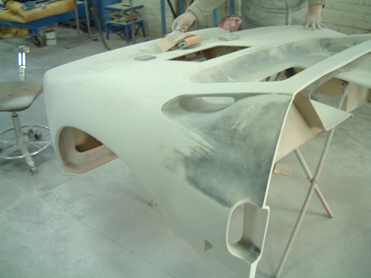

This is a shot of the guide coat being rubbed off the primed coat. This ensures that the surface is flat/even and that there are no ripples. Depending on the colour(especially dark ones), this stage is very important.

Hello Allan and Bill,
Thank you for the info. The Standoy HS Filler is exact the same I plan to use for my GT40 - along with their EP Primer.
Regards Reinhard
Great choice of products Reinhard,you cannot do better than EP &System Filler,should look great.
Best of luck
Al /ubbthreads/images/graemlins/beerchug.gif

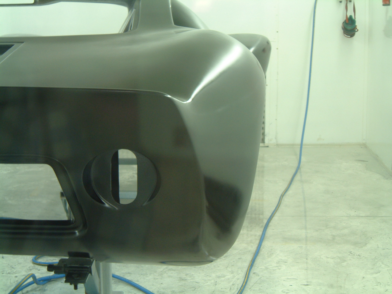

Bill Hara
Old Hand

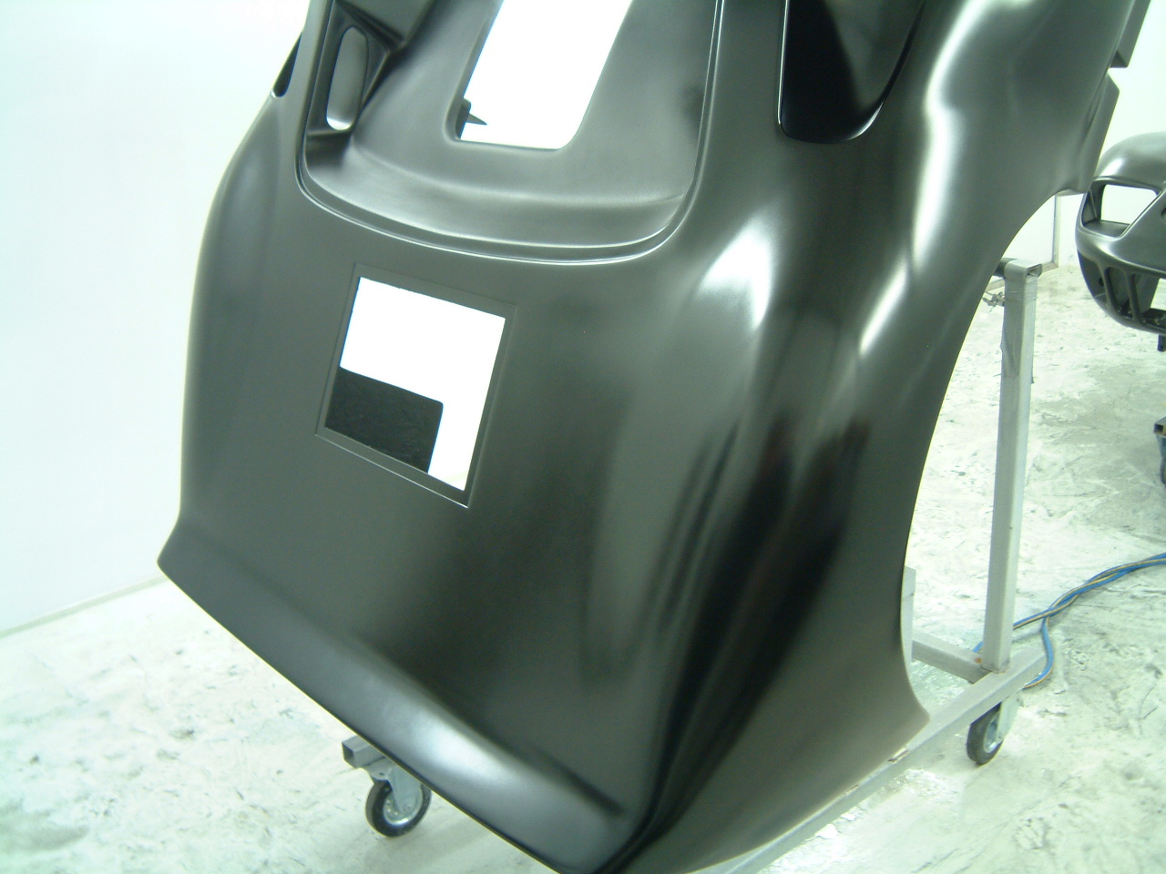

Here is another photo of the guide coat over polyester, being rubbed off.

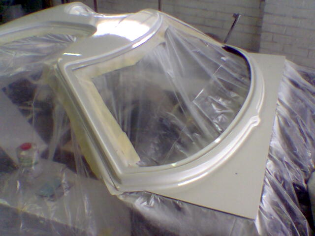

Bill Hara
Old Hand
And here it is in primer. The primer still needs a guide coat and rub down prior to painting final colour.

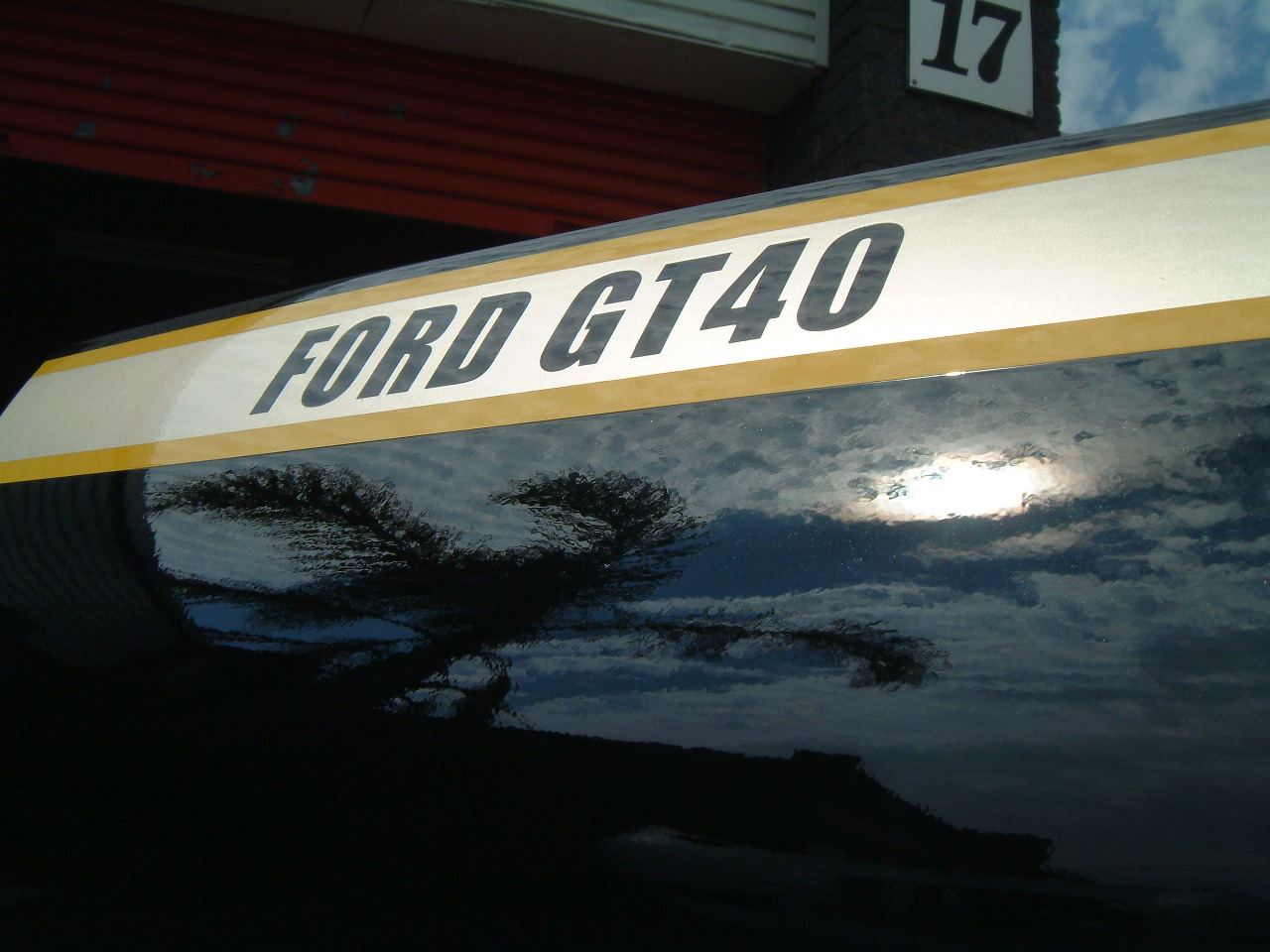

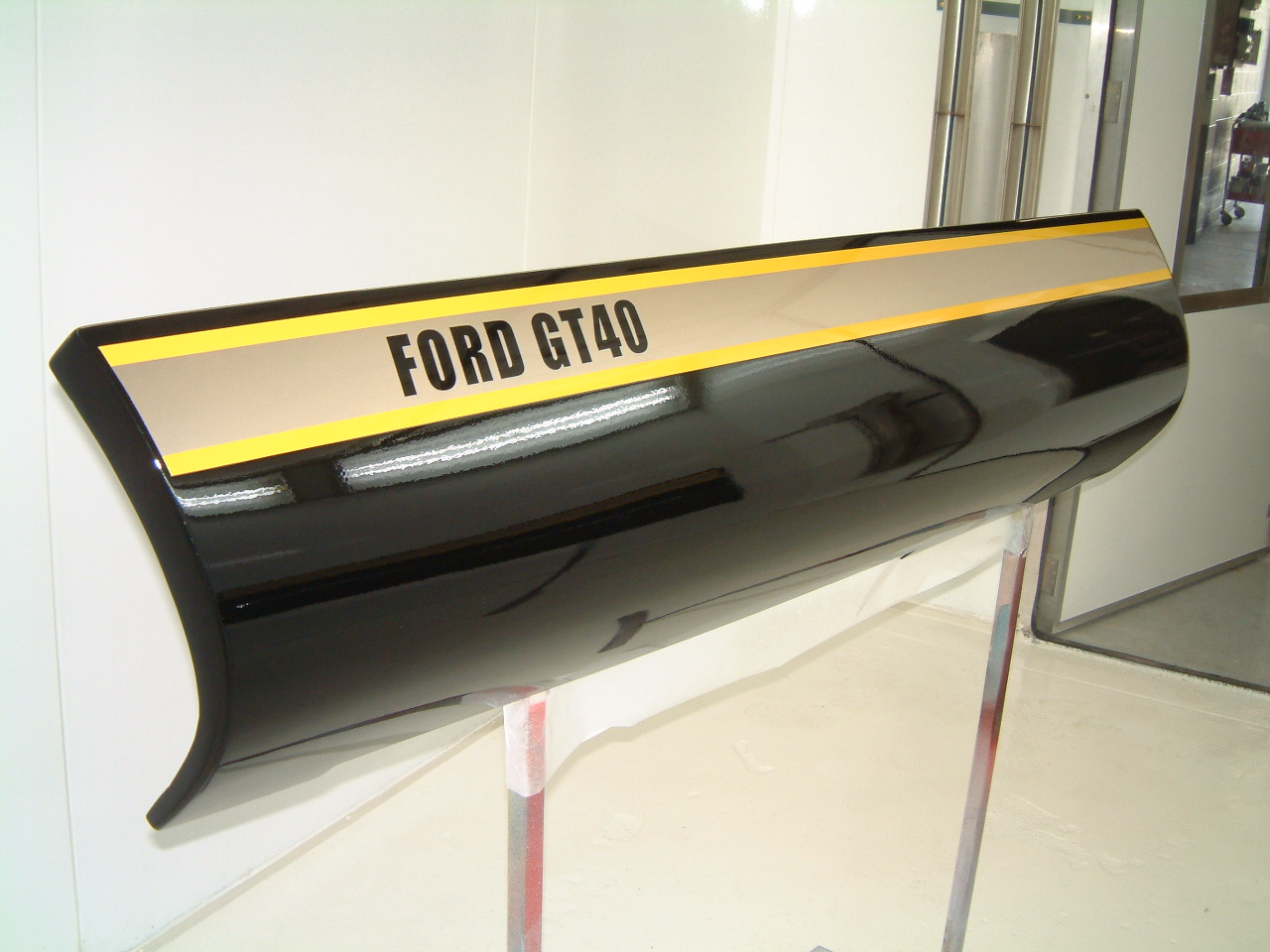

The new home now has a fully upgraded spray booth and my car is now undergoing the final application stage. First cab off the rank was the striping of my sill panel, which still needs to be buffed once it has fully cured.
Peter Delaney
Bill, she is looking great - that sill panel is superb, so by definition, all the others will too !
I love your colour choice - you'll get a new kick out of it every time you see the car in different lighting conditions.
So close now !
Kind Regards,
Peter D.

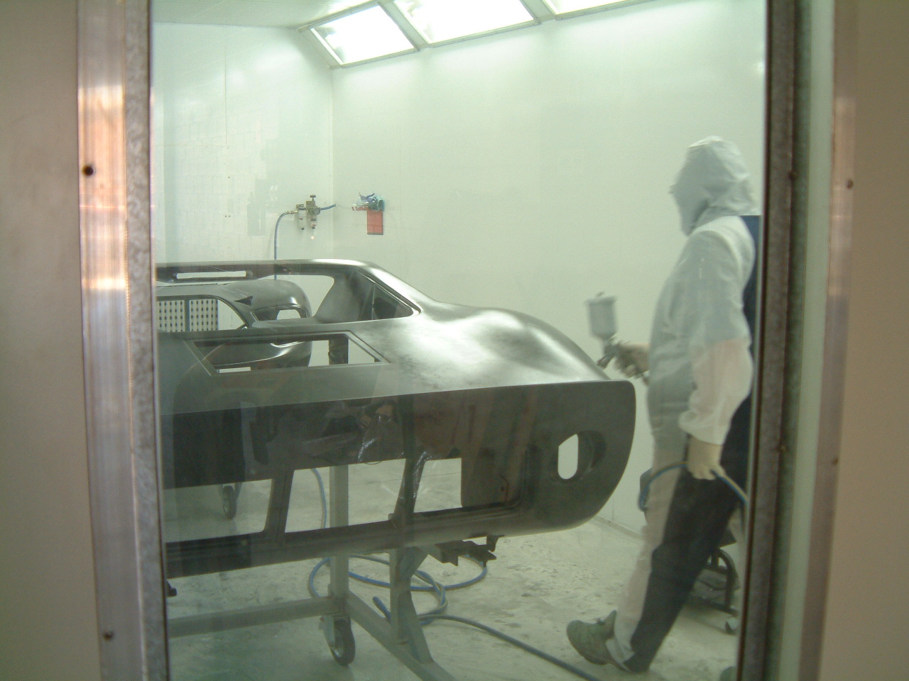

Bill Hara
Old Hand
Rear clip - this is 5 minutes after the last colour coat. There is still some striping and clear to go on.
