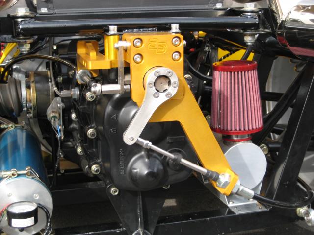

I have a California Motor Sports side shift fitted to my G50 with cable shift as it was the only option with the Ford Boss motor given the motor is so physically large it would have been a nightmare to try and route the rod shift around the motor and also I like the billet end plate which caps off the G50 so there are no linkages hanging out the back of the rear clip.

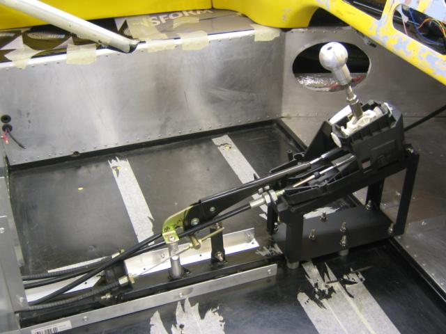

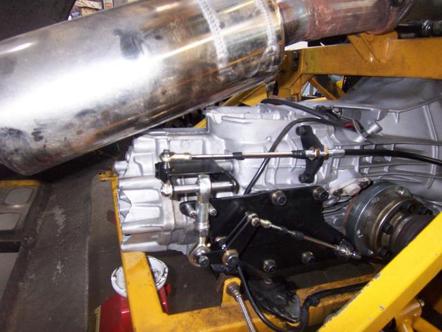

Hi Nick,
how about this setup.
A very smooth shift.Not sure if it's the same as your box though.

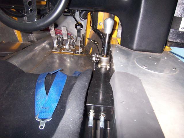

The following are supplied by Steve Austin (yes really) at www.autobionics.co.uk looks like a nice piece of kit.

Dimi Terleckyj
I have the Brandwood cable shifter and had to make many modifications in brackets and levers in order to make it work properly for my G50/03 (shortened to roughly G50/01 overall length).. Check out my build site for details and pictures as I don't know how to capture the pictures for posting here...

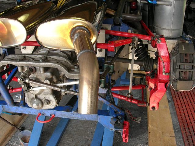

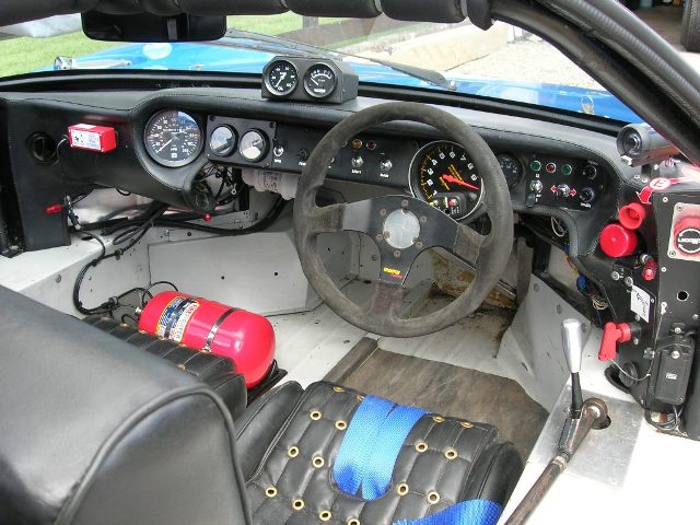

My car "K4OGT" uses a rod change system, basically a rose jointed streight rod from the drivers side, all the way to the rear of the gearbox.
Then with the aid of some additional rods and rose joints provides a superb shift "Like a rifle bolt!"
Engine is Chevy 350 mated to a G50/50 with Quaife Internals & ATB
I have attached a couple of photos
Julian
